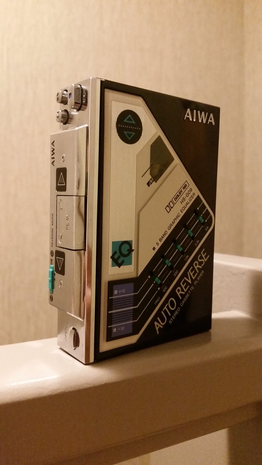

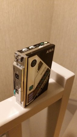

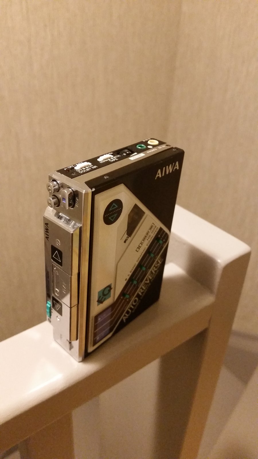

    Here's my Aiwa HS-G09 that I bought from LeBonCoin.fr

  2. T-ster
    1,455
    What a lovely looking unit!

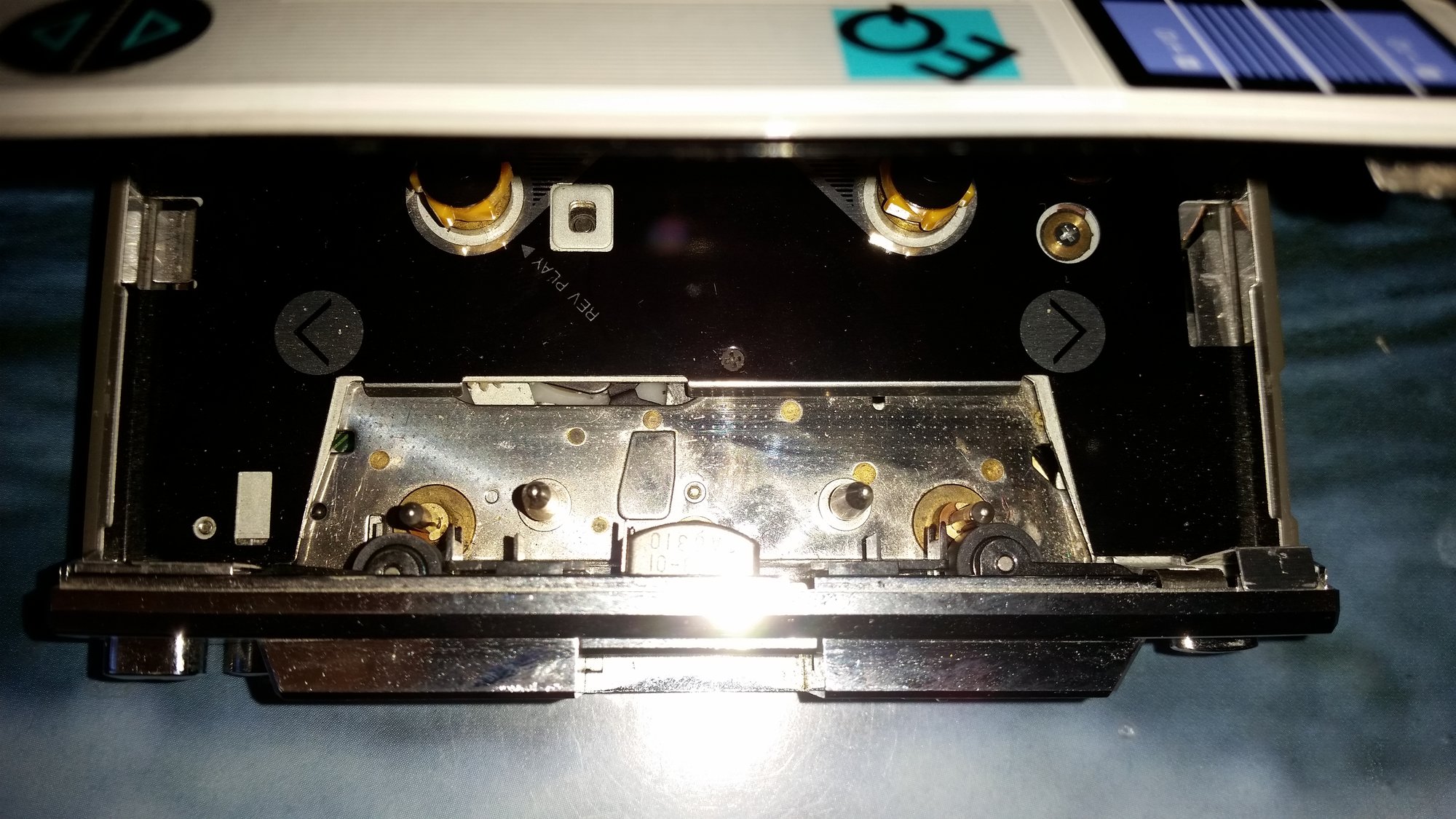

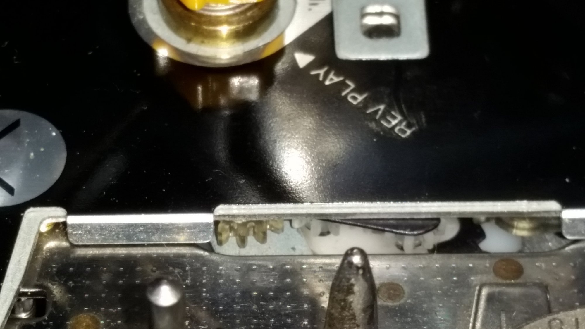

    I've noticed that when you press the play button, the right pinch roller touches the metal turning pin (probably also has a specific name, but don't know it....yet)
    However if you look at the left pinch roller, it doesn't touch the metal turning pin !!
    Is this maybe the reason why the autoreverse eats the tape after a few seconds ?
    By the way the tape is always eaten by the pinch roller positioned on the right.
  5. Soxbrother
    Soxbrother Member
    104
    Belgium
    Another possibilty of the autoreverse is maybe that one of the gears doesn't turn ?
    Without a tape, the 2nd and 3rd white gears on the picture turn, with play, Fast Forward en Rewind.
    The left gear (a bit darker color),
    doesn't turn at all.
    Maybe it only turns when the autoreverse kicks in ? Impossible to see with a tape inside.
