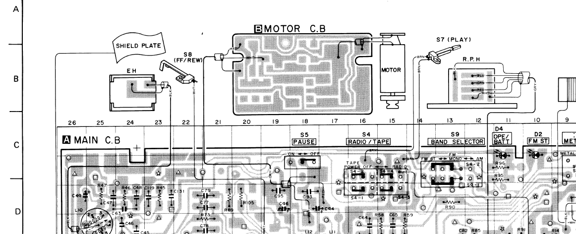

    +1 ^^^ @Jorge , also it seems the Motor C.B. has its own PCB (shielded in a tin box ?) , it looks that it has discreet components that probably can be replaced if they can be read.
    If that fails , Motor C.B. looks like a simple voltage regulator , measuring the input voltage (red and white wires , third wire is earth shield) you can order a generic one from ebay with adjustable output voltage and adjust it to the specific 2.3 Volts needed where the motor wires will be connected.
    As Jorge said this problem seems similar with the WM-D6C usually caused from wrong voltage power supply or wrong polarity.
