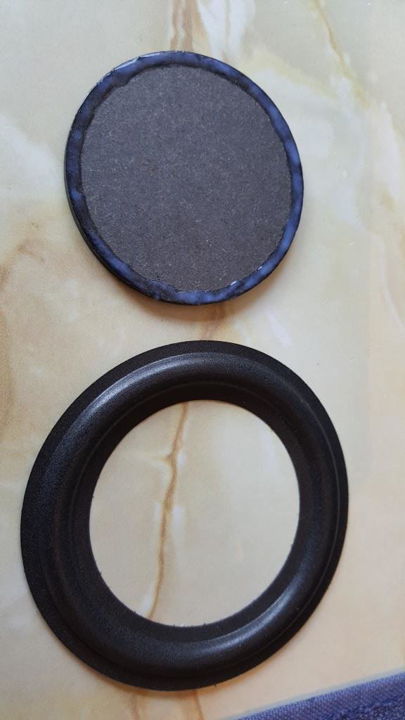

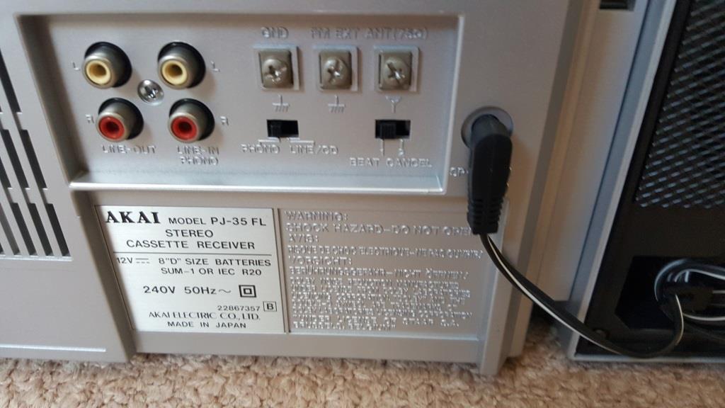

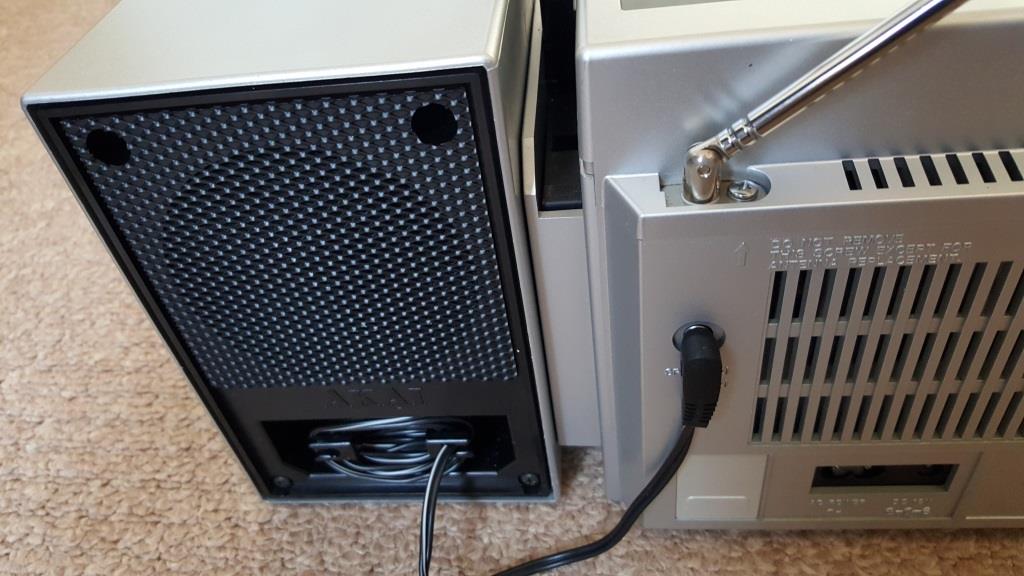

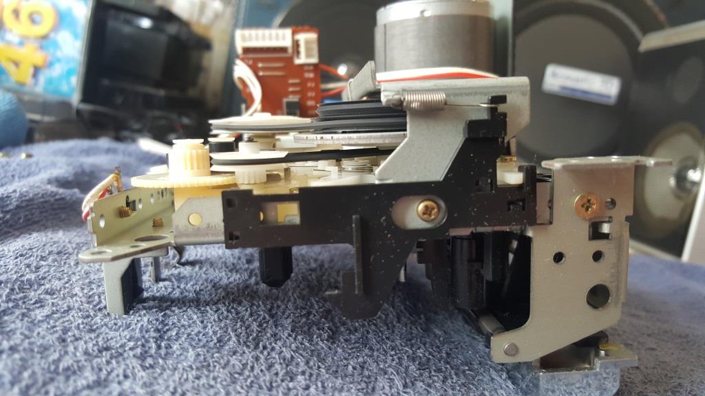

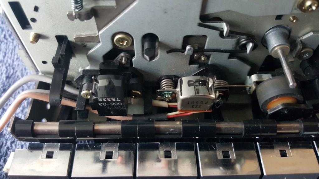

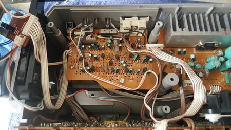

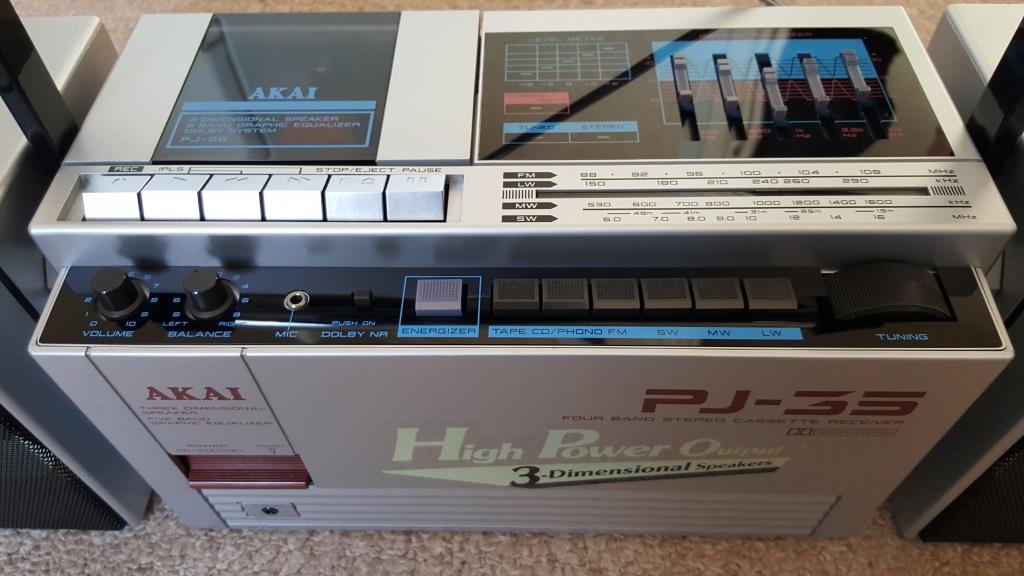

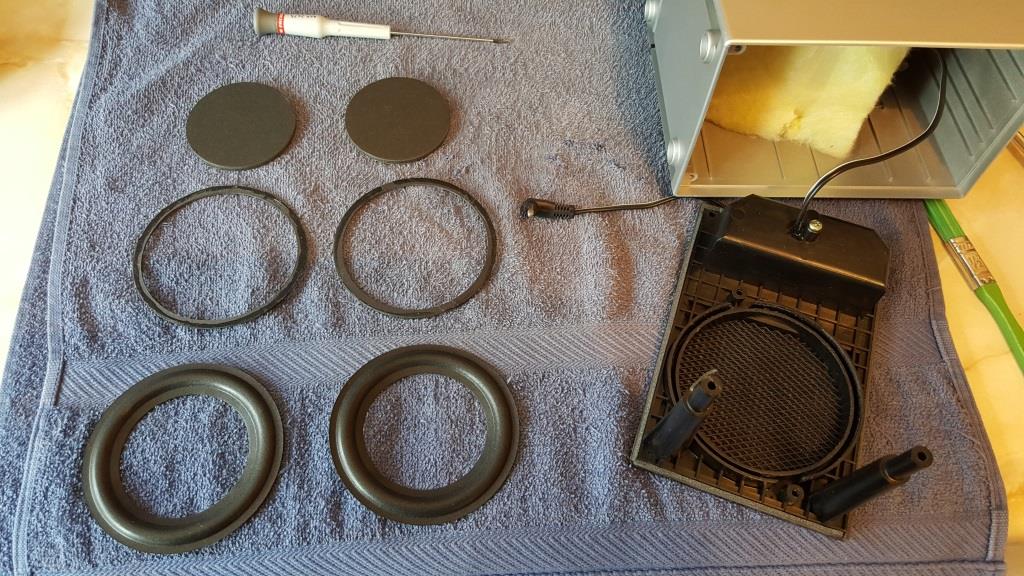

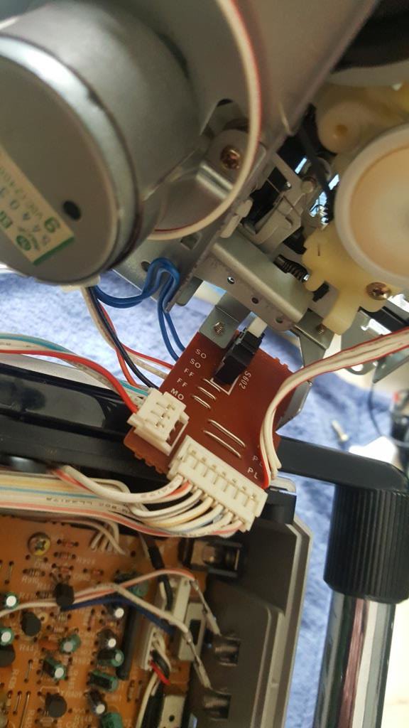

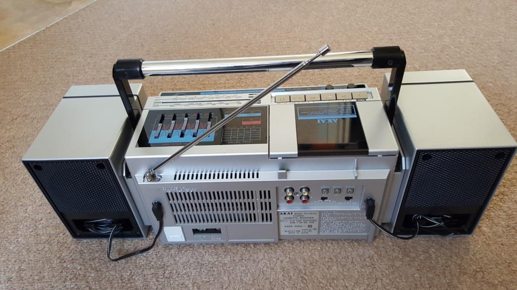

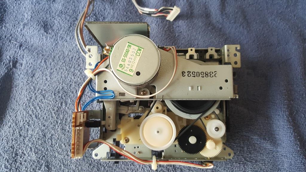

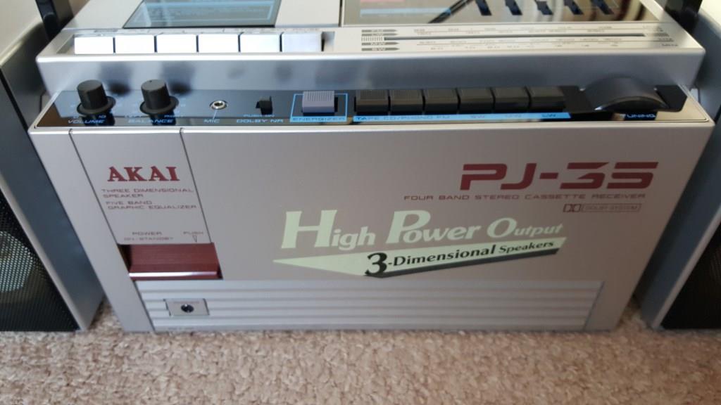

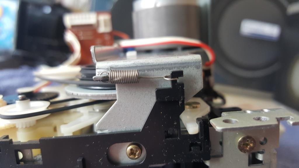

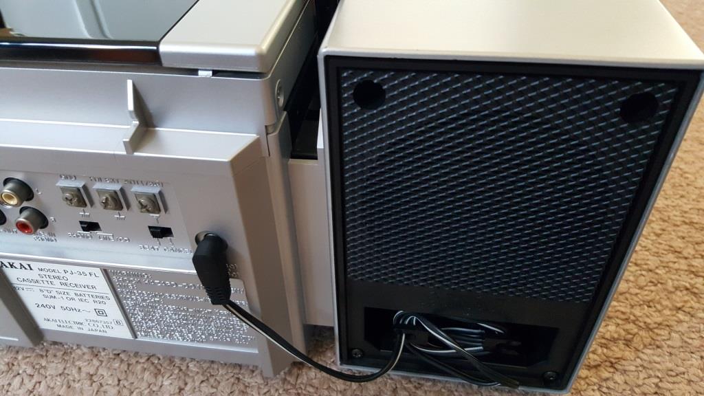

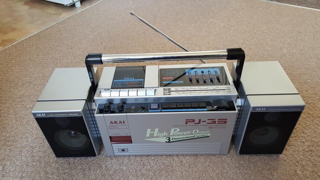

    Got this pretty much minty PJ-35 last week amazing condition and very clean.

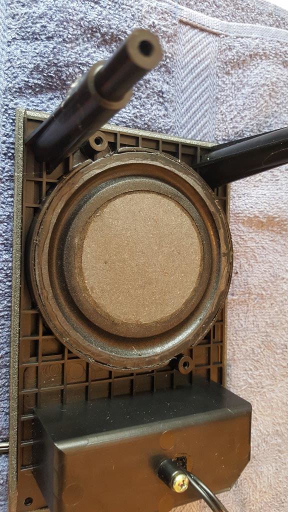

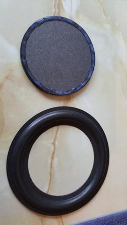

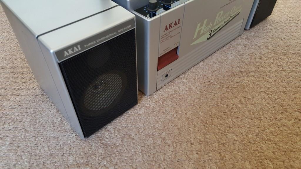

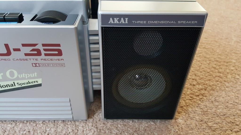

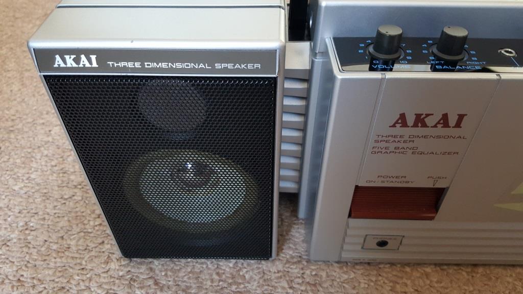

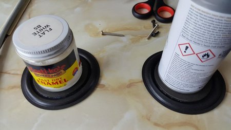

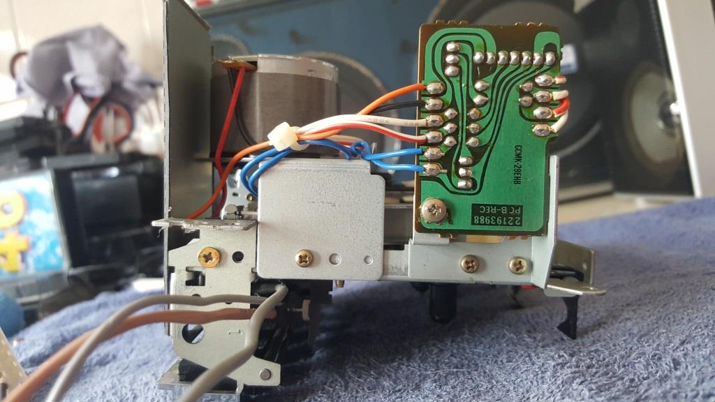

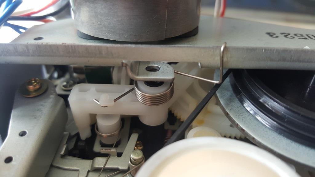

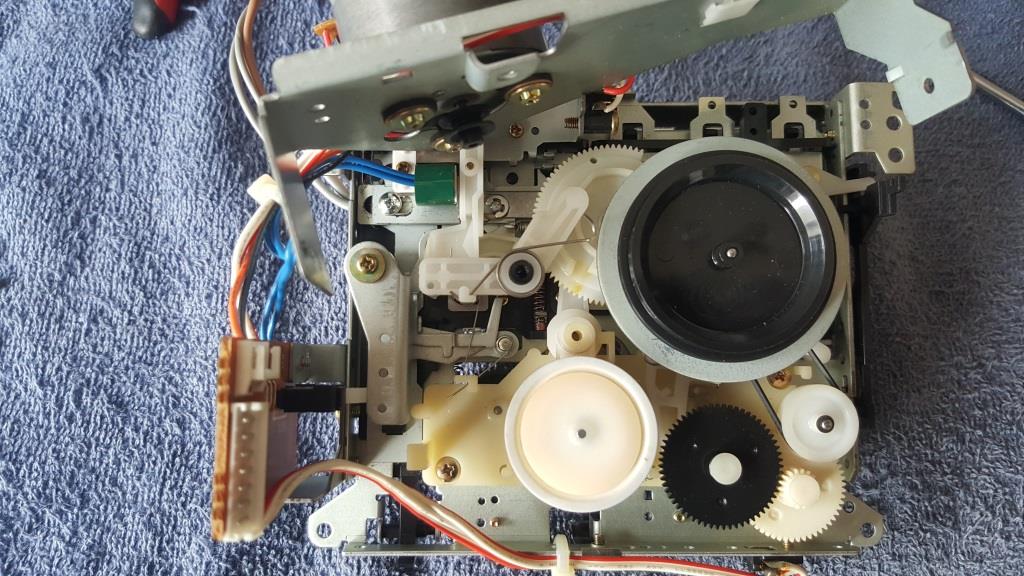

    It needed belts and the passive foams replacing, the front speakers were ok as they have fabric surrounds but they had gone very stiff and the left one had distorted mis-shaping the cone.
    I Carefully used a hairdryer on the misshaped one and while it was soft reshaped it and used a weight to keep the shape until it cooled, worked pretty well. This also made the surround softer after it had cooled, so heated up the right speaker also, they both work very well now.

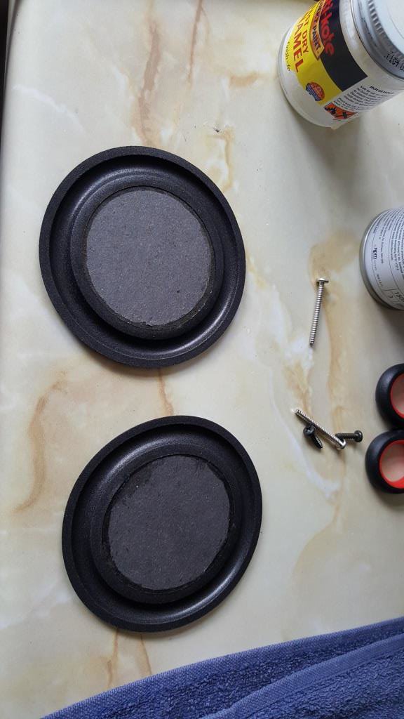

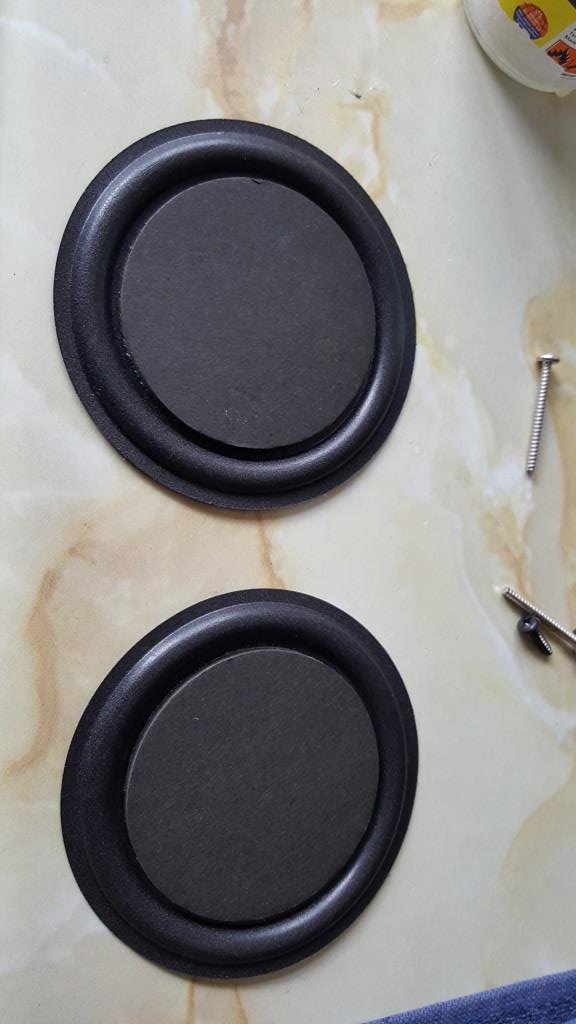

    Had to wait 5 days for foams to arrive from China which was actually pretty quick, I couldn't find 3.5 inch foams anywhere else. The foams were good quality and fitted very well, bit of a pain removing the old ones as they are fitted directly into the speaker cabinet back no separate chassis.
    So it's all done now looks very nice and sounds great.

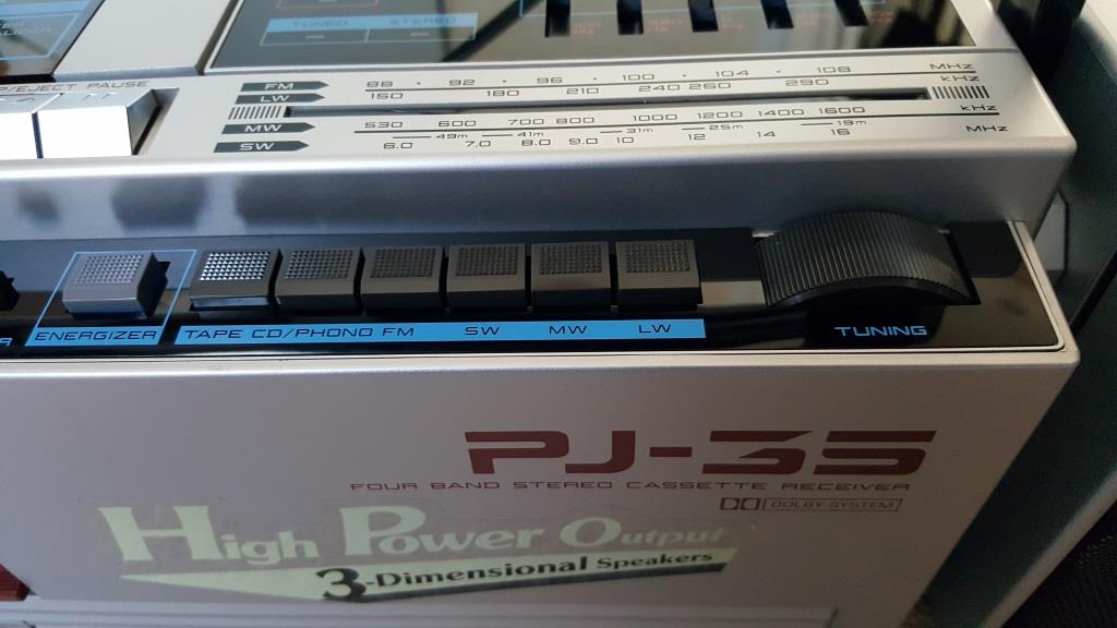

    Well having just bought a red one of these in very good condition i can say it is superb, loud and very clear....only issue id say it's a bit light in the bass, but maybe my foams are stiff and the passives i guess will need doing but the belts etc are like new, so yes superb box. Dave only question i have is...there is a switch that boosts the treble but does nothing for the bass, does you're switch boost the bass and treble dave lad or just the treble....cheers great box:wink2

    The 'Energizer' button on mine only enhances the treble, but as it also increases the volume the bass does increase slightly.

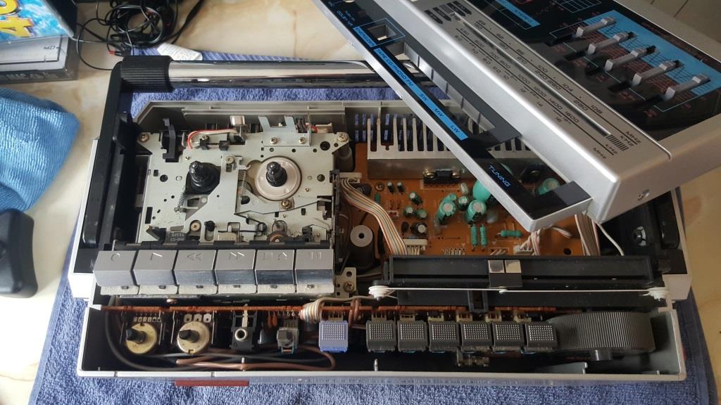

  15. NikolaStereo
    NikolaStereo New Member
    Canada

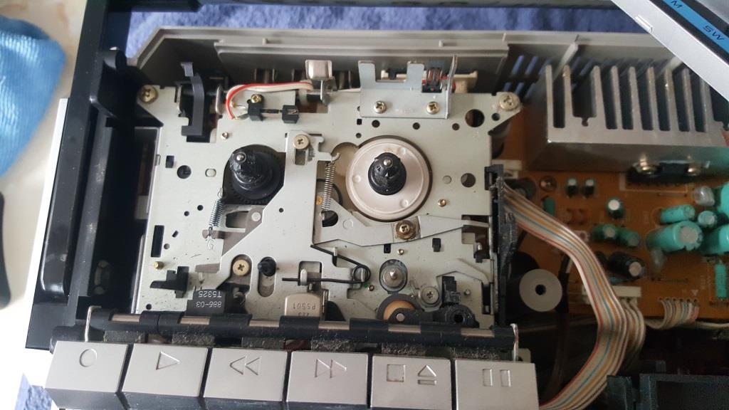

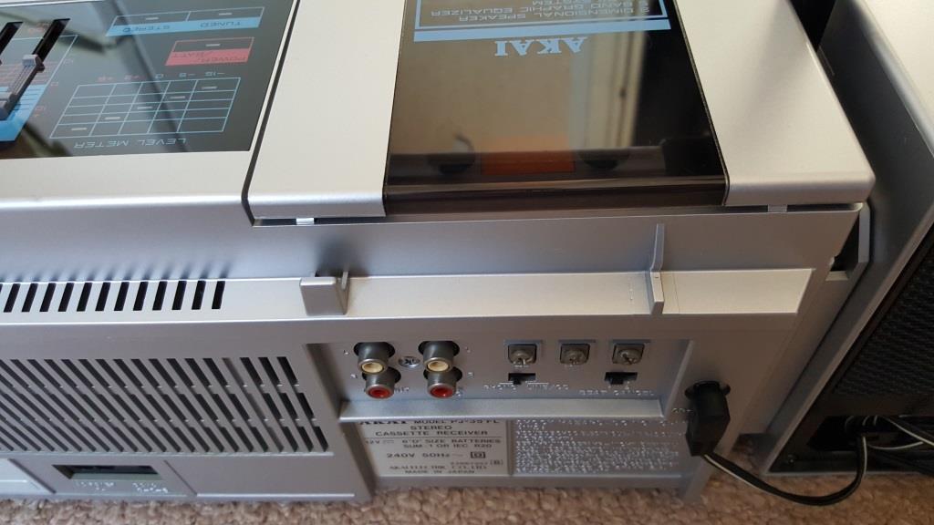

    Hi mrp32Dave, I just came into possession of my grandparents old Akai PJ-35, beautiful machine but the cassette player does not work. It sounds like its spinning but making an awful loud noise and will not play tapes. I'm trying to open it up to clean it out and replace any necessary parts, but I can't seem to get the top piece off. I've taken out the four screws that seem to be holding it in, and the two control knobs on the left, but I feel like if I try any harder to pull it off it will break. Is there a trick to it, or am I missing something? Looking forward to your response and to getting this thing cleaned up and working!
    Thanks,
    Nikola
  16. mrp32Dave
    mrp32Dave Well-Known Member
    276
    United Kingdom
    Hi, these are nice boxes and sound very nice in my opinion, there is one hidden screw in the centre of the battery compartment, hope this helps. Oh nearly forgot the cassette door must be open!
  17. NikolaStereo
    Canada
    Ahh, thank you! That helps tremendously. I'll be checking back with more questions in the future.
