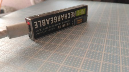

    Old AIWA players still my favorite. Now I can use the modified batteries for all the AIWA cassette players. Bought from Ebay a set of 3 a few months ago PB5, PB4 and PB3. Work great. Charging uses a USB cable.
    Middachten and kitchen10 like this.

    I have been searching for these on Ebay but can't find them. Do you have a link for me?
  11. Jorge
    1,717
    Me too... I found that eBay listing through Google, but I think it was a one-time deal: the guy had a few dead batteries and restored them. Right now I am waiting for Aiwa HS-P202 MkIII arrival, then I will try to get batteries from here
  12. mary lee
    mary lee New Member
    6
    Singapore
    Seller is : wickedkraft
    Lately not putting up any as I was told the original AIWA batteries are running out. Contact the Seller. Understand he will do it for you once he gets supply of the old batteries. He sold quite a number and buyers are all happy with them.
