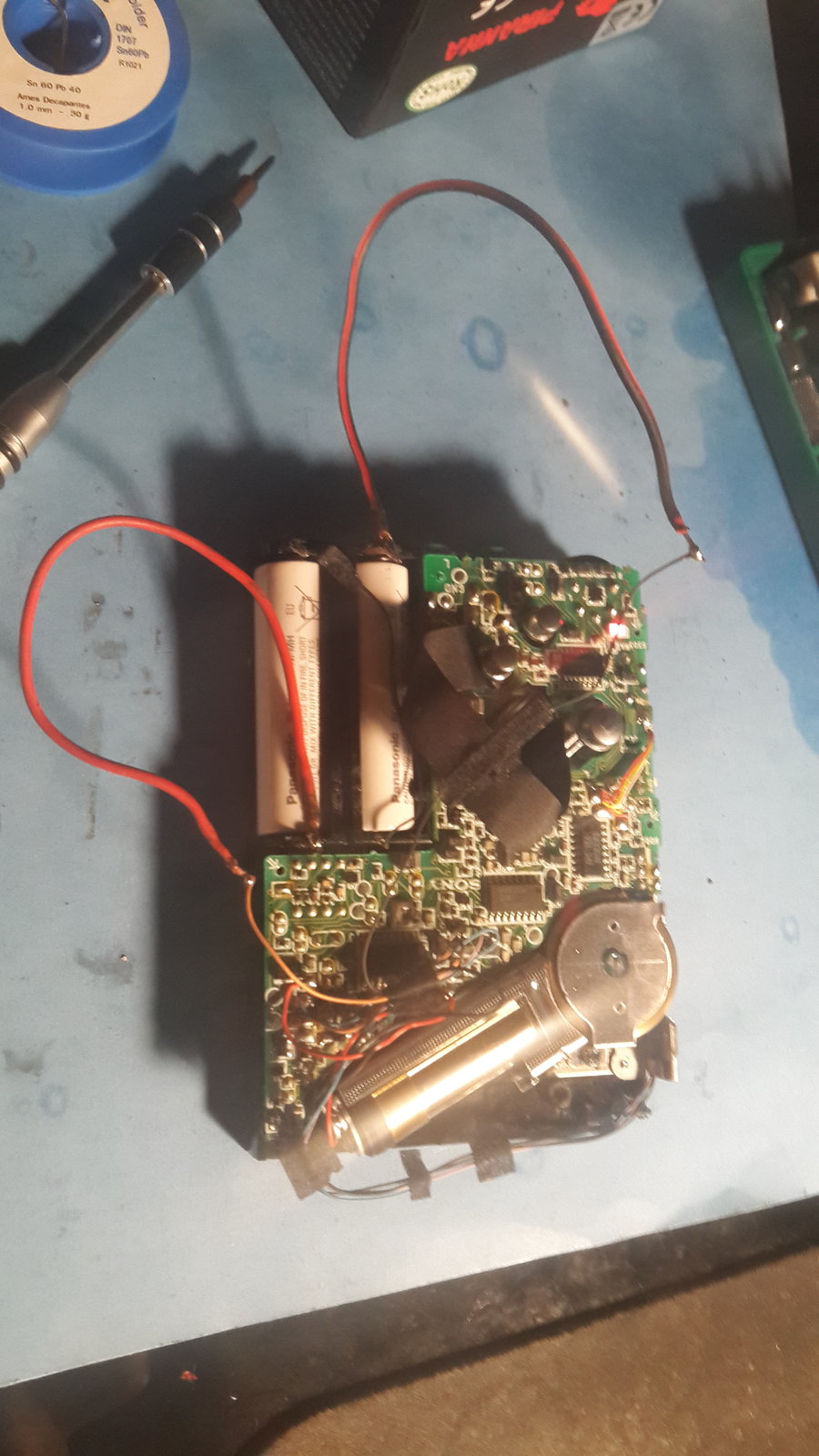

    Please can someone help me with a picture to show me which way the battery connectors are wired and which way they go in the battery compartment. The way I have mine when I reassembled the DD30 means the led doesnt show red and the batteries get very very hot! I have done something wrong

    I happen to have a very fuzzy photograph from last week as I replaced the central gear. Just ignore the hastly soldered cable extensions.
    The orange cable goes on the "bottom" battery +, the gray one on the "top" -, and one bridges the top + with the bottom -.

    Thanks very much for the advice and posting the pic. I have changed the connections on my DD30 and it is powered properly now :applause
