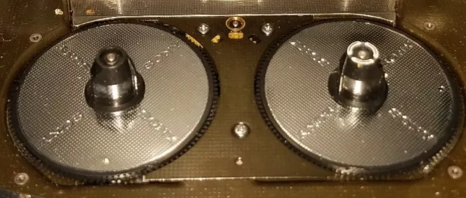

  5. Boodokhan
    2,461

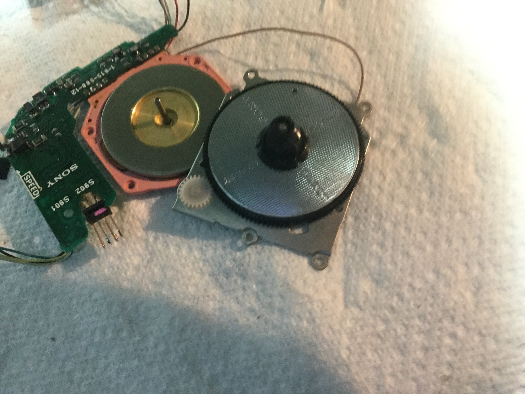

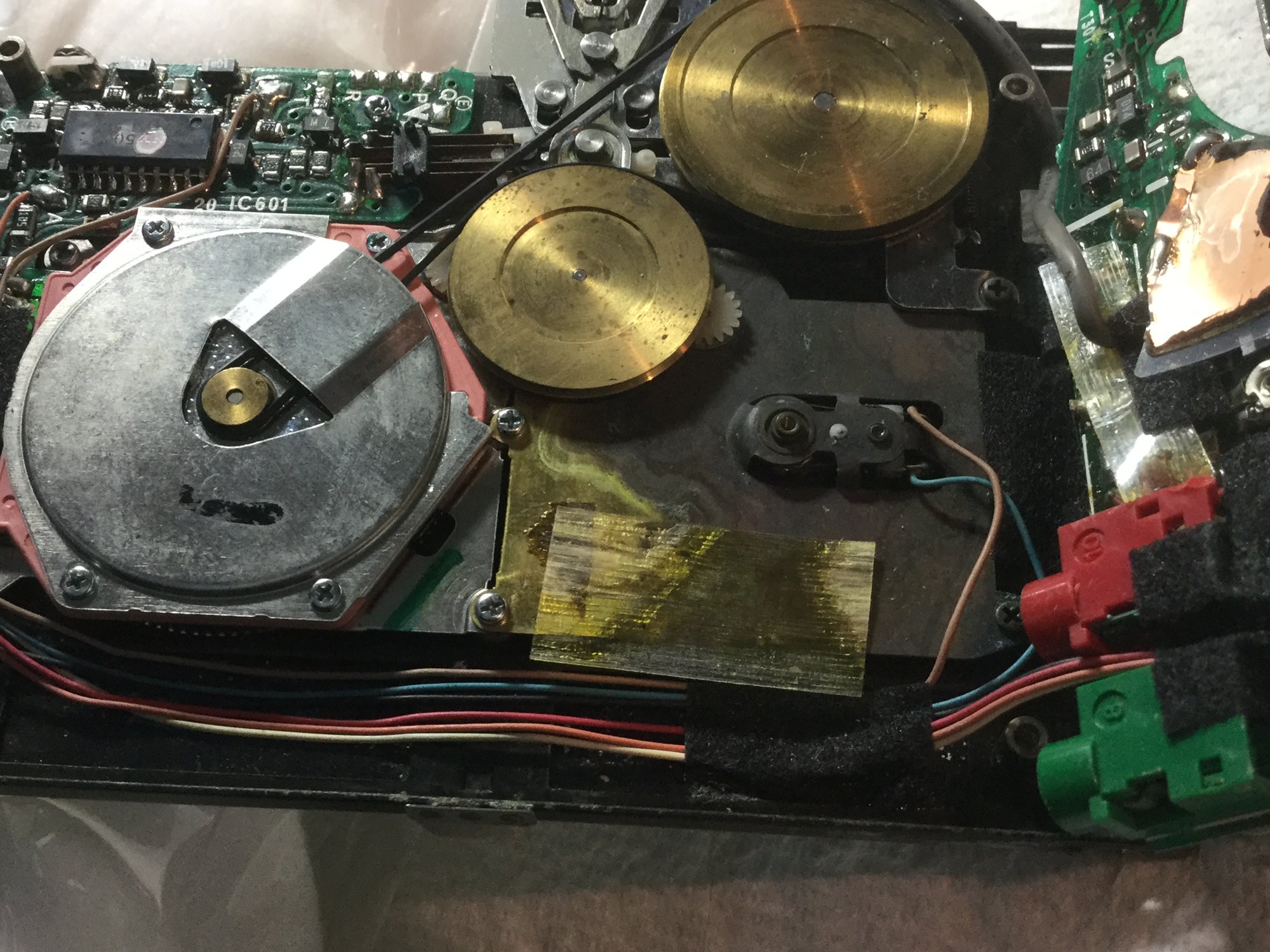

  6. Boodokhan
    2,461
    I took the motor out and you can see the main gear itself here
    speedy2.0 likes this.
  7. speedy2.0
    speedy2.0 Active Member
    361
    London
    That is very useful! Thanks! I think I’ve done the right thing ordering an old similar model. Does the cog detach from the silver plate, or is it one piece?
    On my version the wires power the motor slightly differently, through a very thin plastic circuitboard and into 8 tiny solder points.
  8. Boodokhan
    2,461
    I am sure It can be separated but I have never done that before.
