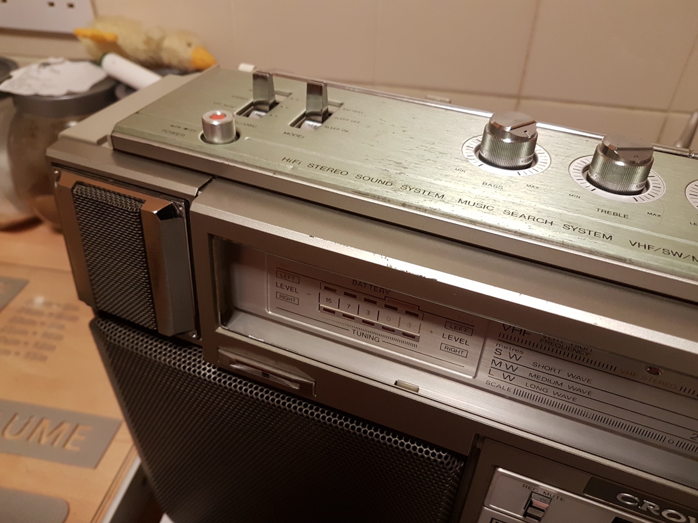

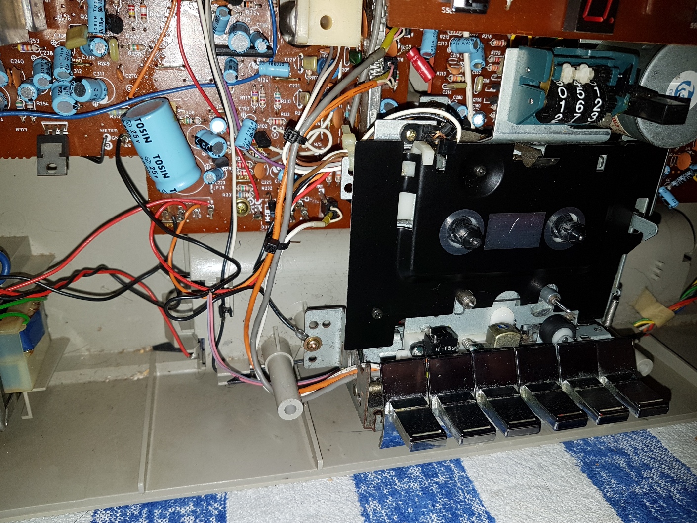

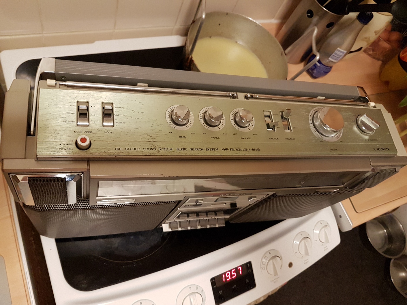

    This one was an absolute nightmare :shock :shock :shock

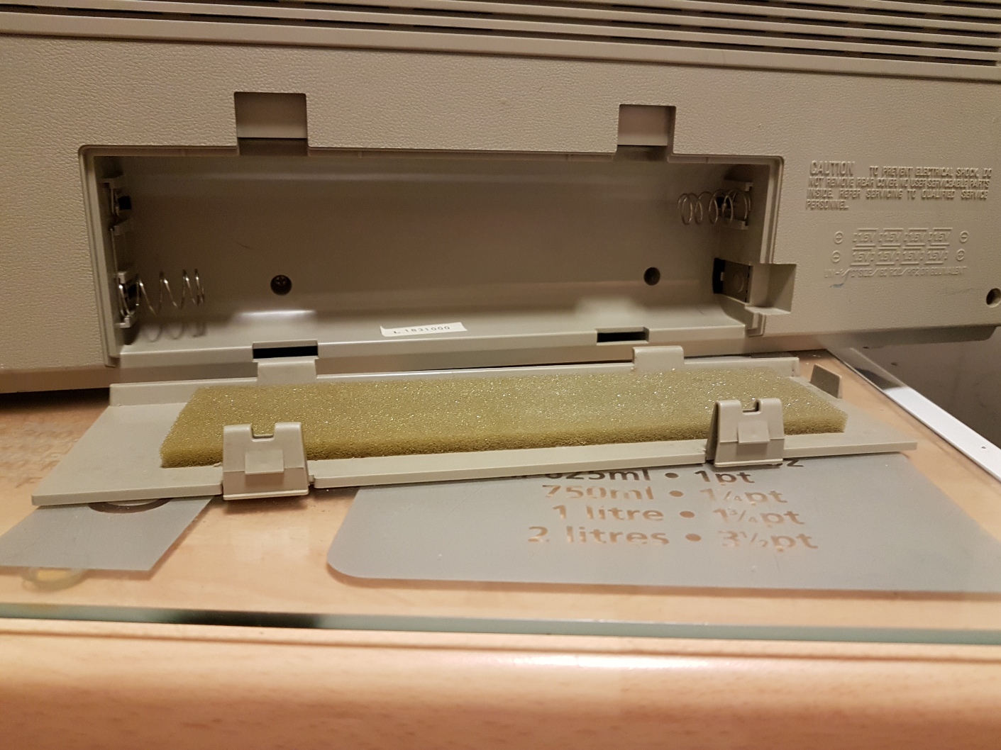

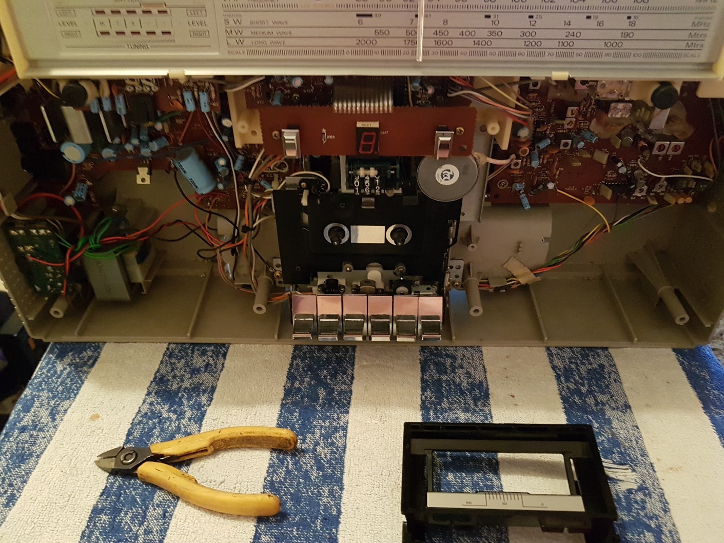

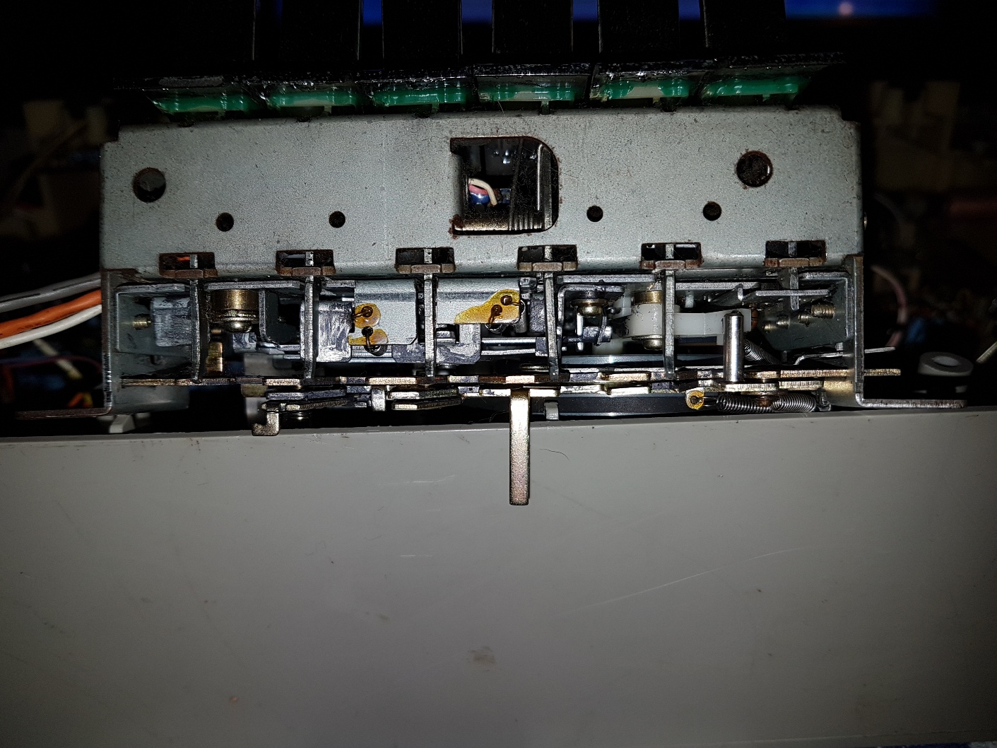

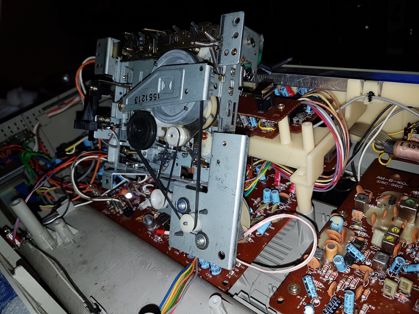

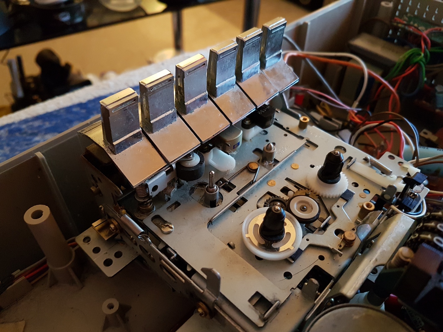

    Really challenging as the cassette deck was completely crippled, it wasn't till I stripped it down as shown in my post when it arrived - I was so excited to get one of the not so common Crowns & never thought it would take 2 months to get it sorted :wink:

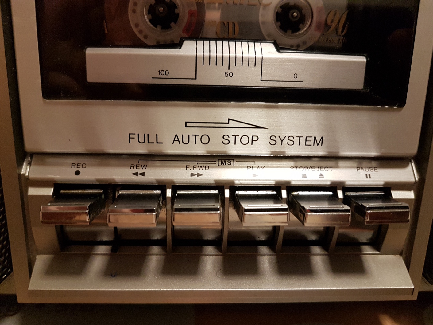

    The keyblock carries the six piano keys that operate the cassette transport functions.........5 out of the six keys return springs were simply missing (The pixie's have been in here) & the remaining spring was jammed solid & ground into the fast forward plate - yeah it was unrepairable as it stood :frown: :frown: :frown:
    Huge thank you to Rudey who unprompted, sent me the deck from a CSC-945L which shares the same deck minus the search system - That didn't matter at all, it was the keyblock I needed, mine was fucked :biggrin:
    This took ages the next stage, I put it aside many times.............3 layers of sliding operating the locks for each key to change over & that's after a major stripdown of both deck mechanisms!!
    Lots of swearing but no loss of temper :lollegs: Just walking away from it & doing slowly stage by stage until: VIOLA!! :bigthumbsup: :bigthumbsup: :bigthumbsup: The doner keyblock now carried the extra components that mine had to make it work at all :reelspin: :reelspin:
    Well the deck now operated manually in my hands, the stop eject arrangement is beautifully simple, but to put everything back was a way off yet - I could operate all functions as though the deck was connected & so far so good :thumbsup:

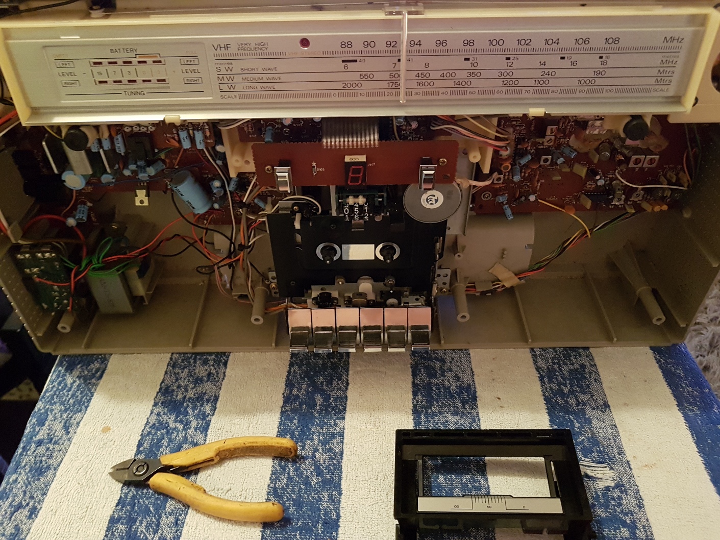

    Next up, clean all switches out with servisol, power the motor up & clean the pinch roller back to black, polish the heads which were all really dirty :shock

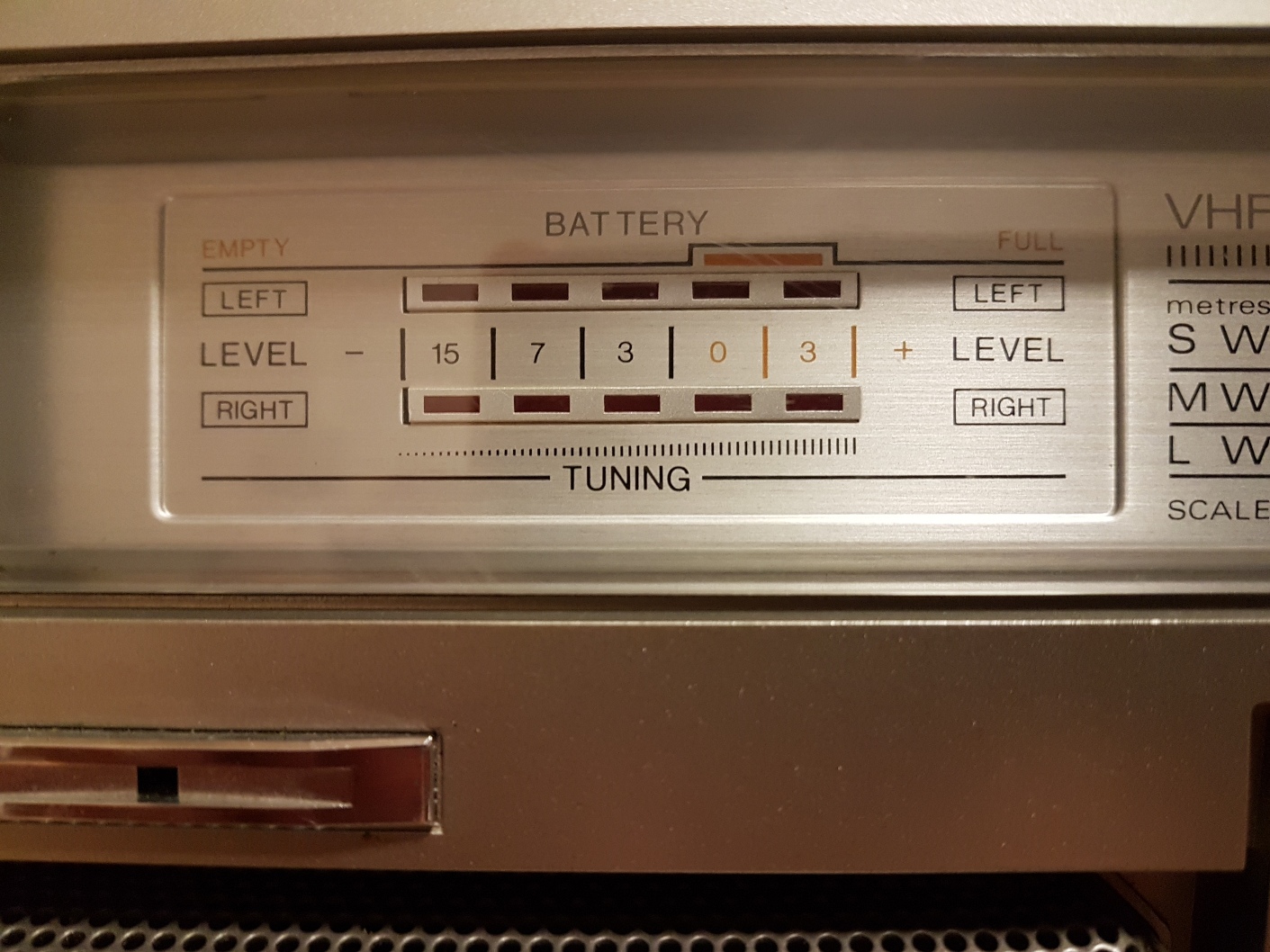

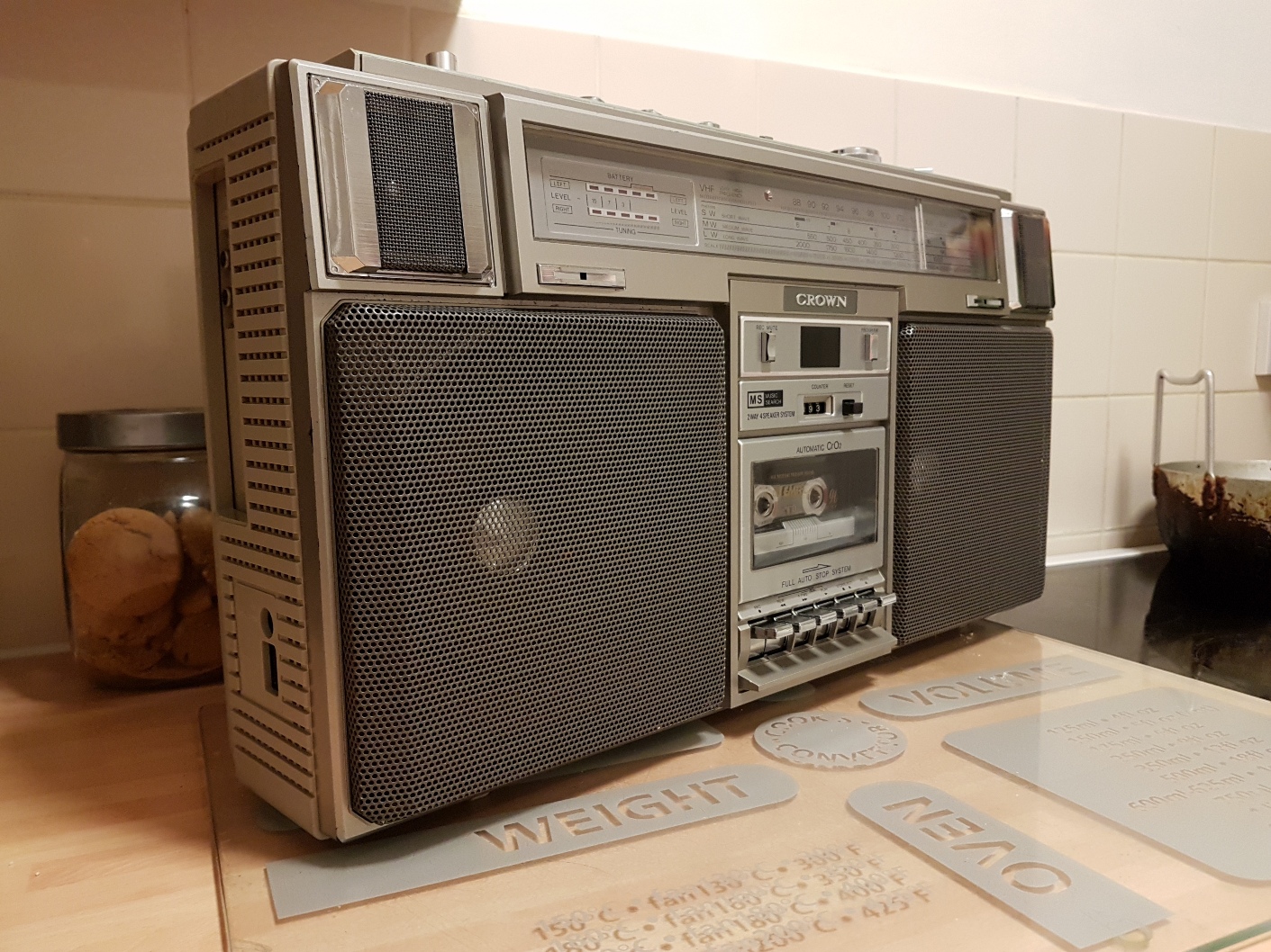

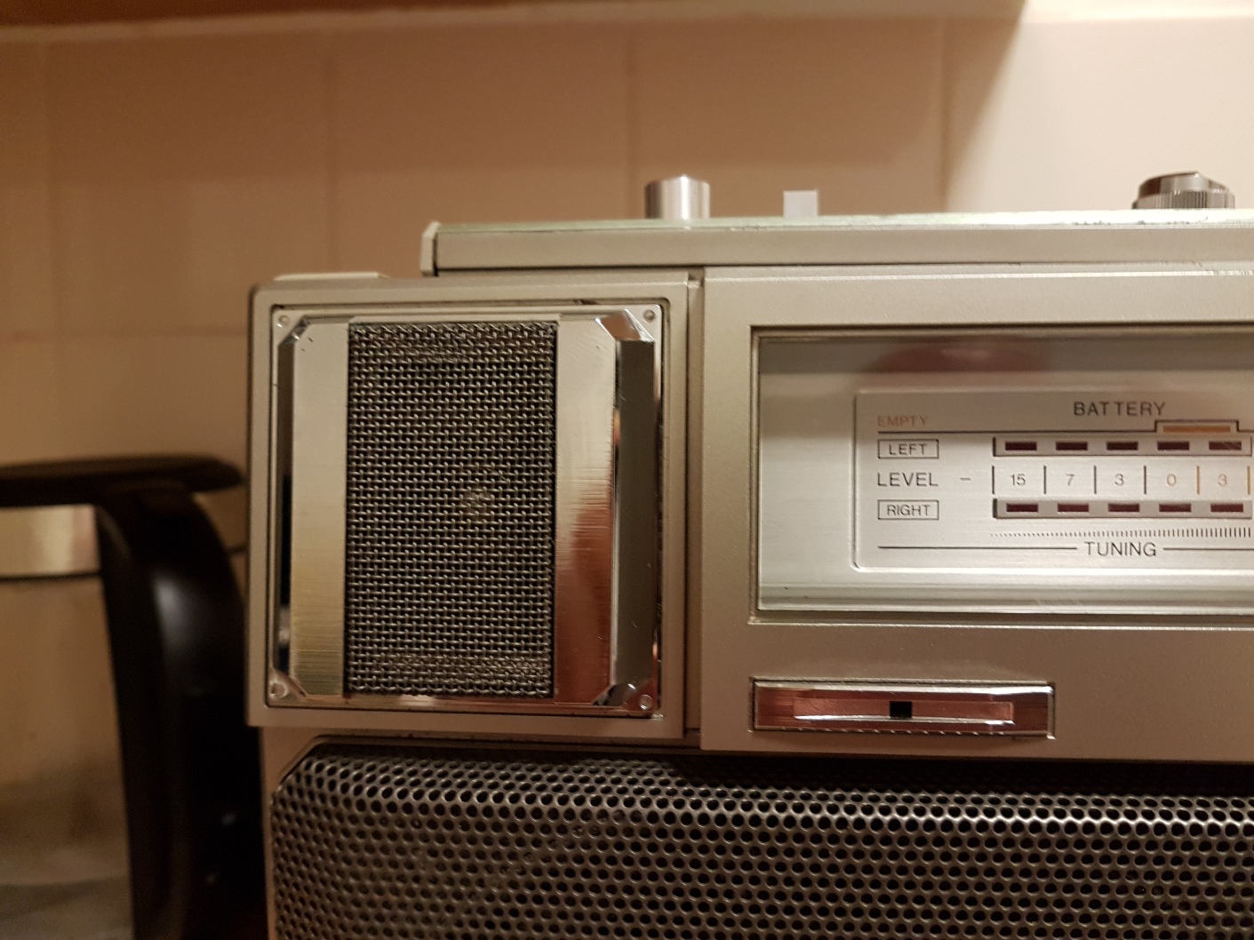

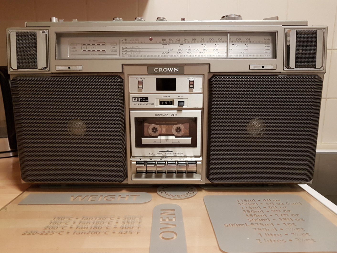

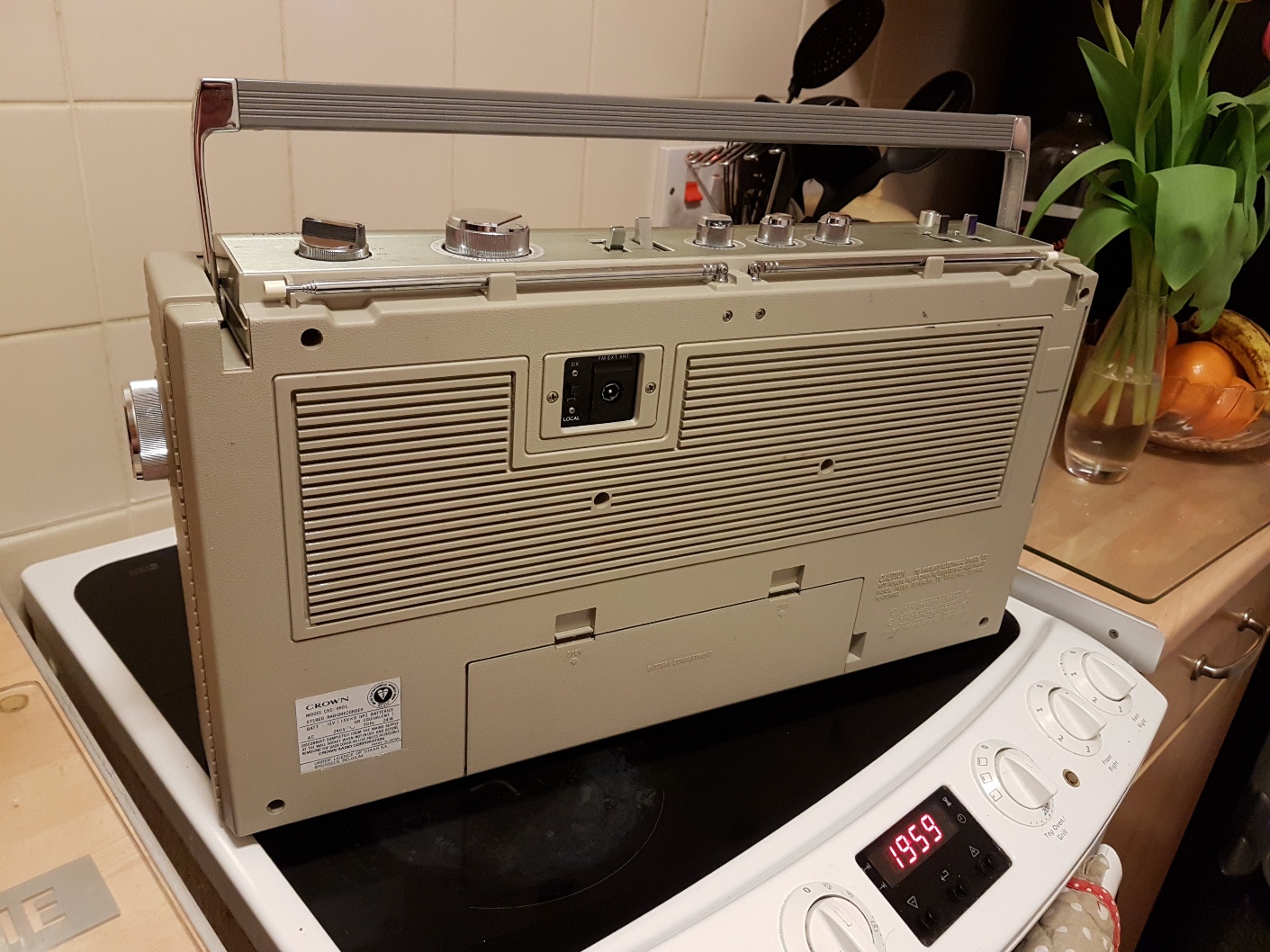

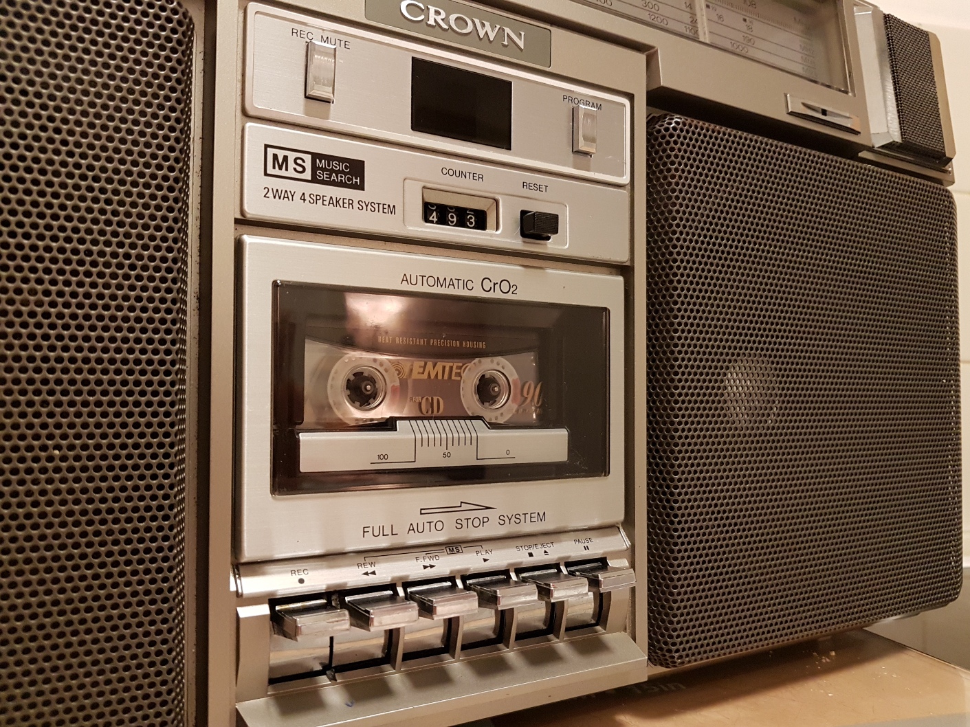

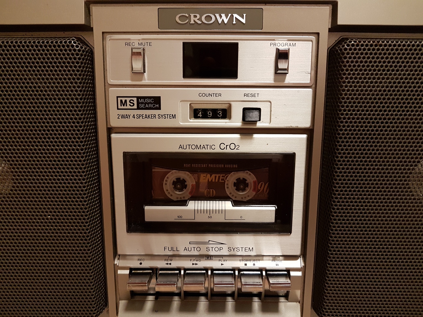

    We are now up to today :biggrin: cassette backplate back in, damped eject mechanism replaced with the better of the two, azimuth adjusted (only a tiny bit out) speakers plugged back in & front back on :biggrin: :biggrin: :biggrin:

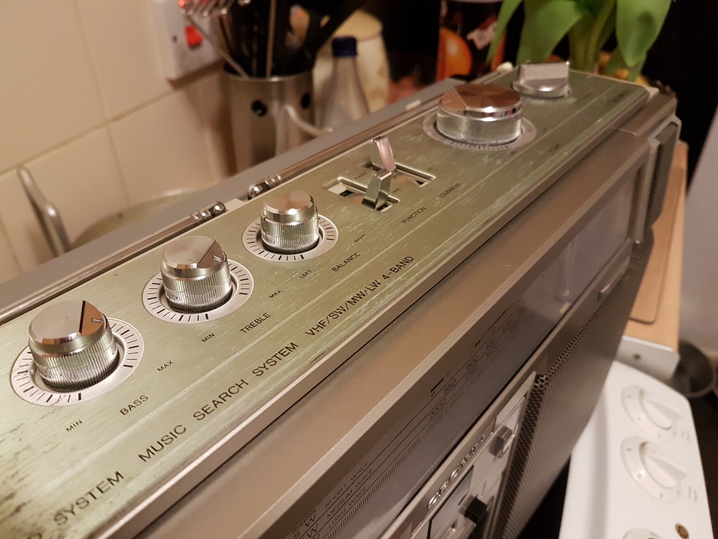

    A really good cabinet clean, top & sides, sadly there is some 'pitting' on the top panel, it looks like deep ingrained dirt to me but I don't want to polish the writing on the top, so for now it's better but not pristine!!
    Picture Heavy I'm afraid & many haven't made it onto here as this repair was a real pig!!
    Took so many pictures as reference :)
    These are just some (reduced size) that give you some idea of what it was like :lollegs: :lollegs:

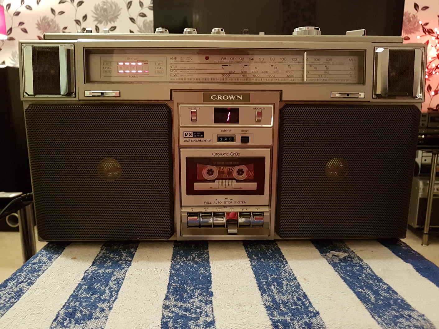

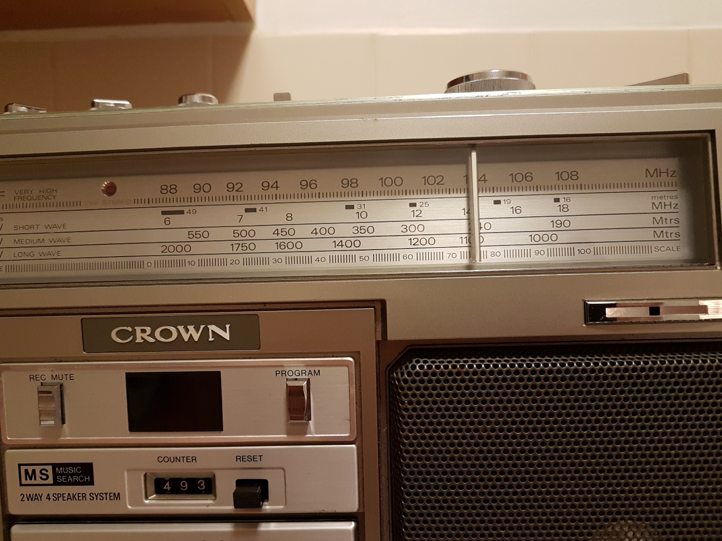

    I can laugh now & I am well chuffed to now have a fully working CSC-960L which sounds somewhere between the 850 & 950 & has the very beautiful Crown looks :reelspin: :reelspin: Good mechanisms once sorted - very stable playback & some nice led's of course
    Here is my CSC-960 people :bigthumbsup: :bigthumbsup: :bigthumbsup:
