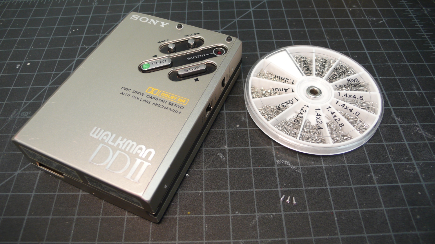

    For silver screws this would be your cheapest choice:
    600Pcs Set 12 Kinds Screws Nuts Assortment Kit M1 M1.2 M1.4 M1.6

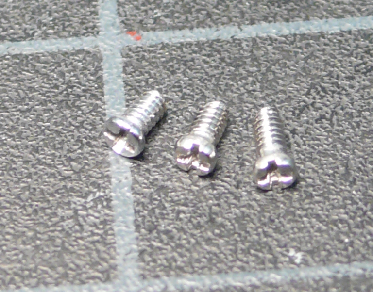

    Now that @mihokm finalized DD centergear today I received my first "real" DD Walkman, WM-DDII (D6 does not feel like a Walkman to me, its more like a cassette deck).
    original screw is on the Left, the ones from the kit "feel" different, the head is cut for both Philips and flat screwdrivers, heads look smaller, although still measure 2.0mm dia, maybe because they are slightly thicker:
    Fit perfectly though...

    these are the screws I got. the head measured 2.67mm across. item # 191542361181

    @turtle561 these are real nice! I think for the higher-end DDs these are the ones to use! Silver screws from my $4 kit look cheap
