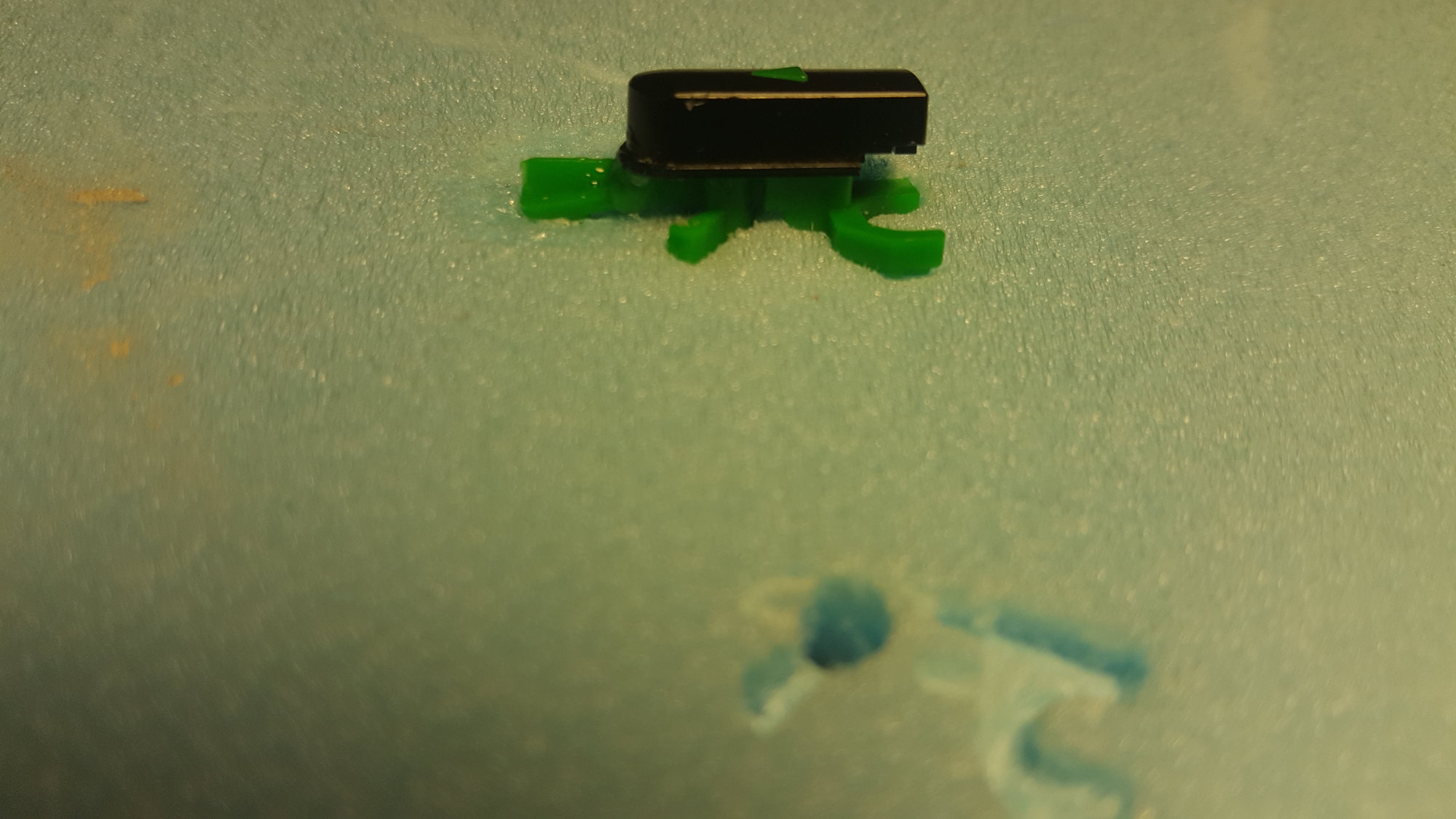

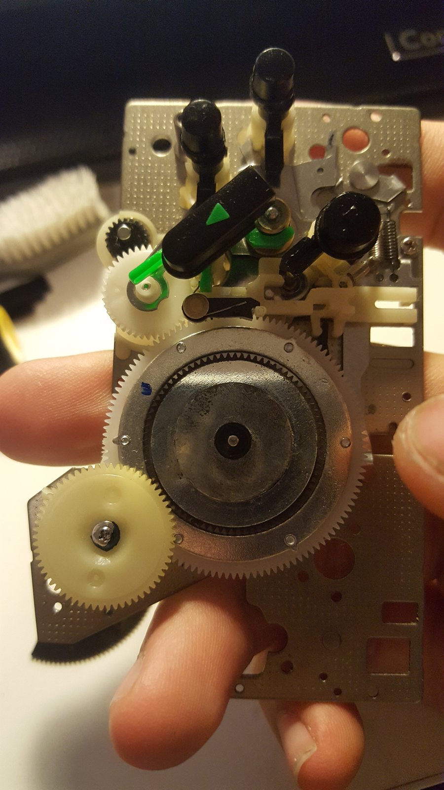

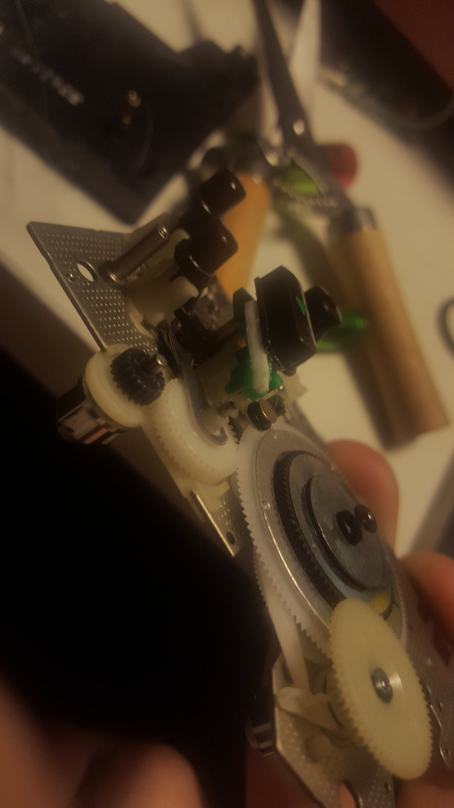

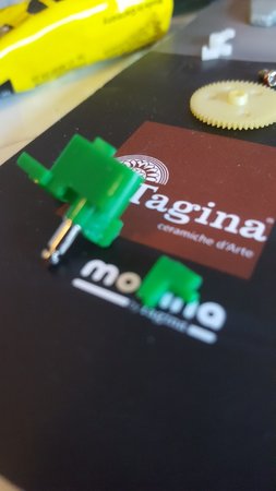

    I have hit a roadblock.
    The play button broke in 2 pieces, I can glue them back but I do not know of the proper orientation of the component that lowers one of the gears.
    I tried with a position that I thought made sense, yet it made no contact on the gear.
    Could anyone direct me to what an unbroken play button ressembles?
  13. matic777
    matic777 Member
    67
    Slovenia
  14. Command8
    Command8 Active Member
    375
    London
    Thanks, I'll see in a couple hours if I got the orientation right :)
  15. Command8
    375
    London

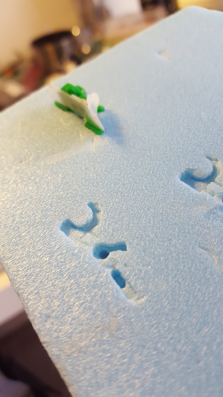

    Alright, made some major progress.
    Mechanism seems noisy, not sure how to handle yet.
    To fix the play button, used a Q tip as a crutch since the glue simply wouldn't bond properly on the pieces by themselves.
    Also repaired the battery cover which was missing a tab; used a tab from a DD1 with ended up fitting with a bit of sandpaper.

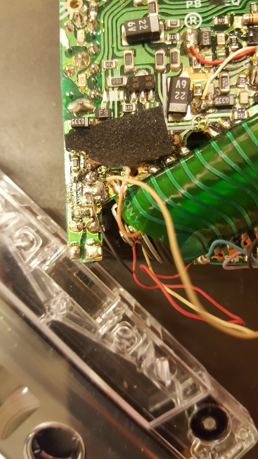

  16. Command8
    375
    London
    Brought the DC2 to my school, Started out well, resoldering in place the cables.
    The play and rewind functions were working the fast forward simply wouldn't remain in position after adjusting so I decided to let it be.
    Then the original problem of the machine came back. The problem which was that it would turn on, work and shut off randomly.
    I had asked @mihokm for advice before, he had said this was fixable by replacing the gear and additionally to replace the tire.
    Thinking that it could be a cold solder joint, I redid the negative cable which had disconnected before.
    This didn't work out well and had apparently made the battery heat up leading to a melting battery clip:
    I don't think I will ever fix this machine.

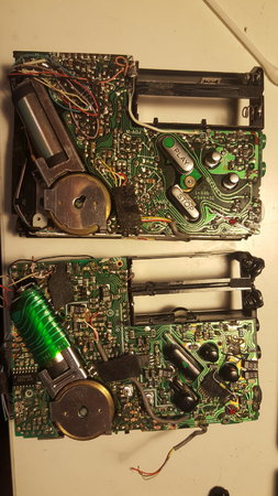

    Alright, ROUND 2!

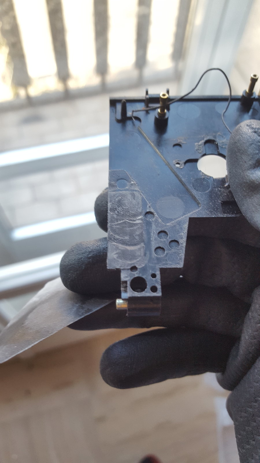

    Received my donor Walkman yesterday. Started the swap, I won't feel bad about doing this.
    Plastic swap was successful, only issue is that I am missing a screw port used to hold in place the DC2 extension pcb.
    I'll saw it out the dc2 chassis and sand down the base from the donor DD.
    /EDIT/ Sawing and gluing down the chassis was successful.
    As helpful advice to others, to smooth down the plastic use 80 grit sandpaper, and then use water sandpaper at 600 and 800 grit, if possible tape the sandpaper on a flat surface and then sand down the item flat to the surface.
    Suggestions , ideas, and mods are welcome.

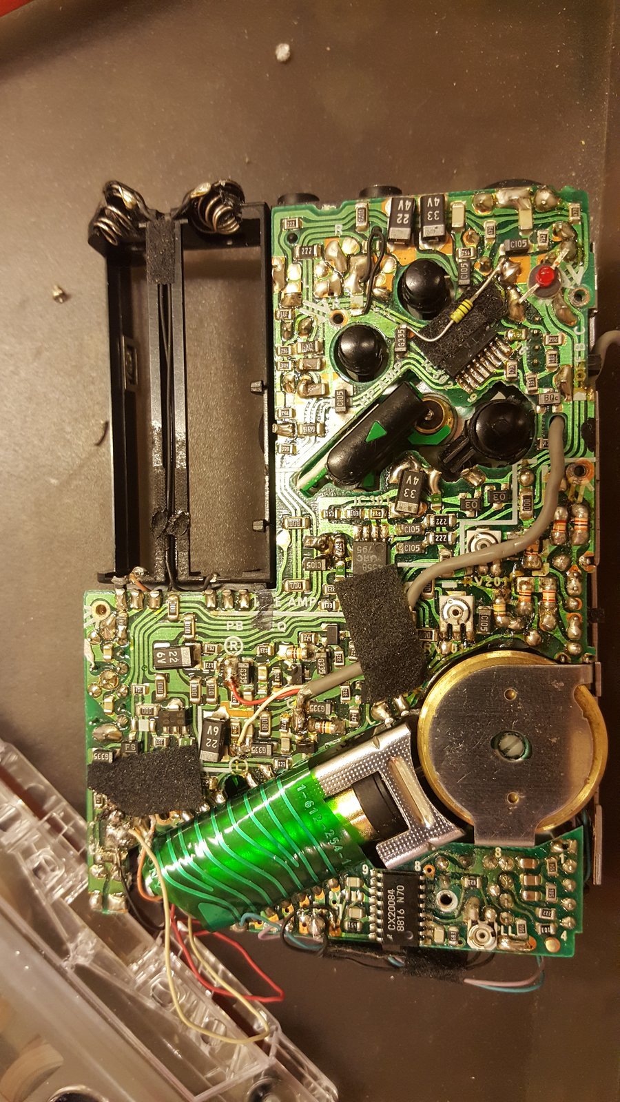

  19. Command8
    375
    London
    Yeah, i'm going to have to send it to a technician on this one.
    So I cleaned it up, made sure everything fits without any issues, compiled a list of things to do to the Walkman.
    What needs to be done:
    - battery terminal re-soldered on the pcb
    - play head; cable resoldered, azimuth calibration, tape path calibration, demagnetized
    - capacitors need to be checked for leaks, maybe also replace caps with higher quality caps
    -center gear; already replaced it as well as the tire but the gear must be aligned (for FF and RW to work properly)
    - tape auto shutoff problem fixed
    - contact cleaner on the scratchy potentiometer
    - lubrication of moving parts
    - servicing?
    After observing the list, I have come to the conclusion that it would take too much time and effort for me restore, repair and service the Walkman.
    Now I just need a good technician in Europe that does repairs well, is fast and most importantly affordable.
    I̶'̶l̶l̶ ̶u̶p̶l̶o̶a̶d̶ ̶m̶i̶s̶s̶i̶n̶g̶ ̶p̶i̶c̶t̶u̶r̶e̶s̶ ̶t̶o̶m̶o̶r̶r̶o̶w̶.̶
