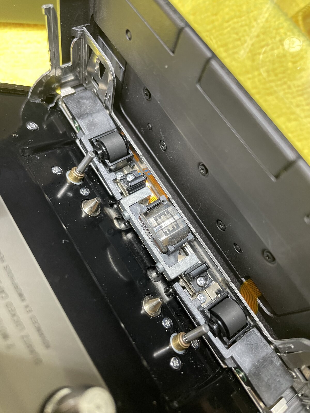

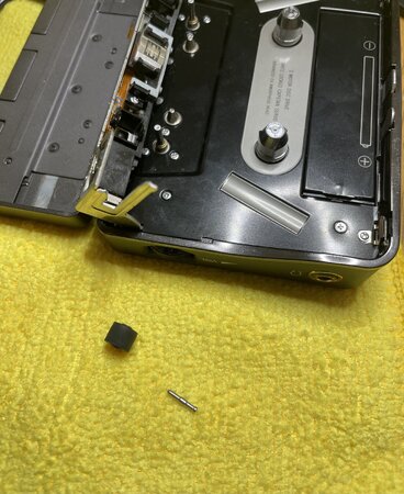

    Hi there nakamichi. When you mentioned “remove the lock” which lock are you referring to? Is it the washer that holds the pinch roller assembly in place? If not, could you kindly tell me which lock is it? Thank you in advance!
  12. isengard69
    isengard69 New Member
    4
    With regards to this, user nakamichi kindly replied to me via DM that the lock refers to the door of the DD9. This method has its risks (e.g. accidently tearing the ribbon cable that goes to the front of the lid), so it is advisible to be careful. Hope this helps someone.
    Here are some pictures of my successful replacement of the pinch rollers on my DD9:
    Emiel likes this.
