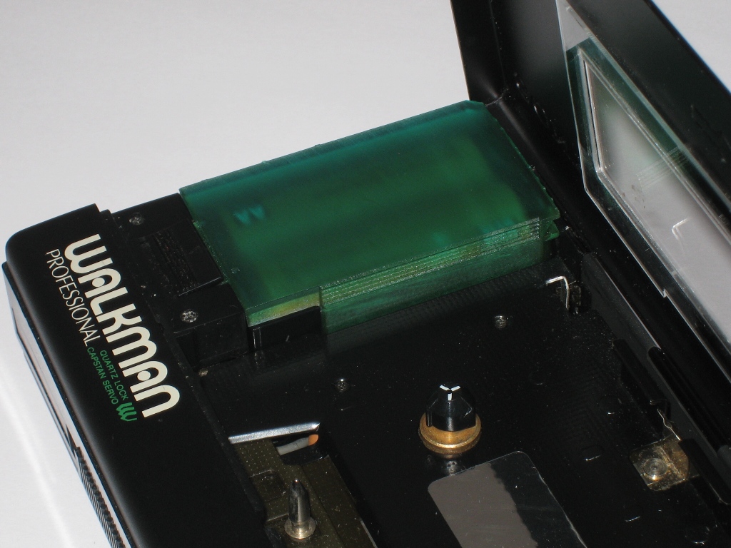

    Occasionally you get some nice surprises buying from Ebay. A couple of years ago I spotted a box of bits for a Walkman WM-D6C for sale. When I looked at the photos I noticed that there were parts of both a D6 and D6C shown so I asked the seller if everything shown was included; he confirmed that it was. I put in a bid and got the box for £35.
    The WM-D6C was rather beyond repair but has been an invaluable source of both parts and knowledge. There were a lot of D6 bits in there, however. Almost a complete D6. To cut a long story short, I have repaired the CP602 module (speed control), replaced a couple of faulty capacitors from the main board and replaced the mute module, belts, pinch roller and capstan tyre. The meter wasn't working so I replaced the driver IC. The clear window from the cassette cover and the battery caddy cover were missing so it now has one of my prototype windows and a 3D printed battery cover fitted. The screen print on the housing is a bit scratched as it's had an interesting life. The best thing about this particular D6 is that it sounds especially good. I'm not sure why; perhaps the head gap is a bit narrower than most, but there is something a bit special about this old D6 which somebody had previously given up on.
