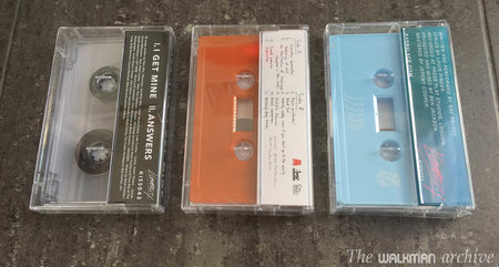

    A few days later a small package arrived:
    It was not very well protected, but the tapes arrived safe at first sight. Another inspection revealed that they were slightly damaged, with some small cracks here and there. Nothing serious, but there were there.
    The cassettes used were new and coloured ones:
    They look like some sort of cheap ferric ones, due to the tape colour:
