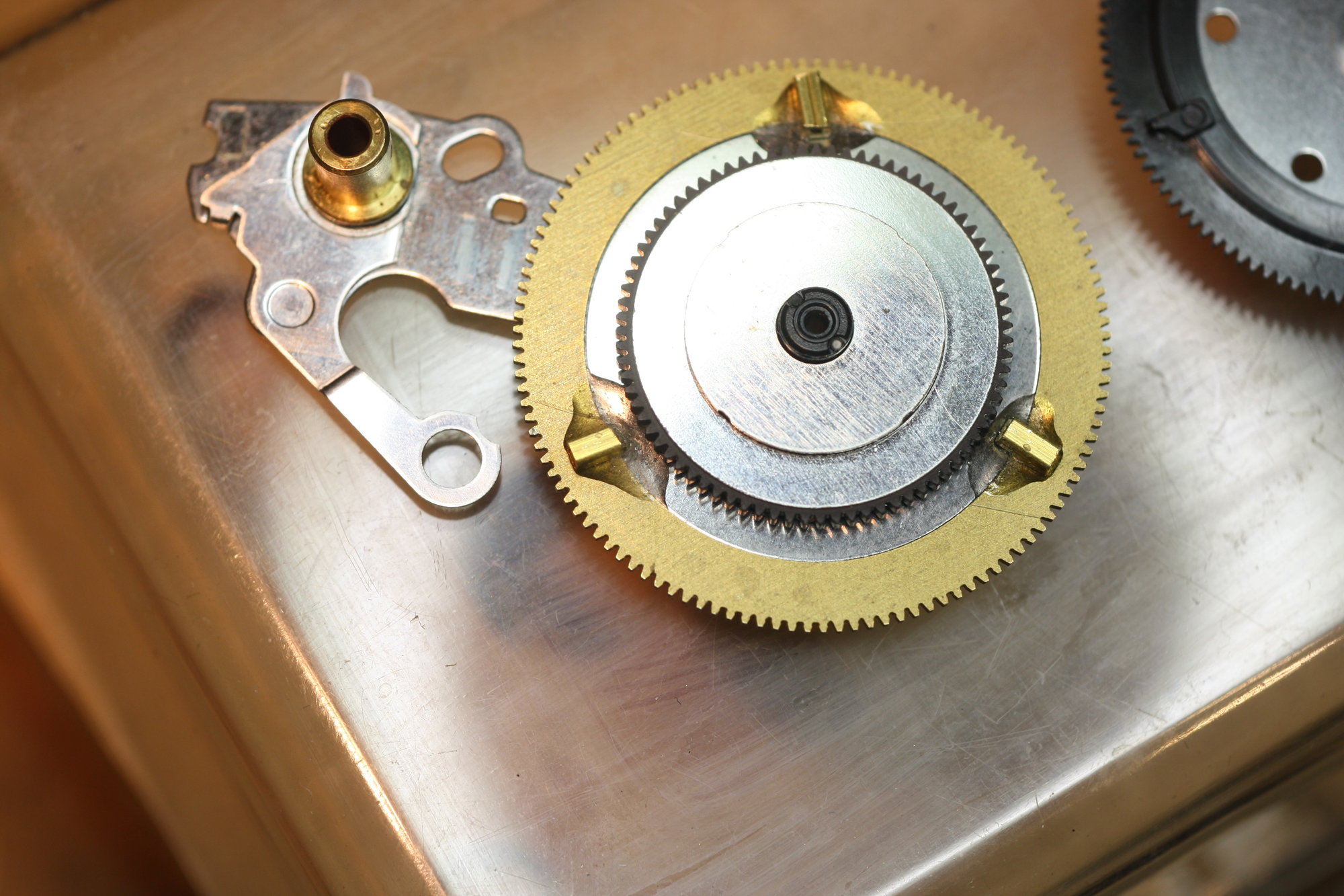

    Hello guys,
    I'm glad to announce that the first working prototype of newly made center gear is here.
    It's just prototype, made of brass, not plastic. It is also missing parts necessary to fix it to the original metal ring.
    I used epoxy glue, instead. It works fantastic, even after playing 3 cassettes on my WM-D3.
    There is still long way to go. They must be made of plastic. Metal would wear adjacent plastic gears quickly.
    With Philip, we're trying to find way how to make it. It's not easy and not cheap. Even 0.05 mm difference in size will cause problems. It needs lot of time and money but there is progress.
    I'll keep you informed.
    Marian

    Would Brass be that destructive to the other gears?
    What are the options moving forward? Using the brass to create a mould to then be filled with an appropriate material?
    When you say its missing parts, do you mean a collar for either side?
    Perhaps if all the gears that this gear came into contact with were also of the same material, that would take away the issue of wear & tear. You could argue that this would create a friction issue, but the same principle works fine for watches etc. Just wondering if thats an option. I have yet to take a brave look inside a DD so basically have no idea what I am talking about.
    Anyway, this now has me looking at my large collection of DD units and knowing that a longterm solution is not that far away.
    I have a formLabs PLUS SLA printer. Annoyingly, the teeth are just a bit too fine to use their tough resin, which would have been ideal.

    Wow cool! I do agree on doublecee about the bras.
    So if I counted correctly the gear has 120 teeth?

    I hope I can finish this project.
    I studied technical engineering school, then I Technical University (Radioelectronics) and now I work as computer specialist and java developer.
    I have all skills to prepare technical drawings, doing CAD designs, etc.
    The design will consist of one gear and two rings and three screws. These dural rings and screws will be used to fix the gear to the metal disc.
    Now, it is necessary to have 1:1 prototype done and tested. If all is OK, then I can order model production and then final mass production of plastic gear. Together with my friend Philip, we're working on it. He's searching for producers in US and I'm searching in China.
    It would be fine to sell this self-repair kit for acceptable price so that it would be available for everyone.
    Brass material isn't the best for this design. It wears quickly and it would wear all adjacent plastic parts. I will reopen my WM-D3 and see what damage it did.
