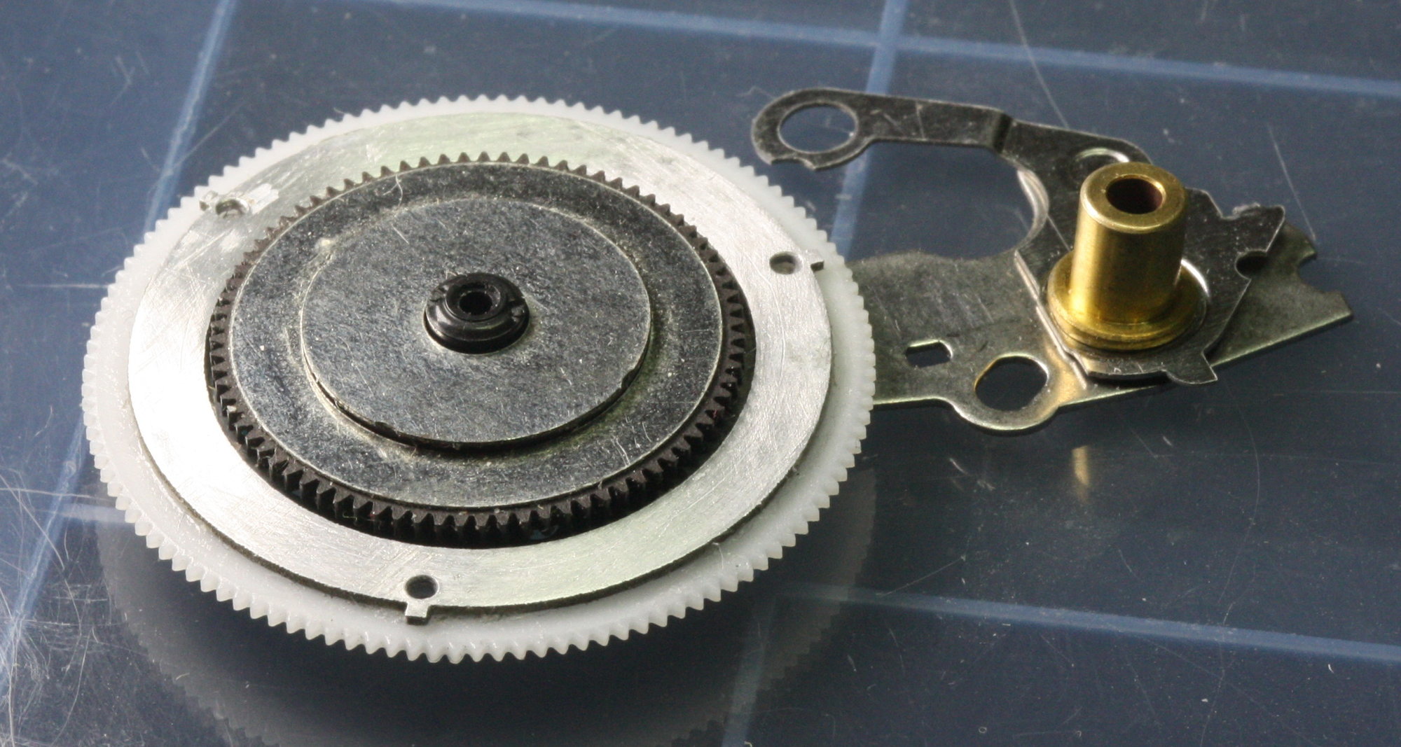

    I did experiment. I removed the brass gear prototype from WM-D3 and I checked what damage it did to the adjacent plastic gears.
    I was surprised because I didn't find and sign of wear, even if I looked to them through magnifying glass. May be brass version could be also alternative.

    I received new gears. Here it is how it looks when it is installed, together with the support rings.
    This gear is fully functional now, but....

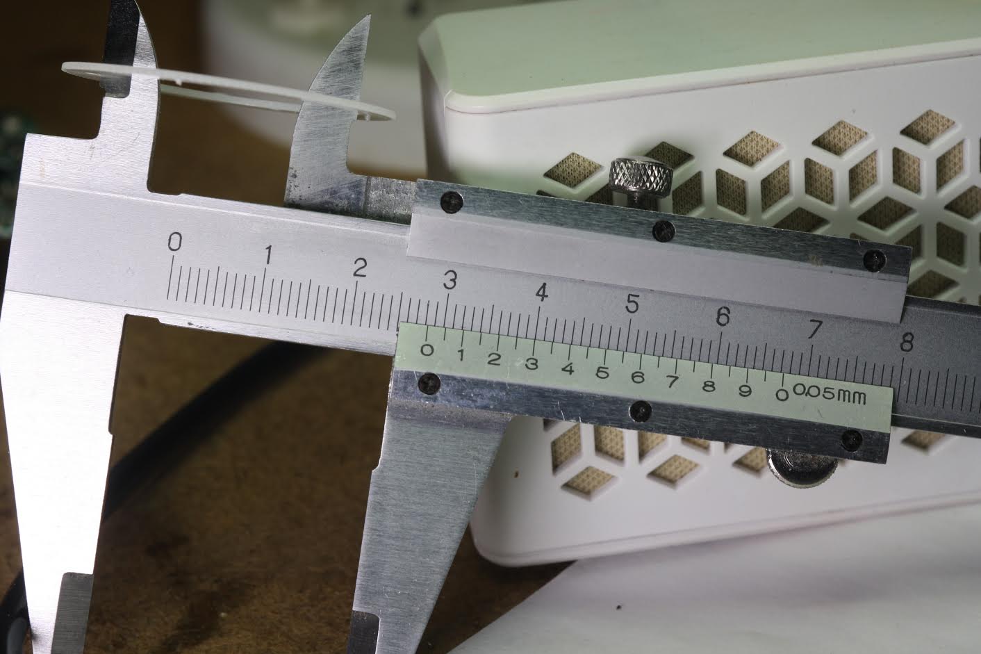

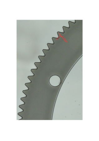

    Unfortunately, life is not easy and the gears and support rings are not perfect. Gears are nice and smooth but producer made several mistakes in dimensions.
    1st. - teeth height is smaller than it should be, by 0.1 - 0.15 mm:
    2nd. Internal gear diameter is 28.3 mm instead of 28.1 mm, which makes gear eccentric, when installed on the metal disc
    Result: gear is too noisy

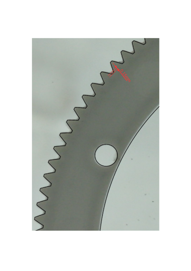

    I'm back here with small update.
    I received new samples. These are much better, the tooth height is almost the same as original. I'm sure this one will fit.
    Final gears were also produced and they will be shipped to me in 10 days. In 3 weeks they will be here.

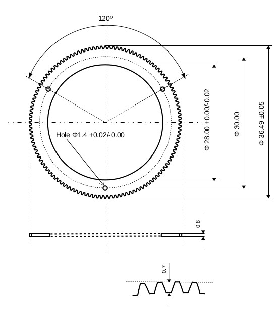

    These are bigger problem. One of them is too thin - only 0.25 mm. At this thickness, the material has to be hard and strong. The first version was made of dural. It was very bad choice - the rings were very soft, thread for M1.4 screw was also not strong enough. New version, that is currently being produced, is made of steel. I still don't know, what will be the result material. Titanium would be the best but who will pay for it? Here I need your advice. What do you suggest?
    Also, countersunk screws must have reduced head width. They must be similar to ones that are used in DD models to fit FG/capstan part. I cannot find such anywhere.
    I'm attaching gear drawing, for those who want to experiment :) I think 3D printing technology is not prepared yet for this precision but may be I am wrong. gear_drawing.jpg
