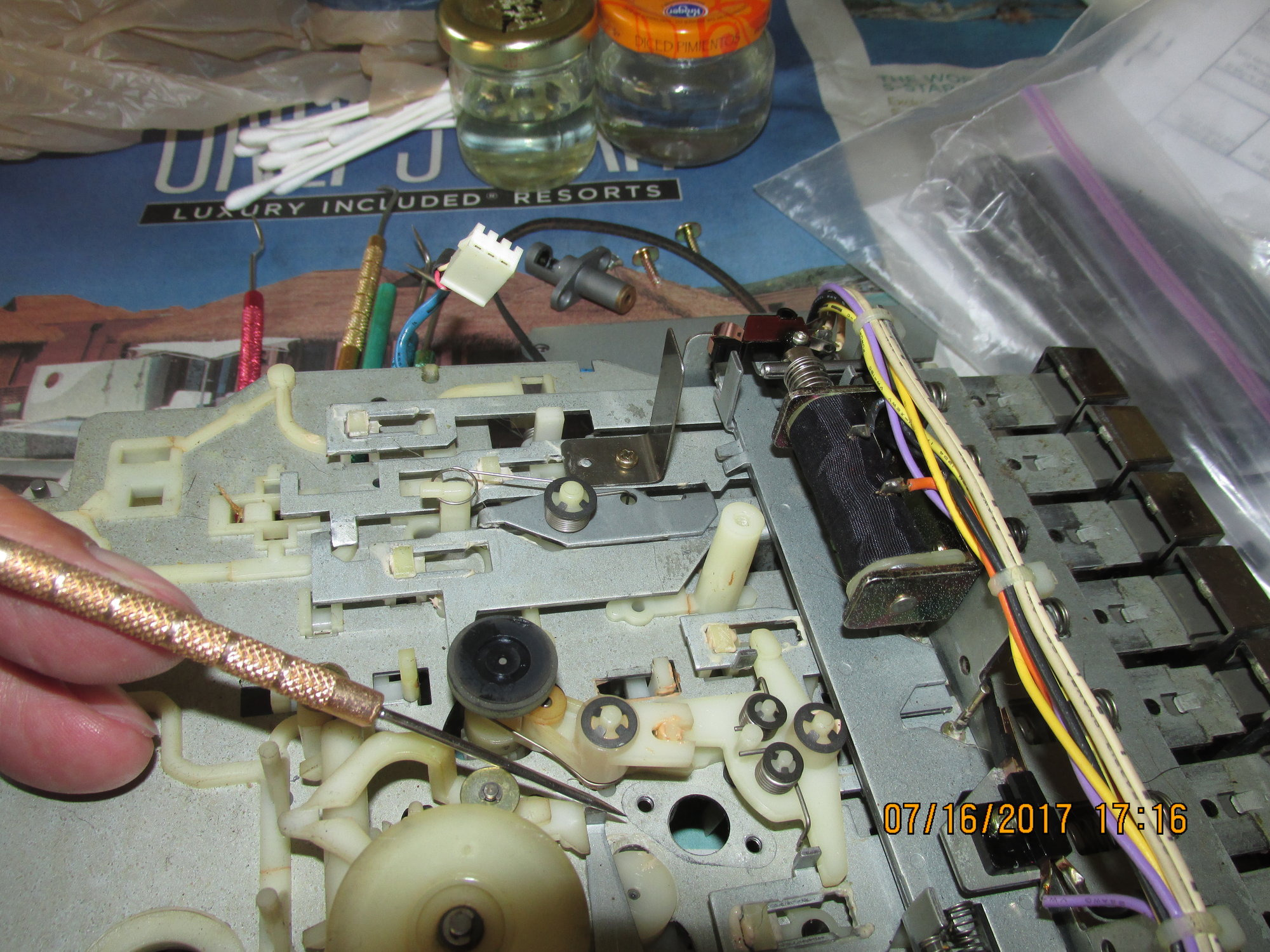

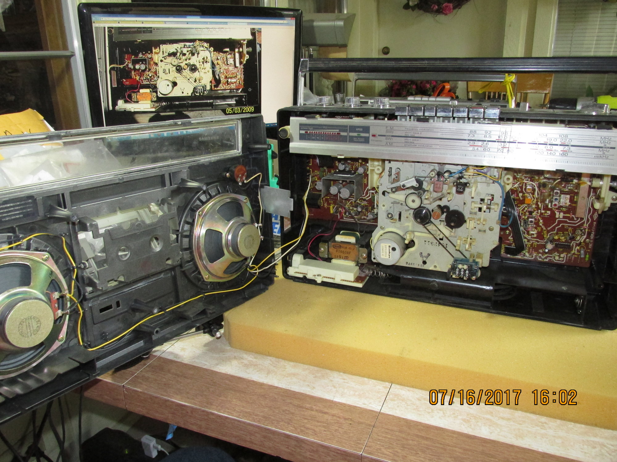

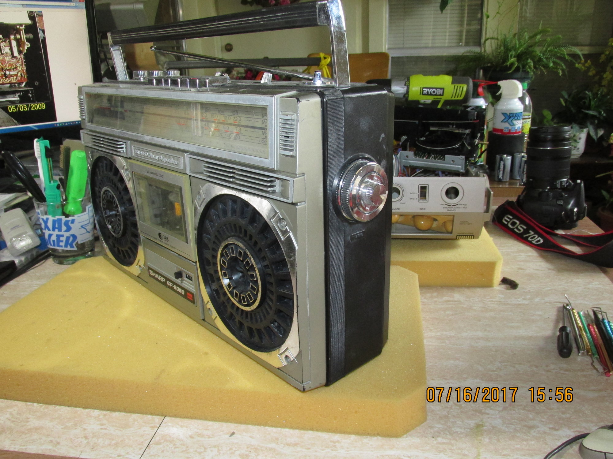

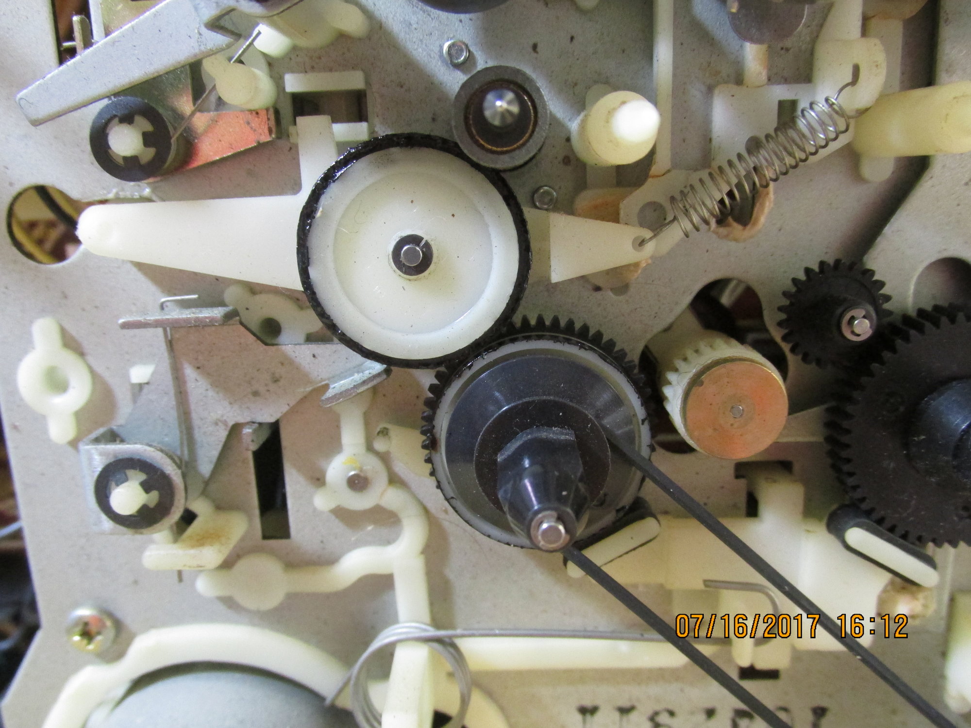

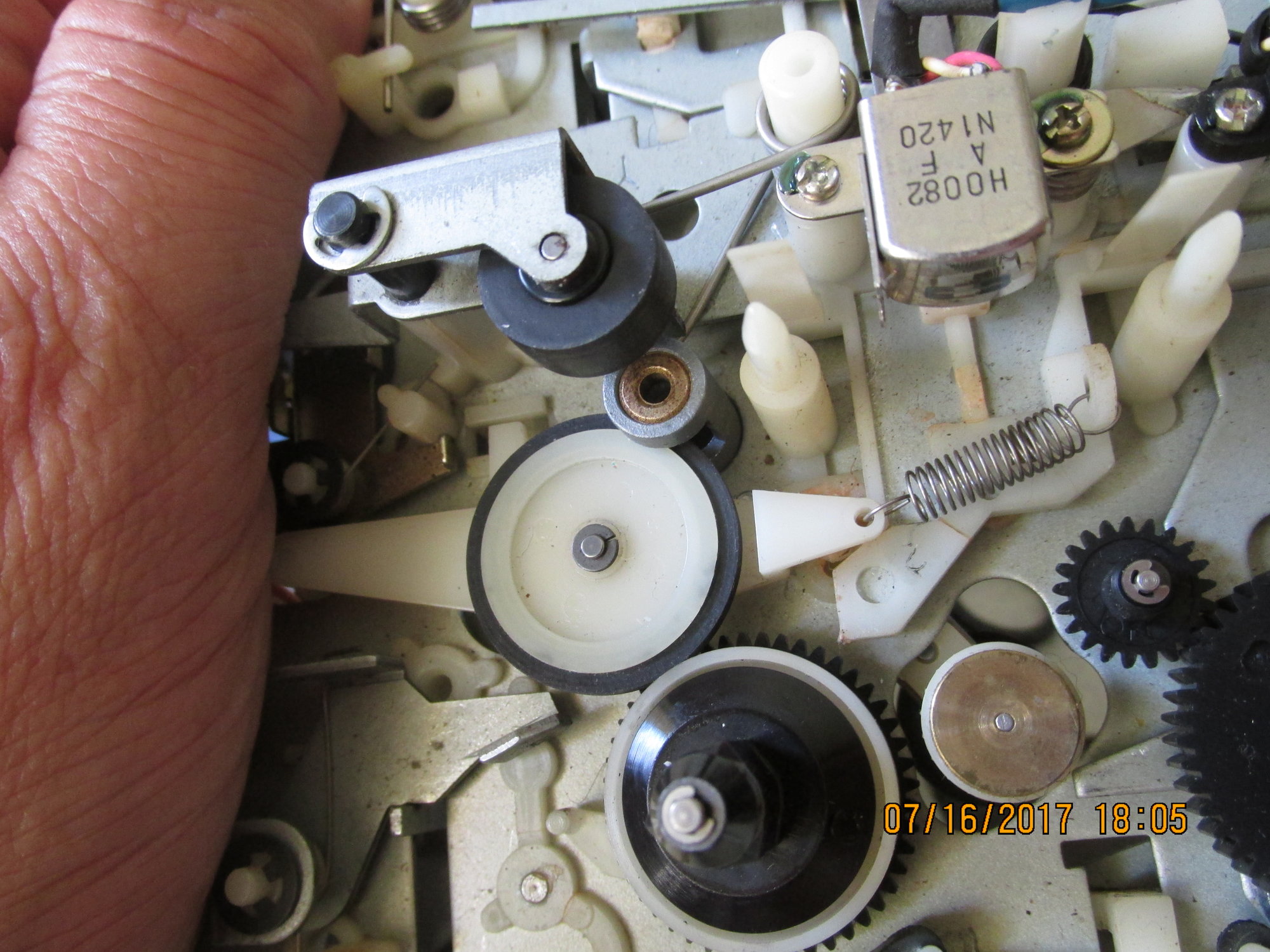

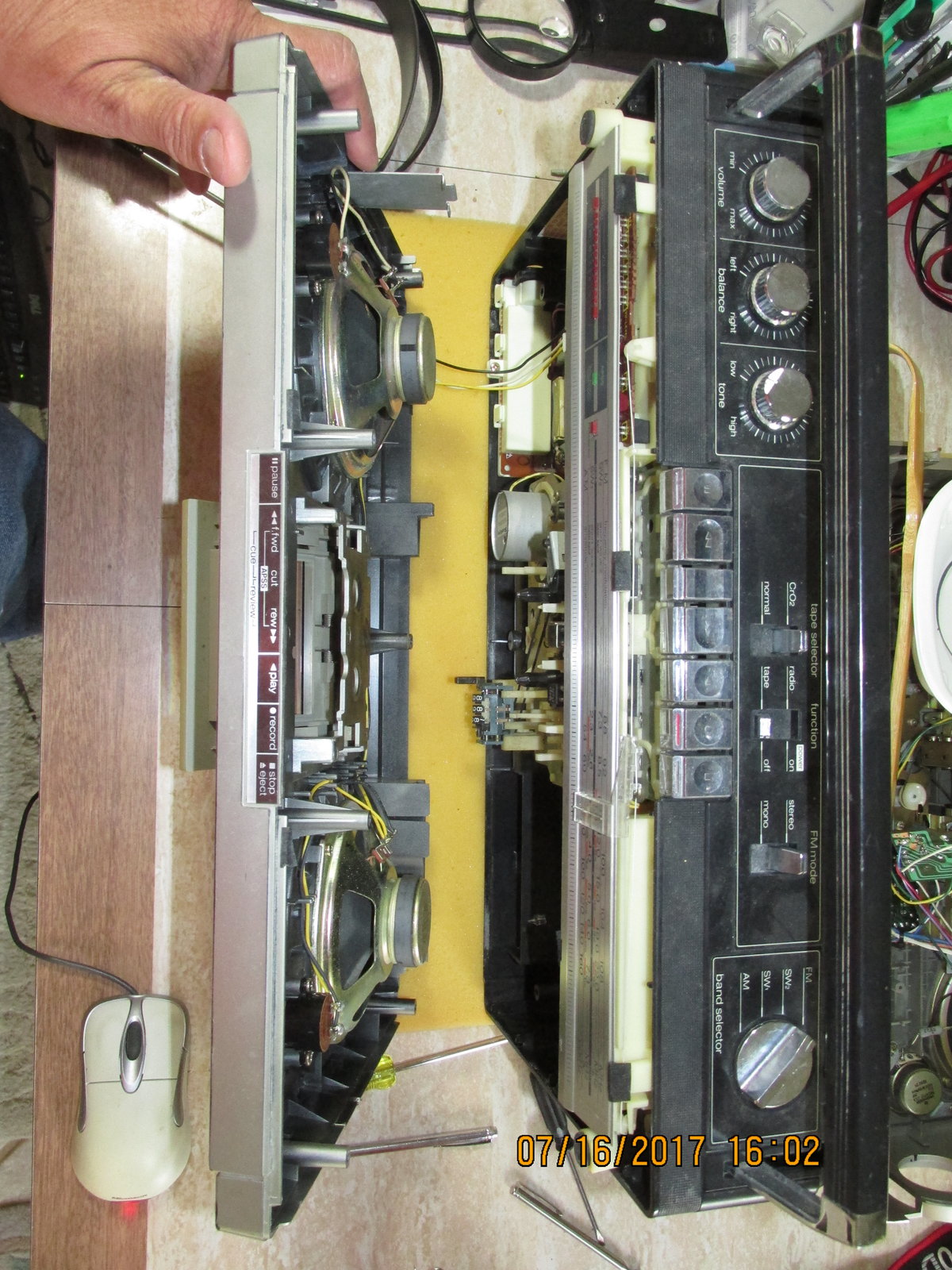

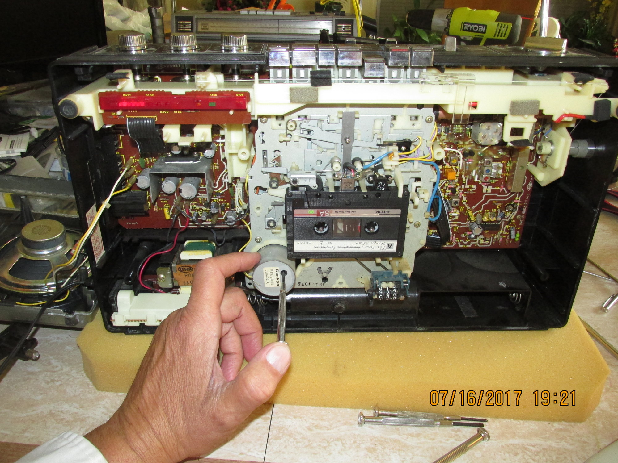

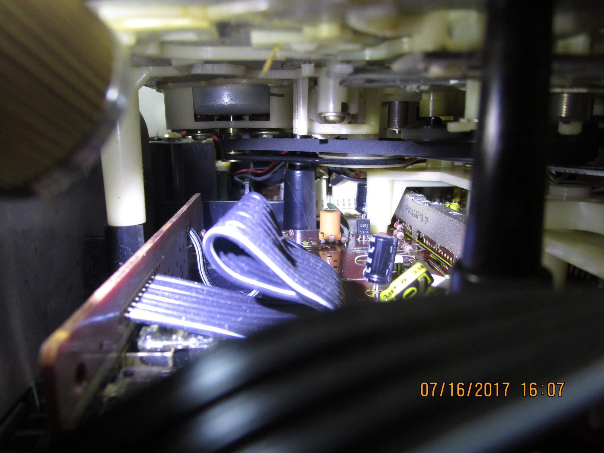

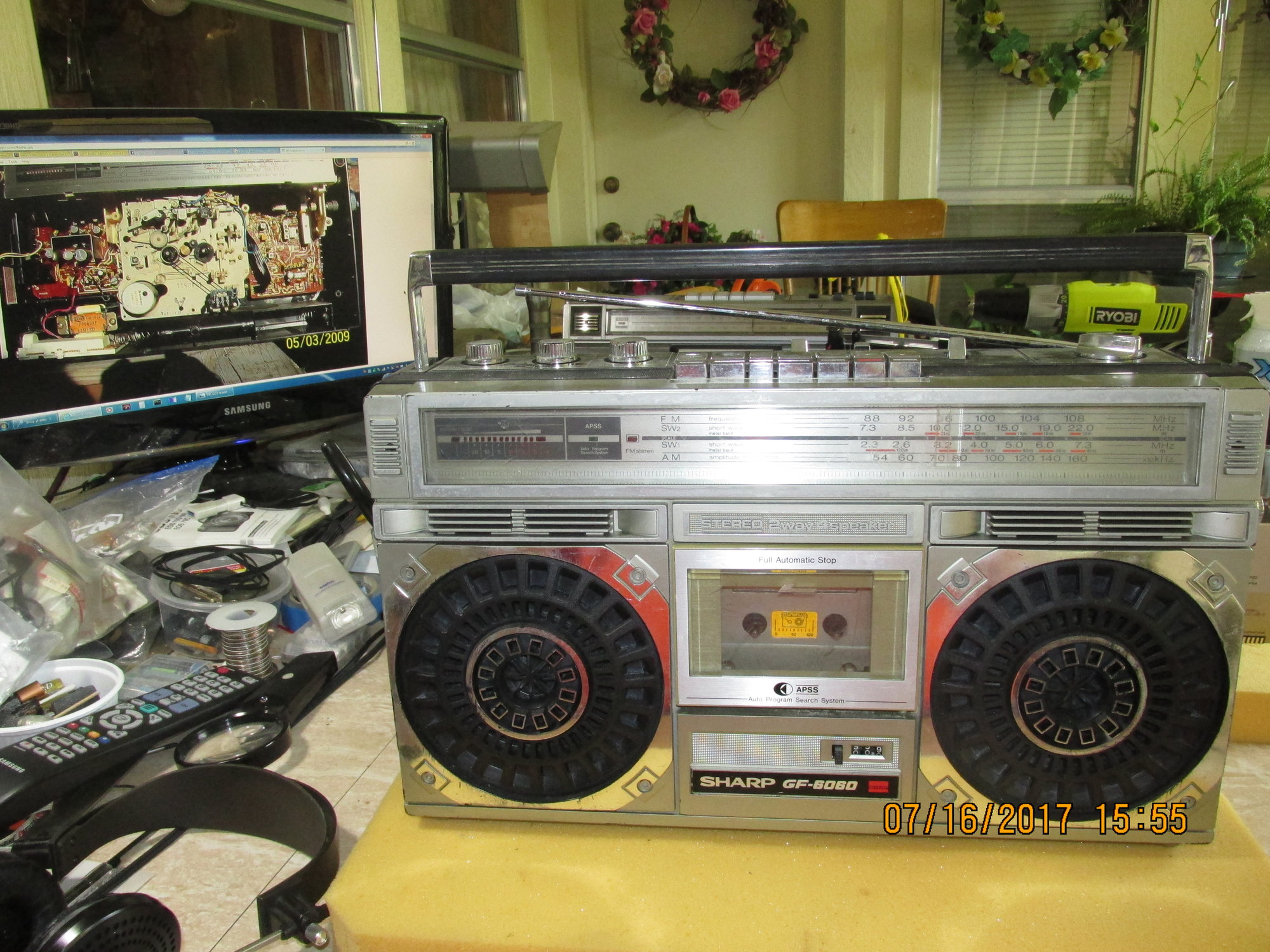

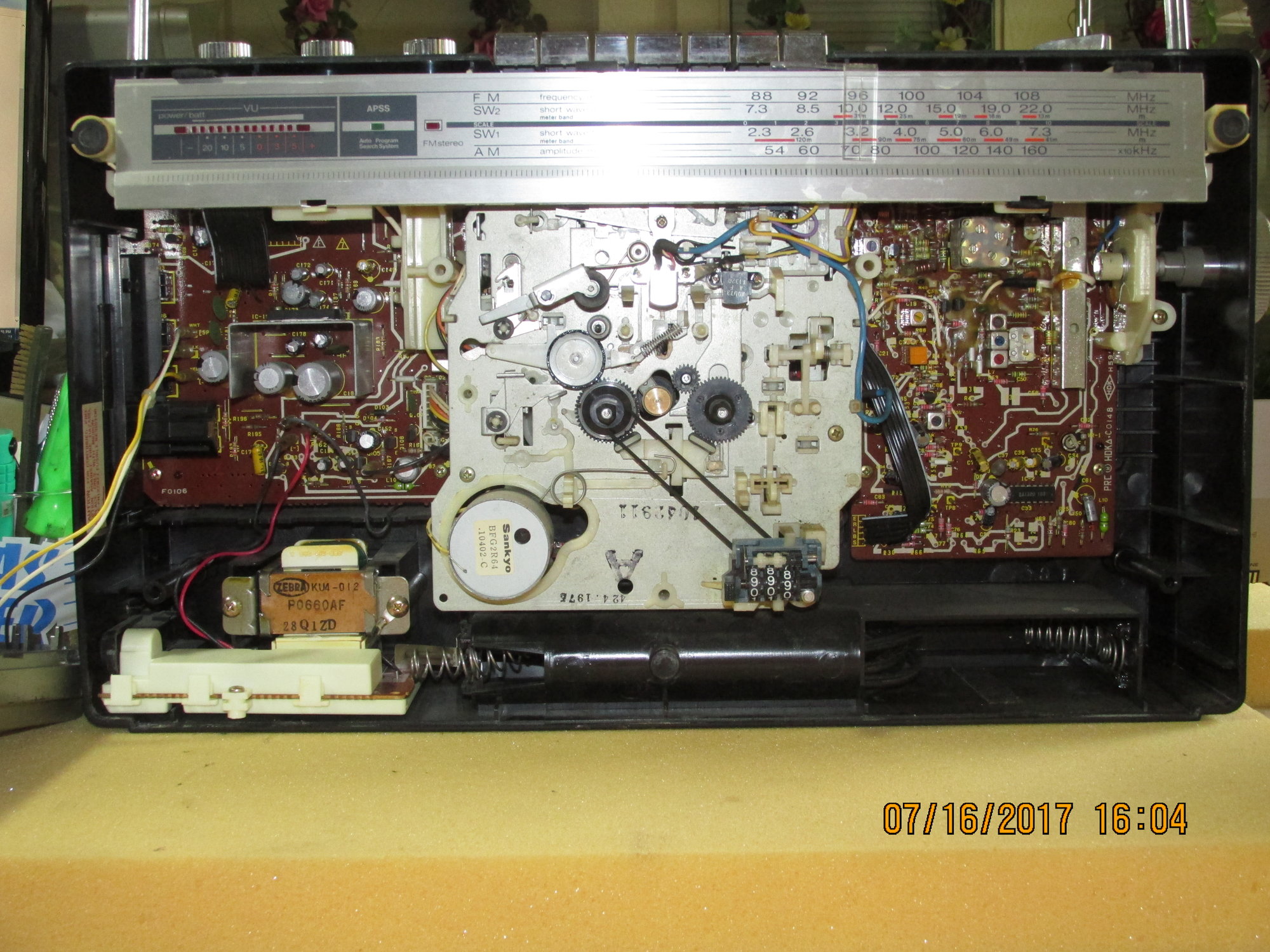

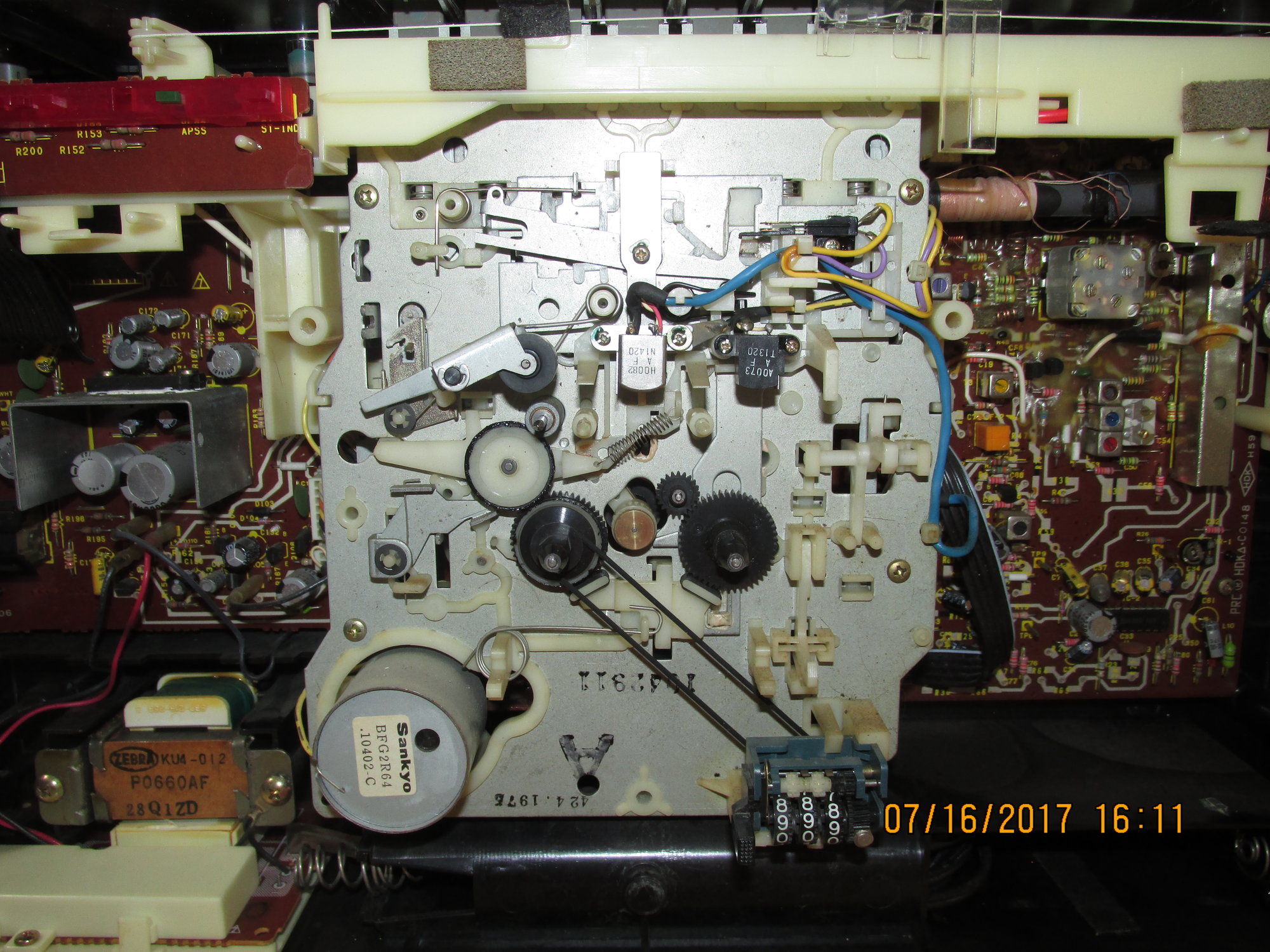

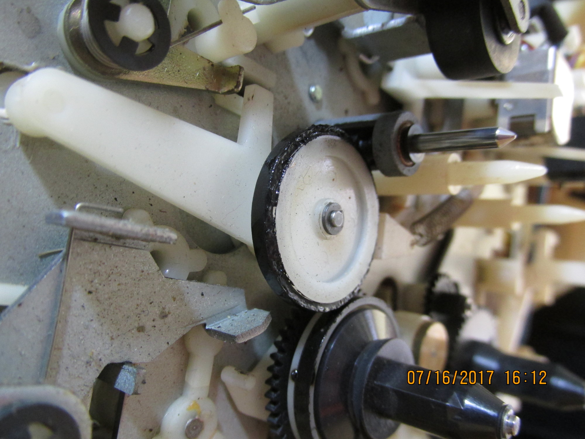

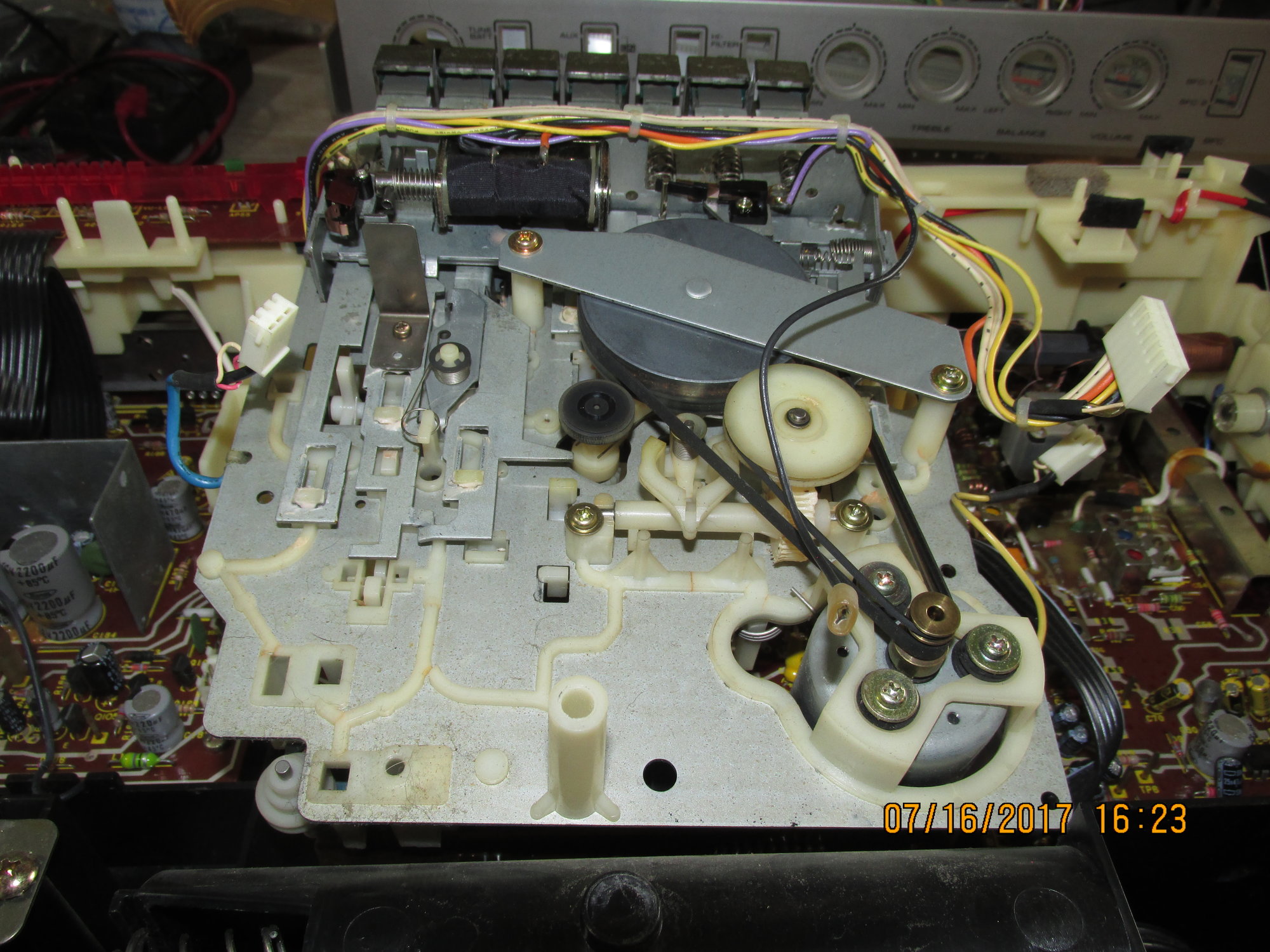

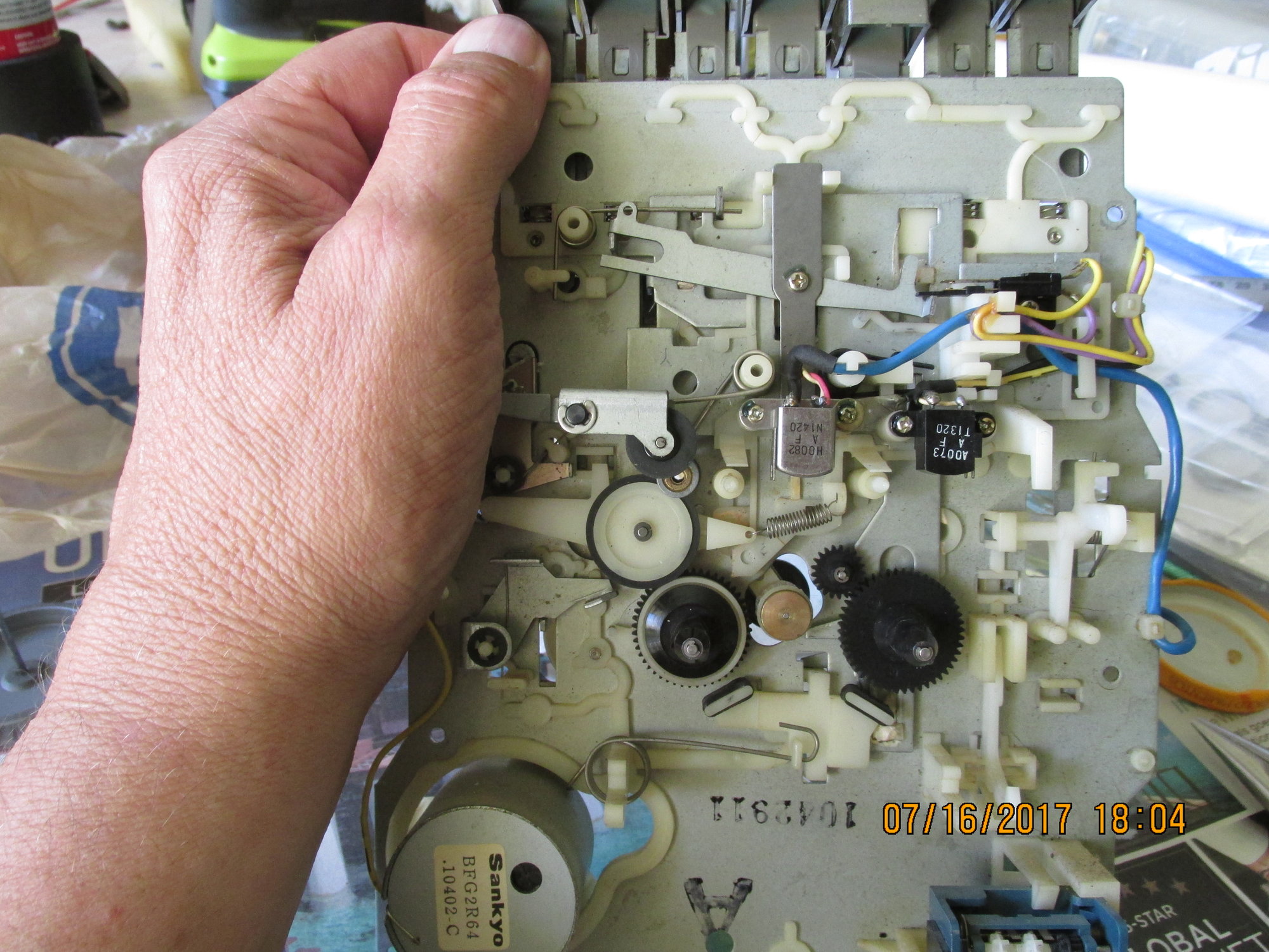

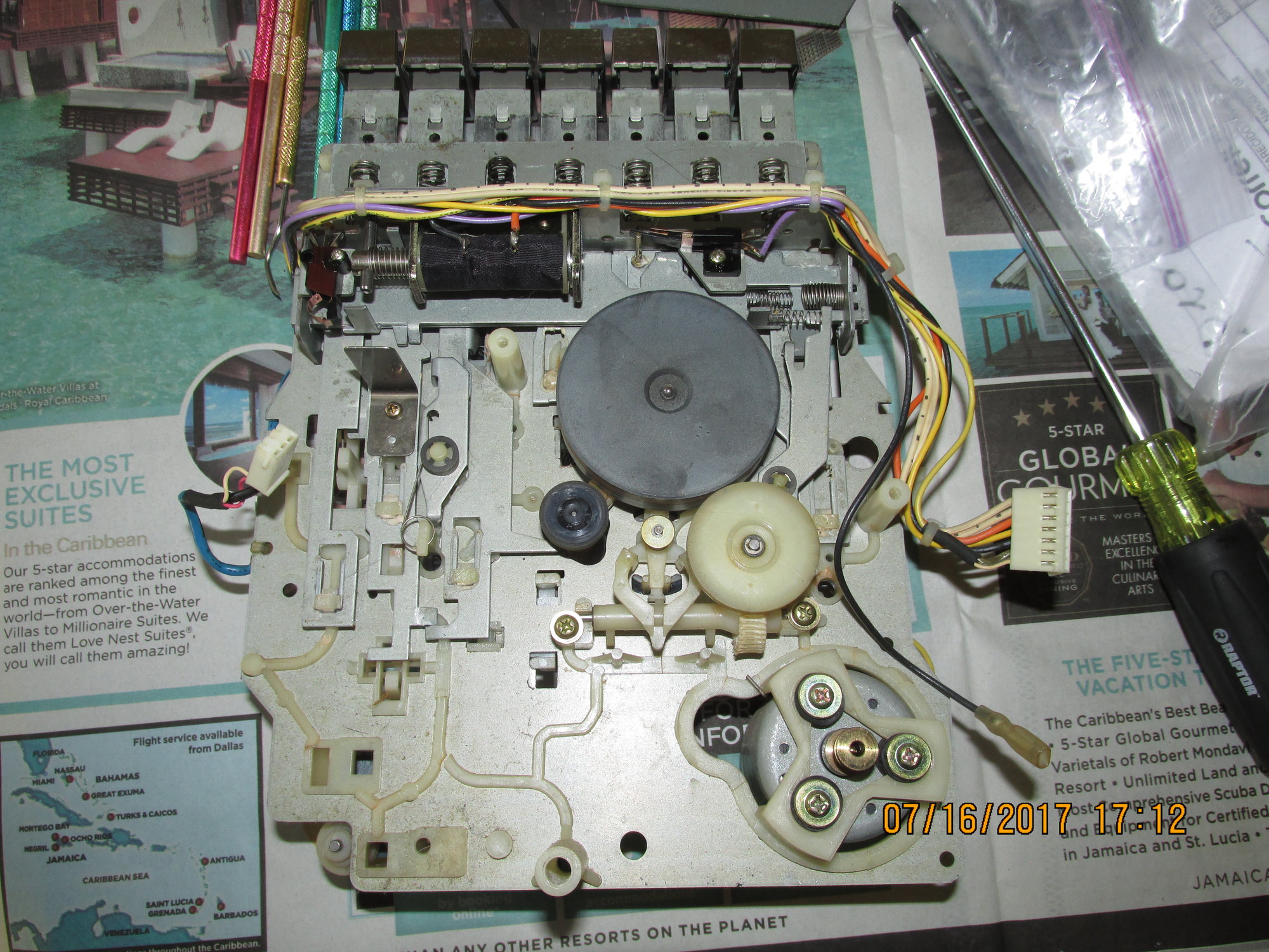

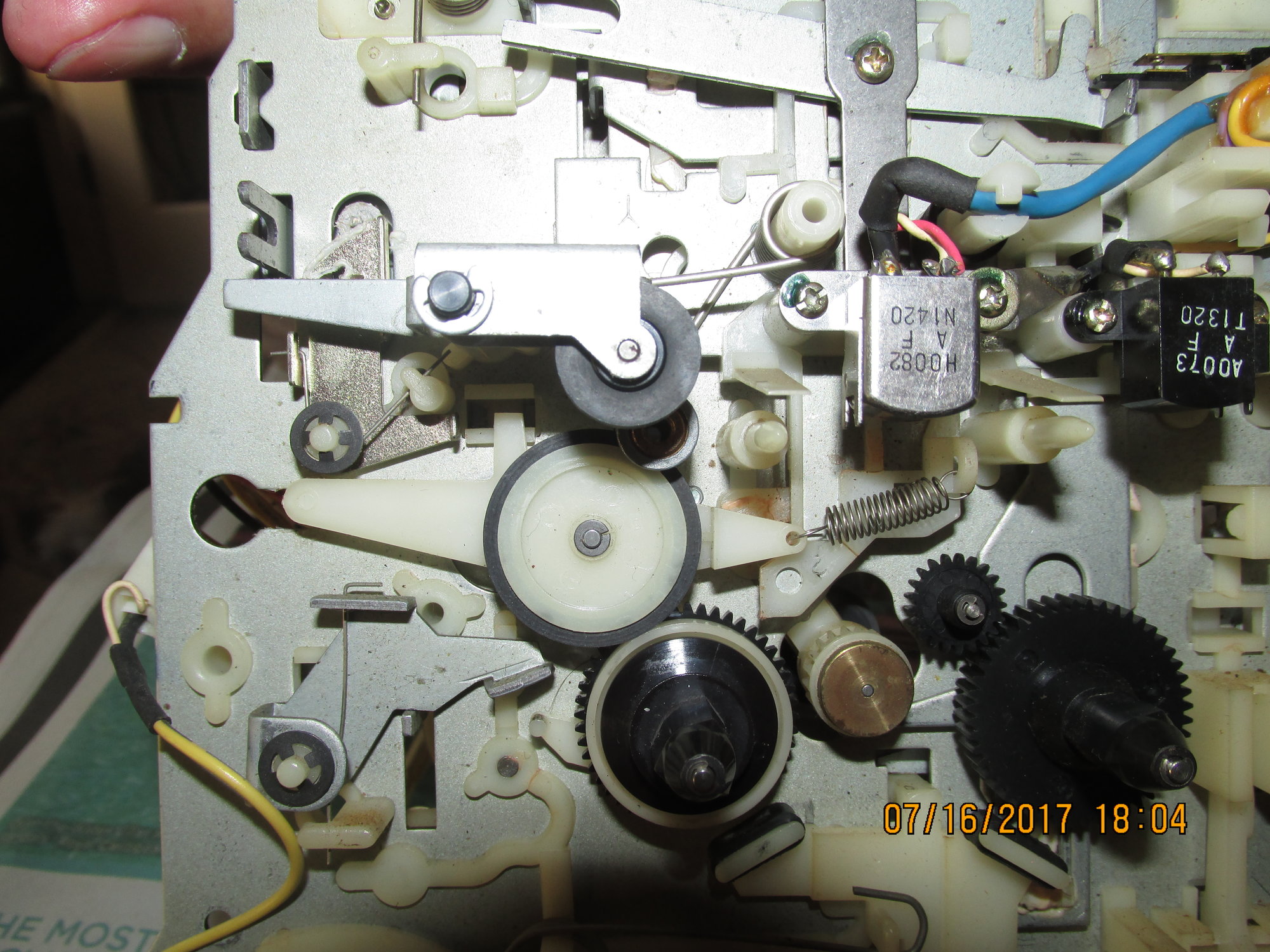

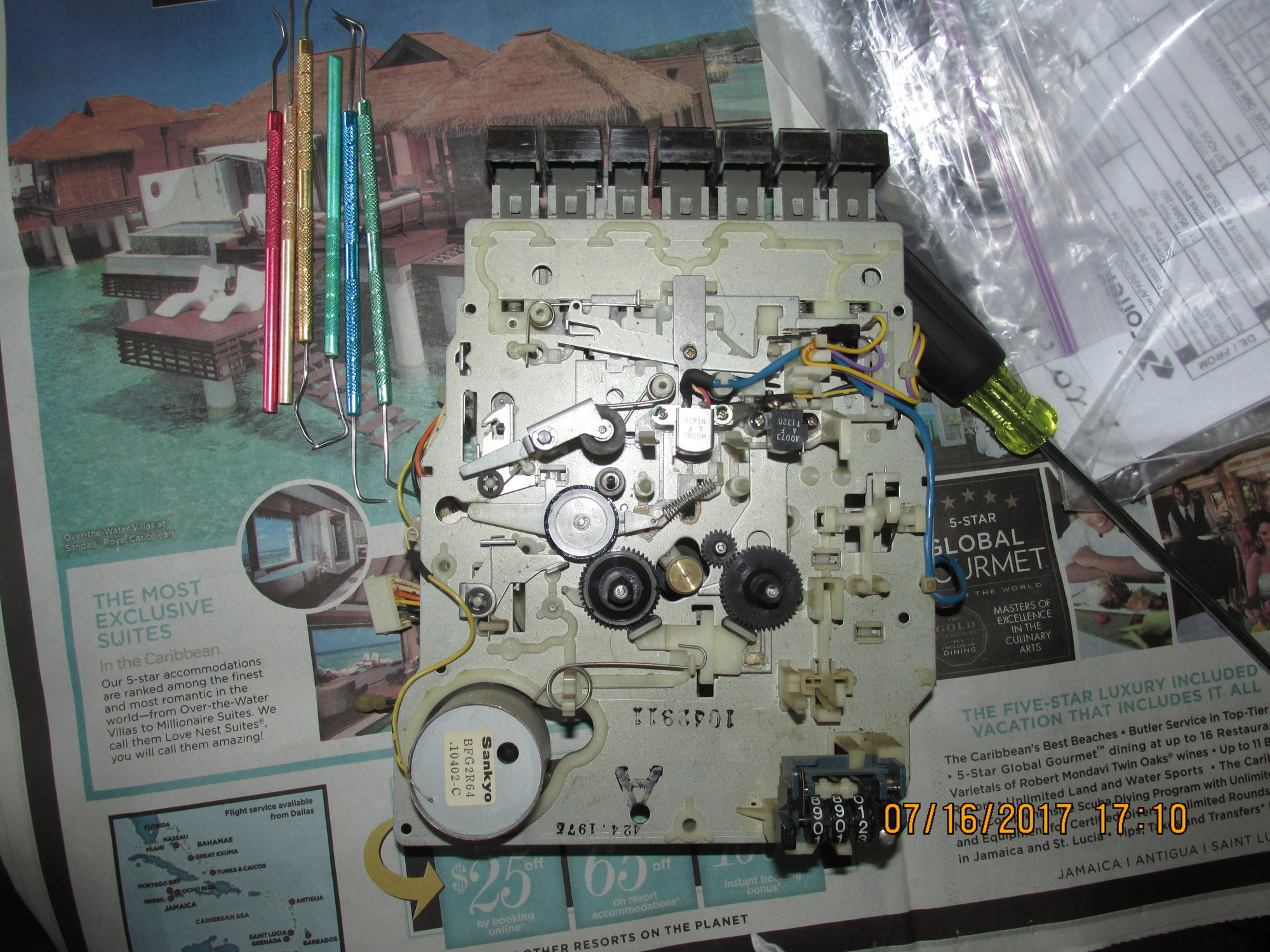

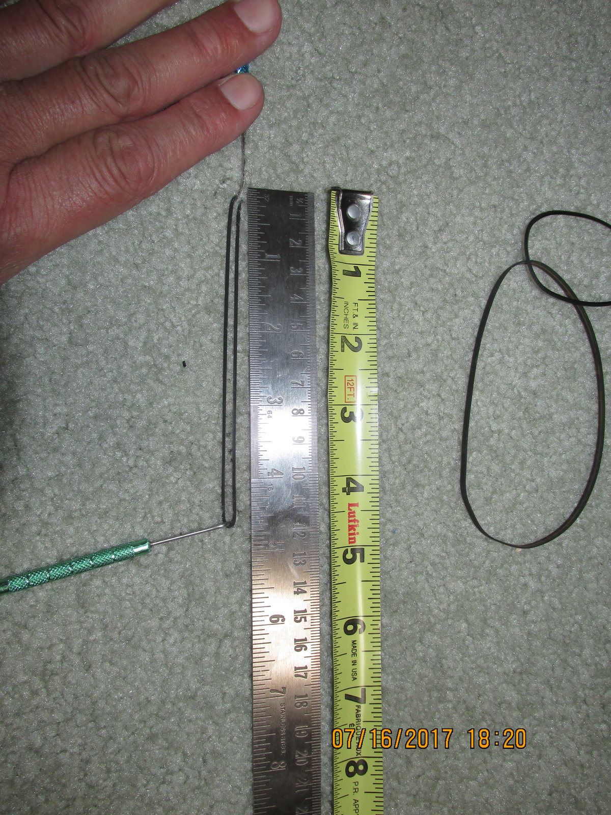

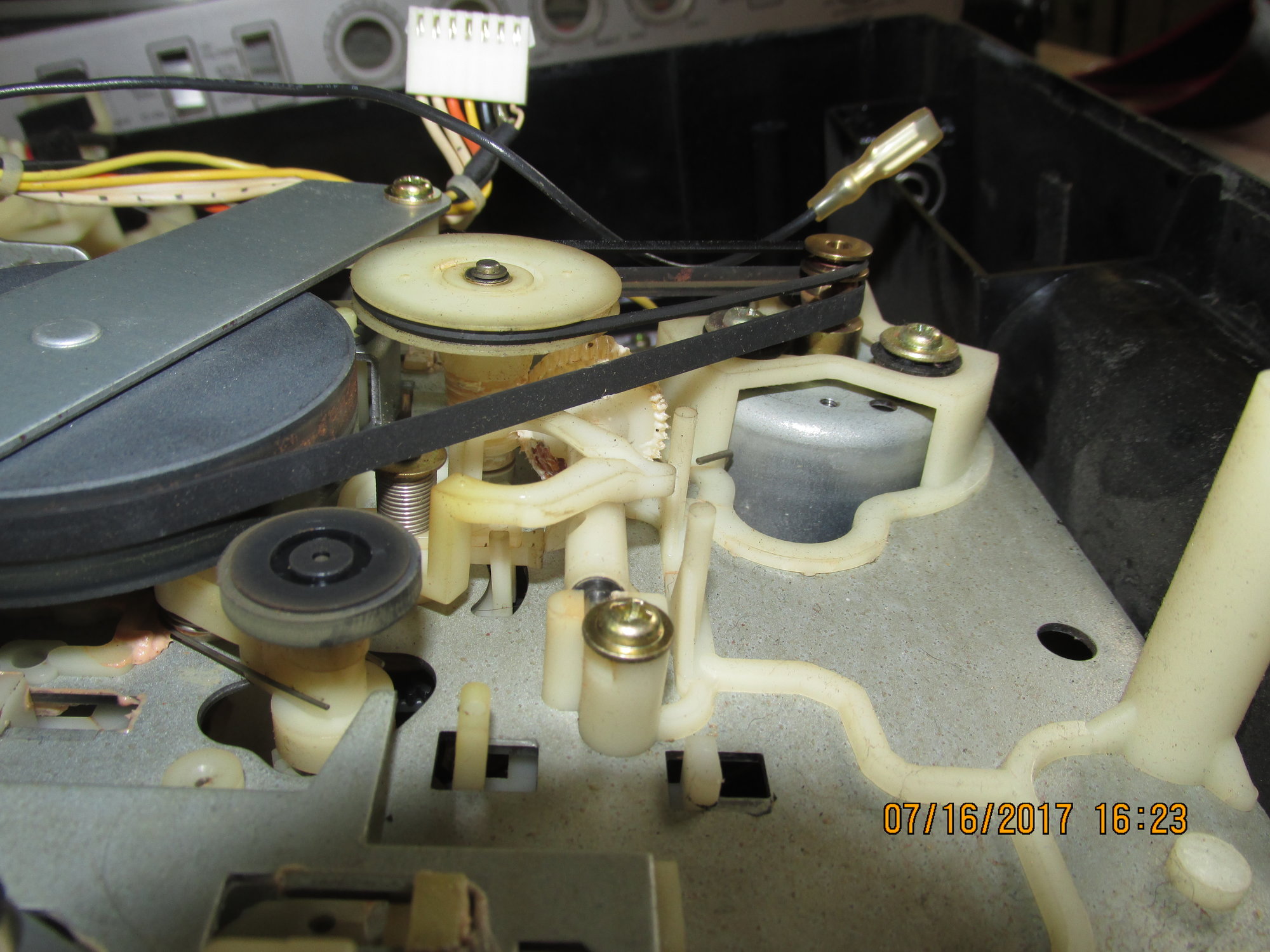

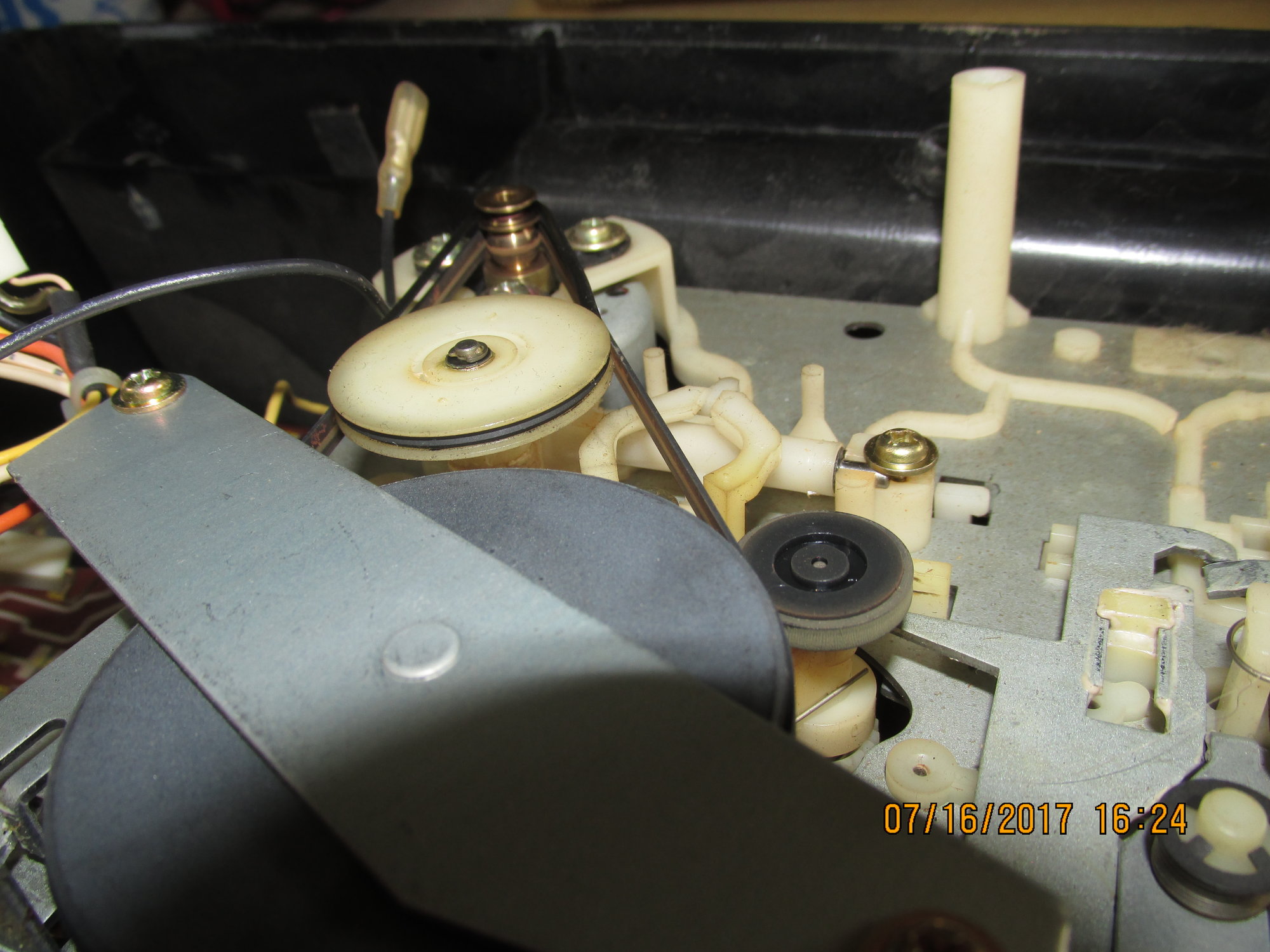

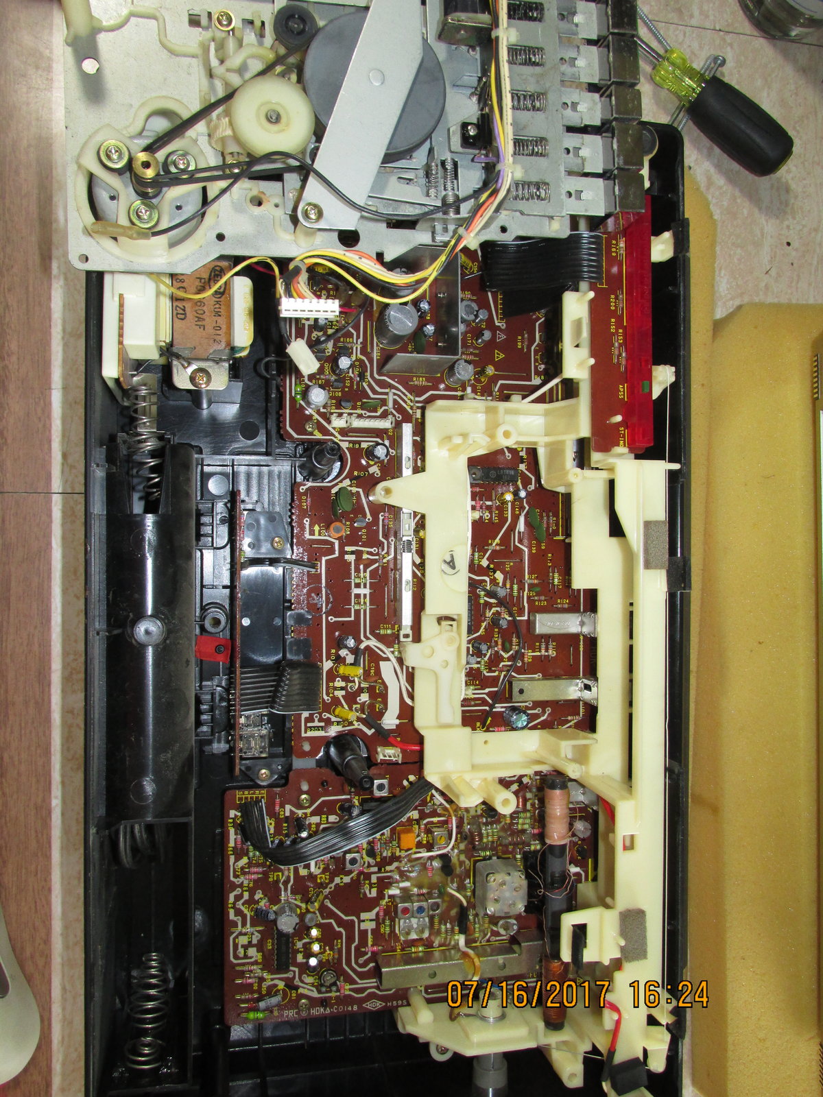

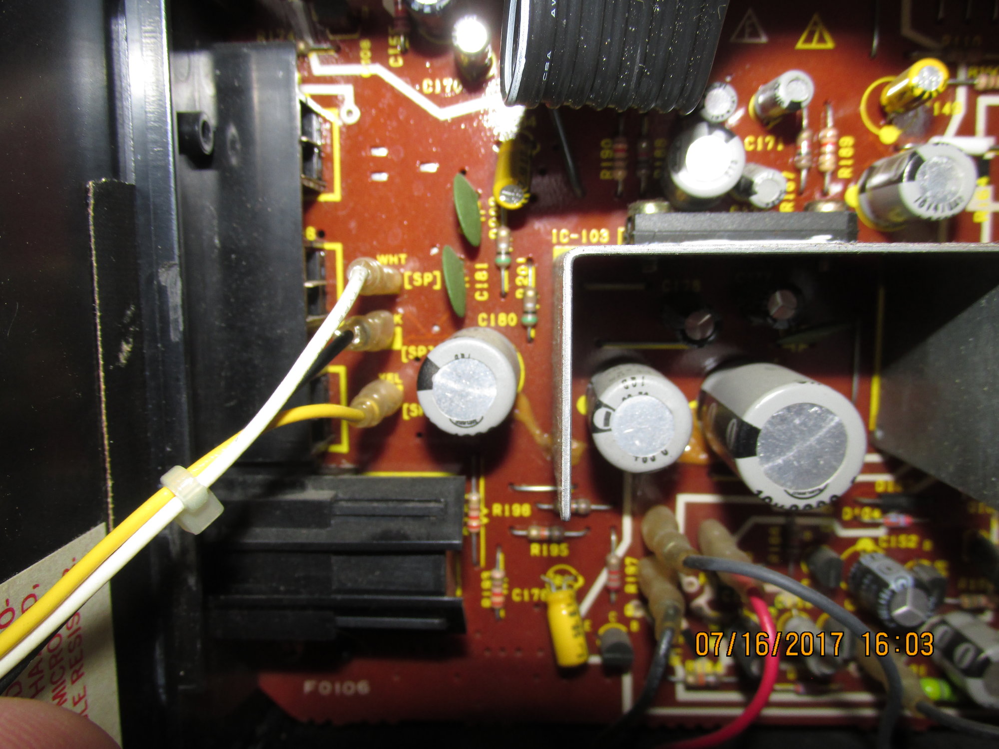

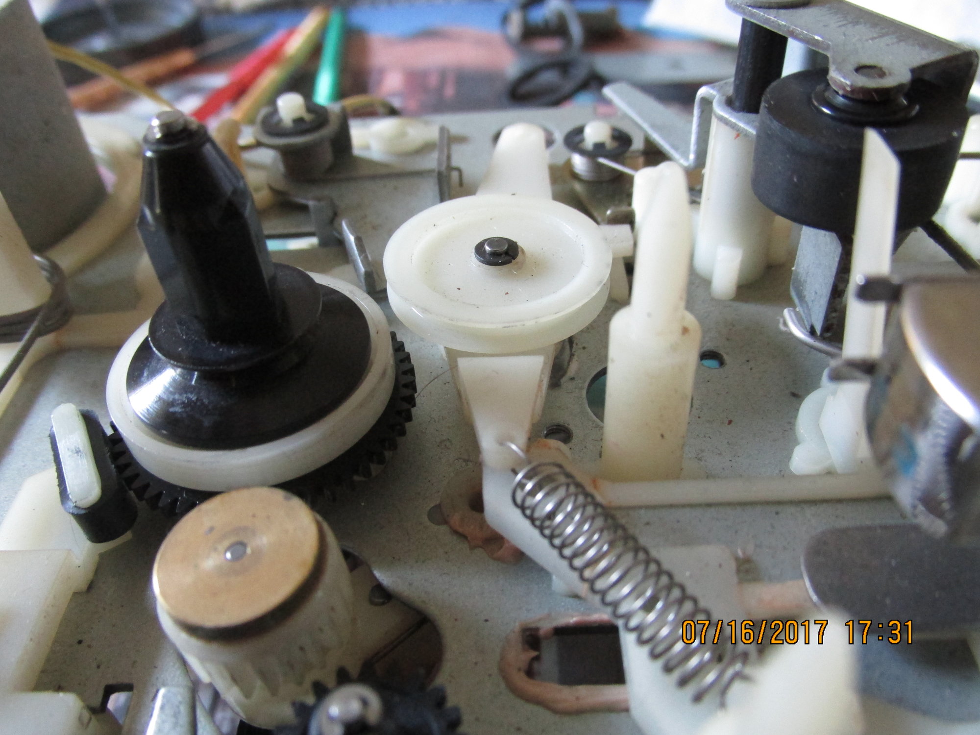

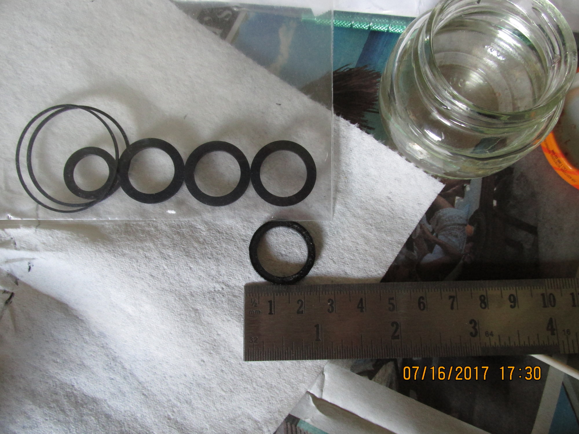

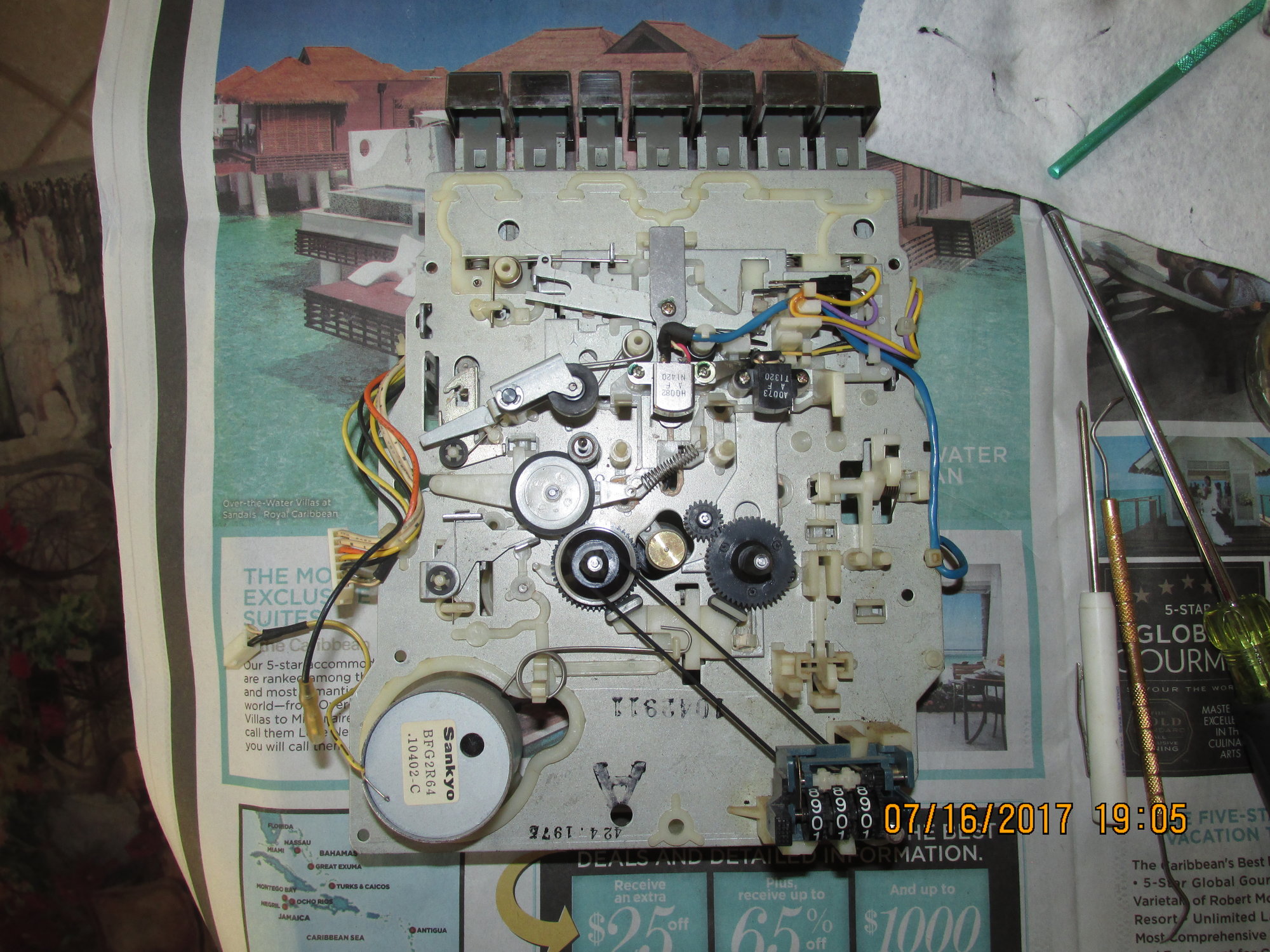

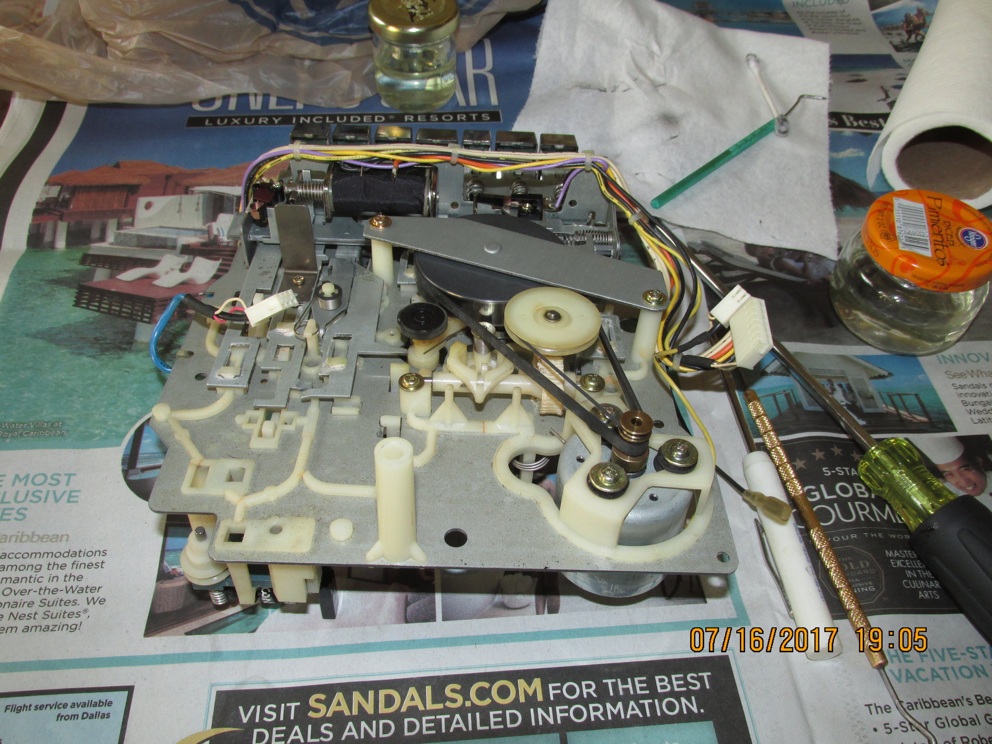

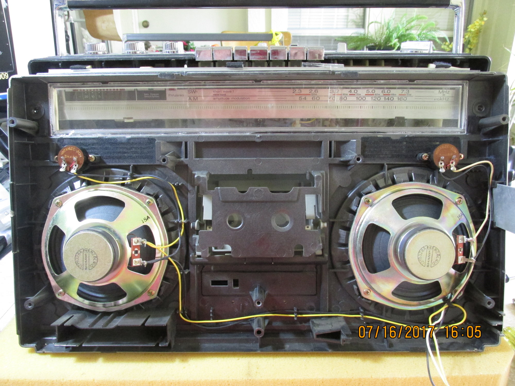

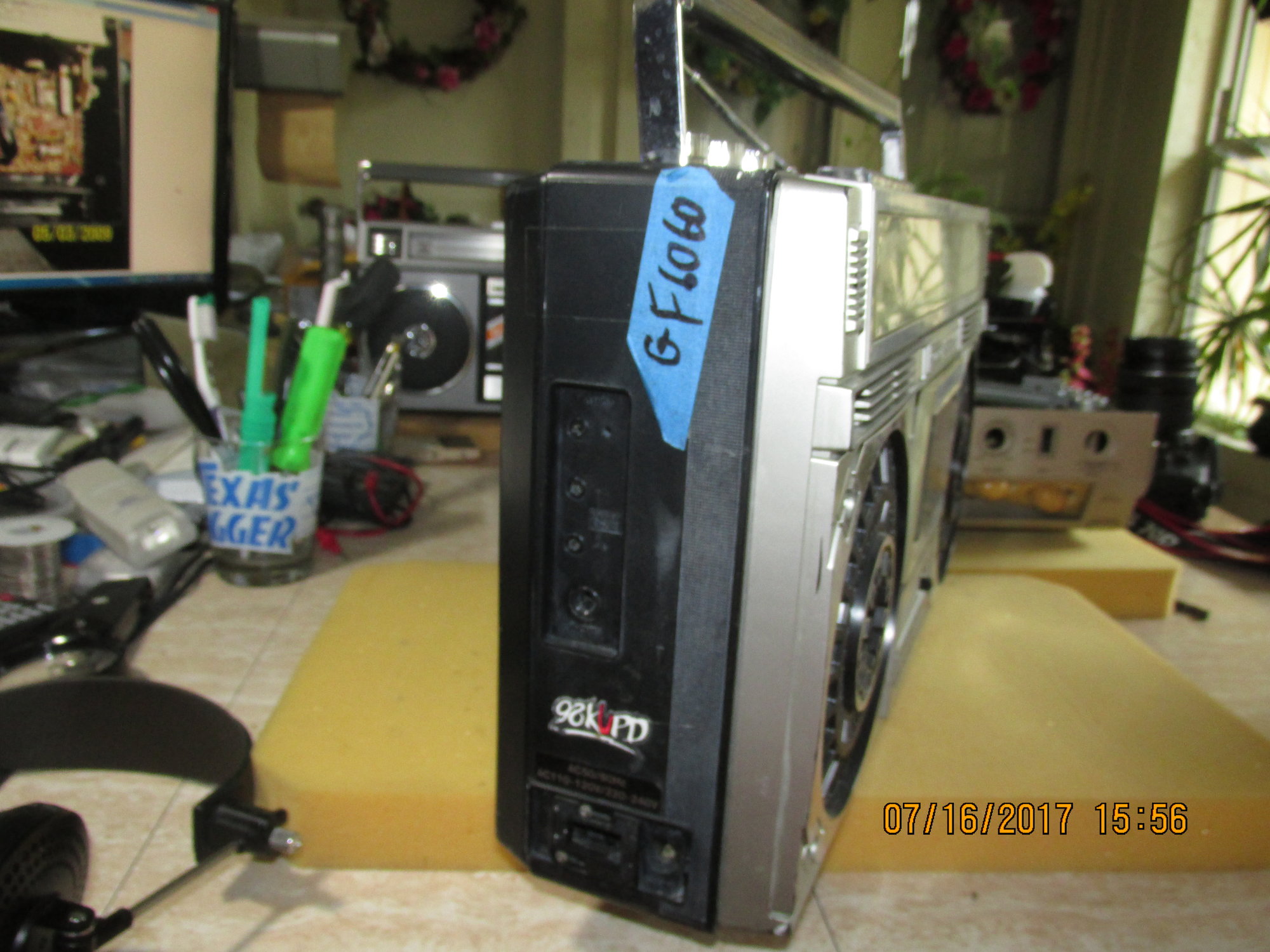

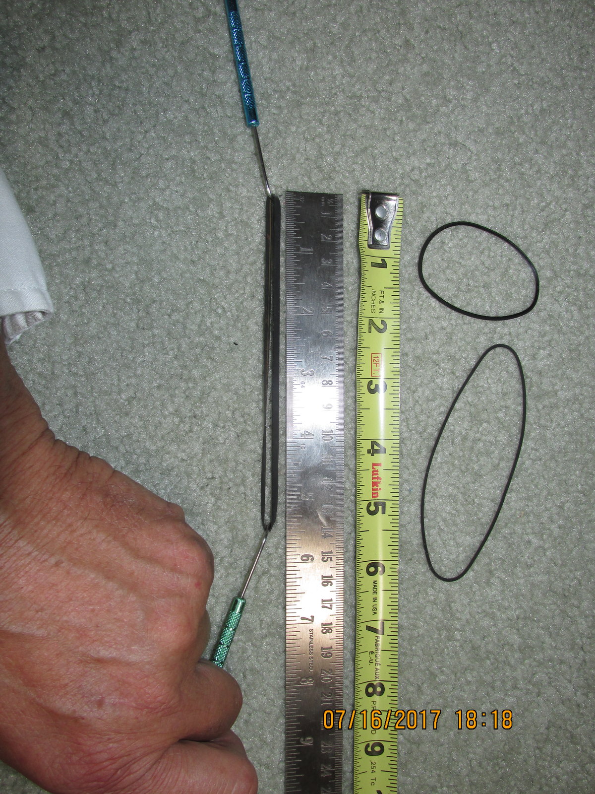

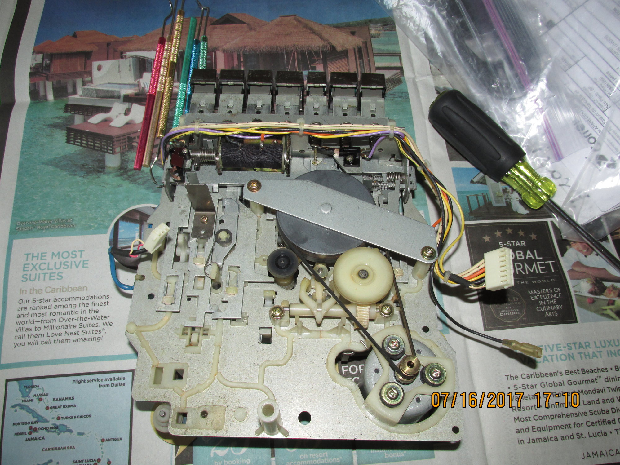

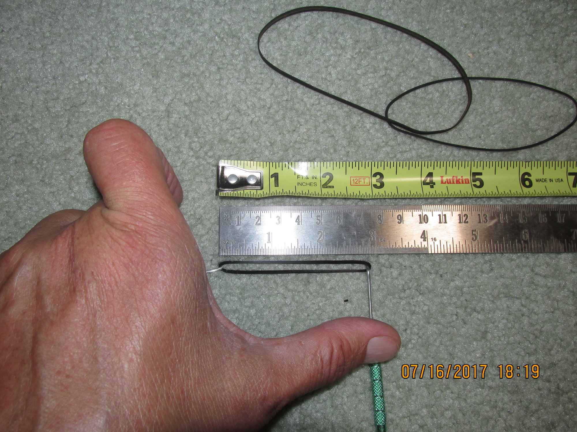

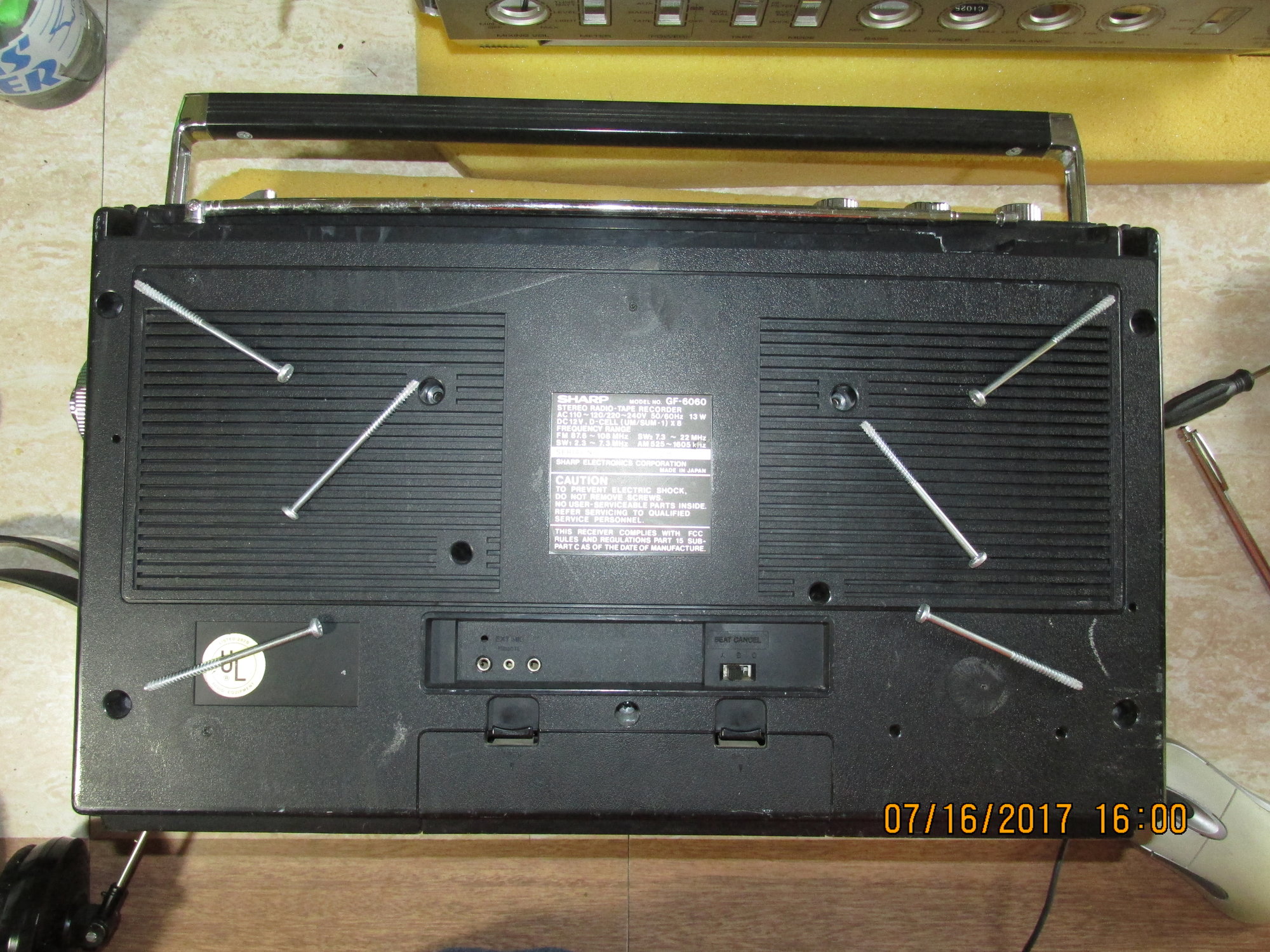

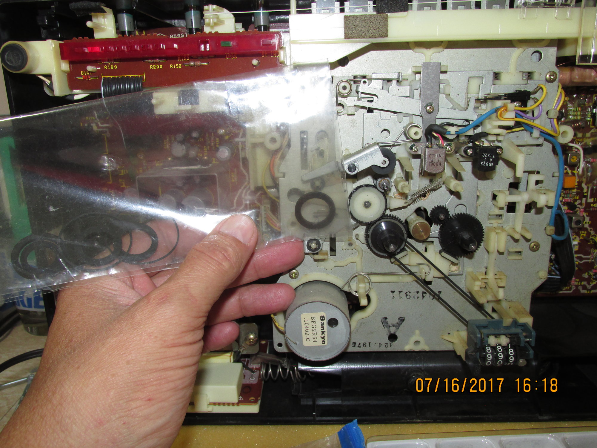

    IMG_6781 Sharp GF-6060 from year 2009.JPG IMG_6782 Sharp GF-6060.JPG IMG_6783 Sharp GF-6060 input.JPG IMG_6784 Sharp GF-6060 tune.JPG IMG_6785 Sharp GF-6060 back rear.JPG IMG_6787 Sharp GF-6060 top.JPG IMG_6788 Sharp GF-6060 Seven screws remove front.JPG IMG_6790 Sharp GF-6060 inside front.JPG IMG_6791 Sharp GF-6060 inside open this way.JPG IMG_6792 Sharp GF-6060 speaker wire.JPG IMG_6793 Sharp GF-6060 inside back from front view.JPG IMG_6794 Sharp GF-6060 inside front from back view.JPG IMG_6795 Sharp GF-6060 woofer tweeter.JPG IMG_6797 Sharp GF-6060 belt travel.JPG IMG_6798 Sharp GF-6060 tape deck close.JPG IMG_6799 Sharp GF-6060 take up reel tar not rubber.JPG IMG_6800 Sharp GF-6060 capstan rubber tire gone.JPG IMG_6801 Sharp GF-6060 new Idler match.JPG IMG_6802 Sharp GF-6060 capstan flywheel detail.JPG IMG_6803 Sharp GF-6060 flat belt travel.JPG IMG_6804 Sharp GF-6060 another idler tire.JPG IMG_6805 Sharp GF-6060 behind tape deck main board view.JPG IMG_6806 Sharp GF-6060 before new idler tires.JPG IMG_6807 Sharp GF-6060 befroe new belts.JPG IMG_6808 Sharp GF-6060 remove flat belt.JPG IMG_6809 Sharp GF-6060 remove capstan bearing.JPG IMG_6812 Sharp GF-6060 I have new take up idler tire.JPG IMG_6813 Sharp GF-6060 cleaned take up idler.JPG IMG_6815 Sharp GF-6060 Idler take up installed.JPG IMG_6816 Sharp GF-6060 new idler through capstan bearing.JPG IMG_6817 Sharp GF-6060 tire will engage capstan.JPG IMG_6821 Sharp GF-6060 old flat belt size.JPG IMG_6822 Sharp GF-6060 old secondary belt size.JPG IMG_6823 Sharp GF-6060 old tape counter blet size.JPG IMG_6824 Sharp GF-6060 Cleaned all switches pots & recording bar.JPG IMG_6825 Sharp GF-6060 Two new Idlers capstan & takeup reel.JPG IMG_6826 Sharp GF-6060 New flat belt & Secondary belt.JPG IMG_6827 Sharp GF-6060 Speed adjust motor for proper pitch by ear an favorite tapes.JPG Sharp GF-6060 New Idler Capstan & Take up Idler rubber tire Play Cassette Service
    Date of rebelting 16 July 2017
    Pictures I took as I replaced parts to make the cassette deck work again and cleaned all electrical connections.
    I am not sure but I caption each picture I upload to here, so I am not sure of the captions can be read for each picture.

  3. Cassette2go
    500
    Every Picture has been named and I have tried to find the captioning as in the past in other places - that the name - of the picture would be over laid on top of the picture in some form but - this does not work here.
    If you were to ( right click to 'save as' ) then you can view my picture captions.
    I will work on getting better text per pic I post soon.
