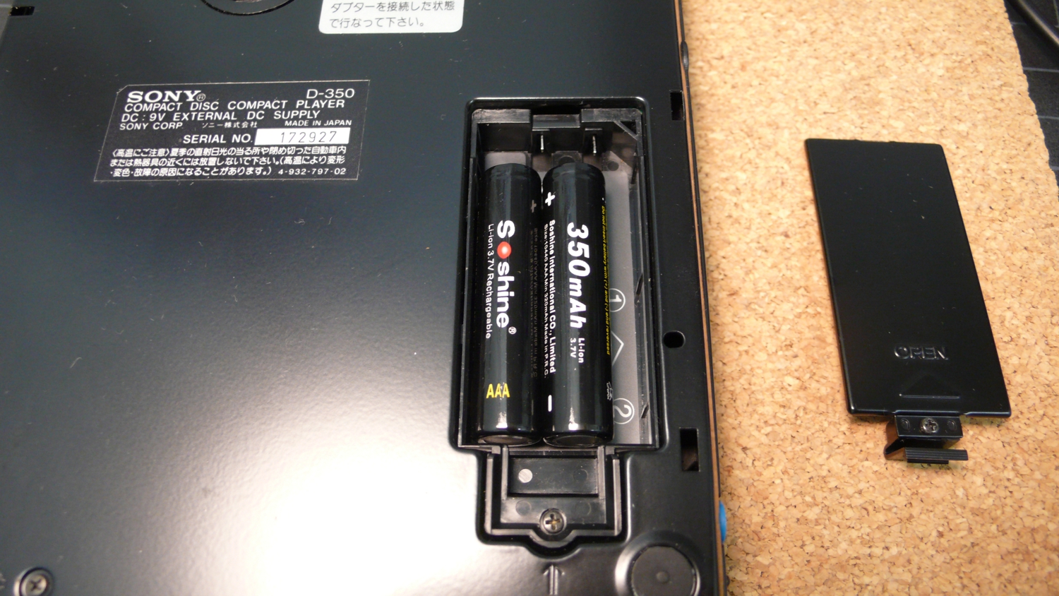

    External gondolas for D-350 are as rare as power supplies for Technics SL-XP7, it is much easier and cheaper to buy full package from the start. I do not wish you luck finding one simply because you need a small Miracle, not just luck here ;)

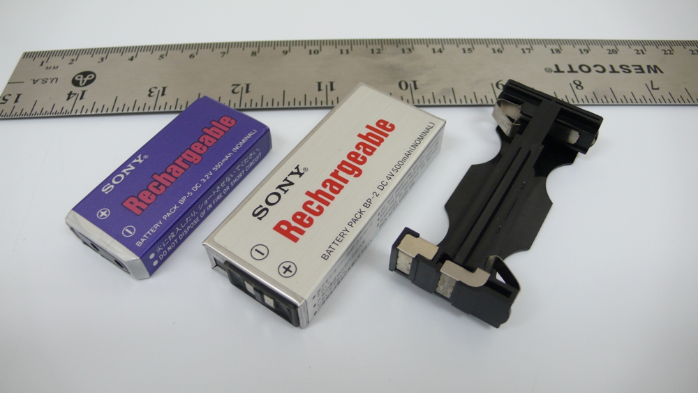

    Internal battery compartment for BP-5 is so small that AA won't fit:
    Never saw 2xAAA adapters, your best bet is to hardwire two AAA (or rechargeables!!), or rejuvenate your original BP-5.
    Li-Ion cell for iPod fits BP-5, it is on my To-Do list

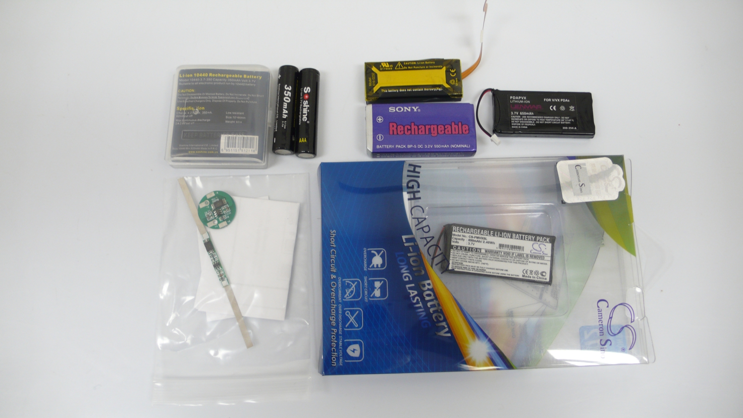

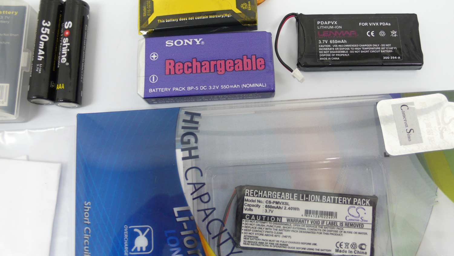

    this is what I have, cell on top was pulled out of iPod (5-th gen):
    zoomed to see exact models:

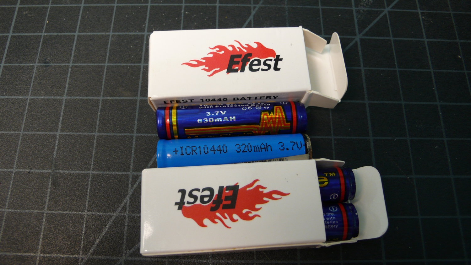

    As a temp solution, two AAA Li-Ion "in parallel" (otherwise you get 2x3.7V=7.4V) is the easiest fix:
    BTW, do not get fooled by those 600+mAH AAAs. Here is how they look once you peel shiny outer foil:
    Make sure you buy them with overcharge protection! Each battery needs its own chip.

    Thanks for the pics and the info...have ordered 2 x Palm V/XV batteries...to try and rebuild as a BP-5 !

    I never did! But solder two wires to the board, next to the batt connectors and pull wires outside thru the slit.
