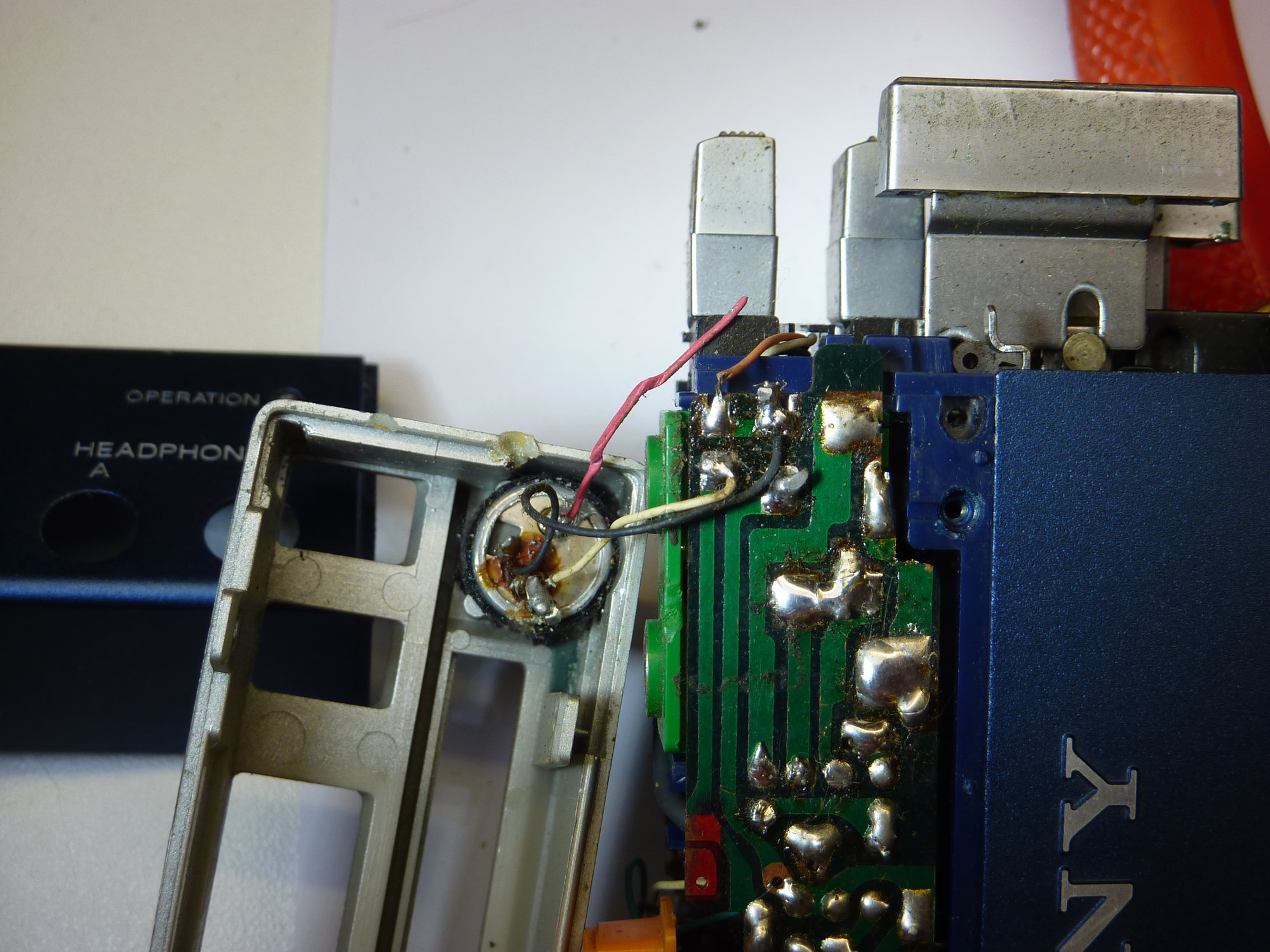

    Hi guys...i got a loose wire...can someone tell me where it goes....its a red mic wire
  2. enryfox
    enryfox Active Member
    288
    close to Milan (Italy)

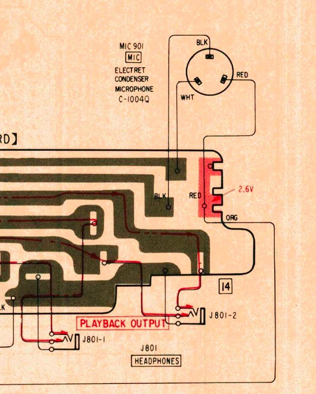

    Looks like more than one wire is out of place, black should not be soldered there and red goes together with orange.
