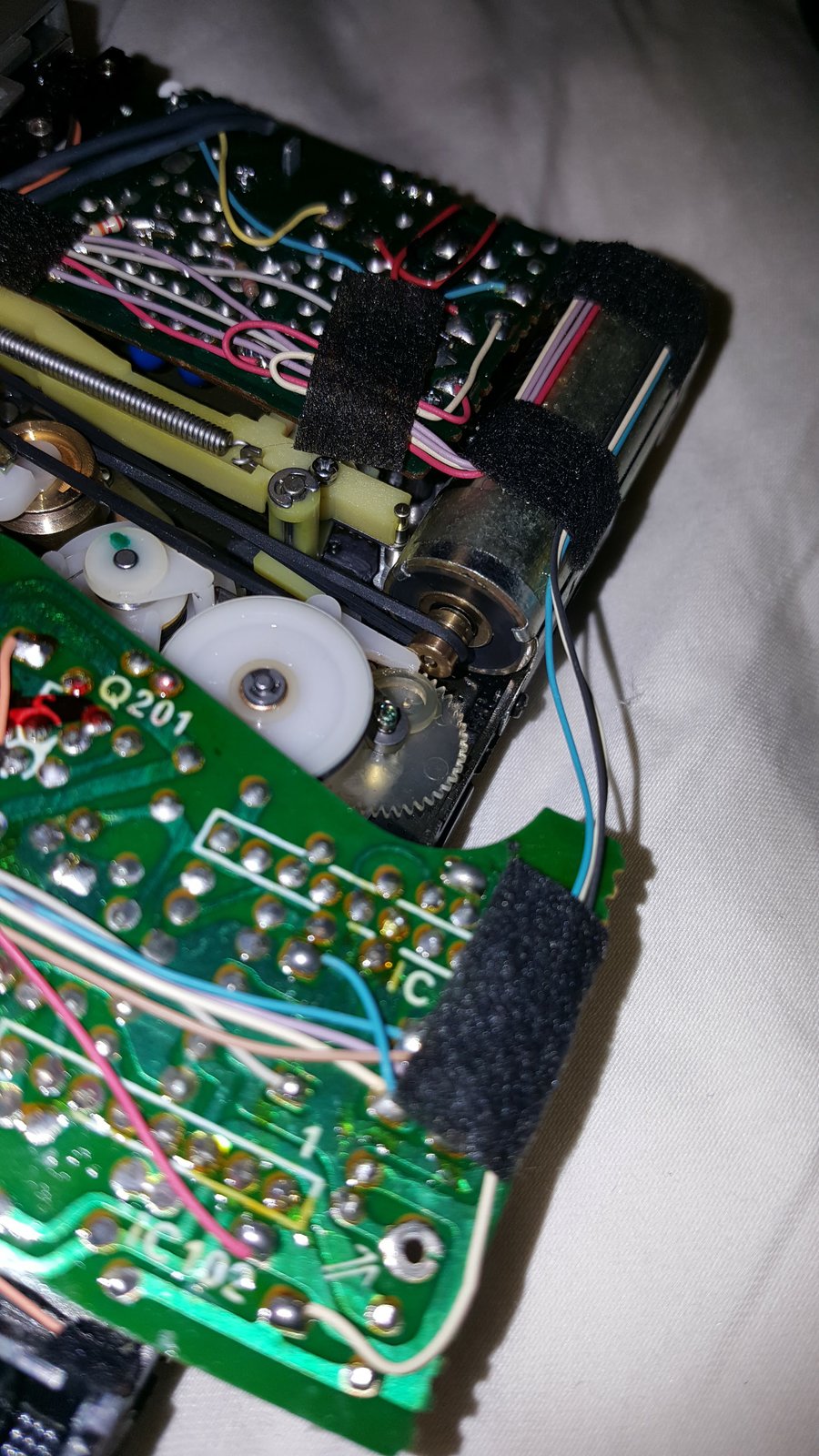

    Hello, first post!
    I recently picked up a Sony TPS-L2 Walkman in great condition and I'd really like to try and get it running. The light turns on when I press play, and I can hear static when I plug headphones in the jack, but the motor does not turn (I was planning on replacing the belts anyways so I opened up the back to check and sure enough the motor doesn't turn). Is there anything I could do or check to try and get the motor working? I'm new to all this but I'd really like to get it working! Thanks!

    Try running the motor solely off a single AA battery with no load. If it doesn't turn, try turning the shaft by hand and see if it's stiff/stuck.
    Capacitors are unlikely to cause the motor to not run.

    So just place a single battery in the back, with no cassette in and press play? I tried turning the shaft but I can't really even get two fingers in to turn it. Is it supposed to be able to turn freely? Like if I just try to run it with one finger? Because I can't really turn it.
    Maybe it is stuck because I am having a difficult time turning it. So you just sprayed some WD-40 near the shaft there?

    Great news, its starting to free up! I've been keeping up with dropping WD-40 in it and now when I press play it will run for a few seconds but get caught again. I'll keep up with it and update when its up and running.

    Hey guys so I'm having a couple new problems. The motor works great now and I put the new belts on but I'm wondering if its running backwards? The part that turns the cassette tape (I apologize I don't know the term for it) looks like it turns the wrong way. It also seems to be pretty loud, any suggestions?

    Belt not routed correctly- check pictures of other TPS-L2 belts.

    Ah, I see where I messed up, it's running good now but it still seems loud?
