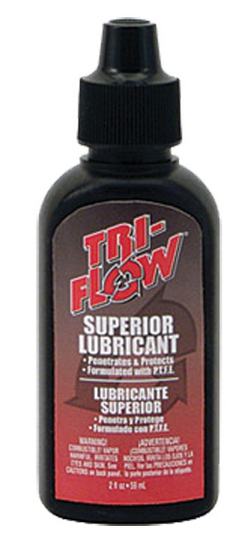

  7. buzbox
    buzbox Active Member
    459
    Australia
    I use this at work and home too. Does the job. Many other types out there so shop around. I'd stay away from WD-40 though. Its good for a temporary fix but a good lubricant is best.

    thnx Buzbox but I'm afraid that this kind of lube is not available in Belgium, Europe. ;)

    Should be able to find something similar
