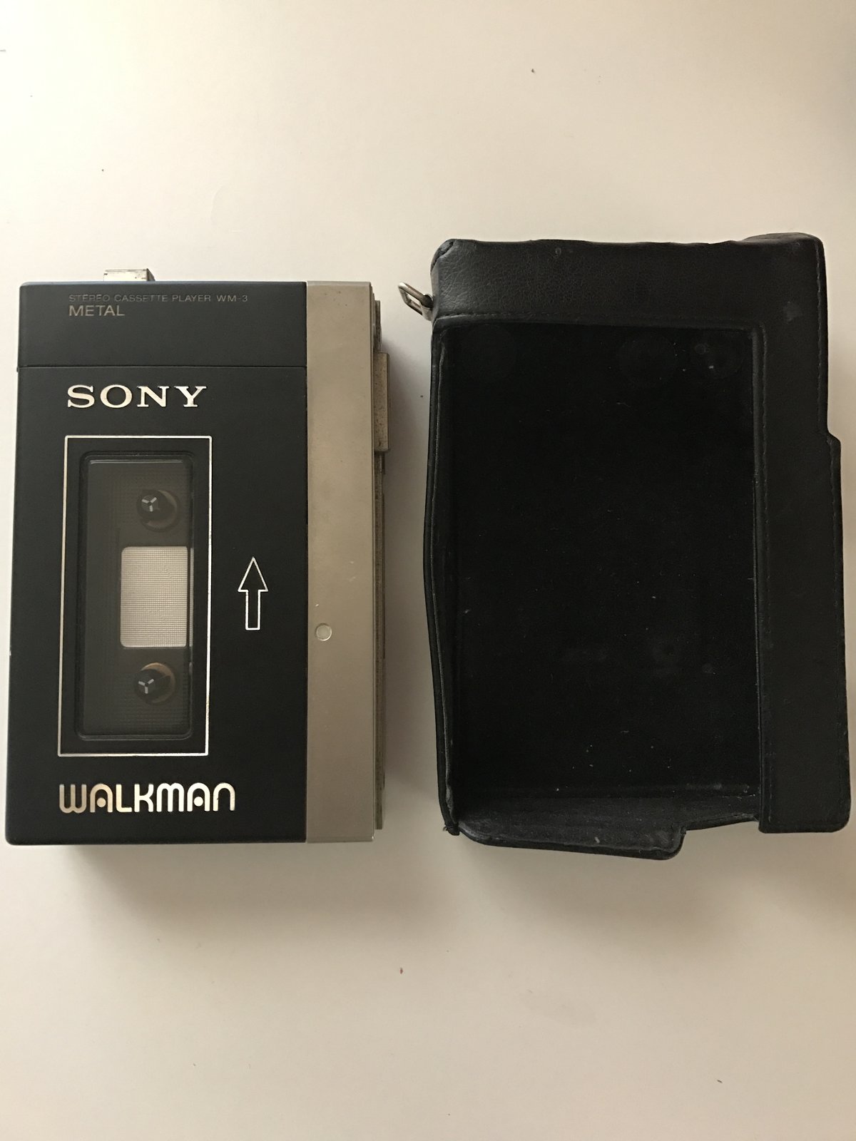

    IMG_1816.JPG Hi everyone, this is my first posting on here!:wave:
    I have an old WM-3 that I would like to get running again. The seller who sold it to me said it's a working unit but needs a new belt replacement. If I had more experience with repairing these I would do it myself, but I don't unfortunately and wouldnt wanna risk damaging anything if I tried to. Can anyone offer some help? Thanks

    Changing the belt on this walkman is easy but you have to make sure the problem is only the belt.
    (By the way, internal structures of WM-3 and TPS-L2 are identical)
    first step: place fresh batteries and push the play button. Do you see the light turns on right away and motor running??? if you see these 2 conditions then you can change the belt. The best source to buy the belt is from one of our members @mihokm . I can help you with simple photos to change the belts. This walkman needs 2 belts

    Hi Boodokhan, I do believe it's just a simple belt replacement. The red light comes on when it's powered up and I can hear a humming sound from the motor running, so there's no problems with that. If it's an easy process to change the belts then with some help from you I can try and replace them myself. I'll also send a message to mihokm.
