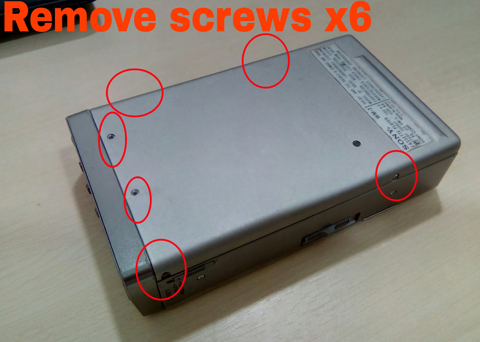

    Since there's a request from our S2G member, it's my pleasure to share my experience with you as I worked on my WM-7 today. Following are the steps that I would like to walk you through the images.
    1) Change new Belt
    2) Volume pot replacement

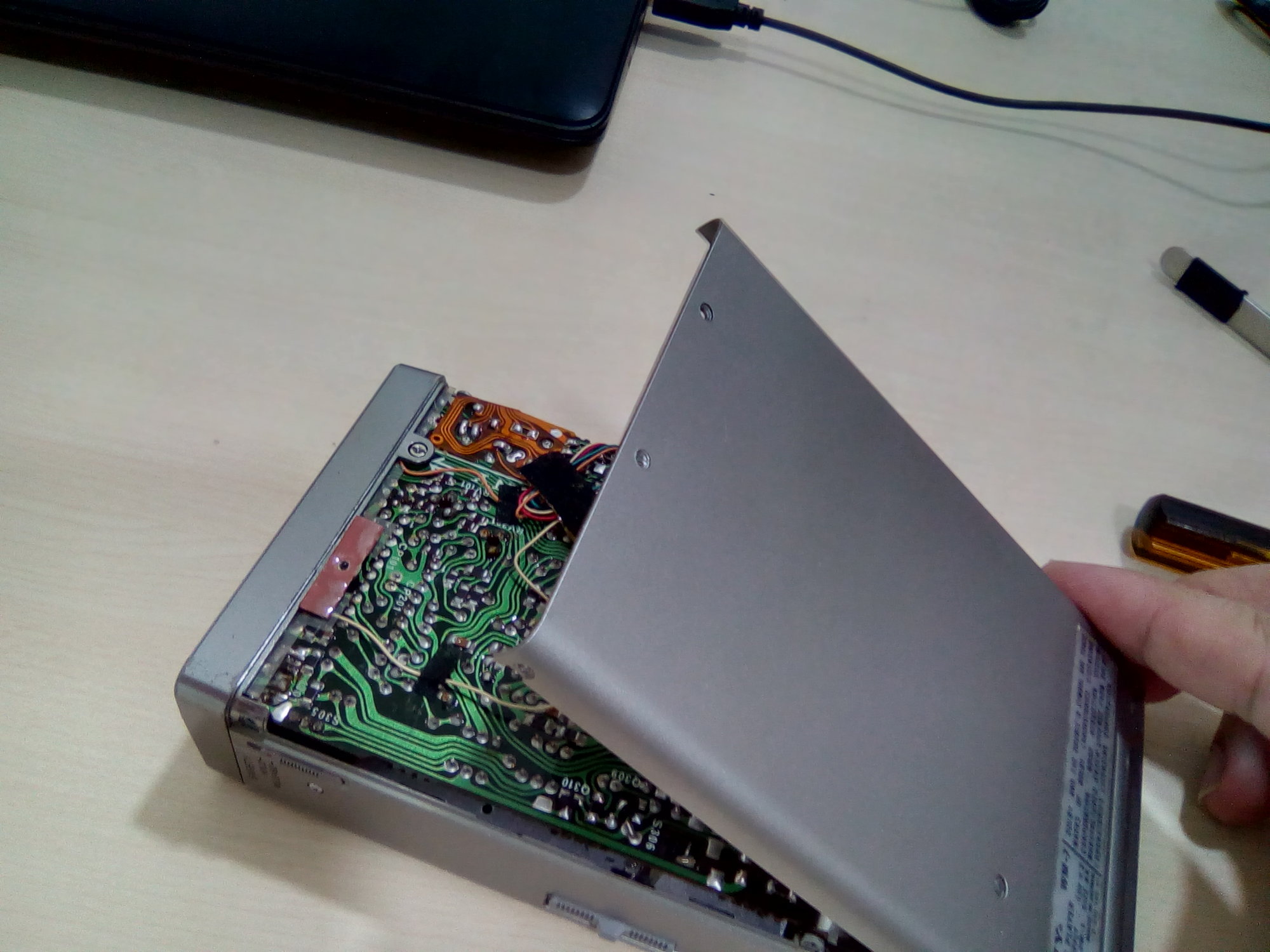

    Slowly lift the cover from the top where the control button panel located.

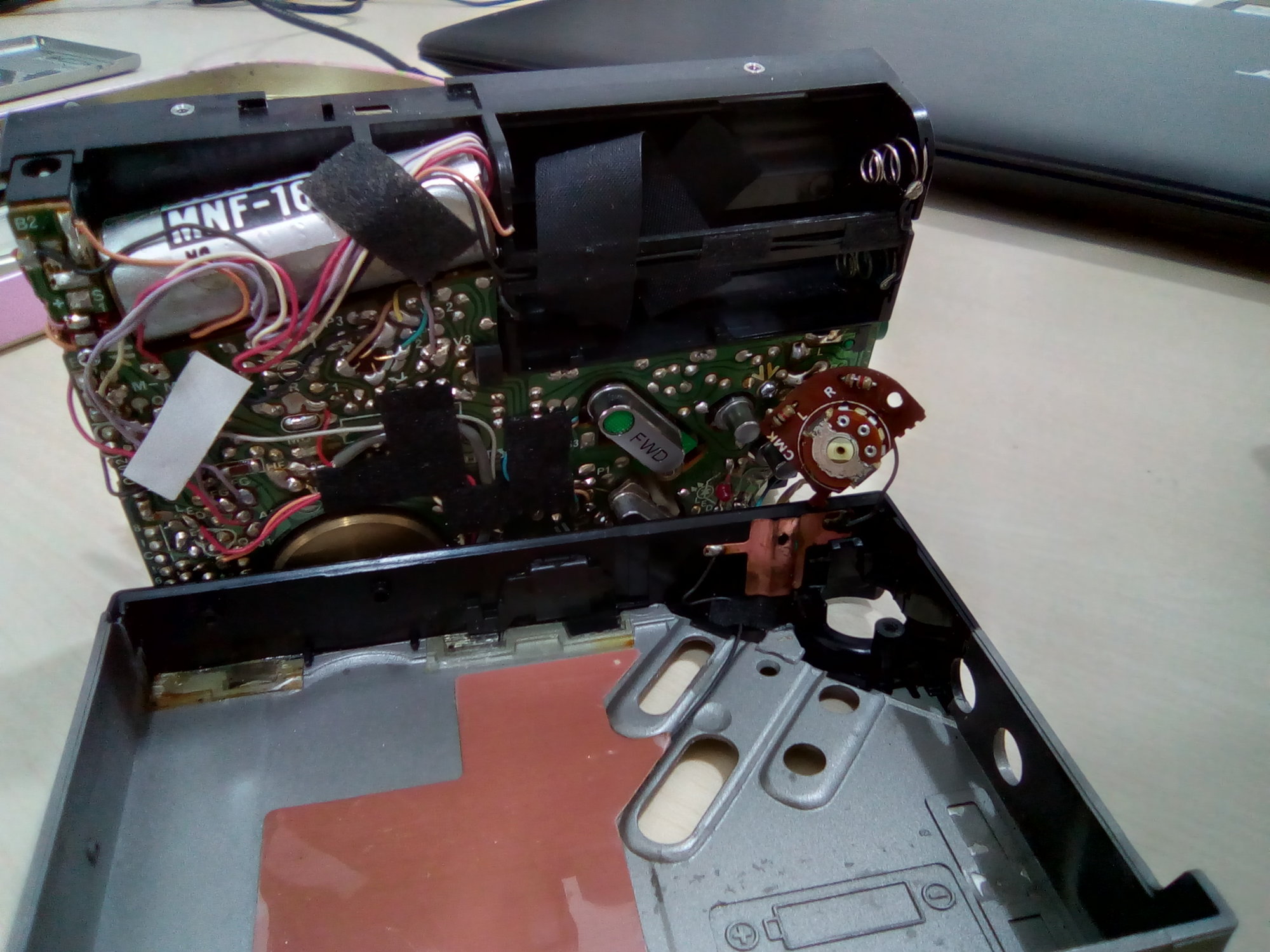

    Malaysia
    Then firmly pry the control button panel and slowly detach it from the unit. IMG_20161218_092540.jpg

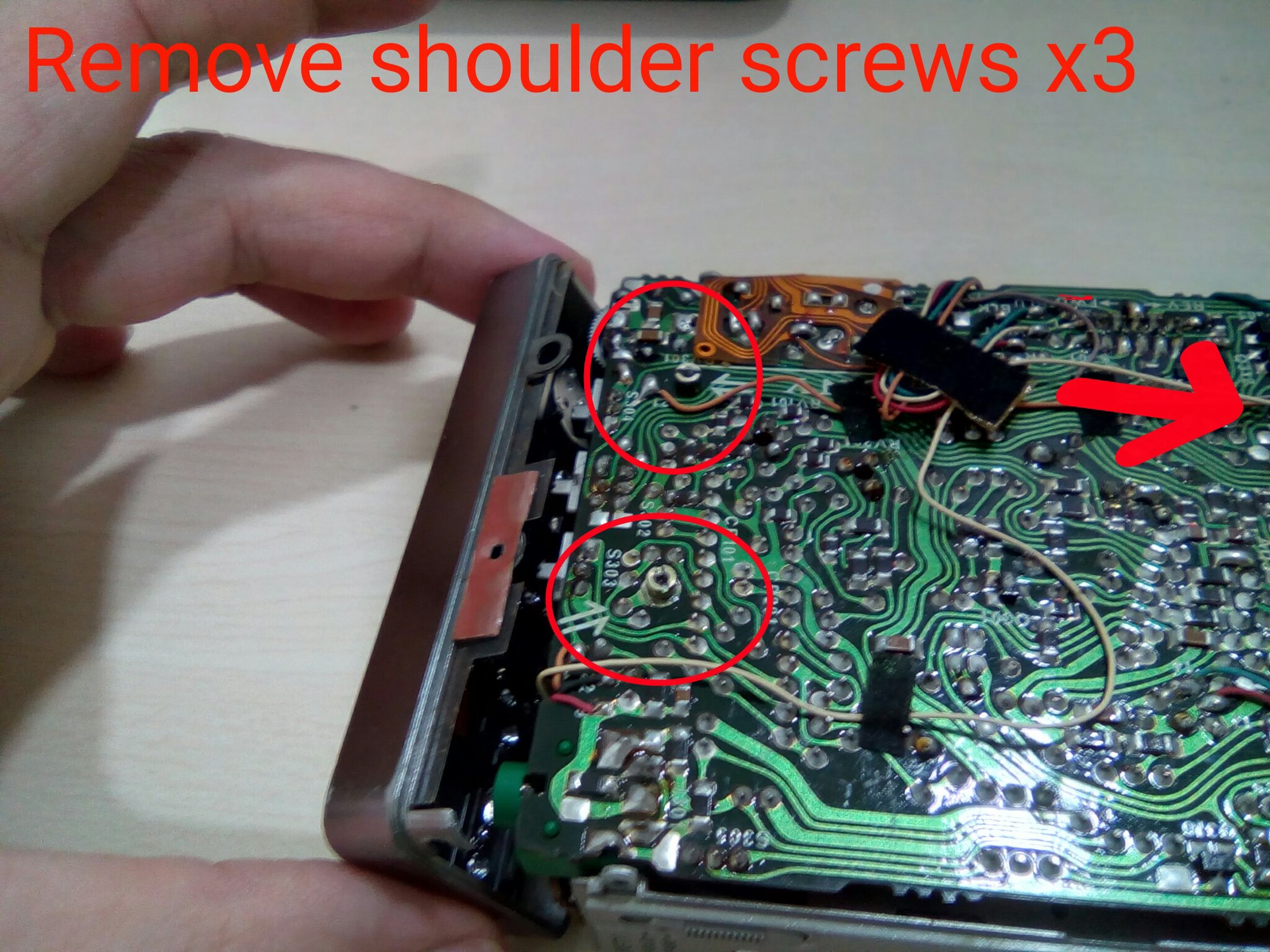

    Malaysia

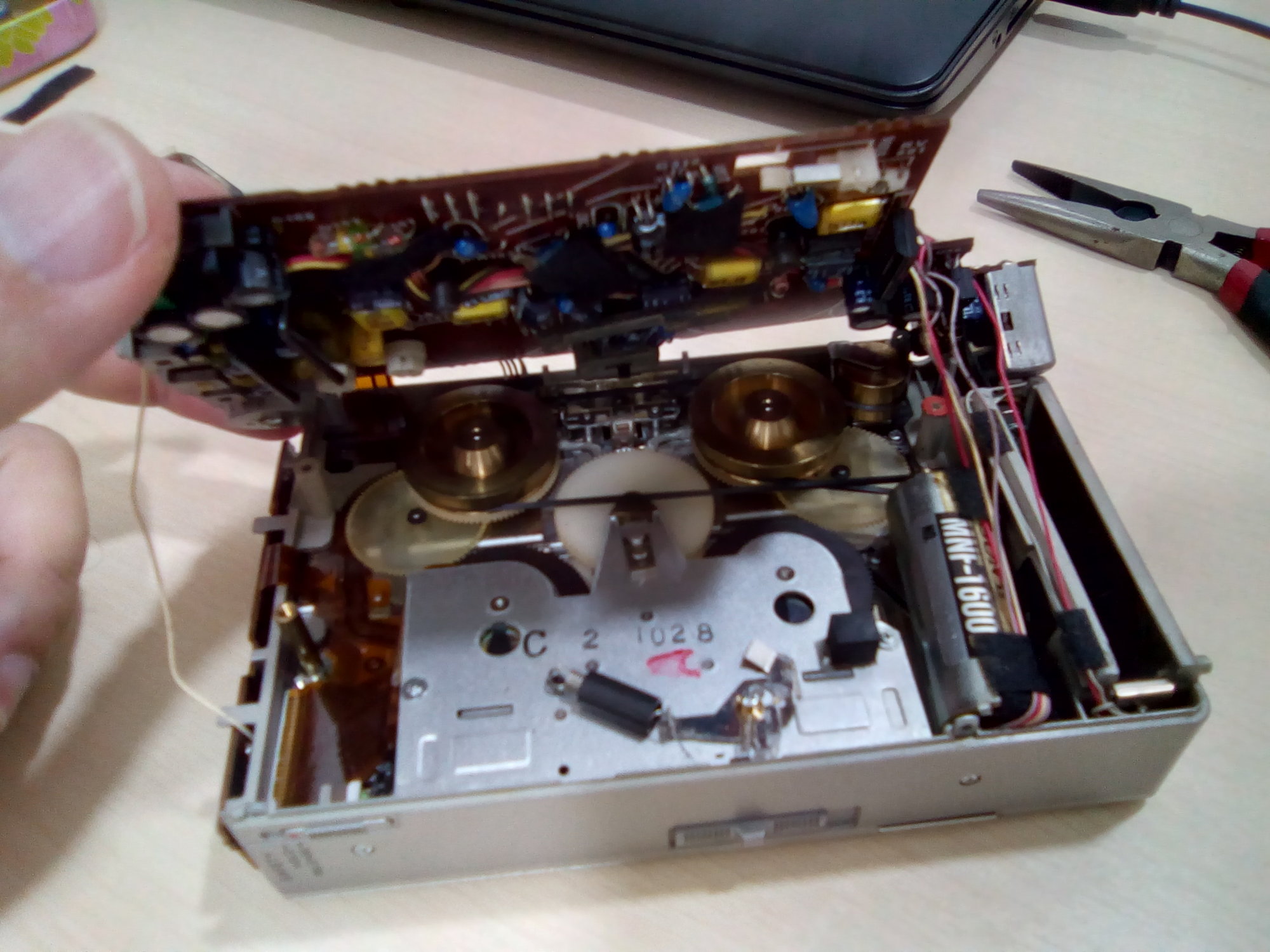

    Next remove the shoulder screws that hold the PCB in place.
  5. Ken80s
    Ken80s Well-Known Member
    381

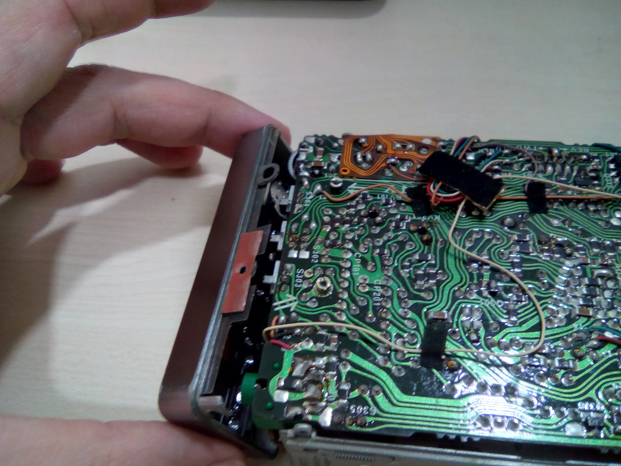

    Malaysia
    Slowly lift the PCB in order to access to the mechanism. Doing so you will be able to see the belt but please be extremely careful and gentle not to break any wires from the soldering points.

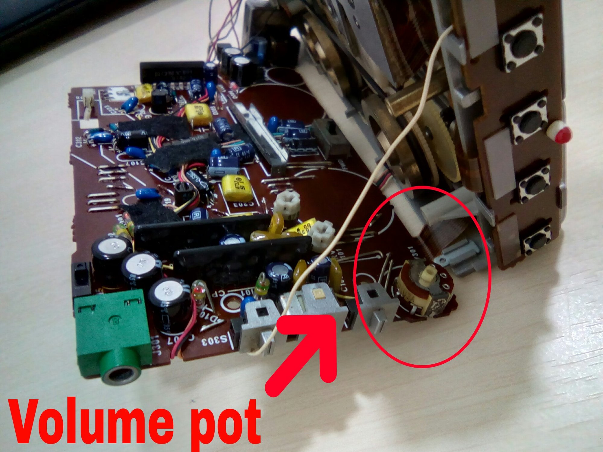

    Malaysia

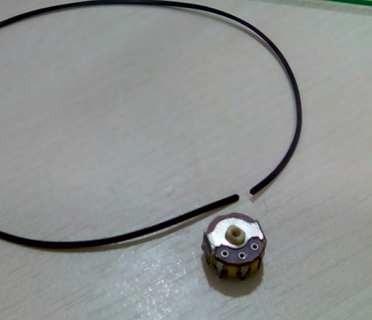

    This is the volume pot that I need to replace.
  7. Ken80s
    381
    Malaysia
    No choice I have to salvage the potentiometer from my WM2 as I don't have any spare with me.

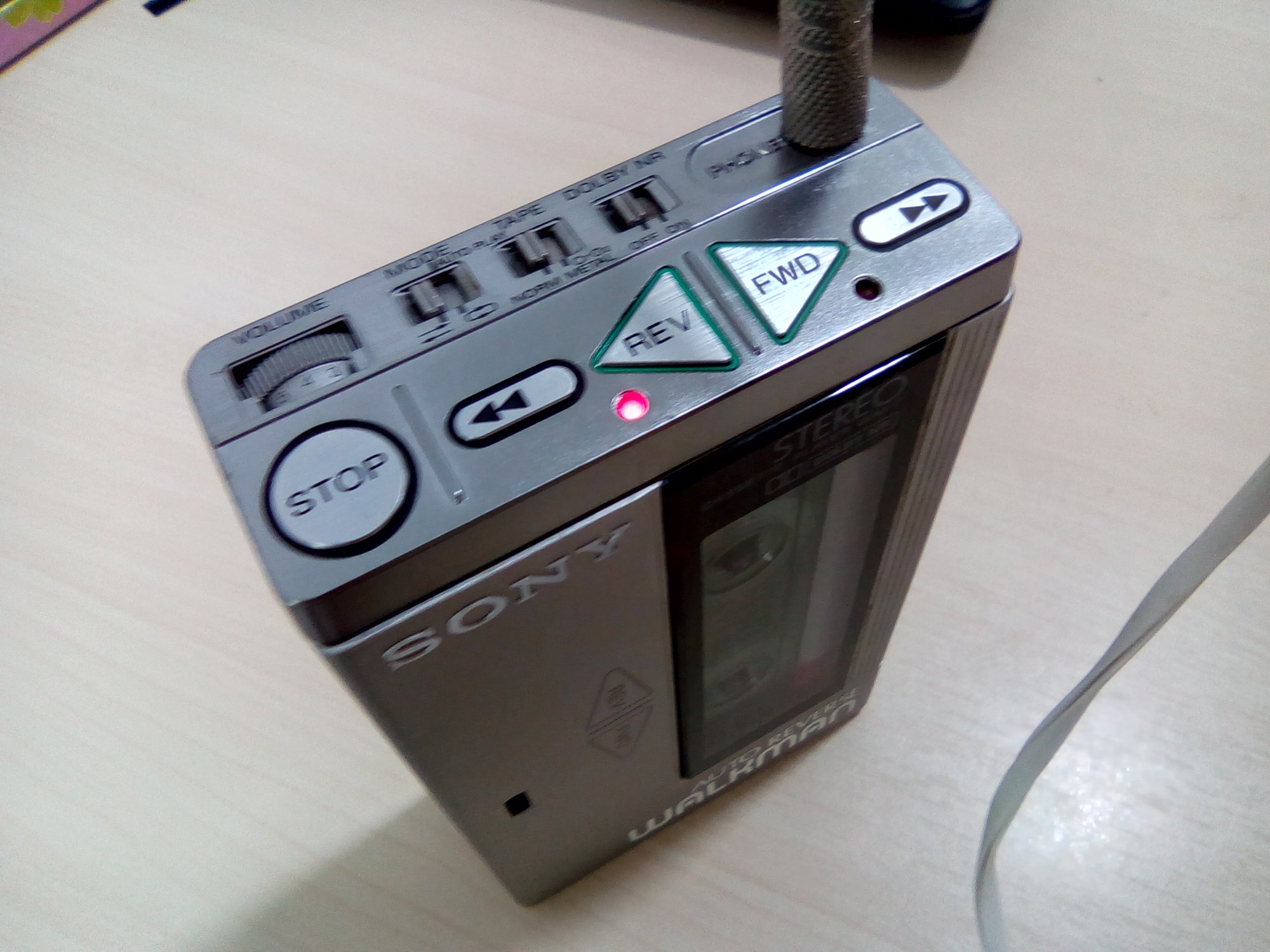

    Took me around an hour to get the parts replaced.
  9. Ken80s
    381
    Malaysia
    Now my WM-7 is working as good as new, the wow and flutter has improved significantly and the volume adjustment is smooth with both sides in perfect condition.
