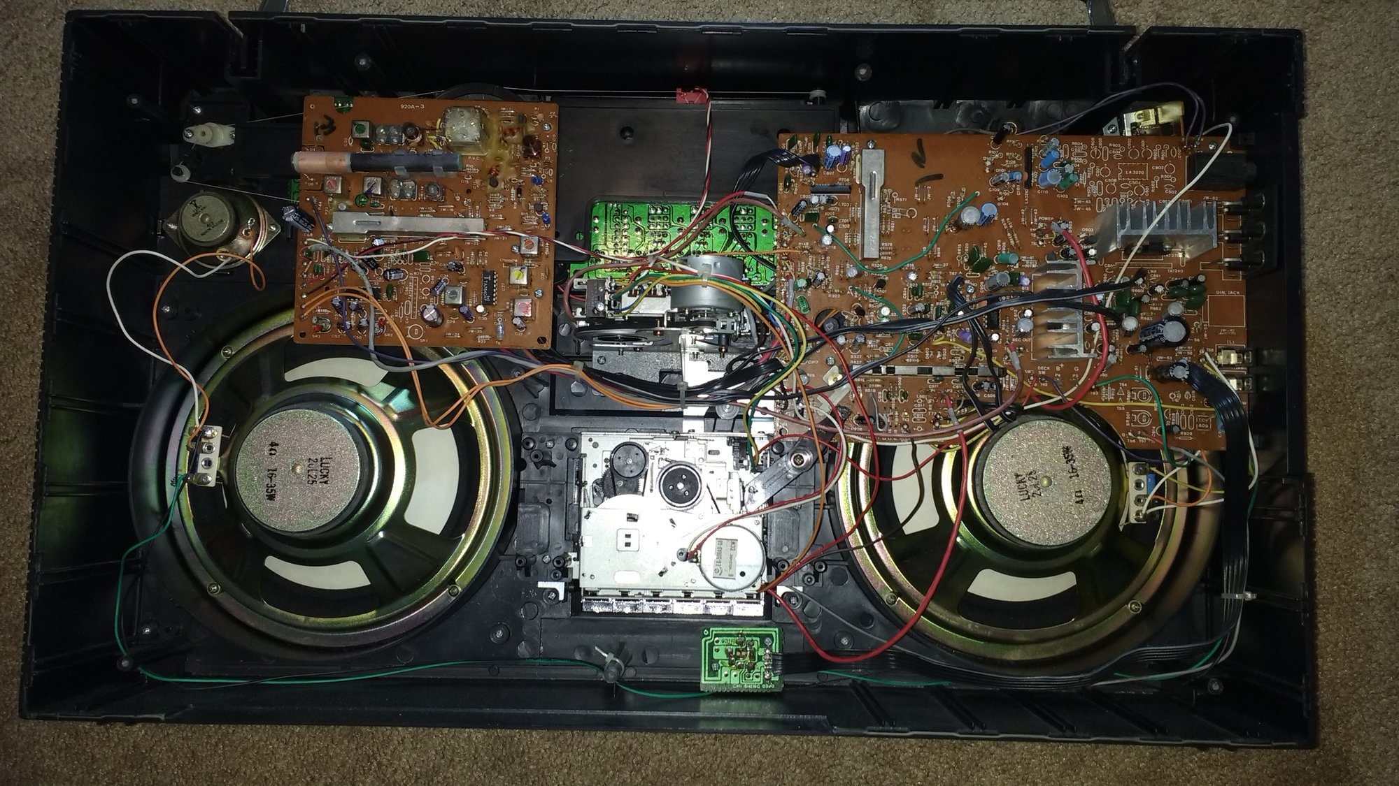

    Hello everyone. I was a member on the old site and now I have an issue with my Lasonic TRC-931.
    I lost all sound for it. The speakers pop like normal when turned on and buzz while on, but I get no sound, none from the tape deck either.
    I thought it was the tuner board and replaced all the CAPS on it and also looked for cracked solder joints but that did not work. I next removed the main board and checked for cracked solder joints and found a couple questionable but that was it.
    Anyone have any ideas?

    When I but my cases back together and powered it up I noticed when I placed my hand near the volume and balance controls the static noise increased. Therefore I'm going to take it apart and check those controls, got nothing to loose! And it lost sound while the radio was on.

    Just removed the volume eq board and found some oil like goo on the balance pot. Otherwise everything "looks" fine.
    I then cleaned the pots with tuner cleaner and since it's out, I'll replace the 10 caps on that board.
    Hope that fixes it!
    In theory could the oil like goo have shorted the pot? I suppose so...

    Yeah, not sure if it was from me cleaning the volume and balance pots or the replacement of the CAPs.
    I would have liked to do one thing, power it up and if that did not work, do the next but I had to remove two boards just to get to the vol/bal/eq pot board therefore I did those caps while cleaning the pots.
    There were 10 CAPs of three different types on the board. I get all my CAPs at Mouser. I also did the large CAP at the power supply. The only CAPs I did not change out are the ones on the large board, there's a lot of them on that board.
