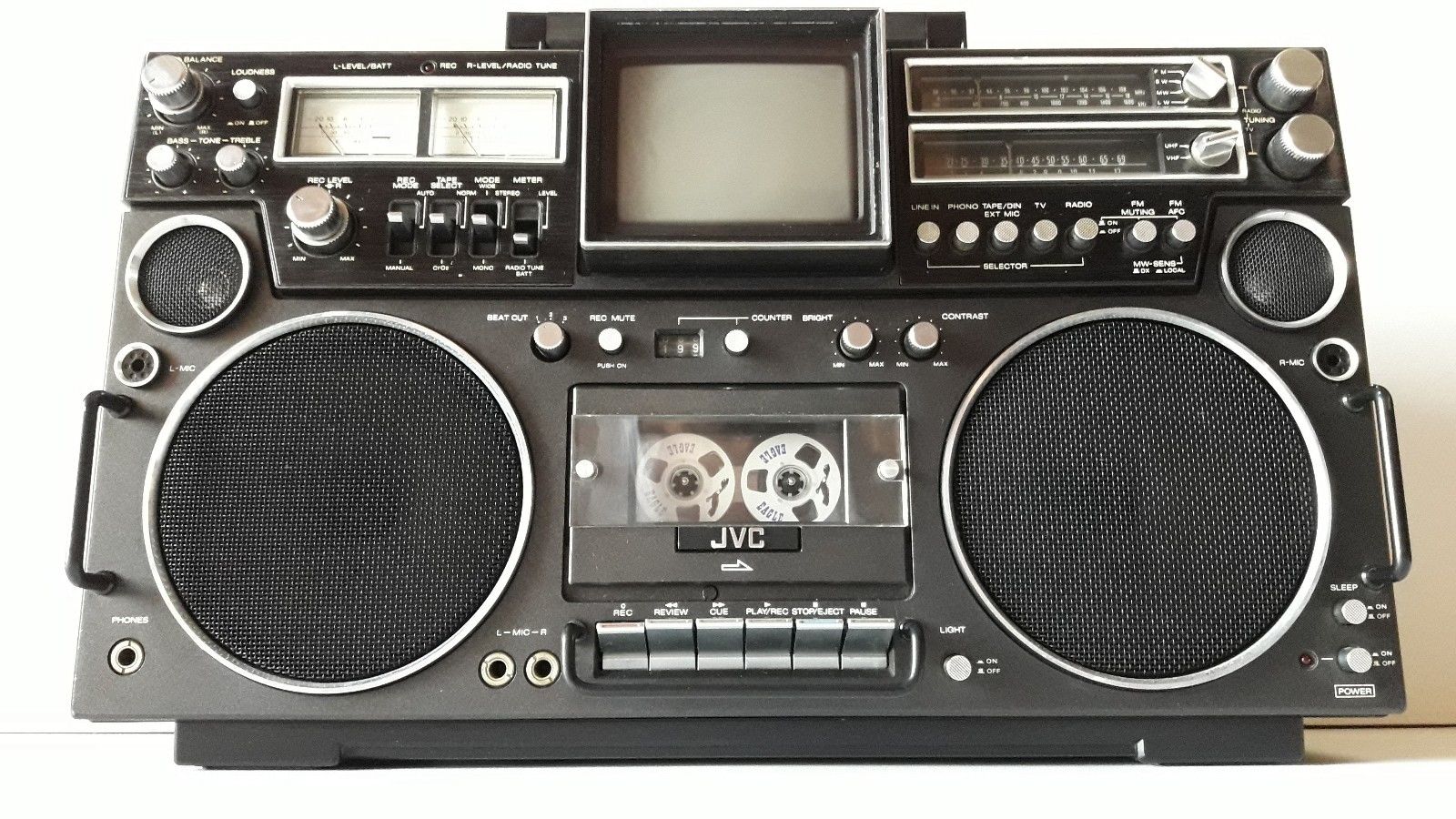

    Hi guys need some experts on this
    Unfortunately my latest acquisition of a ghettoblaster did not end that well.
    After receiving and tested the machine all worked fine but i returned home i tried to power on the machine and play radio but nothing happened.
    The thing is that the power button is turning red on but nothing happens
    When at the same time i press play on the cassette player the radio kicks in and the lights go on.....
    If i let the play button on the cassette player everything stops
    There is a sleep button so i am thinking something happened to that or else..
    Easy fix? Some direction would be nice even to inform my technician about particularities on this model.
    Very sad and hope for some crucial info but please note i am not a technician but interested to learn a thing or two.
    Thanks for any crucial comments on this one

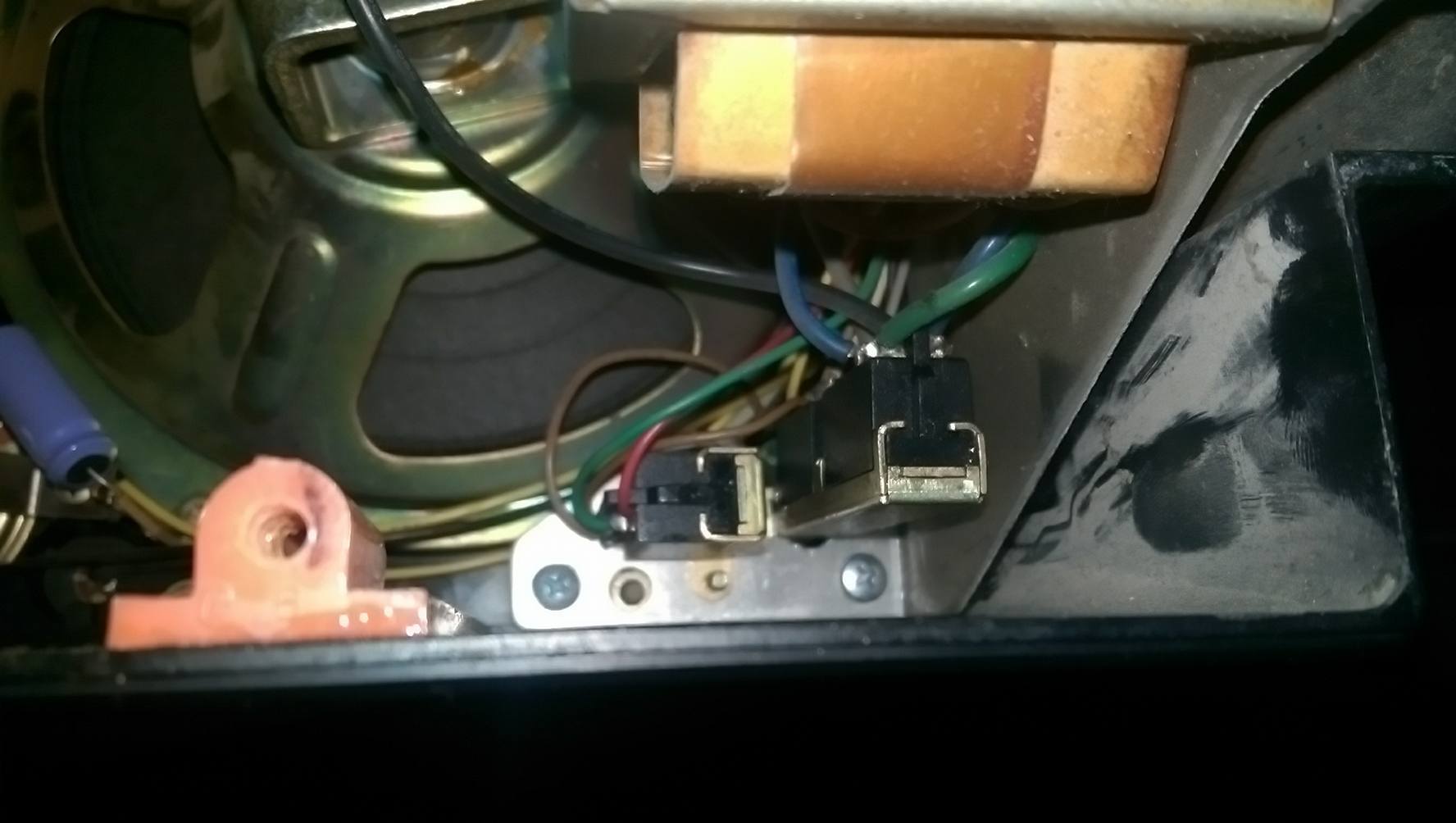

    here are the two switches that may cause the conflict

    have you applied contact cleaner to the switches ?

    yep tried that now its on a long visit by my technician (and he is a slow turtle) thanks for the reply

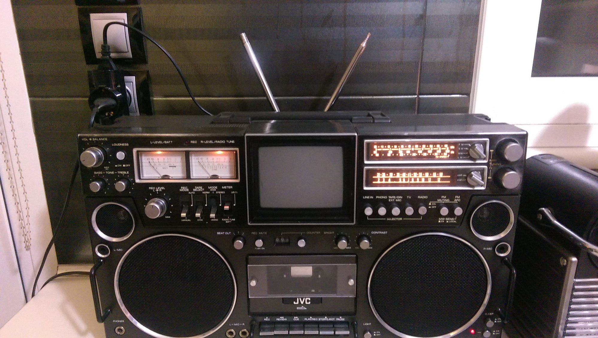

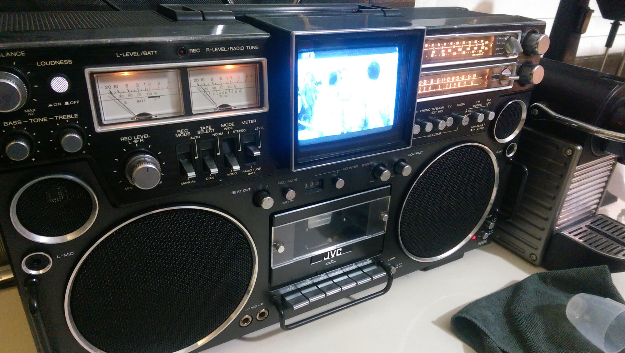

    Ok managed to fix the box.The killer?High voltage from our precious "State Electricity company" thanks for burning out a true jem of boomboxes.
    Still missing a cap for one antenna (hell i ll go make one) and a battery cover (helll i ll go make one too) Tape fixed All is good!
    Here are some pics enjoy!
    And who said analog is dead i even manage to get one channel! IMAG0533.jpg IMAG0531.jpg IMAG0537.jpg

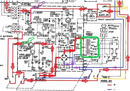

    I attach some pics of the service manual, if need more please
    ask.

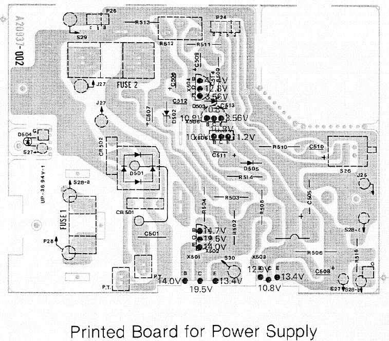

    diagram power supply.jpg diagram power supply2.jpg Printed board for power supply.jpg

    It is a bit difficult to tell what is going on without being able to see where the three connections to the "sleep" switch go. Do you have a test meter to start checking voltages ?
    I think the operation in the sleep mode is as expected. The idea was that if you wanted to play the radio (or TV) for thirty minutes when you in bed ready to sleep you could select sleep, pop in a C60 and and press play. When the tape ran out the unit would turn off.
    I have a Sony radio that has a clockwork timer for the same purpose.
    The question is why the box doesn't operate normally when sleep isn't selected.

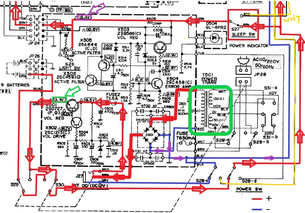

  17. Silver965
    Silver965 Well-Known Member
    630
    Torino

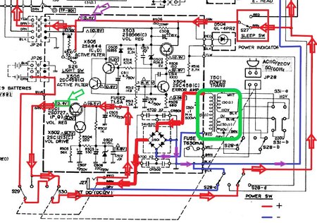

    Hello ... based on the first picture of the diagram It works like this ... Starting from the transformer (Green square) .. the voltage is rectified and filtered and reaches the external 12 volt socket .. go over the switch of the 12 volt socket and reaches the voltage regulation circuit (transistor 2SD727 + 2sc1213..Ec.) At the output of this stage (green arrow) there are about 13.4 Volts .. following the red circuit, on the Sleep switch you will have to have 13.4Volt. ..but also at the output of the Sleep switch you will need to have 13.4 Volts (Purple arrow)

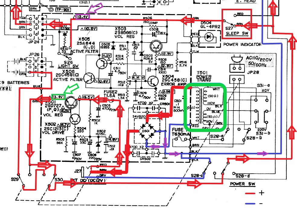

  18. Longman
    3,663

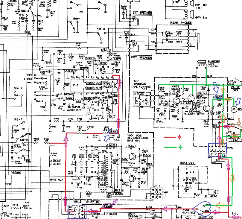

    Nice work on the annotated diagram. Mine isn't so neat. My question was what happens with the third connection yo the sleep switch and the connection next to it ?
    It would also be helpful to work out which position sleep is on the switch. Finally is sleep supposed to be independent of power or do they both need to be activated ? You might be able to find that in the service manual.

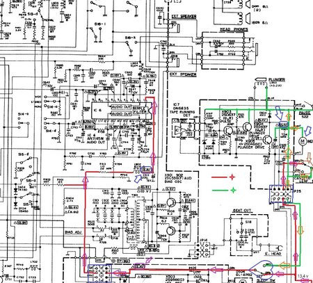

  19. Silver965
    630
    Torino
    In the second image of the circuit it continues like this ... the 13.4 volt power supply (Red wire) reaches the cassette leaf switch ... then (green wire) it powers the motor and other parts ... but returns to the SLEEP switch .... therefore in the two positions the Sleep is powered ... in one position directly from the power supply and the other indirectly by the cassette leaf switch .... at the output it feeds the audio integrated ... So if not pass the voltage you will see the engine turn but you will have no audio

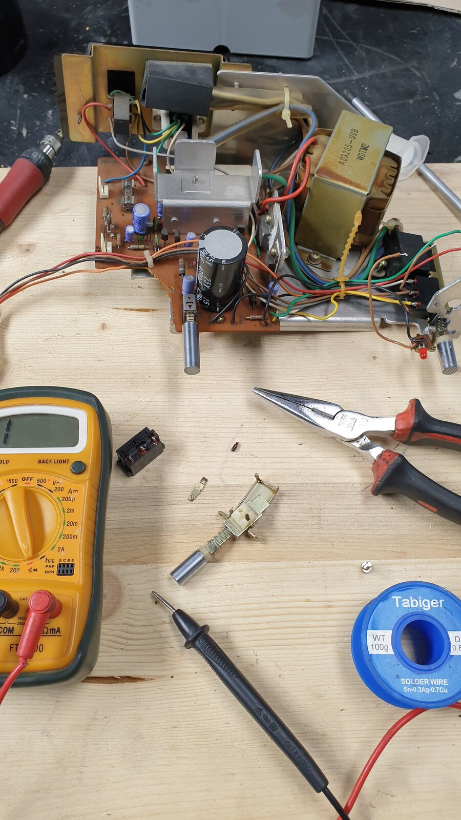

  20. Robboape
    Robboape New Member
    7
    Italy
    I followed your instruction checking the voltage and at last I found the problem.
    The SLEEP switch. A tiny black chips burned in the switch. I fixed all and seems that everything works well.
    Next week I'll receive the small 6v bulb and I'll reassembling all.
    I'll share some pics.
