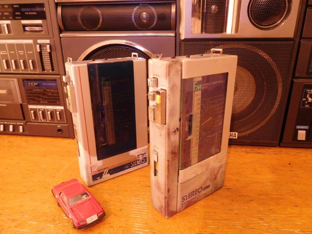

    Yep, going through some old threads while looking at a box of players that hadn't been out in a few years. I know I had some decent Sanyo's and Toshibas from back when I could find them for a couple bucks. I did it, I'll admit it, I left some batteries in. Here's what a few years of rotting batteries will do... And these were in mint condition when I bought them....
    autoreverser likes this.
    14,117
    They both had the plastic cover with the flocked lining, I think the flocking helped spread the acid...

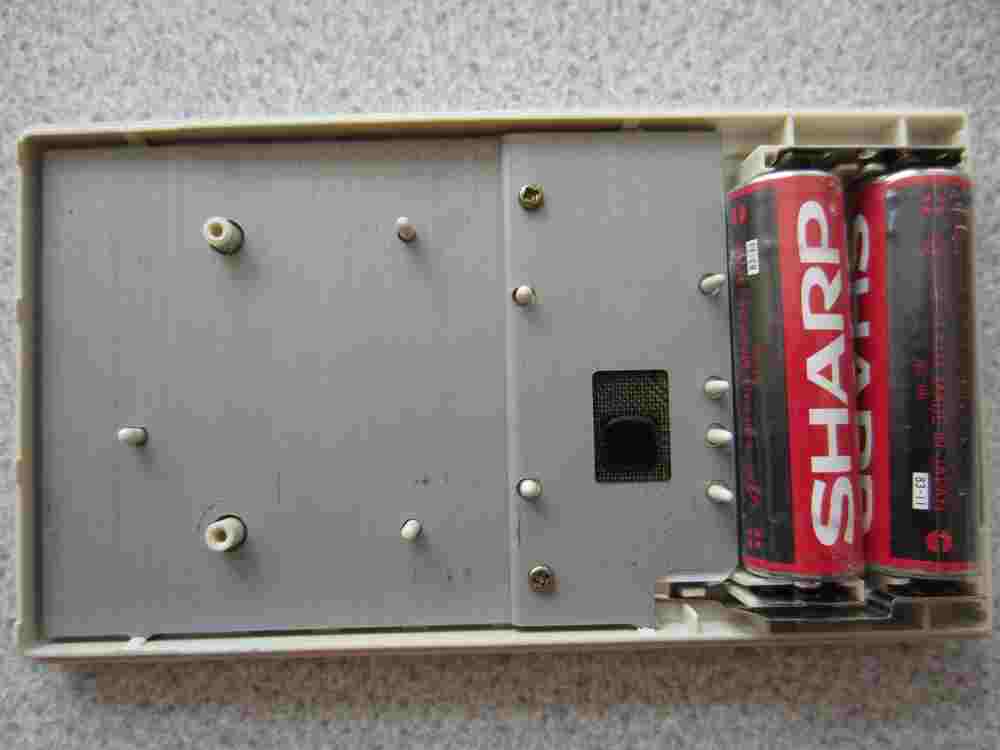

    In contrast about a year ago I bought a Sharp calculator at a car boot sale. Although it is working perfectly I decided I had better check the batteries.
    1983 (which ties up with the age of the calculator) but still going strong with no signs of leakage.

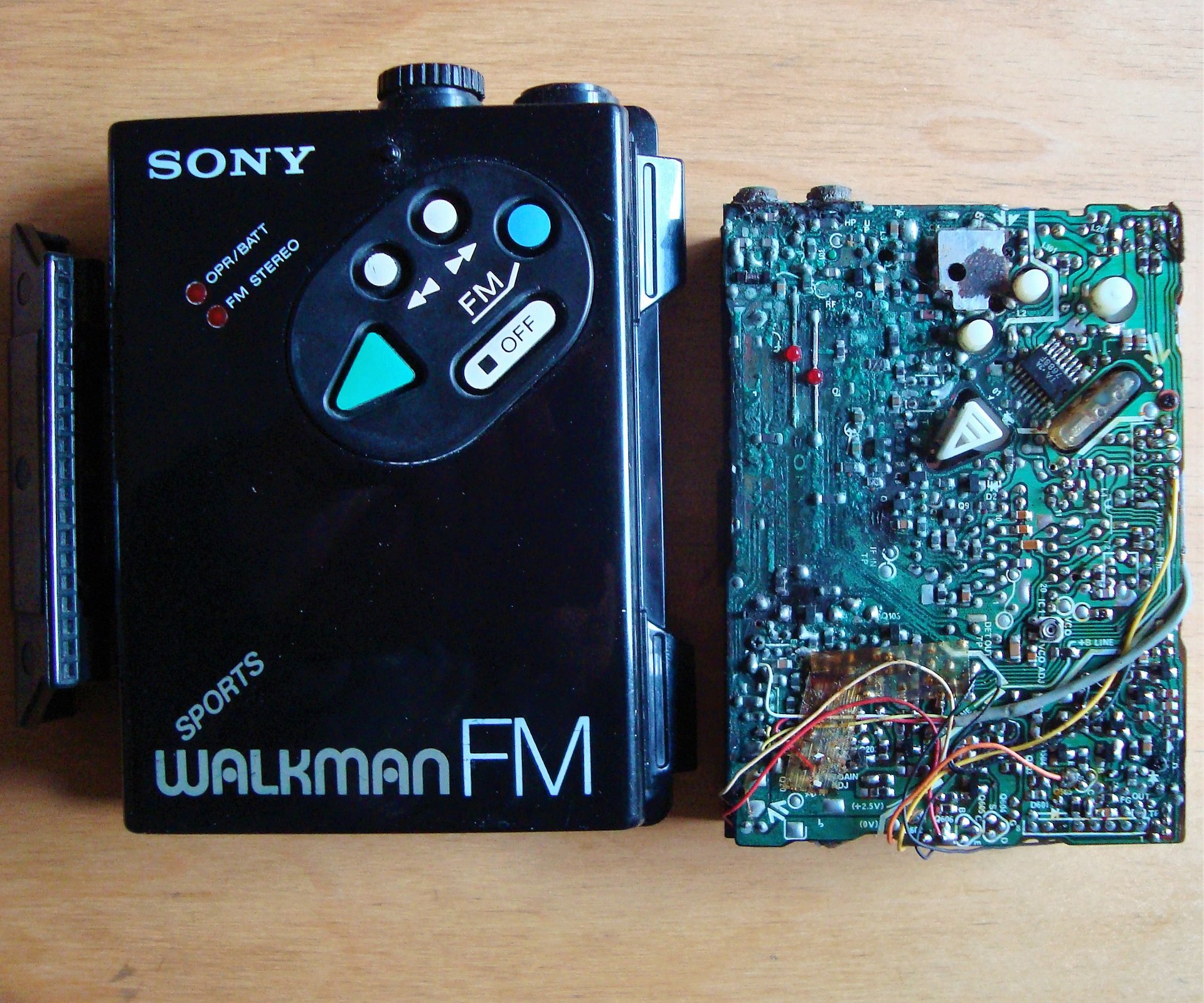

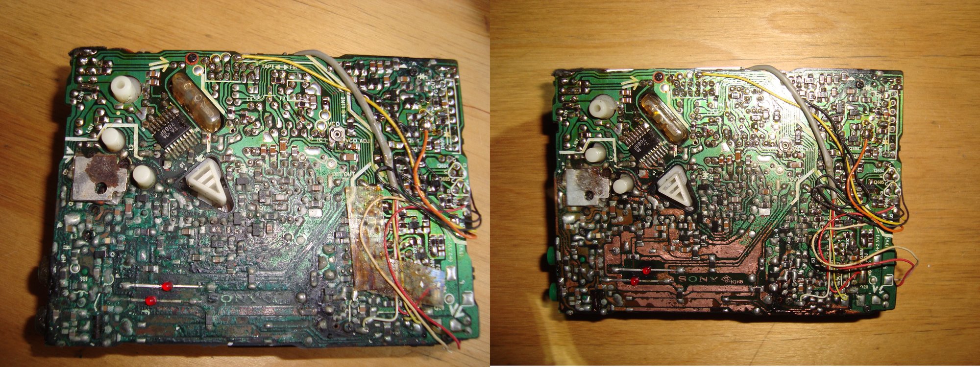

    Had bought this one, in this condition, because of the somewhat rare black color and a couple of weeks ago started to clean it just to see how extensive was the damage .
    It seems it has some hope to bring back to life but a lot of work also , it is impressive how the acid was dissolving copper under the protective paint.
    Note that most of the damage (naturally) is just under the battery compartment area.

    If all it did was rot away the copper it would be possible to replace that with wire links.
    The problem I had with the Casio was that it seemed to have soaked into the circuit board making it conductive enough to mess up the operation
    e.g play one note and get two. I spent hours cutting tracks at each end and replacing them with insulated wire, but as noted in my last post,
    each time I fixed one fault another would appear a few months later.

    Most certainly that's how the acid found its way to the printed circuit, through the circuit board, from the batteries side. Actually the circuit board on the battery compartment is heavily discolored from brown to almost black.
    I'm not super optimistic about it working again, it just has a chance.:shrug:
