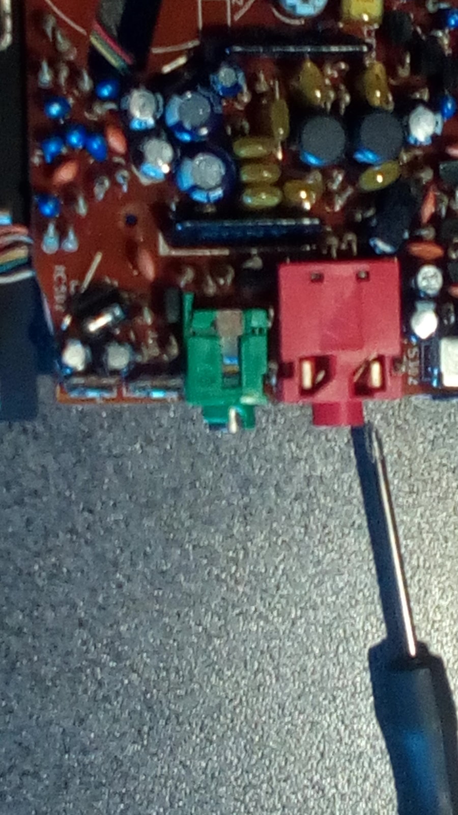

    Hi there
    Does anyone know a source of replacement D6C headphone sockets, the green one? Either generic or approved stock is super.
    Plastic on mine has degraded with age and now split, temporarily repaired with cyanocrylate glue, which won't last long.
    All avenues or help welcomed.
    TIA
    Greg

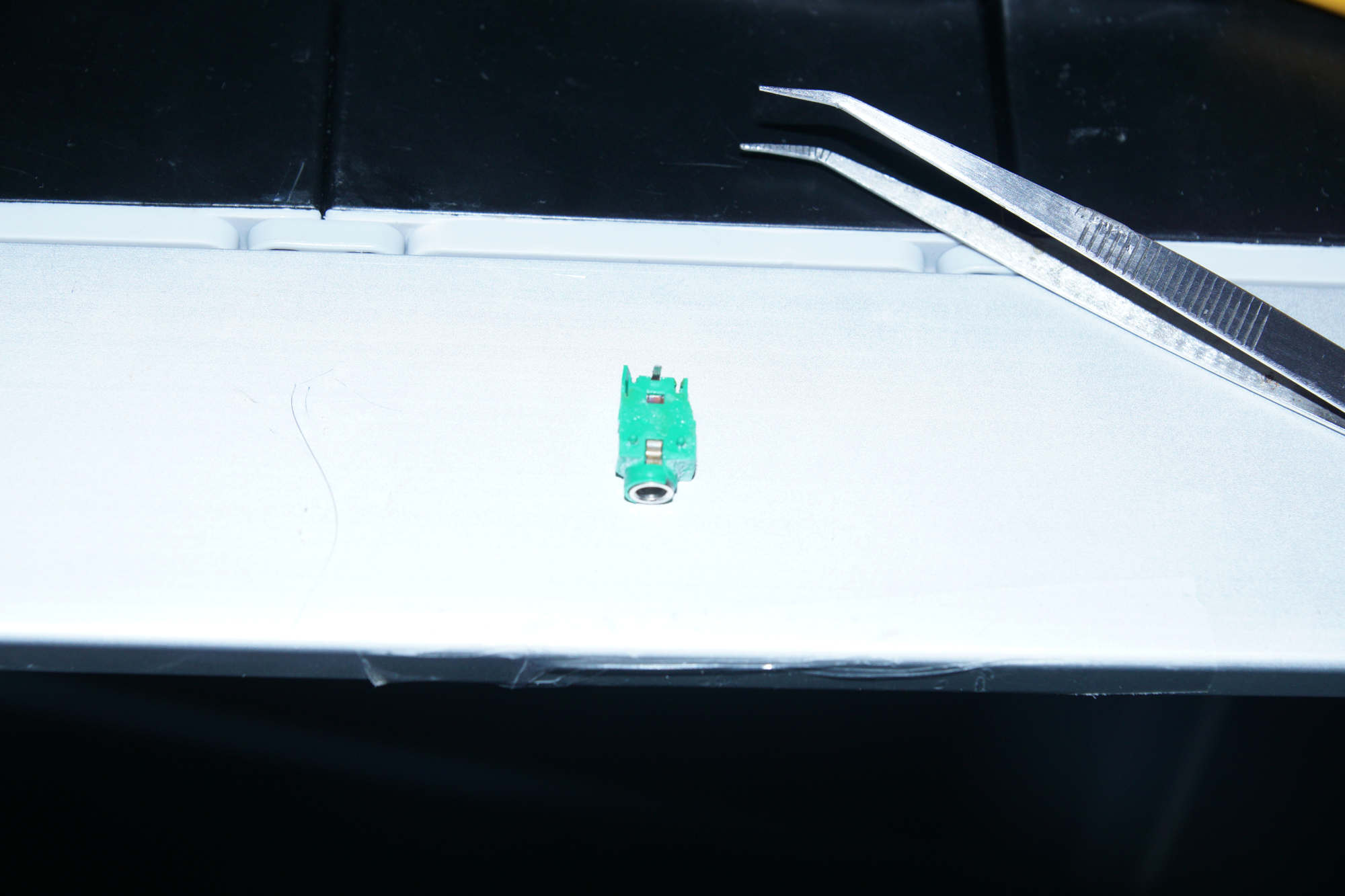

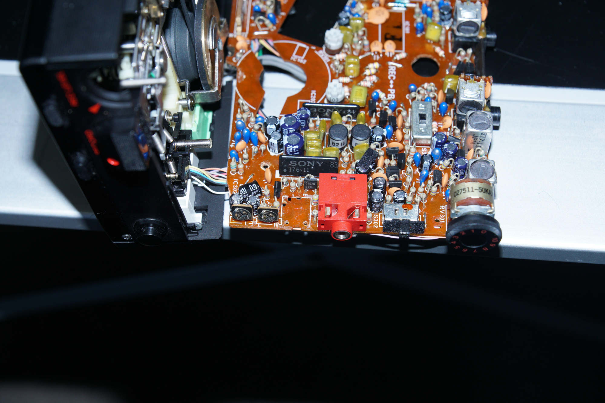

  2. greg
    greg Member
    65
    ENGLAND
    Extra pics: DSC05345.JPG DSC05346.JPG

    UPDATE:
    Commercial new socket search was fruitless. I went through thousands, quite literally.
    Sourced a black line-in D6C socket stripped and sold on the *bay. After pictures from the vendor, it seemed like it would fit. Arrived from Germany to the UK in a few days, soldered carefully in and works a treat.
    So, that's a very positive result, if you can source a used/stripped black jack from a WM-D6C, they fit the green headphone jack/socket solder holes on the PCB I can confirm. I'm not sure if this is just revision 1/ or revision 2 or all of the revisions until it ceased produiction.
