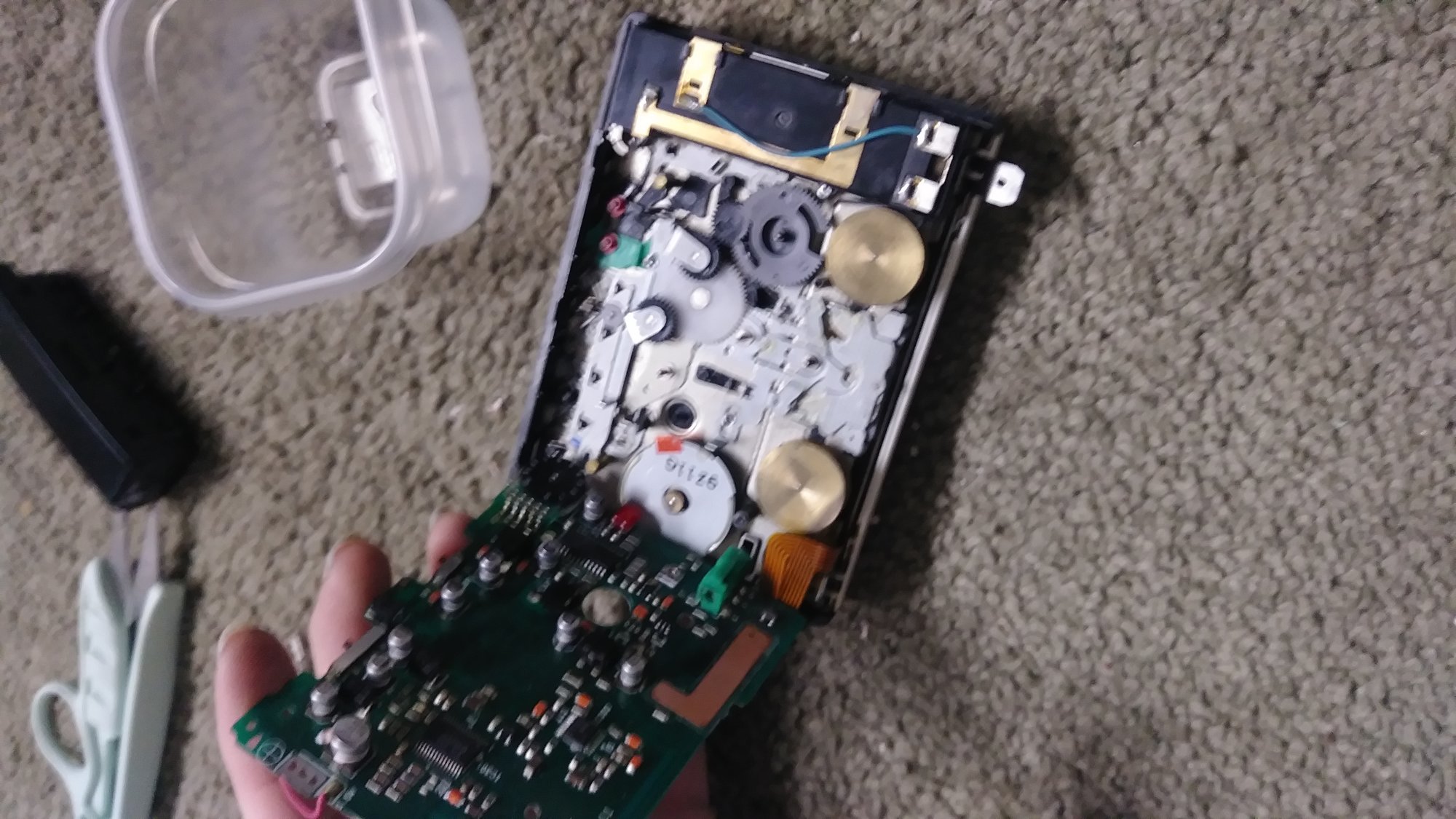

    ok, so I finally got it open, and oddly enough, two wires were already detached and there's no belts whatsoever. for this I'm definitely going to need a service manual or at least info on what kinda of belts it takes and how they're placed.
  16. daisy perry
    daisy perry New Member
    9
    pa
    here's the inside
  17. bub
    bub Active Member
    259
    Singapore
    Unfortunately your machine is missing several mechanical components as well. The clutch gear and takeup reel gear, both often found broken in WM-150 mechanism Walkmans, are missing. It seems like the revious owner either cannibalized them for another machine or disposed of them.
    You will need another mechanism to source the parts.
    autoreverser likes this.
  18. autoreverser
    1,757
    yep, unfortunately bub is right - this is an ex-f606 - sad, but that's how it is, you got nicely ripped off :badmood:
