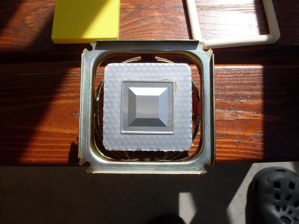

3) I used non-acetone nail polish remover to get rid of the old foam and glue. What worked well was taking some flat cotton bits, and soaking them in the solvent, and laying them diectly on top of the glued bits (after scraping off the foam and some glue beforehand). Let it sit 1/2 hour, and that old glue swells and is really easy to remove. See here the result:

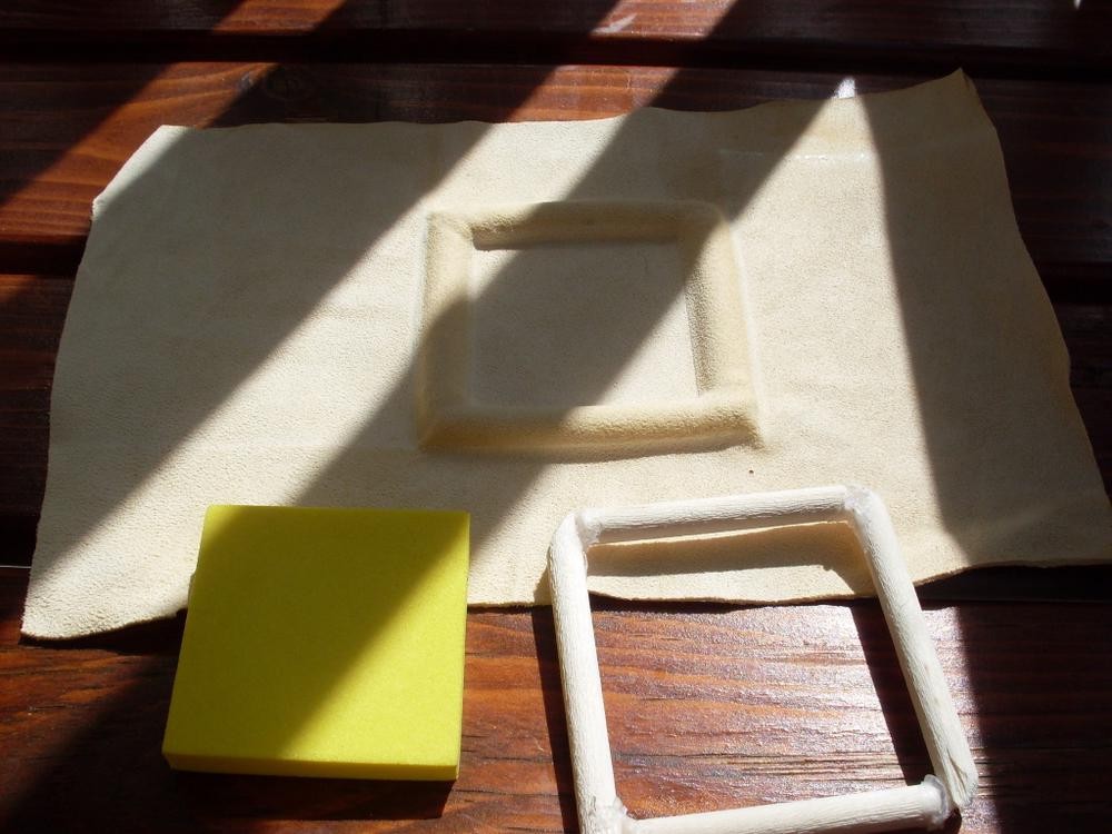

In the next picture, you can see my template which consists of some wooden plant stalk holders which were cut and glued (glue gun). The leather chamois was soaked thoroughly before pressing into the mold. The yellow foam square (courtesy of my 2.5 year old's "learn some letters" kit), fit perfectly inside to keep the inner shape (pressed down with 1 glass of water for weight). I used flat table coasters to meet the outer edges and keep the shape (pressed down with 4 glasses of water for weight). Then sprayed the hell out of the exposed "bulge" with starch, followed by some savage hair-dryer action (to cook the starch a bit). Let it dry in place over night (what you see here is the next day after I took my template apart).

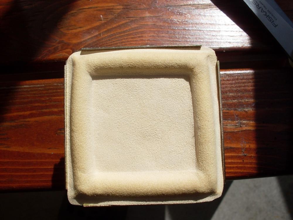

After an initial cut, I got this (note it is fitted inside the speaker frame),

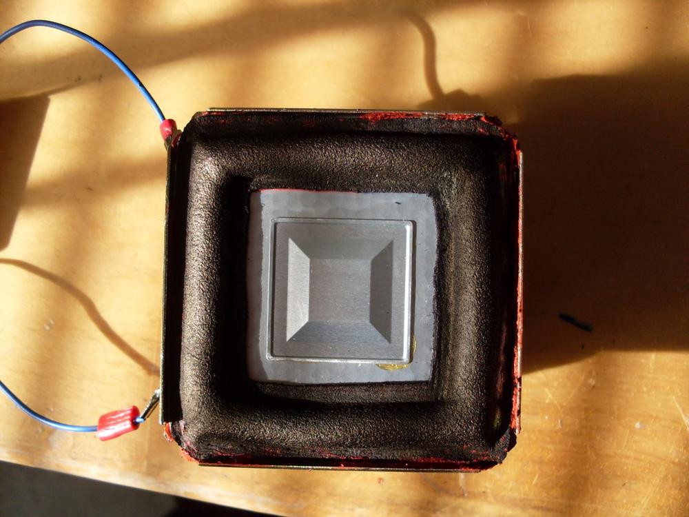

And some cloth dye action next

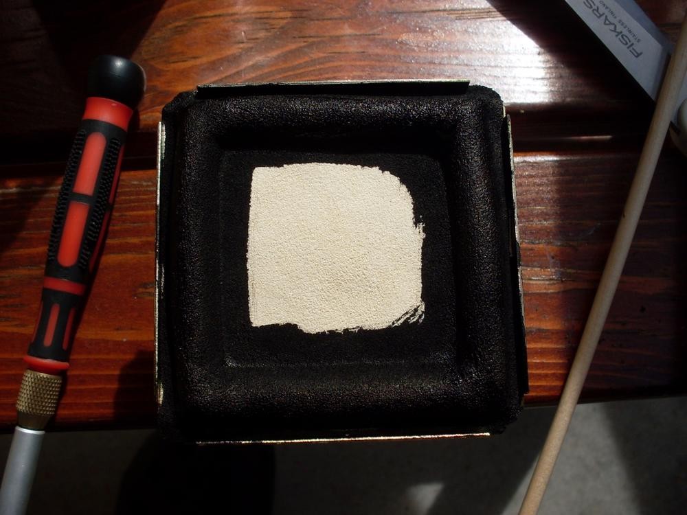

After this, one needs to measure and cut out the inside bit. I could have done a nicer job, but wasn't going for looks really, although I think one could carefully make these to perfection with some practice. And the final product:
Couple more notes. I used a 1.5V AAA battery hooked up to the speaker connectors to keep the "cone" in place, from the first gluing til it was dry (seems to have worked). I also used some silicon gasket sealer (high temp) as my glue. So, you see what you can get: maybe go with a clear silicon, as you can see some red poking through, although a cotton swab with some of the nail-polish remover worked well for goof-ups.
