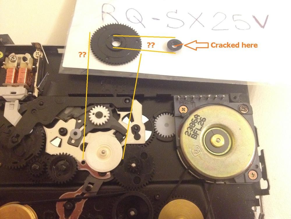

Hello Retrodos and fellows. I know this thread is over 2 years old, but I am trying to restore a very similar Panasonic model (RQ-SX25V) that has the same problem.
I wanted to ask your valuable help to explain more detailed how should I mount or adapt the cracked black locking washer back. I am attaching a picture showing separated parts.
I do not know what is the correct position, or how to glue it. Thanks in advance for your attention!
damaged_clutch2
marian.mihok - 2014-08-29 05:13
Hi.
This is common mistake - the black ring is not cracked. This "crack" or split exists there from the beginning. This black ring is specially shaped washer - it was split in order to be able to attach it to the center gear. However, after many years the plastic material looses it's elasticity, so it is not able to keep together.
If you want to glue it, you must do it while it is attached. Apply small amount of epoxy glue on the top of this ring. However, epoxy is not suitable for this kind of plastic, so it is not the best solution. Better approach is to glue small washer (or any plastic ring) on the top of the ring.
The best approach is to replace the small tiny washer that is attached to the top of the axis (the one that keeps the "cracked" plastic ring attached) with the larger one. In this case you do not need to glue anything and this is permanent solution.
Marian
bruno - 2014-08-29 05:54
Thanks man! I believe I can replace the tiny washer that forces the kit to be together. When I disassembled that, I noticed small fragments of white plastic that must falled from the wasted white washer.
I will update this post as soon I can replace it. Thanks a lot for your information! Best wishes.
