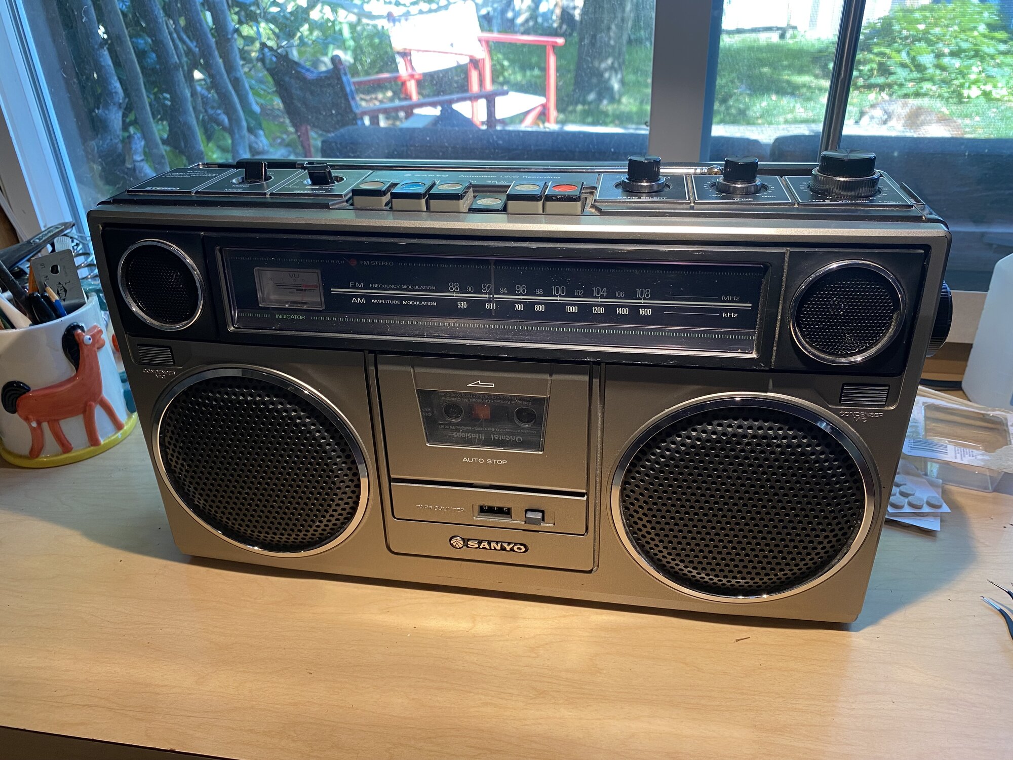

    I posted about this in AudioKarma but after being invited here I will also post my experience working on this unit.
    I’ve had this for a few years with hardly any issues. Got it for $25 at goodwill.
    It had normal old unit issues like crunchy volume and tone controls and sometimes slow reaction to FF and RW. I mostly use this to transfer tapes from the deck to my computer.
    But recently I accidentally hit record for a split second and then stop and play.
    After this I got a loud and low hum on the left speaker / channel. This did also appear when sending audio out to the computer.
    Based on some advice and research I ended up taking the entire thing apart. I eventually got the tape deck out attempting to keep good track of all the screws and wires I undid.
    I saw that the belts were unsurprisingly saggy and weak. I ordered some new ones and proceeded on to my original quest.

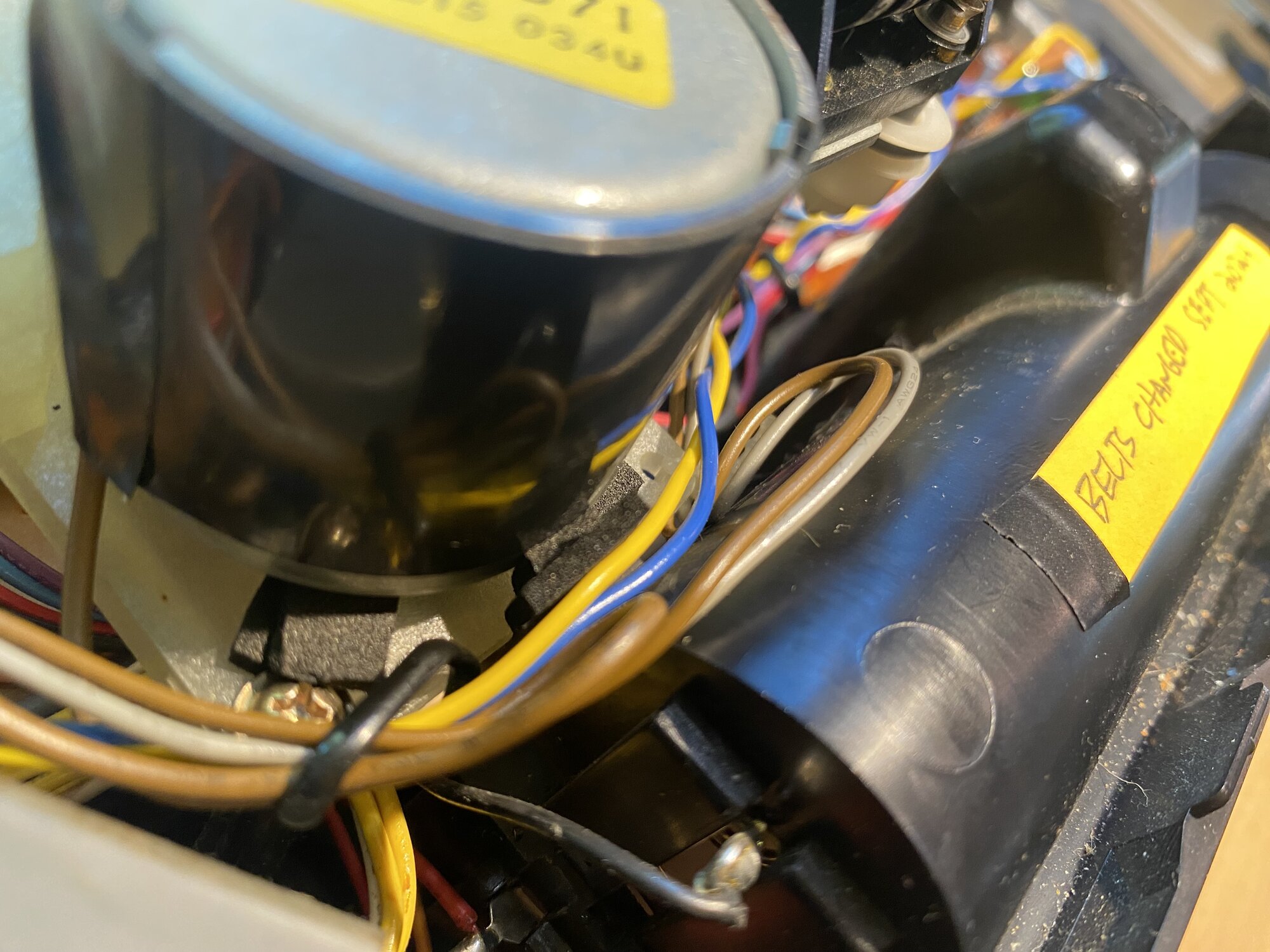

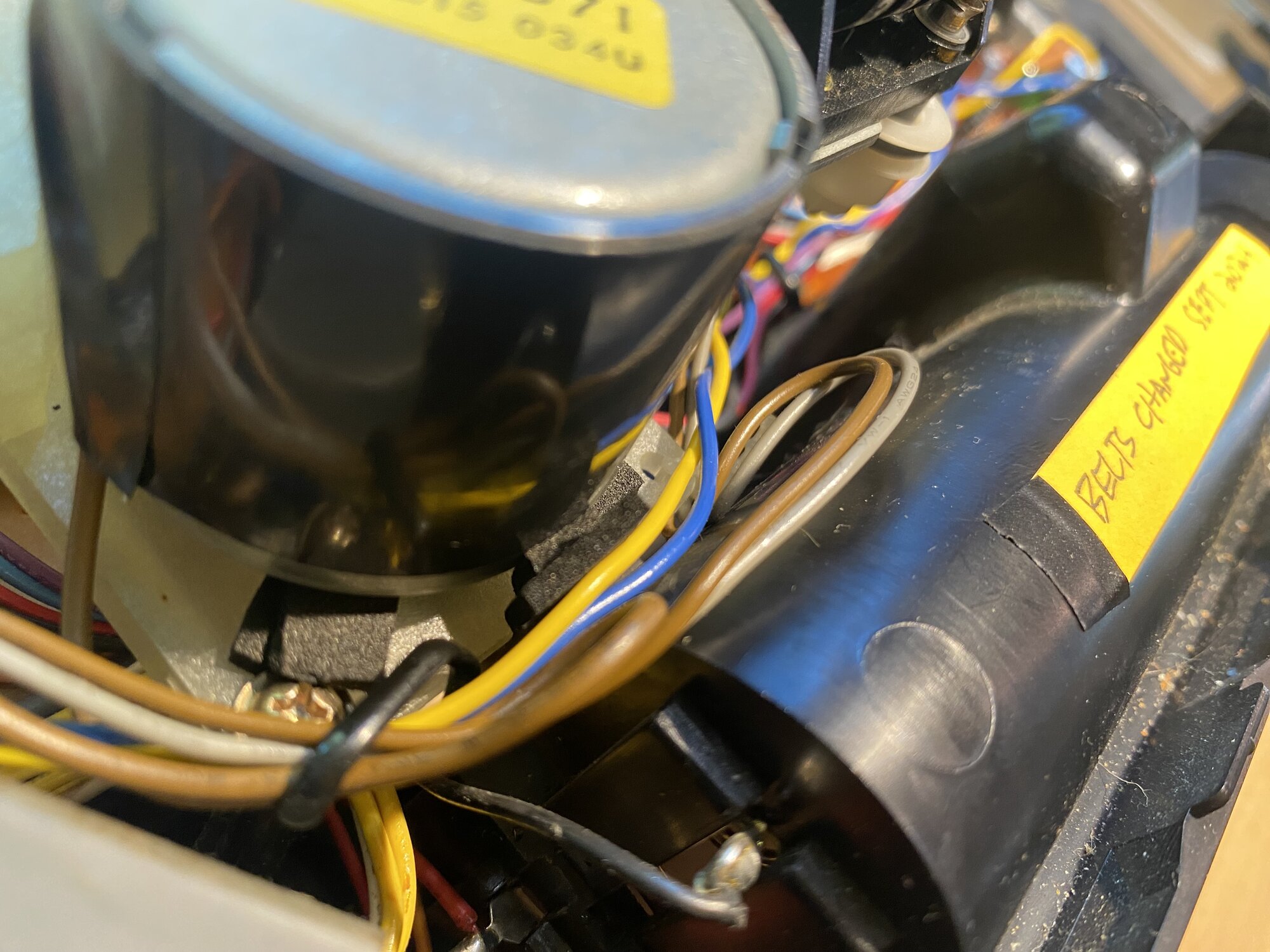

    The motor bushings were super flattened and shrunken which means the motor wobbles around in the housing. I later deduced that this is probably causing the occasionally persistent warbling sound. Bookmarked that for a future fix. In the meantime I jammed some cardboard between the motor and the housing for some stabilization.
    I couldn’t get to the backside of the circuit boards without major surgery so I just cleaned anything that looked a little dirty and shot some deoxit into all the switches and knobs. The recording switch doesn’t have any holes but I just shot deoxit into the edges.
    cleaned the tape heads, roller and capstan.
    Put the whole thing back together (no extra screws!) and viola! The hum was gone.
    this is when I noticed the warbling sound and also ordered belts.
    The other new and unaddressed issue is that AM radio no longer works at all. There’s no static or noise. Just zero. I must’ve screwed something up while poking around. I can’t seem to find the issue. Another user suggested cleaning the AM diode etc as I might’ve (and likely did) gotten deoxit in there. I cleaned everything near the radio components again and looked for any obvious disconnects. I also tried to get some deoxit in the AM/FM switch but that has very little access.
    No progress has been made on that. AM still no longer works.
    I should also add that the AM/FM knob was so severely stuck on it was the hardest part to get off. I wonder if I broke something getting that off.
    I tried to lube up that knob second time around but it was still severely stuck. I’m going to shave down the knob plastic or just order a replacement knob.
    That’s the journey for now. I’ll add a bunch of photos from the internals which were surprisingly clean when i figure out how to on this forum from my phone.

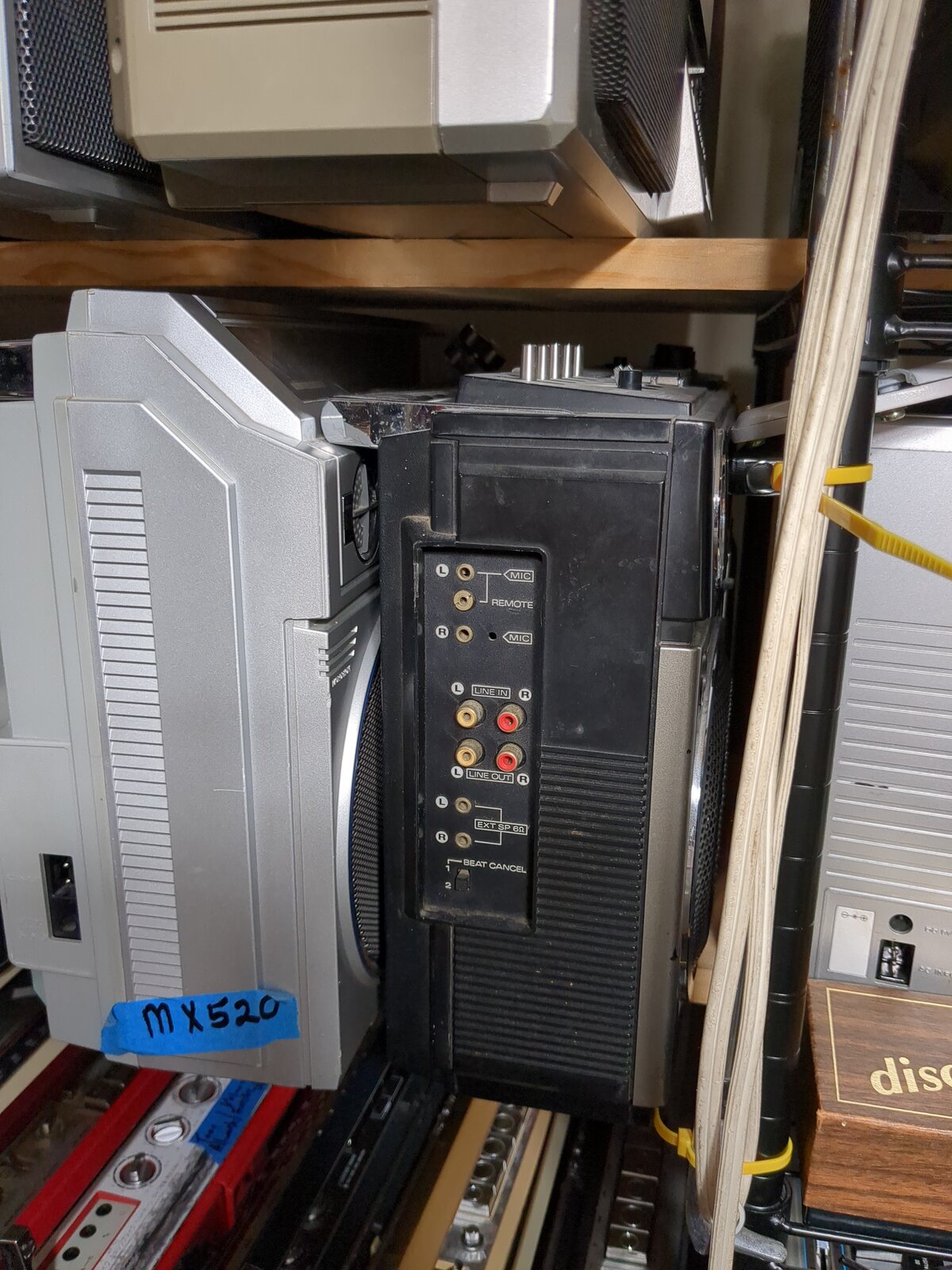

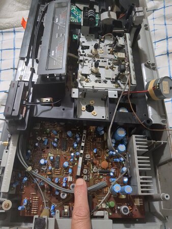

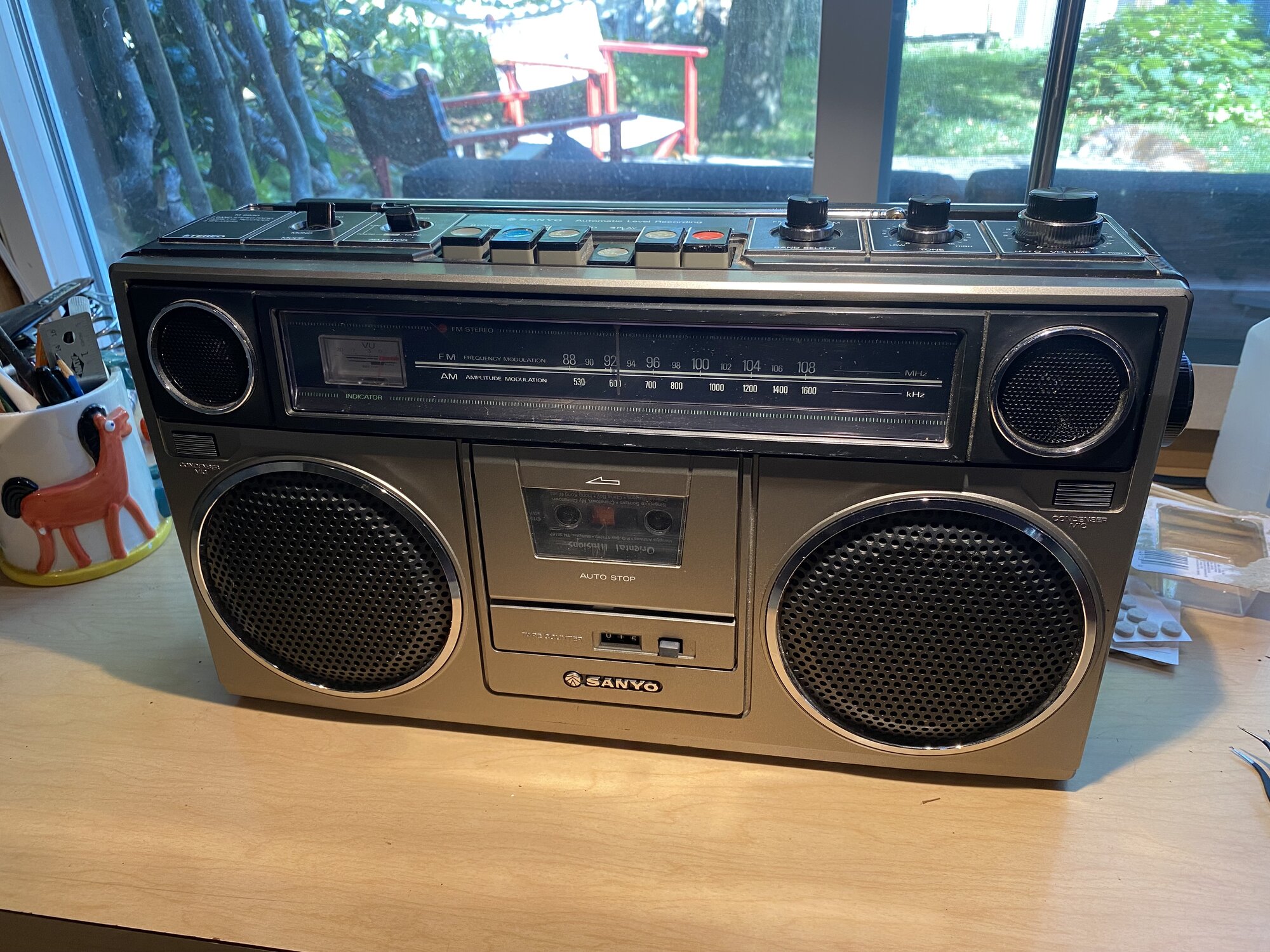

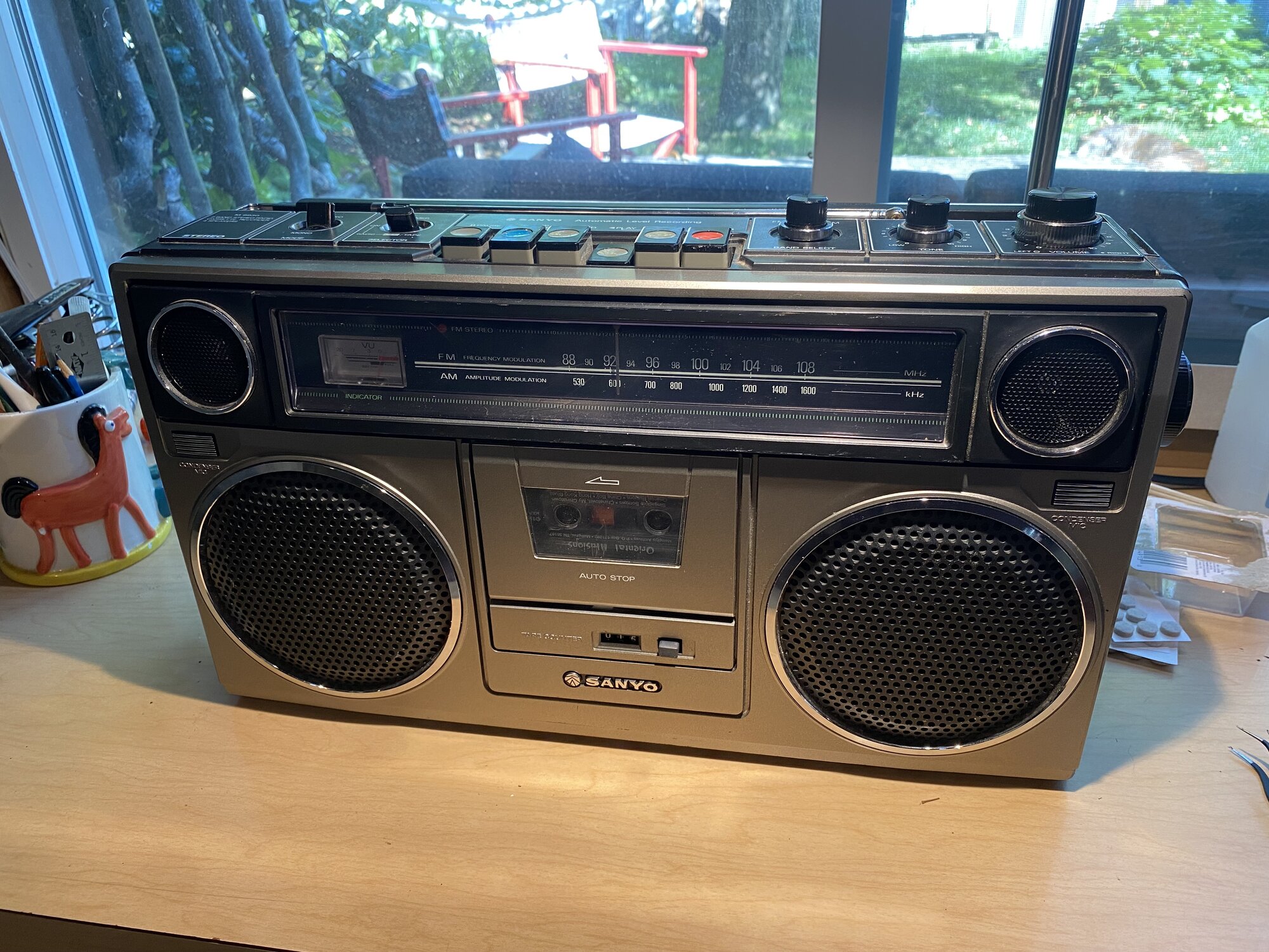

    I just took a look at your picture of your deck and realized and remembered that hey, that motor does not have a speed control on the motor or separately. Therefore, you cannot change the speed of your motor because it is set from the factory and once it's internal weights controls go bad. Then you have to simply replace the motor with another one from Sanyo and those are very hard to find. I know because I found two of them a while back to replace in a couple units. I have that use the same kind of motor basically In this one 17245515911025461983196818372202.jpg
    The model number escapes m99 m990 there's three nines m9990 not there. We go great me at the moment but I remember it someday and there's a couple more that use the same motor 17245516538916944276939974340449.jpg yeah there is a m9999 4. Only three nines and a four k and then we have a m9999 4 with no k.

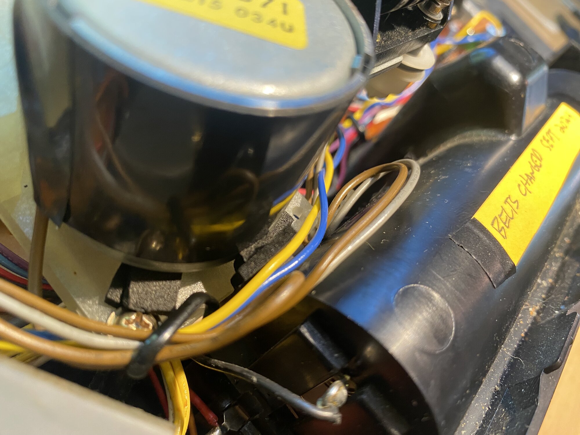

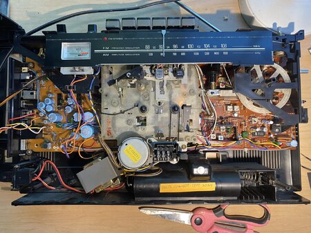

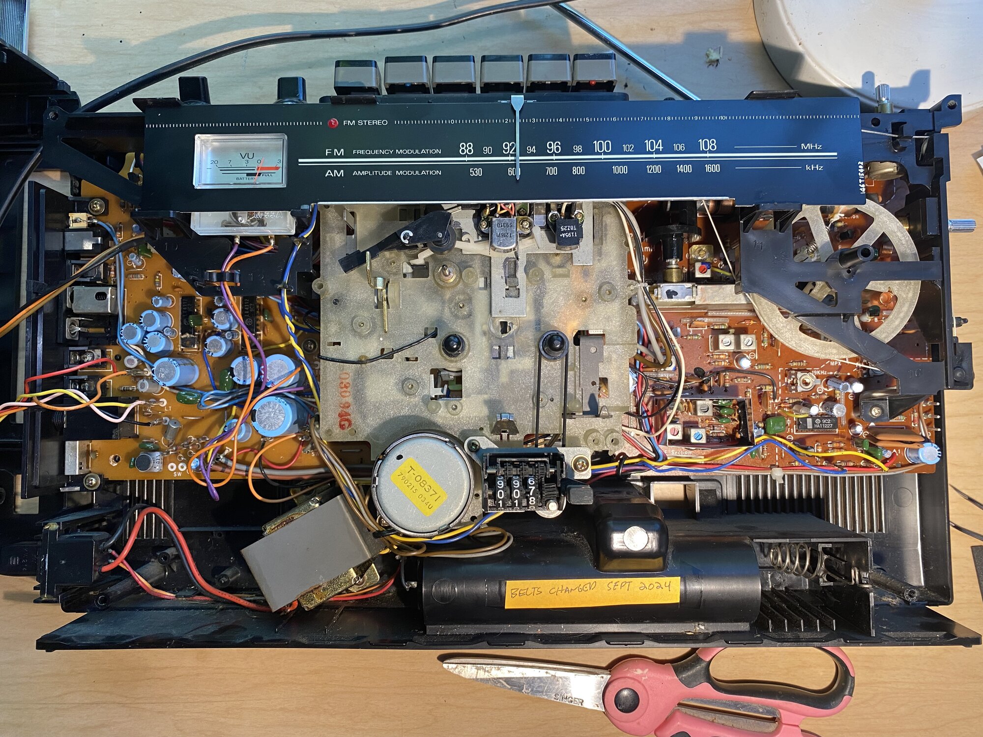

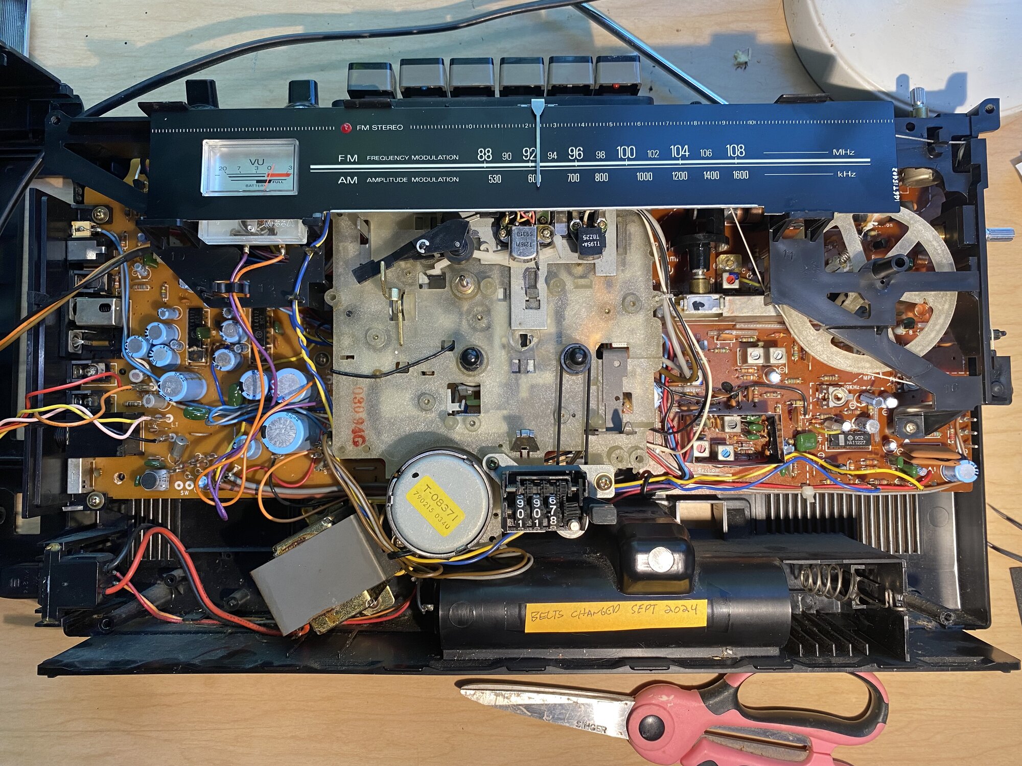

    IMG_2010.jpeg Little update.
    I got the new belts in the mail this morning from China. About $8.50 compared to the US seller that was selling for $34.
    Since I had already taken this apart troubleshooting the low hum it was easy to get the deck mechanism out. Getting the old belts off and new belts in was pretty simple. No major issues.
    While in there I did put some little foam insulation between the motor and the deck to make up for the shrinking of the bushings. everything is working much better.
    No major warble sound anymore that I noticed. Kind of hard to tell since some of my tapes are so beaten up. But the tapes I know are in better shape sound great.
    It’s amazing to have rewind and FF without coaxing the motor into working. And fast!
    When I rewind there doesn’t seem to be auto stop however. I could have sworn it would before.
    hmmmm.
    That is it for now!
    Thanks for the help everyone.
