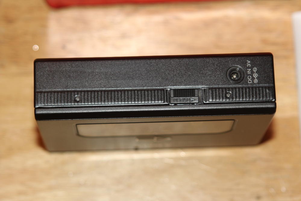

Like the D6C the DC2 has also seen some changes during its manufacture. One easy to identify difference is the door latch. changing from a metal silver one on early units to a black plastic one on later examples. Although not an exact science, is a good indication it is an earlier unit. Oldest units seem to have metal door latches unlike newer ones with plastic in either black or more rarer silver.

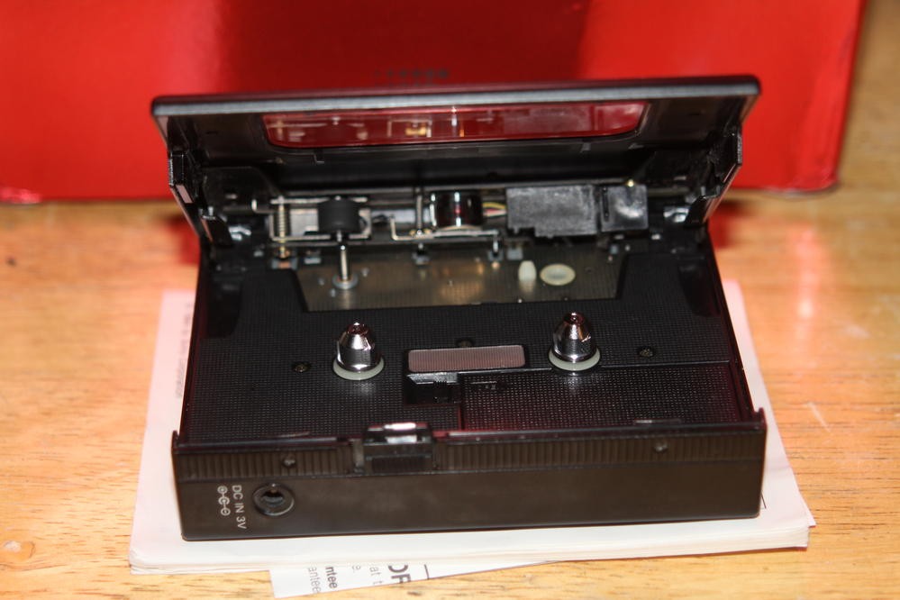

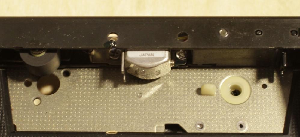

This is a photo from a DC2 c.1985. The head is labelled with the word 'JAPAN', most likely the country of manufacture. The shape of this head is more angular than that of standard heads, with a noticeable central protuberance . There is a grub screw to the right hand side just visible left of the azimuth screw. Anyone know its purpose?

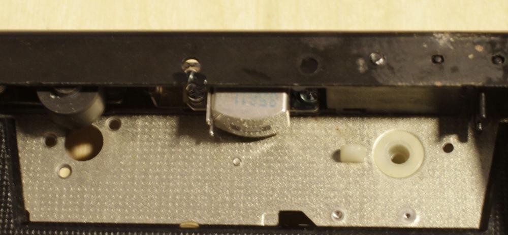

This is a photo taken from that of a DC2 with a production stamp of 1989. No country of origin is now present, instead there is a part number in blue that simply reads '35611'. The head profile is more rounded than the previous one and thus similar to standard heads.

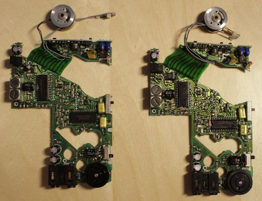

Here are the PCBs from the same two units. The one on the left is the newer example and the one on the right the older example
Notice on the older board there are a number of additional parts particularly around the Dolby IC chips. On the new board the 47uF tantalum has been replaced with a cheaper electrolytic capacitor. Also the green coloured full sized diode has now been removed from the older board and a SMD resistor added.

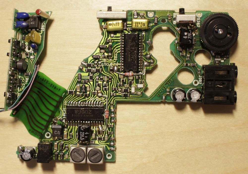

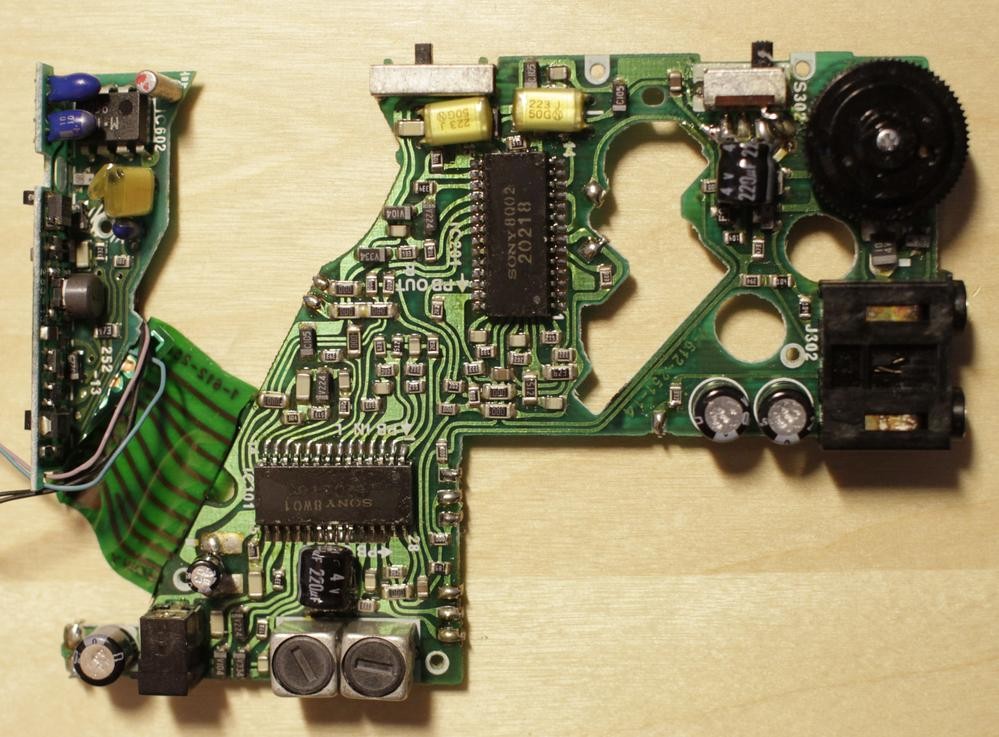

The Dolby IC chips are also changed. On the older unit they are Sony type 20068 and on the newer unit Sony type 20218.
Close up of the older board
Close up of the newer board
