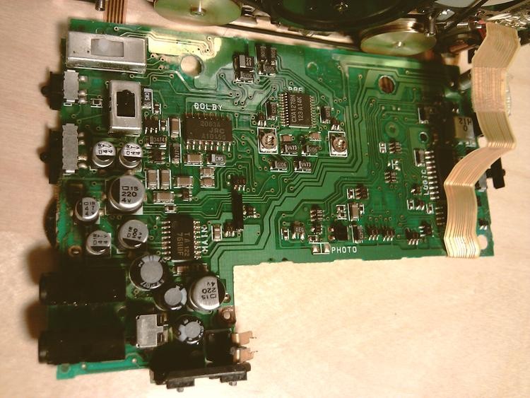

Anyway, upon opening it's the usual story. sticky corrosive electrolyte everywhere. As you can see below the ground point next to the internal battery terminals has nicely crusted up to a white colour. The mic socket is also covered in a nice dark brown gloop.

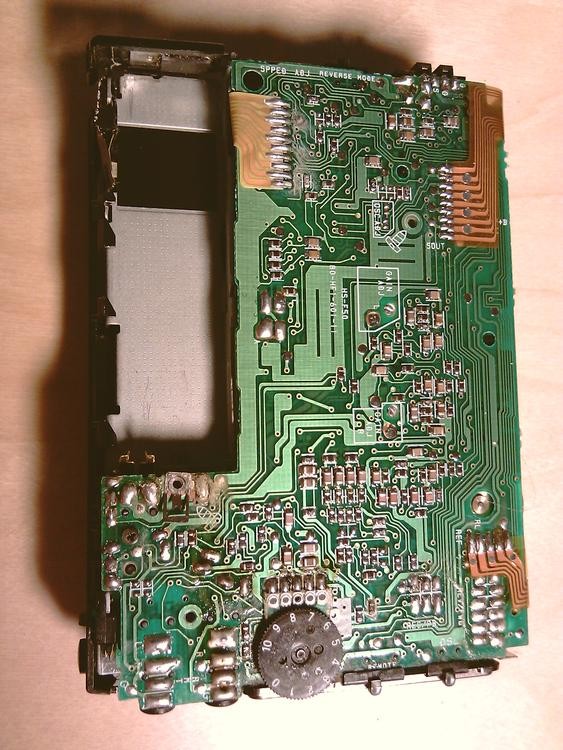

This is what it looks like underneath.

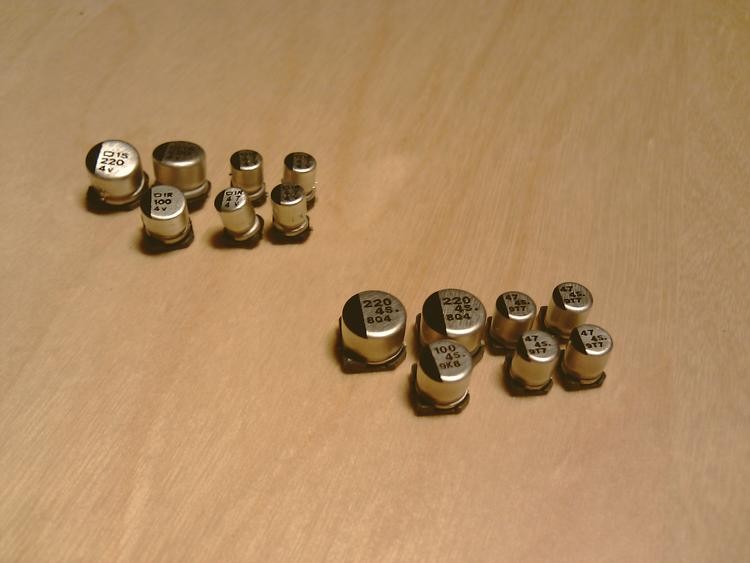

Whilst the board is drying it is time to tin off the new caps. Here they are bottom right to the crappy dead ones on the top left.

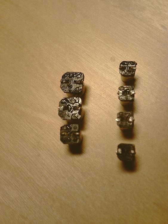

This is what the bottom of the leaky caps look like - nice.

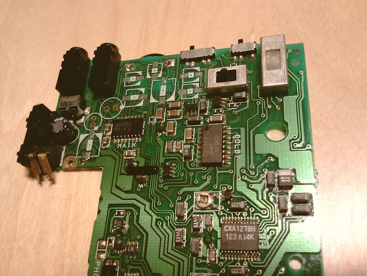

Now it's time to get the board out and re-tin the contacts for the new caps.

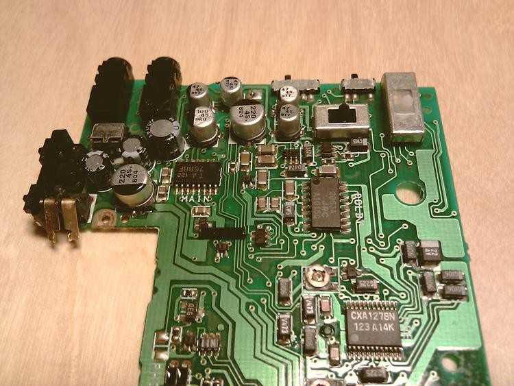

Then fit the new surface mount capacitors and reinstate the good through hole capacitors.

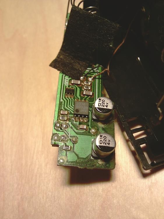

The external speaker has two 220uF 4V surface mount capacitors. These too were of the same brand as the leaky ones in the main unit. They've nicely corroded the tracks underneath the conformal.

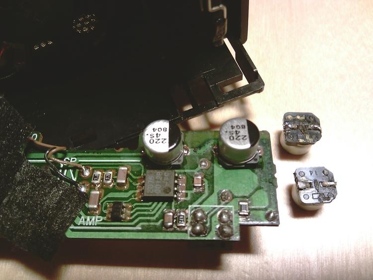

These are removed and the board is cleaned. There isn't much I can do about the corrosion under the conformal. It will have be left as is until perhaps another time to remedy.

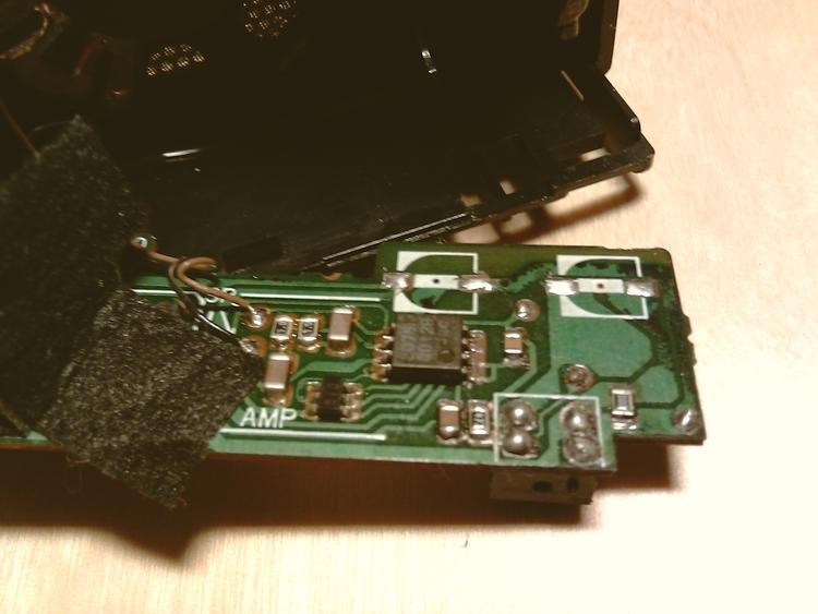

The contact points are retinned, along with a few components where the points have oxidised badly. The new capacitors are fitted. Along side are the old caps. These tested exactly the same as the 220uF from the main unit.
