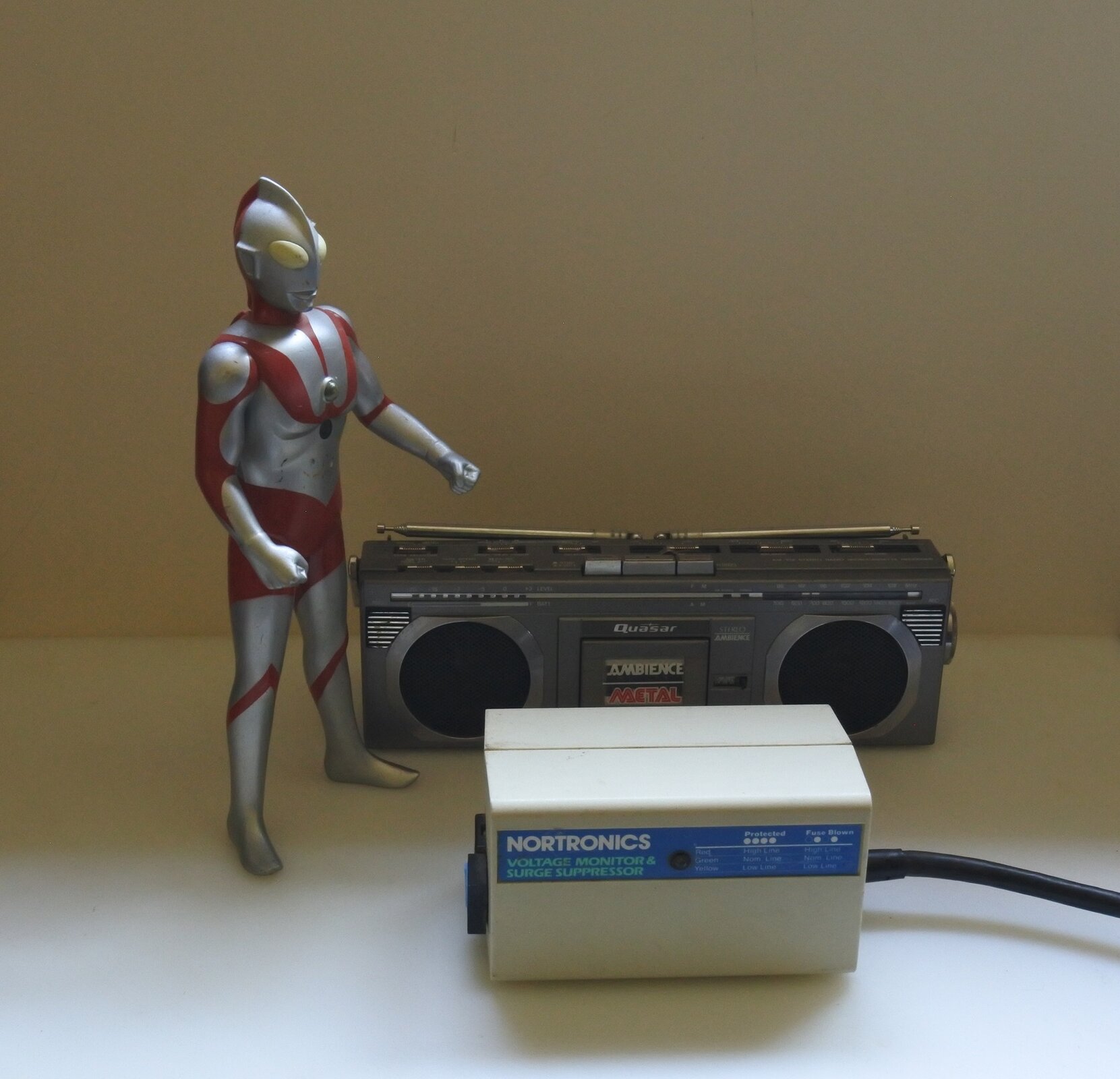

    I pulled it out, I was wrong, it's heavy duty plastic (Made in USA!) from Nortronics and it's only a voltage monitor & surge suppressor. Nortronics was big into replacement tape deck heads and dabbled in many other areas before being sold (and name changed) in the early 90's. I believe these were made for audio components since most of the product line also was. The wire is marked 14 guage but it feels like 10.
    Ultraman is wondering if you have any of that HM conditioner for his noggin?
