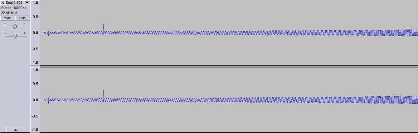

    3. When I played a 20 - 20000 Hz sine sweep, there's an odd bump at the lower frequencies (see attached image). This does not happen to my Walkman (WM-SXF30)
    I'll be more than happy to receive answers to any or all of the above issues, especially the bad treble
