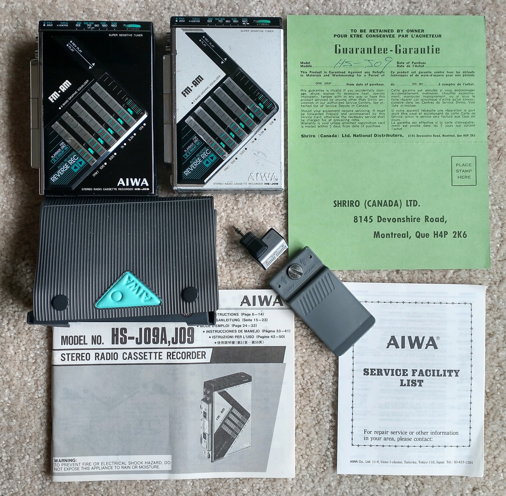

    In the various photos of the units, there is one repaired battery lid, one new battery lid, one replacement white button, 2 black buttons and one tape direction window.

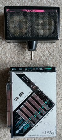

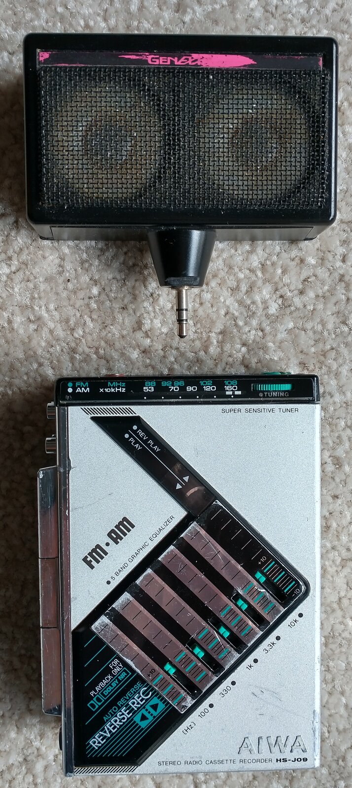

    My attempts to embed images in the opening post didn't work out so well. Maybe this will work.
    The original HS-J09 after many cosmetic repairs and with the stereo non-powered non-bluetooth speakers.
