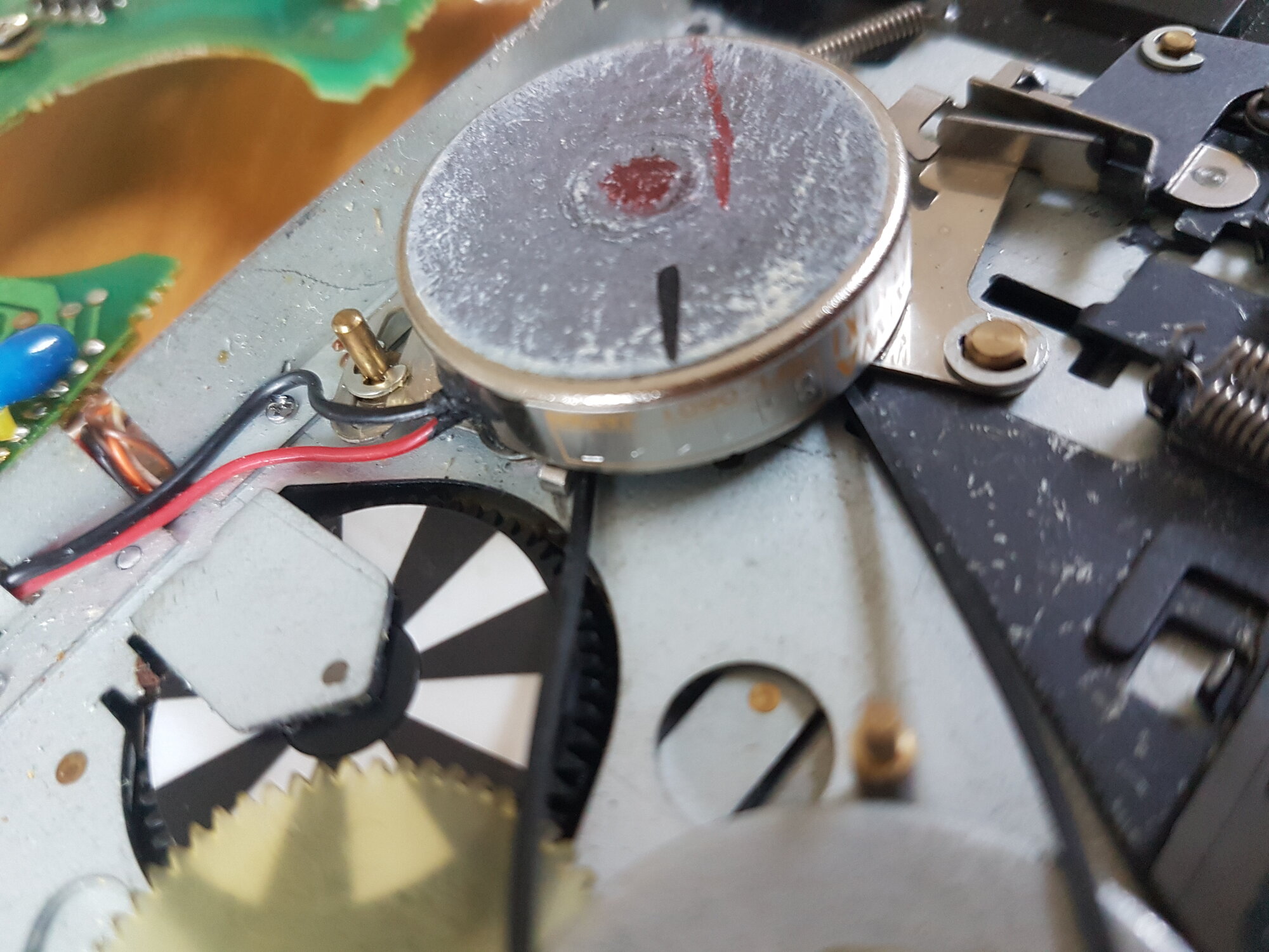

    Hello! I've been working on an Aiwa hs-p06 sporadically now for a while and all it needs is a new belt (it sounds wobbly) but I've ran into an issue where when I play a tape you can hear this crackly buzzing motor noise through the output. It also used to have a squeally motor but I fixed it with some oil. I think it could be a grounding issue but i'm not good at that kinda stuff.

    Update: I resolved it by re soldering some bad looking connections and a drop of oil on the motor (the bad connections were probably due to this being my first recap job). Really nice sounding Walkman.

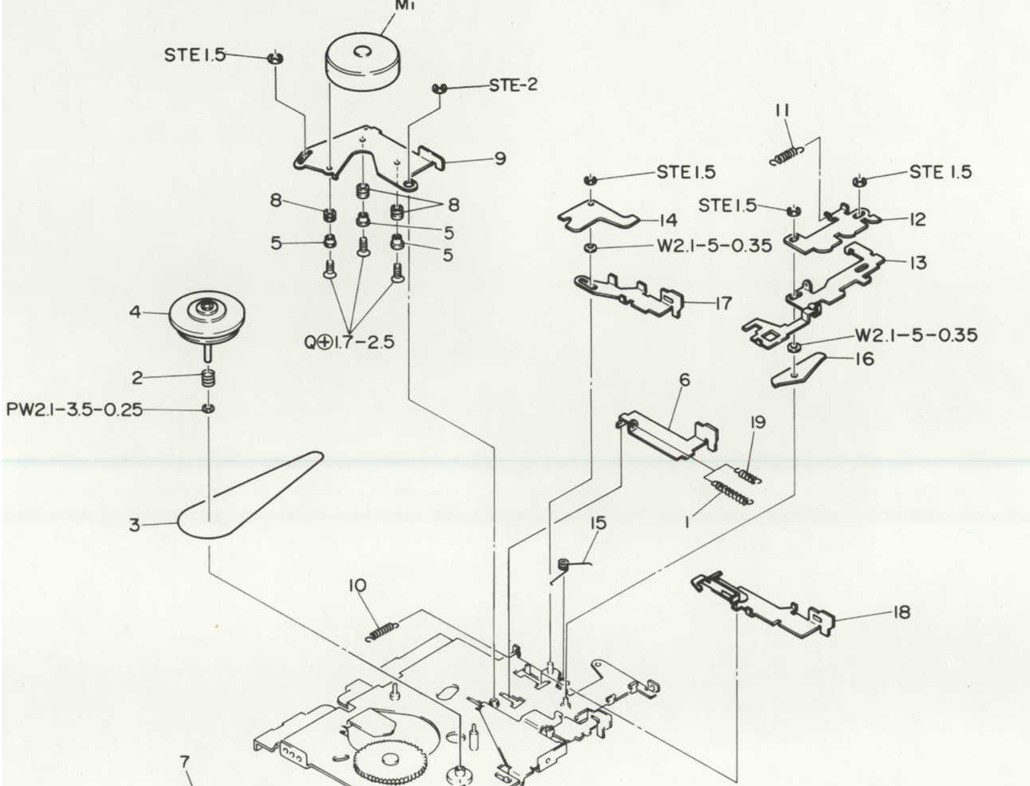

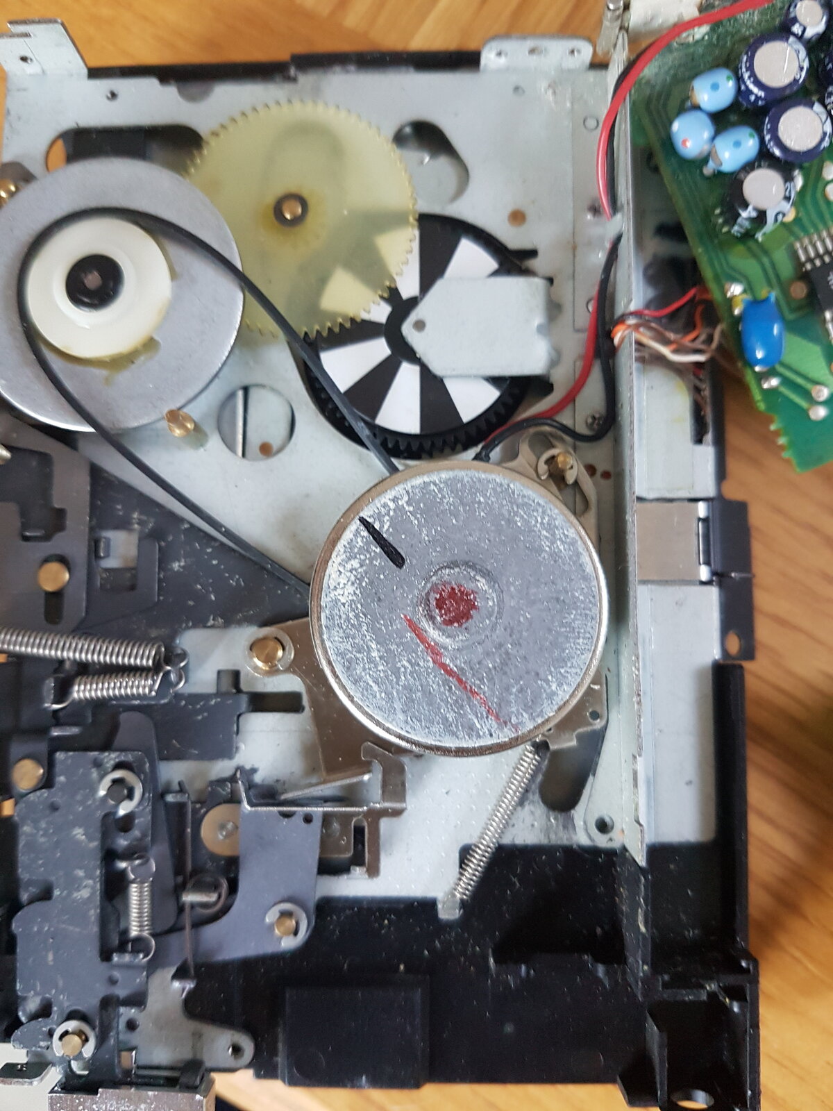

    Glad to hear that you were able to solve the issue. I am also glad that I fund your Thread as I need some help from you. I need to replace belts of P06 and I am not sure how to tka eoff the circuit board. I tried to take it off but it appears to me that there is tiny Side circuit board its connected to, Do I take Solder out and remove that tiny side circuit first? I dont want to mess it up, I love my Aiwa.

    Uh it's been a long time since I took apart my Aiwa but I believe you need to twist some metal tabs holding in the side board? I also think you might also need to de-solder some wires going to the motor.
