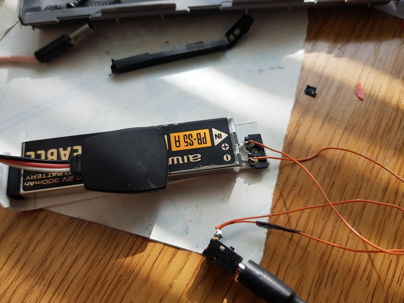

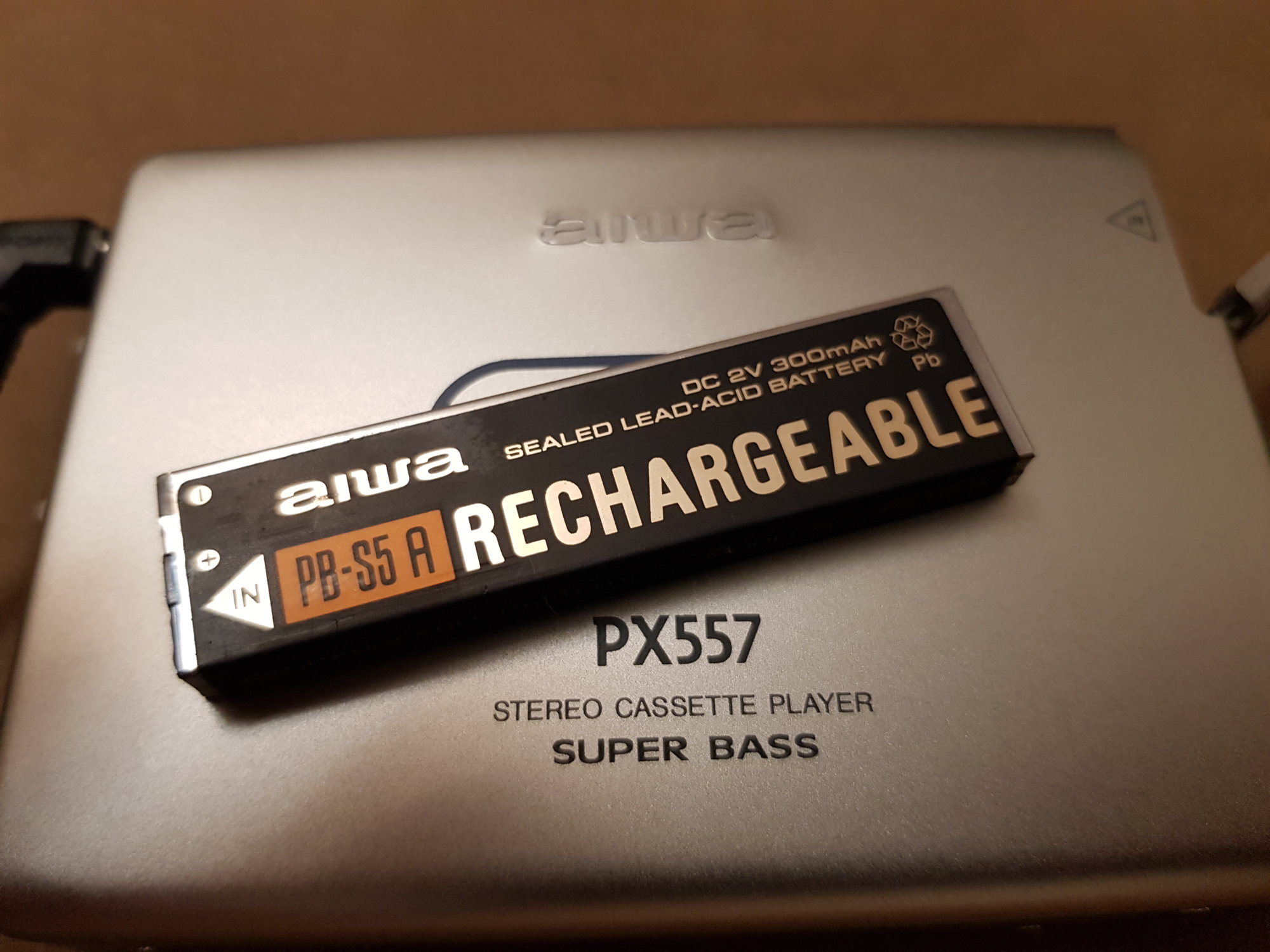

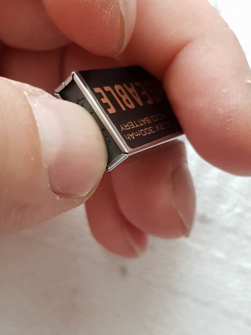

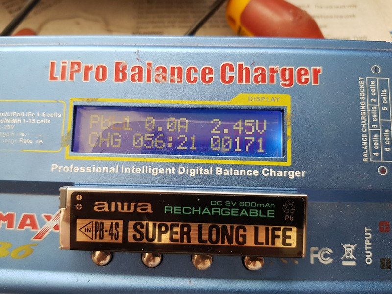

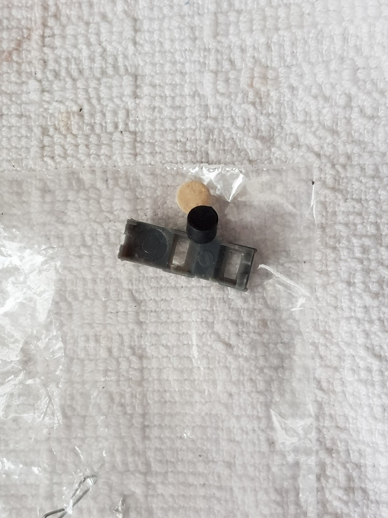

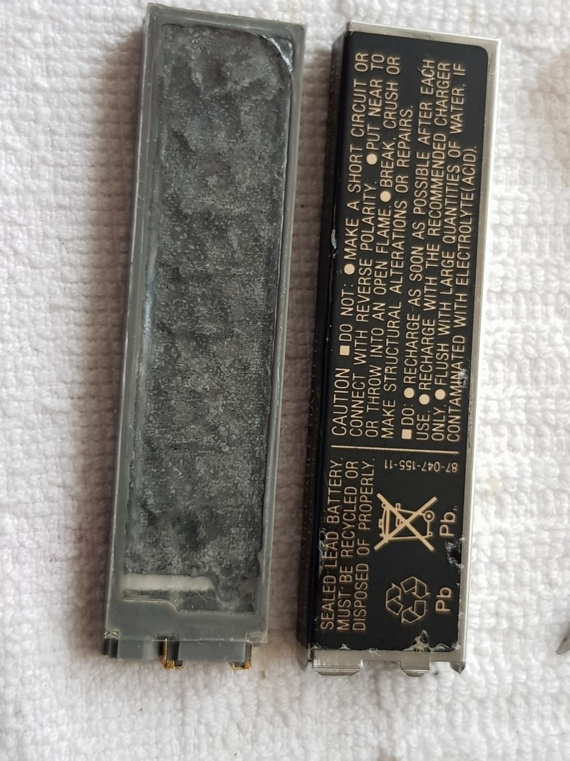

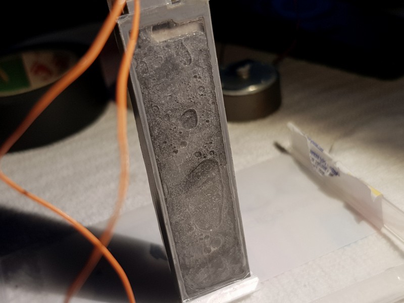

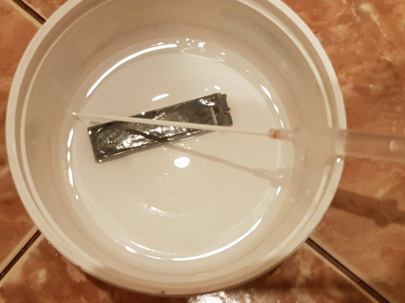

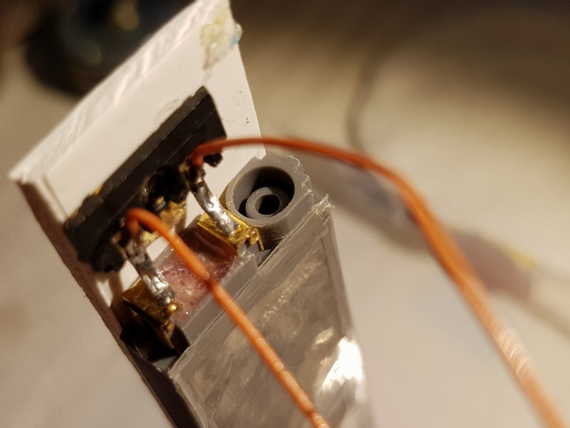

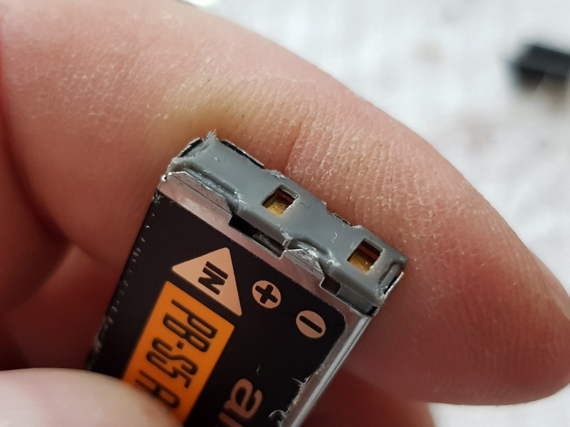

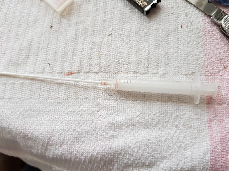

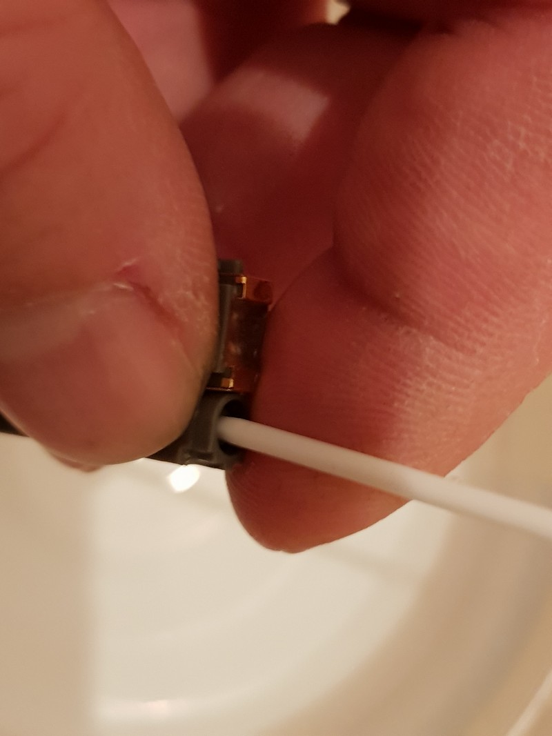

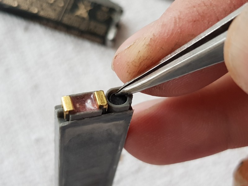

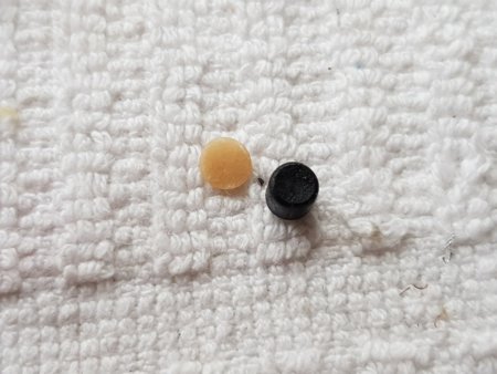

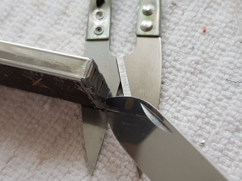

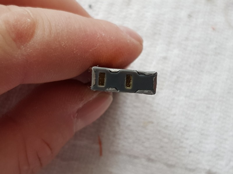

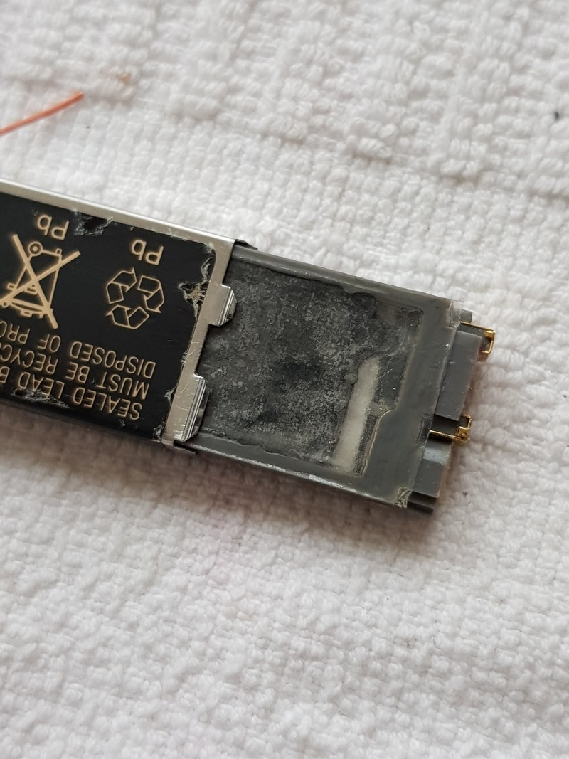

    Everything depends on cell condition. Some are better than others but only around 30% of capacity are back in cell best case scenario. I fix 3 of 5 cell and of 600 mAh cell recover only 150 mAh, of 300mAh cell-100 mAh- Steps are:
    1.Dissemble (from terminal side)
    2.Open rubber valve/cap
    3.Inject distilled water inside to flush inside
    4.Make concentrate mix of sodium-bicarbonate (Baking powder) and distilled water,dissolve ad inject good amount inside, wait 2 hour(this will dissolve sulfate inside).
    5.Repeat step 3
    6.Drain excessive amount of water
    7.Wear protective class and gloves. Take electrolyte with Syringe from some lead -acid battery (2ml)
    8.Wear protective class and gloves. Inject amount in battery cell to fill good and drain it
    9.Charge battery with electronic charger(I use IMAX B6) program is pb 2V 1 Cell with 0.1 current. First charging with open cap and vertical. If current is high than 0.1A-0.3A will gas a lot (if voltage is low and charger wont start-then use 2v charger directly to +and- for 40-60 seconds this way voltage will rise enough). Try again with IMAX B6. Measure with multi-meter to verify.
    10.Wait to charge- if is good it will take some time,if is not good it will finish charging after several second
    11.Measure (U) with DC multi-meter if is around 2.00-2.40 volts is good if is around 1.5 not good
    12.Clear and close rubber cap and paper ring, assemble battery
    13.Test with walkman if is good will last around 90min my best case
    14.Enjoy and say Thanks to me
    20200331_171332.jpg 20200331_171402.jpg 20200331_171517.jpg 20200331_171554.jpg 20200331_171607.jpg 20200331_171616.jpg 20200331_171650.jpg 20200331_171713.jpg 20200331_171818.jpg 20200331_171843.jpg 20200331_172016.jpg 20200331_172033.jpg 20200401_193130.jpg 20200401_193136.jpg 20200330_123556.jpg 20200330_102600.jpg

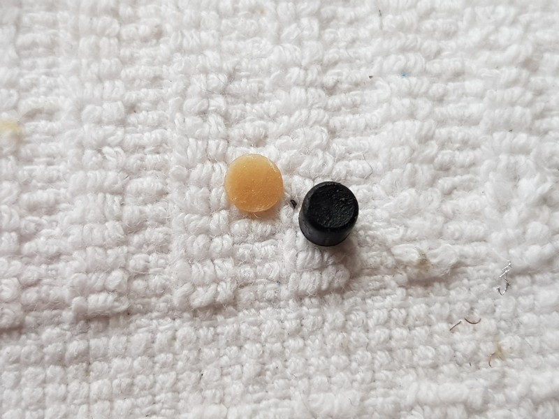

    Hello again i was able to replace the two thin led plates with new ones from china flash light and now PB-4S is like new.

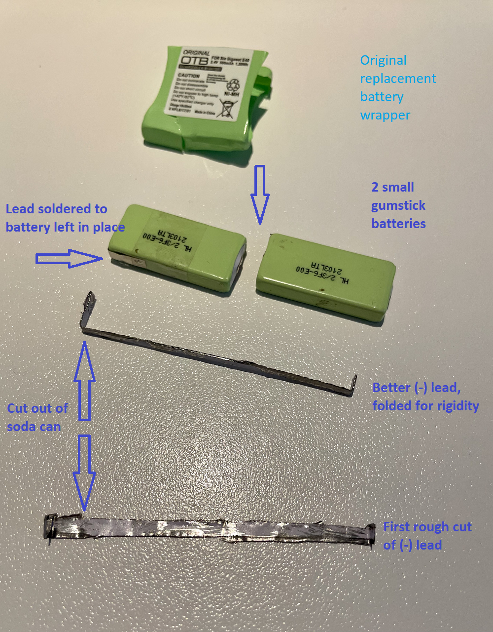

    This is amazing to read! I love the style of the older batteries and unfortunately I also have a few dead batteries.
    For those of us not so experienced to follow the instructions, I recently posted a cost-effective solution in another thread.
    Total cost: approximately 6 euros and a can of soda. Or beans.
    This come down to replacing the lead-acid battery with 2 smaller gumsticks from a Siemens Gigaset E40 battery.
    I cut of the original wires and connector, but left the lead soldered to the (-) of one of the batteries attached. It provides a large contact surface when batteries are inserted and the door is closed.
    These replacement batteries are widely available, for instance Amazon. Details, see: http://stereo2go.com/forums/posts/53277/
    I used part of a can (cut and folded) for the ground (-) that wraps around the batteries top to bottom.
