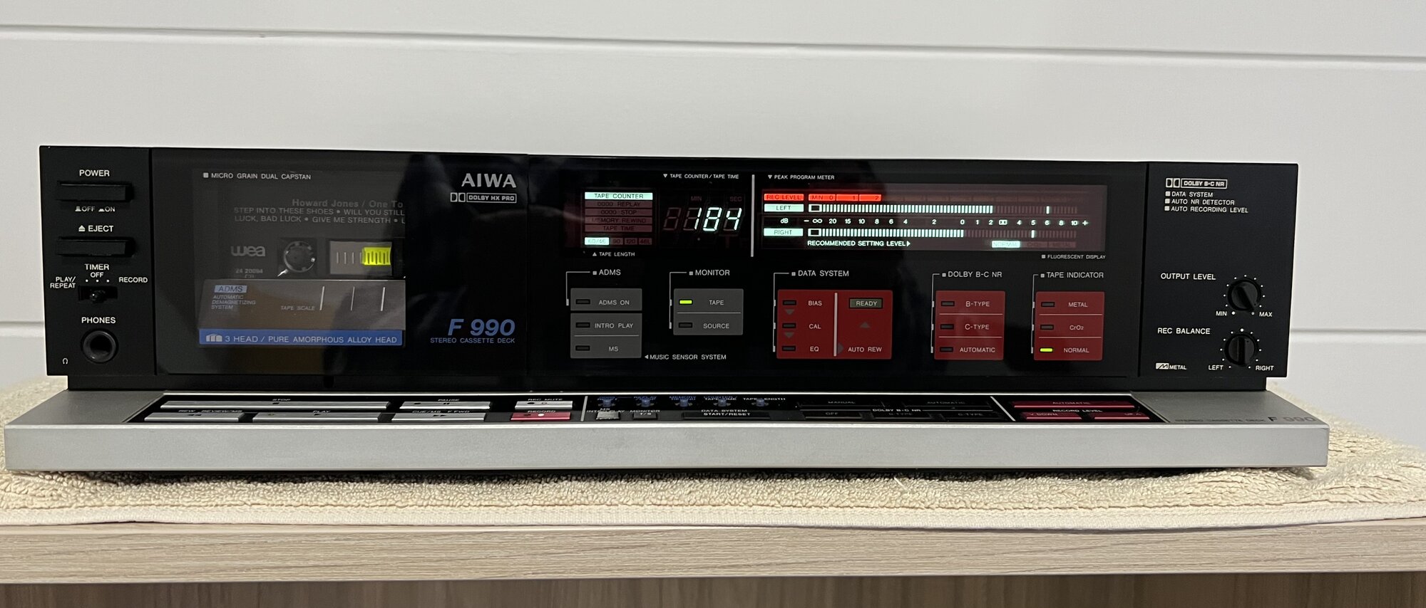

  4. Kiwinut
    Kiwinut Member
    84
    New Zealand
    Have to agree with what’s written as my Aiwa deck as far as I’m concerned was one of the best sounding.
    Back in the day I couldn’t afford a Dragon(now I can)but had this girl since new and just love the sound she produces. IMG_3925.jpeg IMG_3933.jpeg

    euroflash Member
    53
    Oregon
    @Kiwinut Your 990 AIWA is a superb deck, that stands in line with the best. Some may argue that it is on par with the Dragon in the way it sounds. For my taste, it LOOKS much better than the Dragon, and pretty much any Nak.

  11. Kiwinut
    Kiwinut Member
    84
    New Zealand
    I purchased this brand new, I really wanted a Dragon but it was out of my price range(actually I really didn’t want to pay the money) and the 80’s were all about flashy lights and gadgets. I remember the salesman saying as far as he was concerned this was as good or if not better (most likely ment the flashy lights) but I have hung onto her and I am pretty sure this is the forth service I have had done, but this time there was a dry solder on the output rca.
    I have thought about selling but I just can’t do it. It looks awesome and plays awesome. I have a service dude who recons these decks are easy to deal with. But have had others who won’t touch it with a barge pole. Unfortunately over the years I’ve lost the manual, but as I said she’s a thing of beauty when running, audio and visual.
    And thanks for appreciating that.
    Cheers Kiwi nut

  12. euroflash
    euroflash Member
    53
    Oregon
    @Kiwinut Hang on to it for as long as you can. You probably won't find anything equally as good of a recorder for a reasonable amount of money, and in this pristine condition and known provenance - good luck!
    I have been looking for F990 for a few years ("it's the one that got away"). And every year they get more scarce and more expensive, and most of them have already been molested by DYI hacks. These AIWAs 770-990 decks are very complex and difficult to service, sensitive to proper belts for low W & F, consequently, there are not very many techs in the world who work on these particular models with a high success rate.
    And yes, everything about this line of AIWA decks is stunning: from piano-style keys to solid line-level meters, from tape calibration to recording sound. You've got a real winner there!
