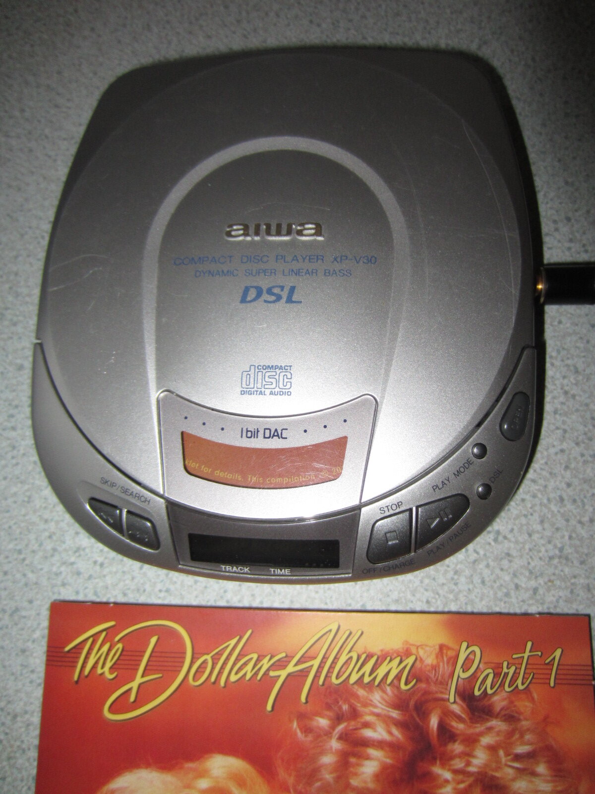

    I have found it is often worth looking at the Buy it Now and found this working Aiwa XP-V30 for just £10
    including postage.
    It arrived yesterday, nicely packed and in full working order. It sounds pretty good on vocals and Piano.
    One of the few articles I found out about it was in Japanese which gives it a favourable review.
    https://blog.goo.ne.jp/domzoh/e/b820578c2ed4a895d8e08b9444b354e2
    From the photos it appears to be based on a Sony main IC and doesn't have
    any of the failure prone surface mount capacitors in it.

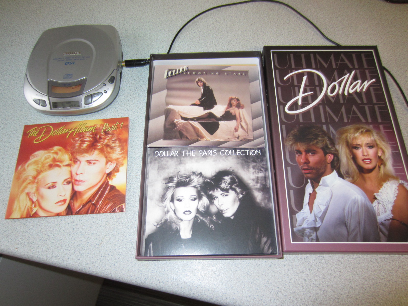

    The second photo is of it playing a CD from a late Christmas present to myself.
    A Dollar box set that cost almost five times what I paid for the player.
    38 years after I got the Dollar Album on LP for Christmas. The set includes a DVD which as an
    extra has the TV advert for it.

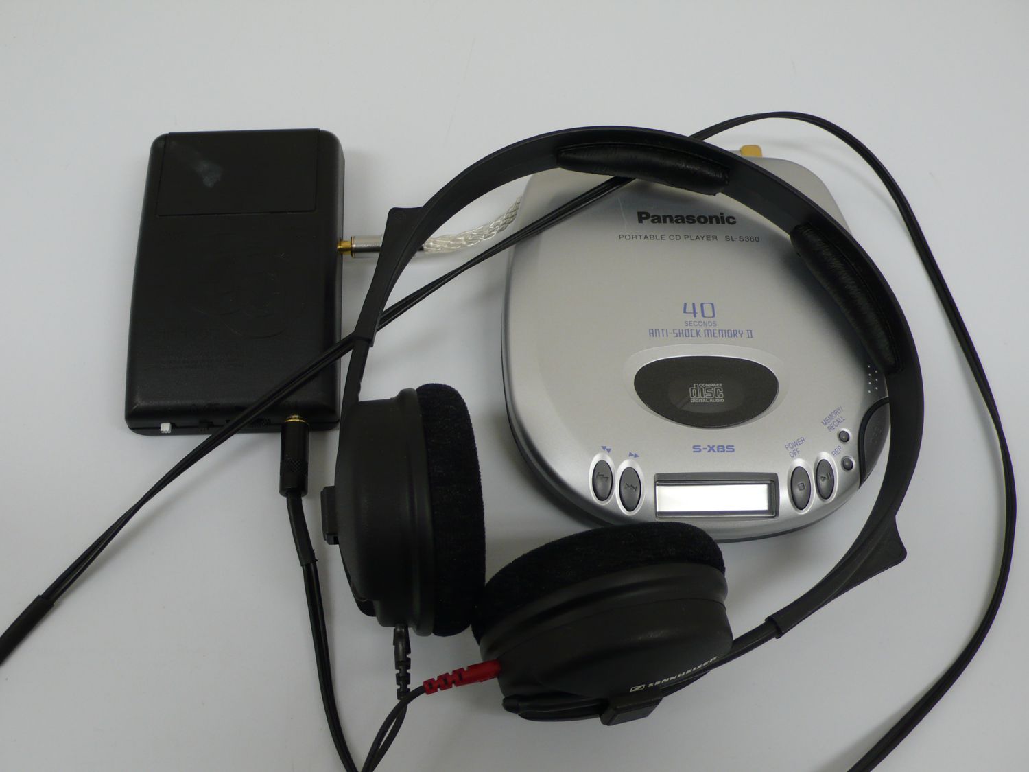

    I do not use any Apple products except for a Macbook that my employer gave me. I have an Android phone with a memory card slot and with a proper access to file system, so I can upload any files I want with any bitrate I want, I am not limited by iTunes. I have many CDs with MP3s having bitrate of 256 or 320 kbps. These CDs have been sitting mostly in folders for the last 15 years or so.
    I did not expect my my remark about pre-1bit DACs to be considered offensive, it is a half-joke after all. There are many good ones, although the quality is achieved by brute force: high-quality components, laser trimming, oversampling, several DACs per channel with averaging, and of course adjustment pots. 1-bit DACs solved the inherent instability of traditional DACs by converting high-resolution low-frequency digital signal into a lower-resolution high-frequency signal. Turned out it is much simpler to design a reliable high-frequency generator than to trim resistors with a laser. So, 1-bit DACs opened the gates to high-quality sound to everyone, not just to audiophiles who can spend pretty penny on expensive gear, how bad can that be? Great and consistent sound quality for every Joe and Jane, cheap.

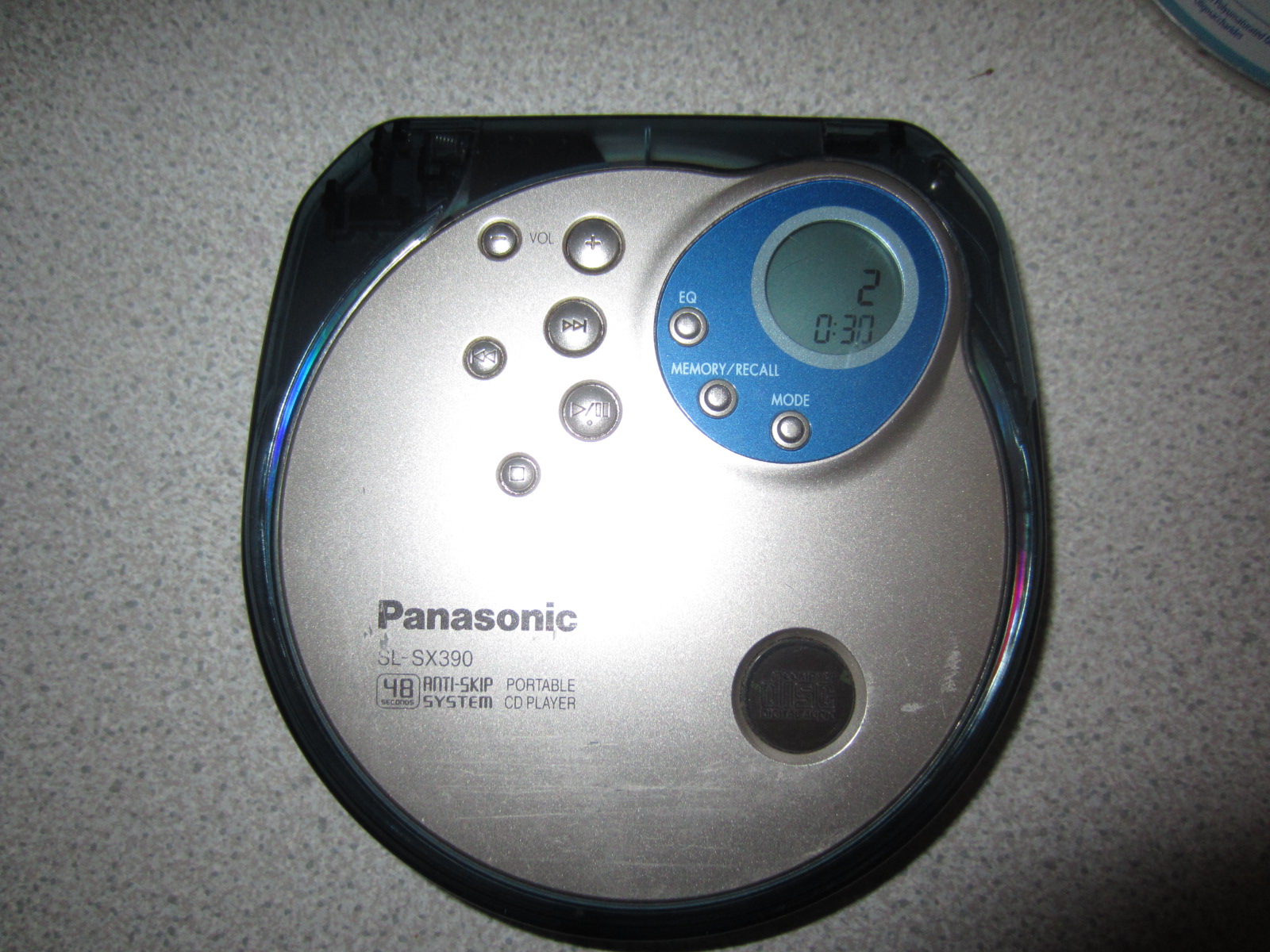

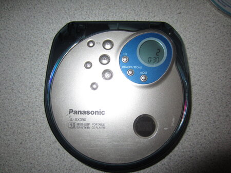

    Here is the Panasonic player I have mentioned before, another bottom fished player I bought a couple of years ago.
    An SL-SX390 old enough to be made in Japan
    I was hoping the Mode button would allow me to switch buffer lengths like someone mentioned in that thread.
    but it just changes the Play mode i.e Normal Repeat or Random. It seems like I am stuck with 48 seconds Anti Shock. I did check the instructions when I got it and couldn't see if I could change.
    Great if you want to use your player on a Fairground ride. Not so great for quiet listening at home.

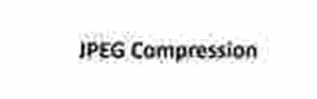

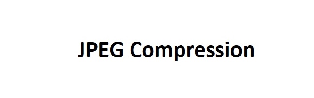

    Unlike tape lossy compression can't be tested just by using test tones although I suppose you might get noise in them. JPEG also uses lossy compression. Here is a 200 pixel high file I created using Paint
    I then dropped the file height down to 50 pixels so that is a 16 to 1 overall compression then re-expnded it back to the original size
    The white areas are still noise free, but look what has happened around the text: noise.
    The text is still readable but it certainly doesn't look as good.
    That is similar to the noise audio compression introduces.
    Now imagine that happening with five instruments in a band.
