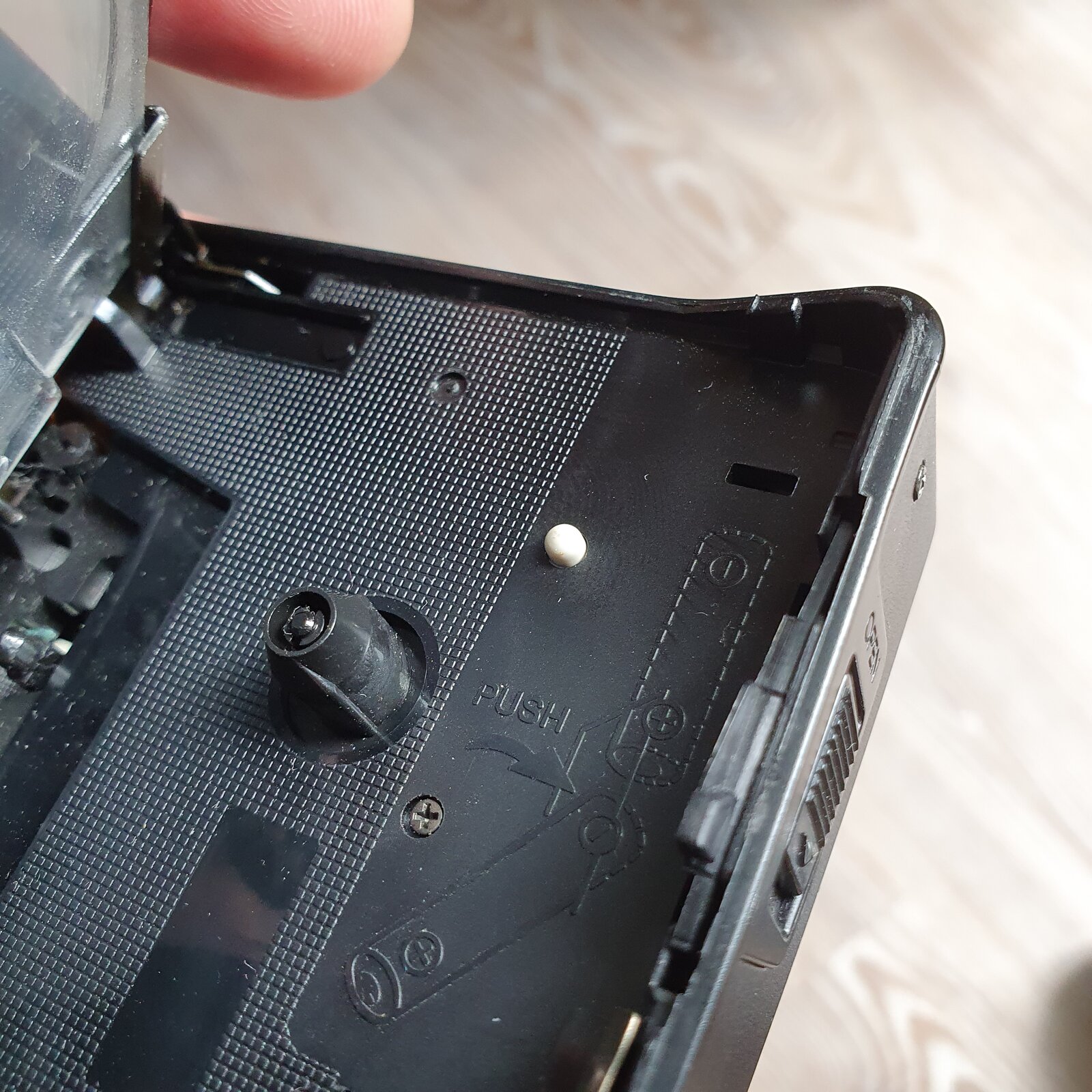

    I have made a mistake and destroyed the black pin on the board, the one that gets pressed by the cassette through the white knob that is inside the cassette compartment. The Walkman is working how it should. Now I wonder what the pin does?!

    I want to share: The white plastic pin stops the motor when the lid is opened while the Walkman is playing the cassette. Another mechanism resets the head assembly to release the cassette. What leads me to another question:
    Why is it necessary to stop the motor before the head assembly resets? Could the Walkman be damaged? Or is it just Sony's advanced engineering?
    Would be great if someone knows.

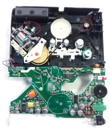

  3. Valentin
    1,669
    My guess is that is designed to stop the motor in order to avoid chewing the tape.
    Unlike the DD, DDII, DDIII, DD30, DD33, DD100, DC2 on which the pinch roller and head are into the carriage itself, on the DD1, DD10, DD11 and DD22, the carriage is just to hold the cassette to save cost.
    Given this, on the former the pinch roller will lift from the tape as soon as you open the door, while on the latter pinch roller will remain engaged and rotating (but takeup reel will no longer make contact
    with the cassette hub) until the auto-stop is engaged by lifting the carriage.

    That makes sense, thank you for your explanation! So if the lid opens for example in your pocket just a little bit and the cassette gets lifted, the motor stops to avoid chewing the tape. If the lid is lifted a few mm more, the pinch roller and head reset. That IS an example of Sony's thoughtful and advanced engineering!
    My guess for the need of two switches is that they behave differently. The white knob / switch has three states: Motor on when knob is up, motor on when knob is pushed down and motor off when knob is released. Very smart! The second switch in your picture seems to only work on/off.
  5. Valentin
    1,669
    Yes, the leaf switch on the left side of the picture is just an on/off and is triggered by pressing PLAY, FF or REW. That type is present on the other series as well.
    Please explain in more detail how that white switch works, as you mentioned 3 positions and switch is single pole single throw.
