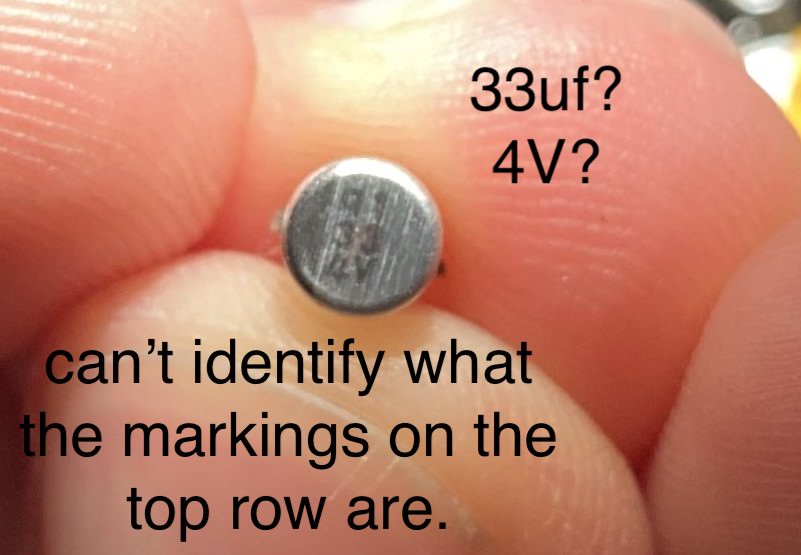

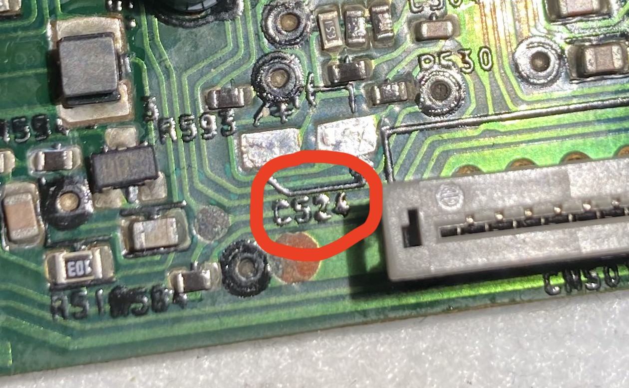

    Just removed a leaking surface mount capacitor from a Discman D-34 and as you can see in the photo, it reads what I'm guessing is 4V 33uf. The electrical part number is labeled on the board as C524, however when inspecting the service manual, C524 is referred to as 10V 22uf.
    I'm guessing I should probably replace the capacitor with one which matches what the actual capacitor I removed was, but I just thought I'd ask for a second opinion.
    Also if someone could validate that I correctly interpreted the values on the surface mount capacitor I removed, I've attached an image of it.

    Regarding the voltage rating, that indicates the highest voltage the capacitor is designed to withstand.
    The problem is that higher voltage capacitors tend to be larger and more expensive. I see the D34 runs off 6V. Therefore a 10V capacitor should be O.K. for any position in the circuit, while 4V would need careful analysis of the maximum voltage the capacitor might receive where it is fitted. As for the value, cheap capacitors tend to have a 20% tolerance as shown in the parts list. So 22uF capacitors from the factory could be anywhere between 17.6 and 26.4uF. Maybe Sony found the design was marginal with capacitors at the lower end of that range so increased the capacitance. You don't say what the capacitor does, but a classic example is for the headphone output where higher capacitance gives more bass. For that I would expect there to be a pair of capacitors of the same value in the circuit though.
    I would try a 33uF replacement with a voltage of at least 4V. Make sure you get the polarity right when refitting it.

    I tend to buy D-33/34/36 for the sake of their KSS-220A lasers to be transplanted onto D-15/D-25 and I just discard the rest... D-34 (same as D-36) has C524 as 33uF/4V SMD on the boards that I found in my 'junk-trash-box' and its SM that I have ALSO marks C524 as 33uF/4V cap. D-33 has 33uF/4V thru-hole cap there. So,... I would concur with @Longman and go for 33uF cap...

    Thank you both, bought the 33uf cap, made sure it would fit in the space.

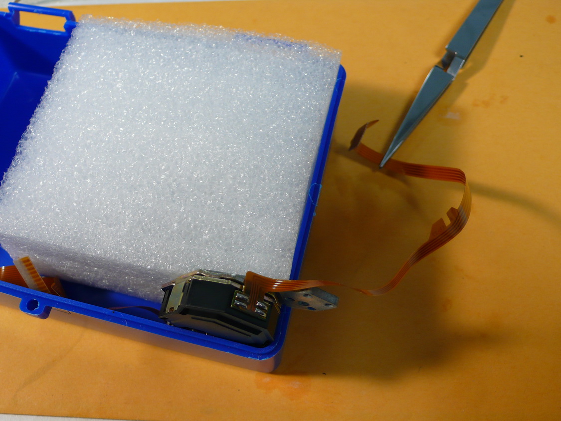

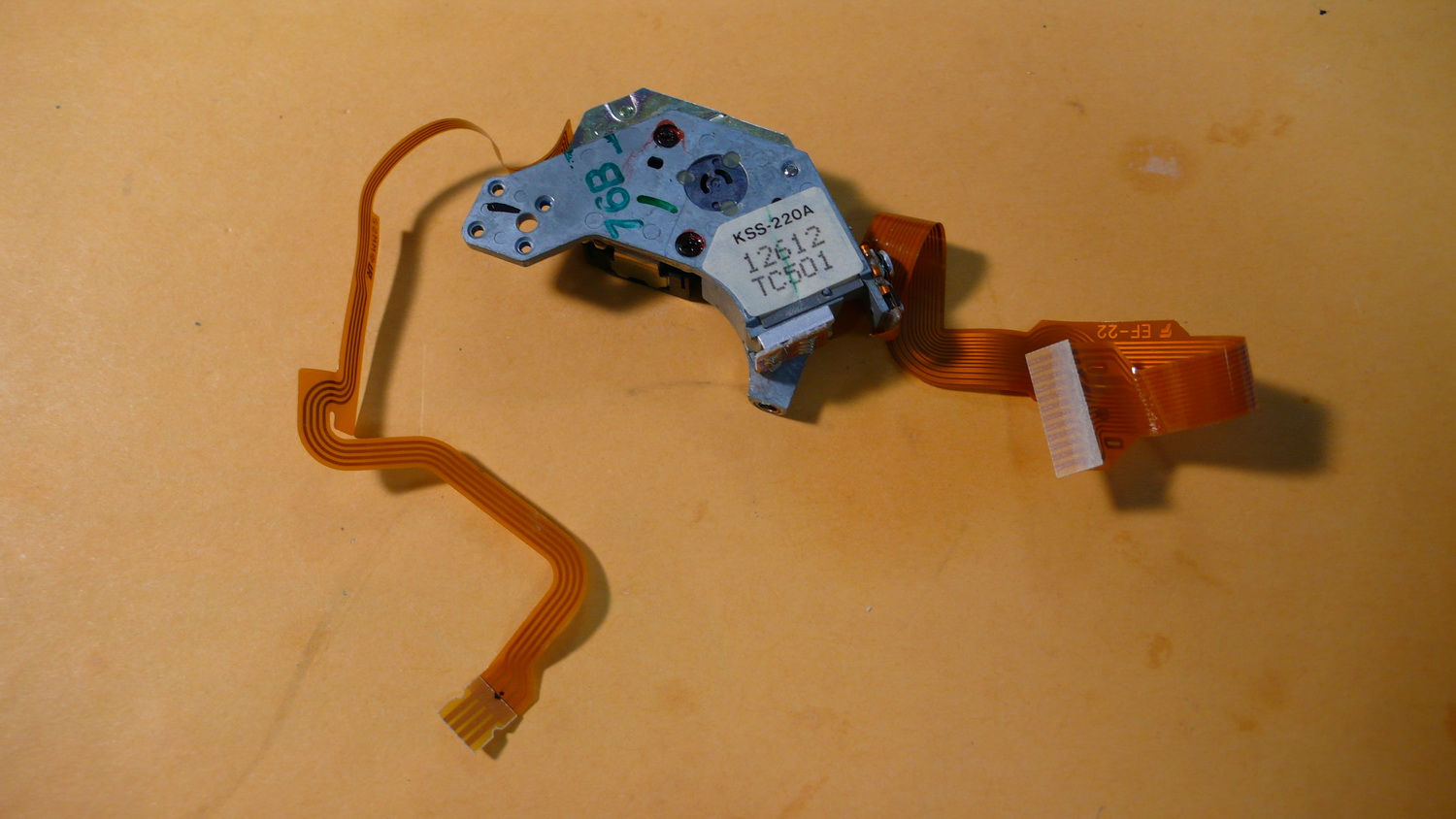

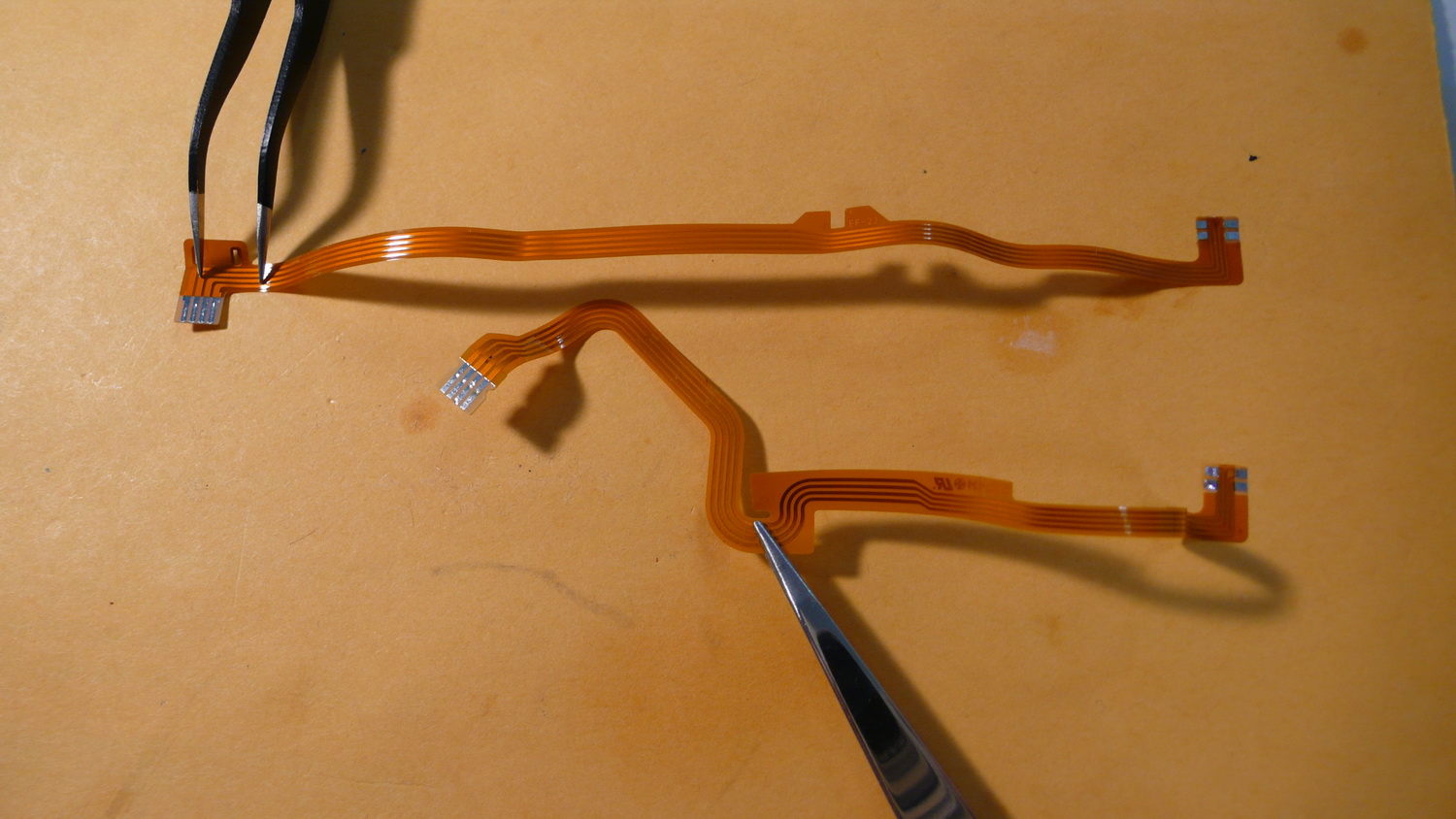

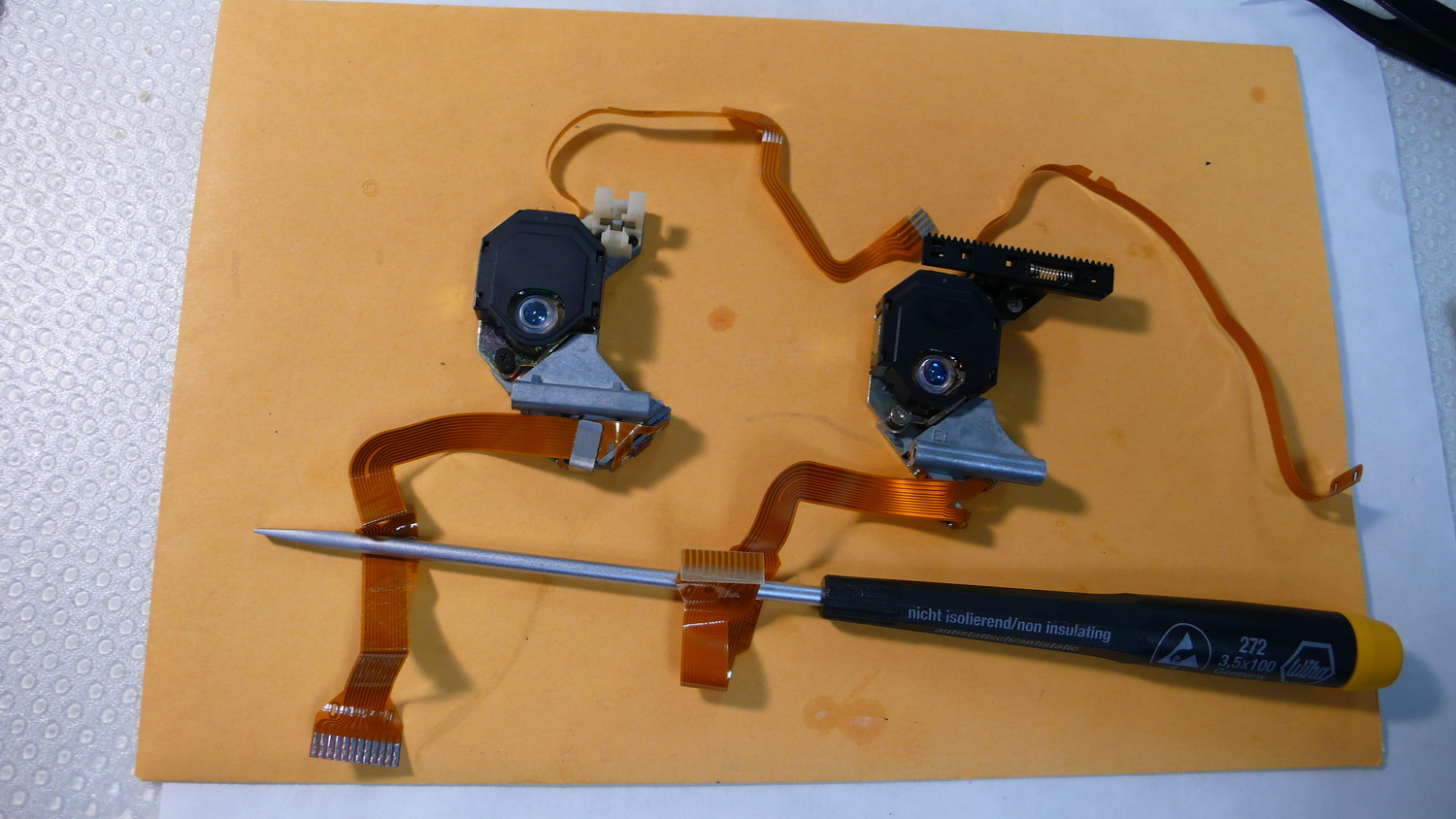

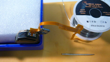

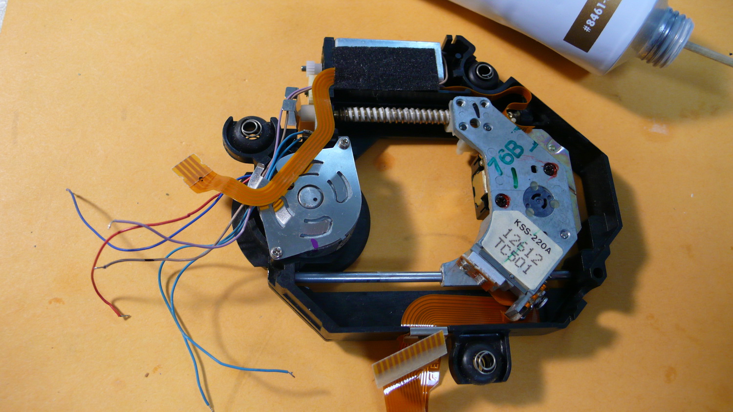

    KSS-165A laser from D-150 (L) next to KSS-220A laser (R) from D-33:
    flexboards leading to focusing coils have different shape, but easily interchangeable. I use plastic box and piece of foam to hold laser in place, desoldering wick to remove four solder joints
    desoldered flexboards, D-33 (top) and D-15 (bottom):
    you will need wooden toothpick to align and to keep things in place while soldering, here is KSS-220A laser with transplanted flexboard
    the end result:

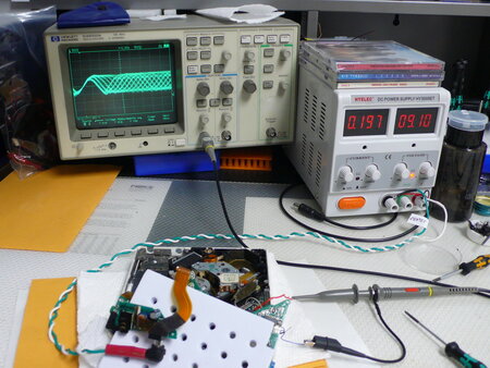

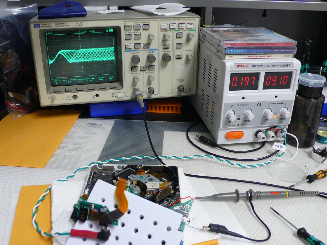

    Hi @Jorge , not to leave the nice tread dead, laser swap works!
    It pick ups the tracks super fast and sounds great.

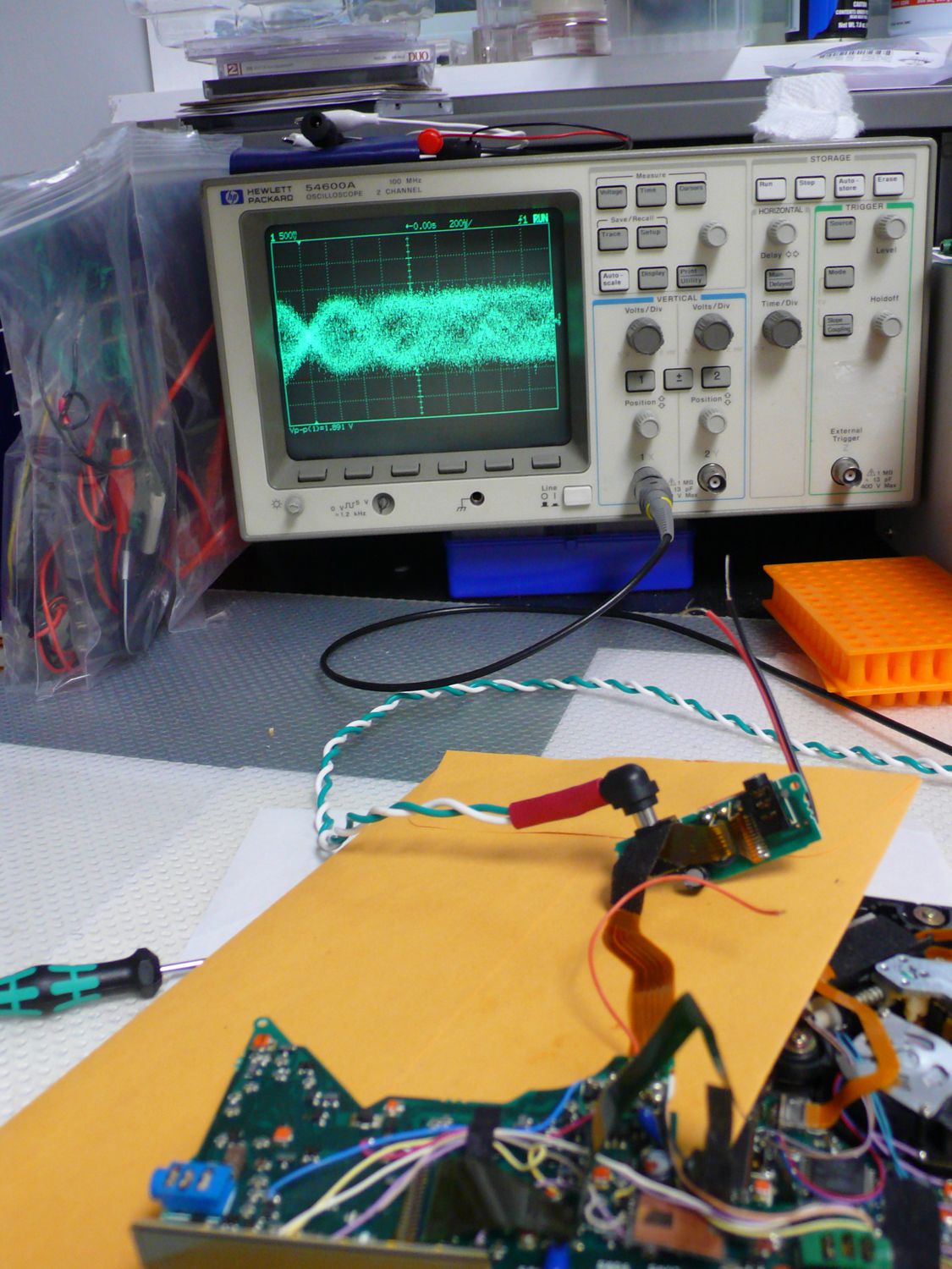

    While adjusting everything however I noticed that the TC466 value written on the new laser is below what I measure 471 mm (as described in the manual), So according to the manual the laser unit should be defective!, but well it isn't.
    Do you have experience with that?
  16. Luis Bertol
    Luis Bertol New Member
    7
    Berlin, Germany

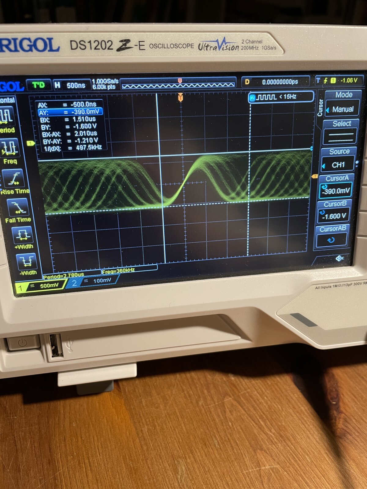

    and this is how the wave looks like
  17. Jorge
    1,754
    looks OK to me: SM says that measured value can be 46.6mA +0.6mA/-1.1mA, so you are within the limits allowed by Sony
    RF eyepattern over 1V and this is good, usually means that all and any CD-R will be playable without any hiccups :)
