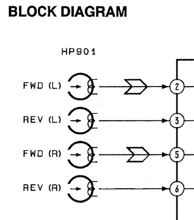

    I think this is a single head model with reversible sides for Left and Right stereo channels.
    See example here:
    All four are inside one tape head.

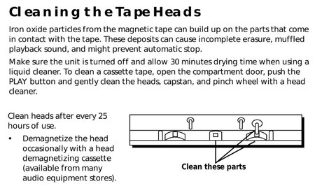

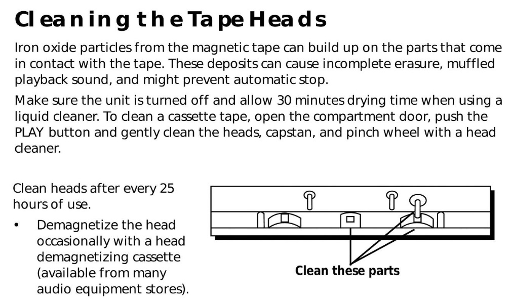

    And here is a picture from the RCA RP-1882 user manual.

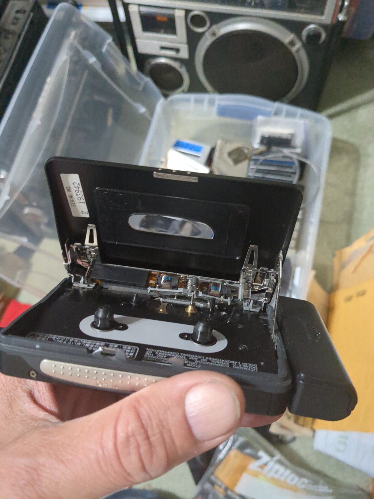

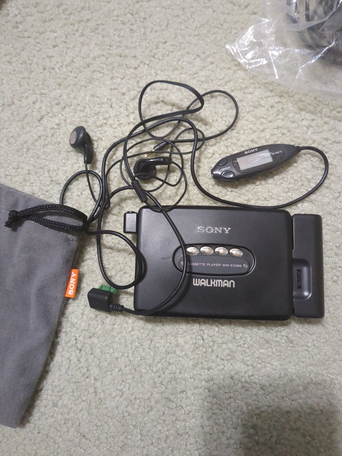

    Yeah I thought I had one of these weird looking dual head walkmans the ex999
    Complete with some original headphones and the remote control in some Gray Sony pouch and headphone adapter which is nice to have on this.
    Someday I'll get around to getting a belt for it.
