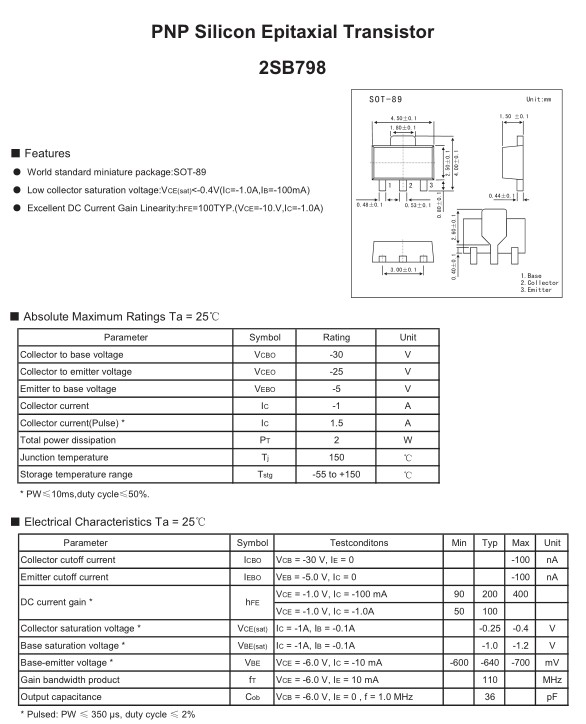

    Clearly something is not right: the drop across the transistor EB junction should be between 0.6-0.8V. Did the transistor check ok with the diode tester on the multimeter (emitter to base and collector to base) ? it should read around 0.6V
    As about the IC itself, if it's CXA1423N, the chances of finding one are slim. And you shouldn't try to source one until you are 100% convinced that is the problem.
    That's why I would check that drive transistor first, even try replacing it with another through hole generic PNP just for testing. A transistor failure can also manifest only under load, in which case it will test fine on a multimeter.
    It's a 1A 25V with hFE of 200: however, the maximum collector current can be smaller, the motor does not draw more than 100mA. So my guess would be that anything with Ic(max) of at least 200mA will do for just the purpose of testing.
