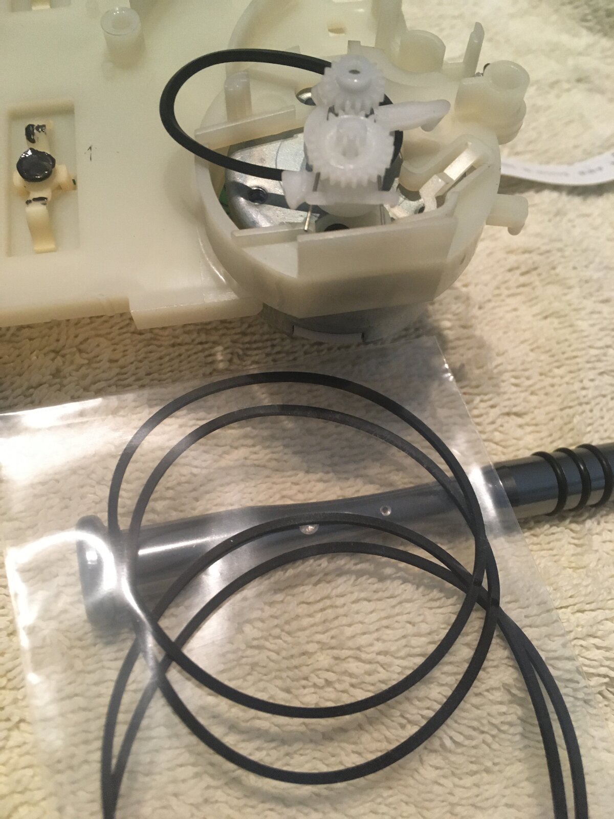

    Well, as I’m curious I tried to connect and play the cassettes but it doesn’t work. So I opened it, it seems that the belts are done. I also managed to take the cassettes out manualy
    Going to order a belt set and see what happens with new ones

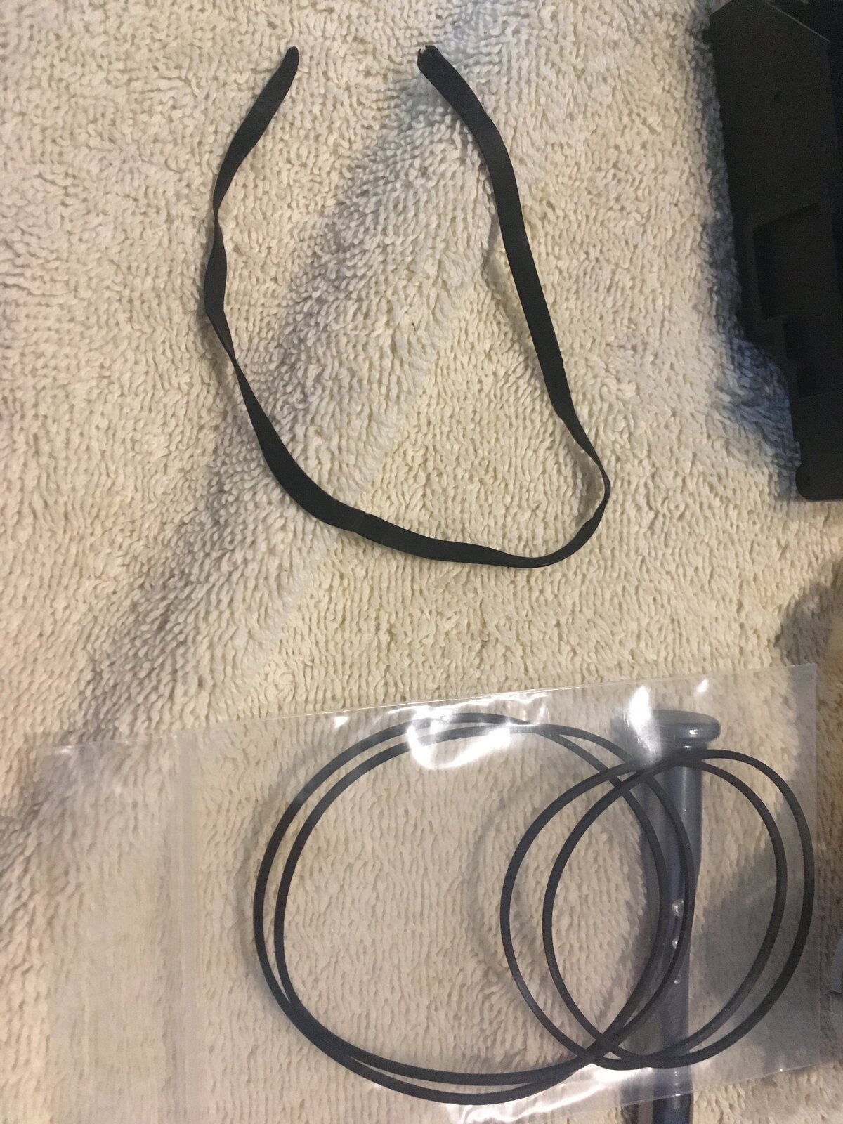

    The bad news is about de TC-D505, I received the belts today coming in from Portugal but as I was getting to change them, I saw that they were not the good ones.
    Sended an email to them to see what to do as they have another ref for the same sony unit and which seems to be the good one.
    So I'll have to wait a bit to get it functional.

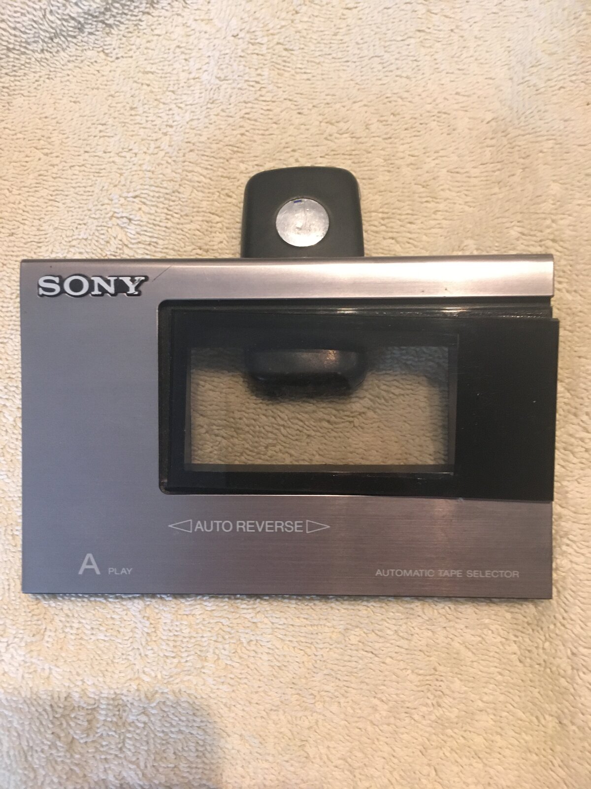

    I have some issue with the doors also, the windows are falling down.
    What it is the best way to fix this, heaten them slowely up and push them in place ?
    16,860
    I'd heat them up very slowly, I've got lab-grade heat guns, kind of like blow-dryers for your hair, but I can put in any temp I want. Most of this plastic will start deforming at 130 degrees F so you don't want to get close to that. If the adhesive doesn't want to let go, you might need something like Goo Gone, something that won't damage the plastic.
