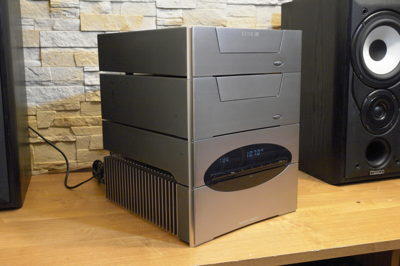

  11. Jorge
    1,754
    Aiwa C30/P30 is a beautiful mini!!! For many years I was very happy with my Harman Kardon Festival system:
    but then one day in 1997-98 I walked into Chicago ProMusica which was right across the street from TowerRecords, and John Schwarz hit me with the best hi-end presentation ever! I fought the idea for more than a year, but in the end maxed all my Credit Cards there... :)

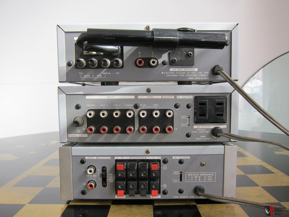

    16,882
    I snagged this photo from an old sale, do you know how to correctly wire it? Some members are younger, this was pretty standard for a kid in the 70's and early 80's.

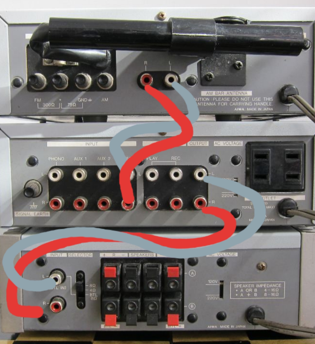

  14. Longman
    3,884
    As people suggested I would start out nice and simple to just test the radio
    • Tuner outputs to Tuner Inputs on the center unit.
    • Outputs from the center unit to inputs on the bottom unit.
    so that is only four phono leads used so far.
    • Speakers to one set of terminals e.g the top row.
    Don't forget there will be several switches on the front which if set incorrectly will cause problems
    • Tuner input selected
    • Correct speakers selected.
    • If you have something like a tape monitor switch is it in the usual position
    • Volume turned up.
    We have all done that. Last week I spent about five minutes trying to work out why I didn't have any sound on Youtube.
    The volume control on my speakers was turned right down !
    If you are still stuck ask member Nick Eccles if he could take a picture of how his Aiwa is wired.

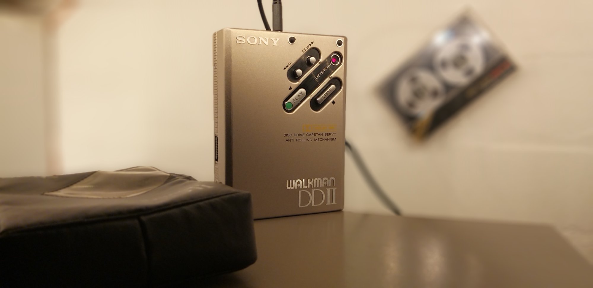

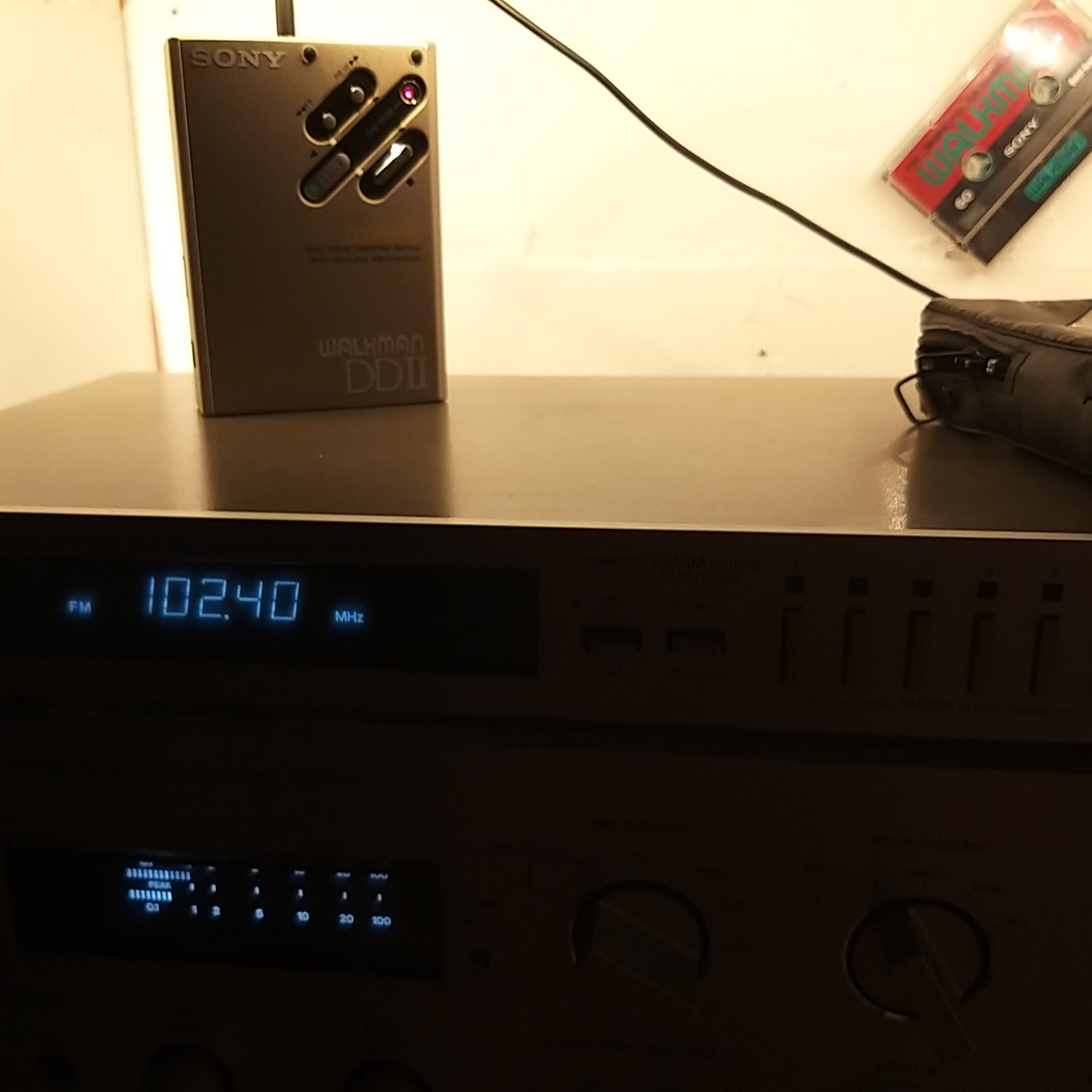

    Things are getting interesting if a DD is playing on top, aiwa, technics or something else, doesn't matter..... 20190803_005215.jpg
  17. JK1210
    JK1210 Active Member
    178
    Cologne, Germany
  18. JK1210
    178
    Cologne, Germany
    16,882
    Nice to see you out again JK1210, great wiring photo! I pulled my SH-8030 out and confirmed it's still working and does having multiple "screens".
