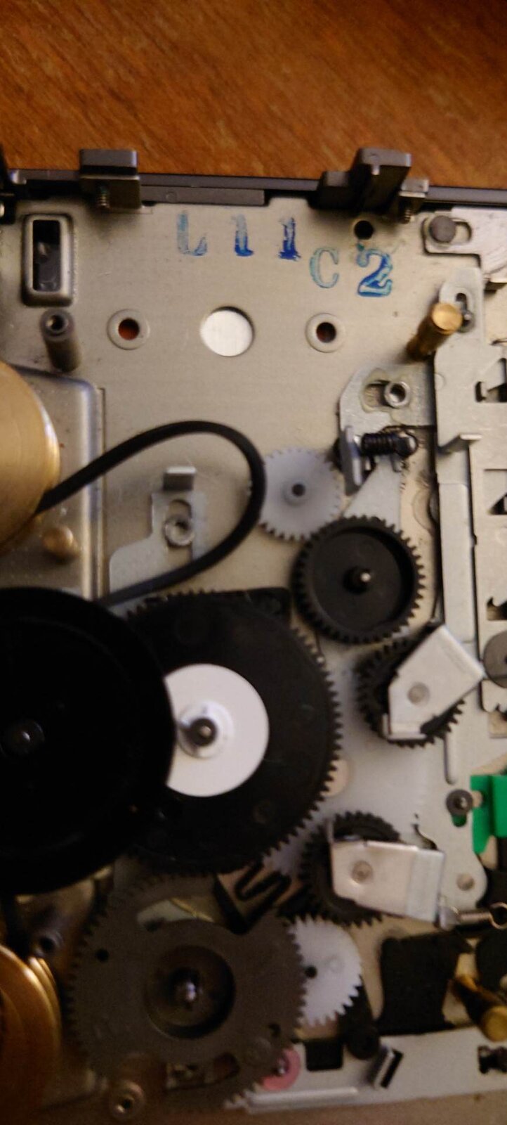

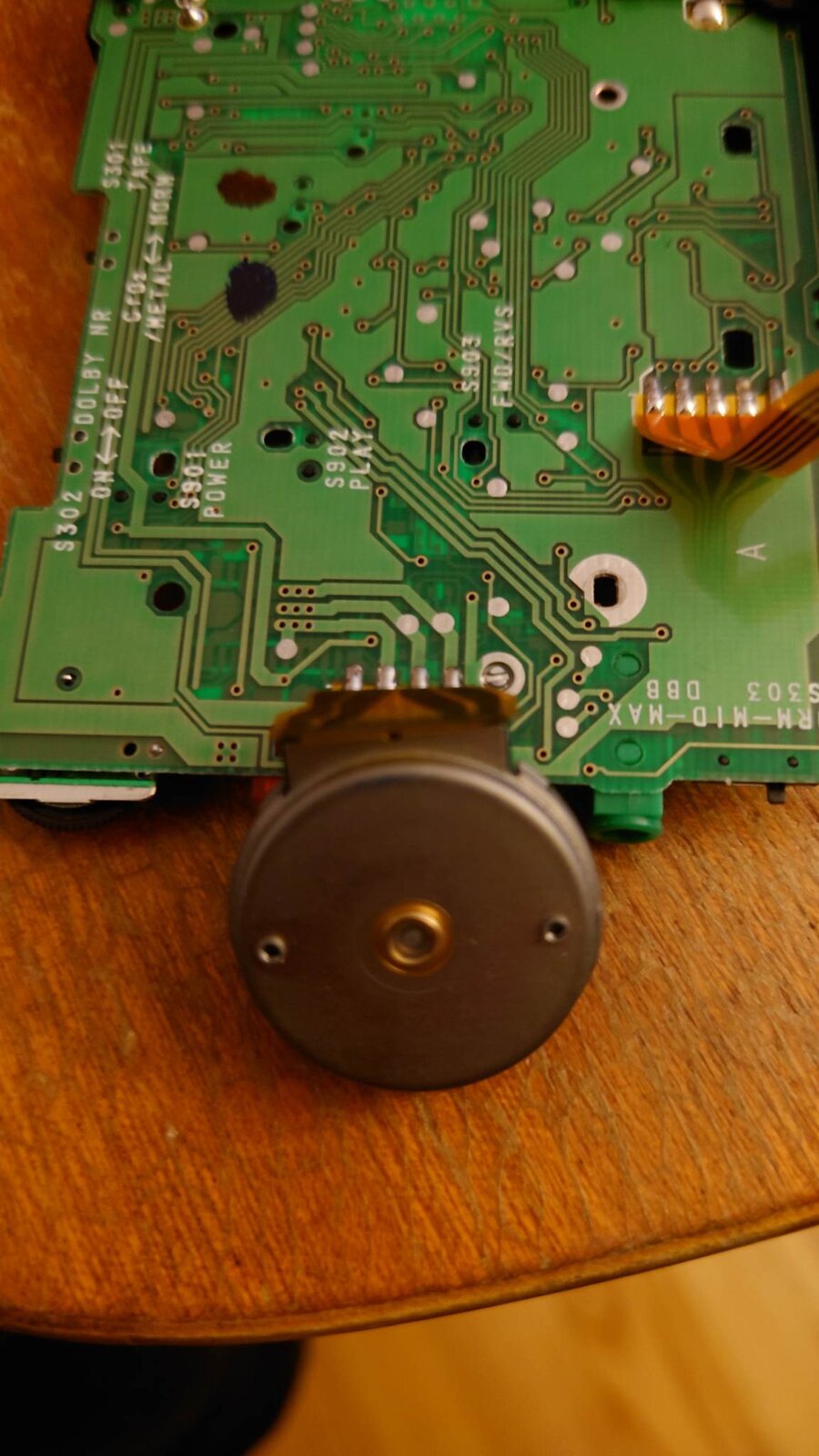

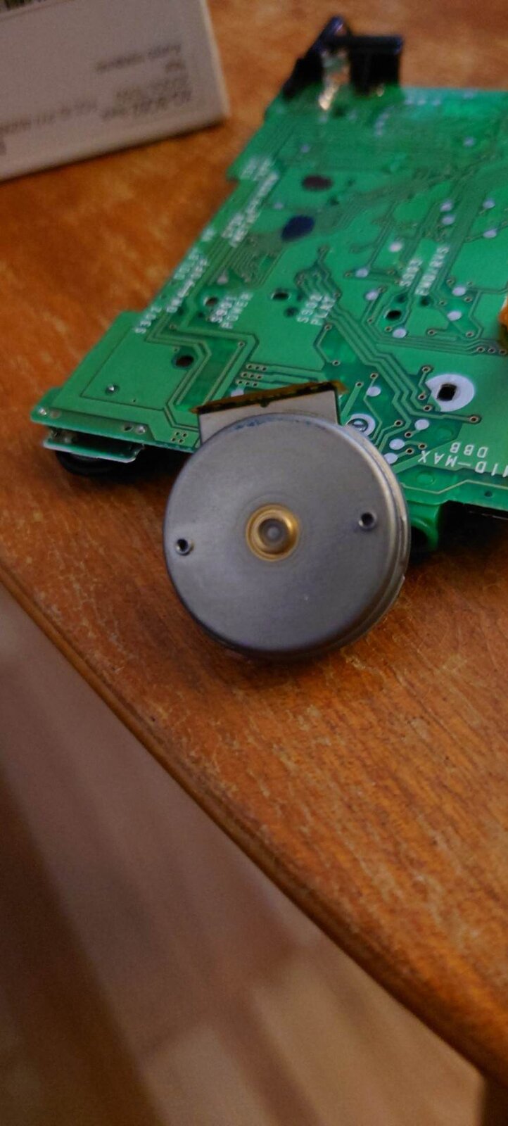

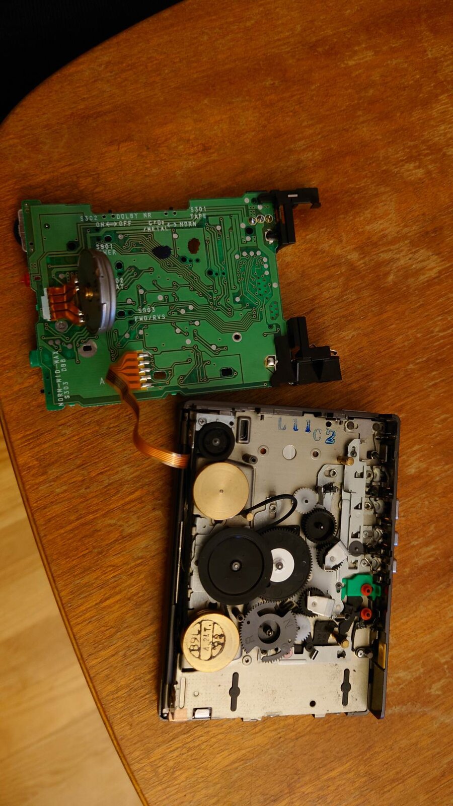

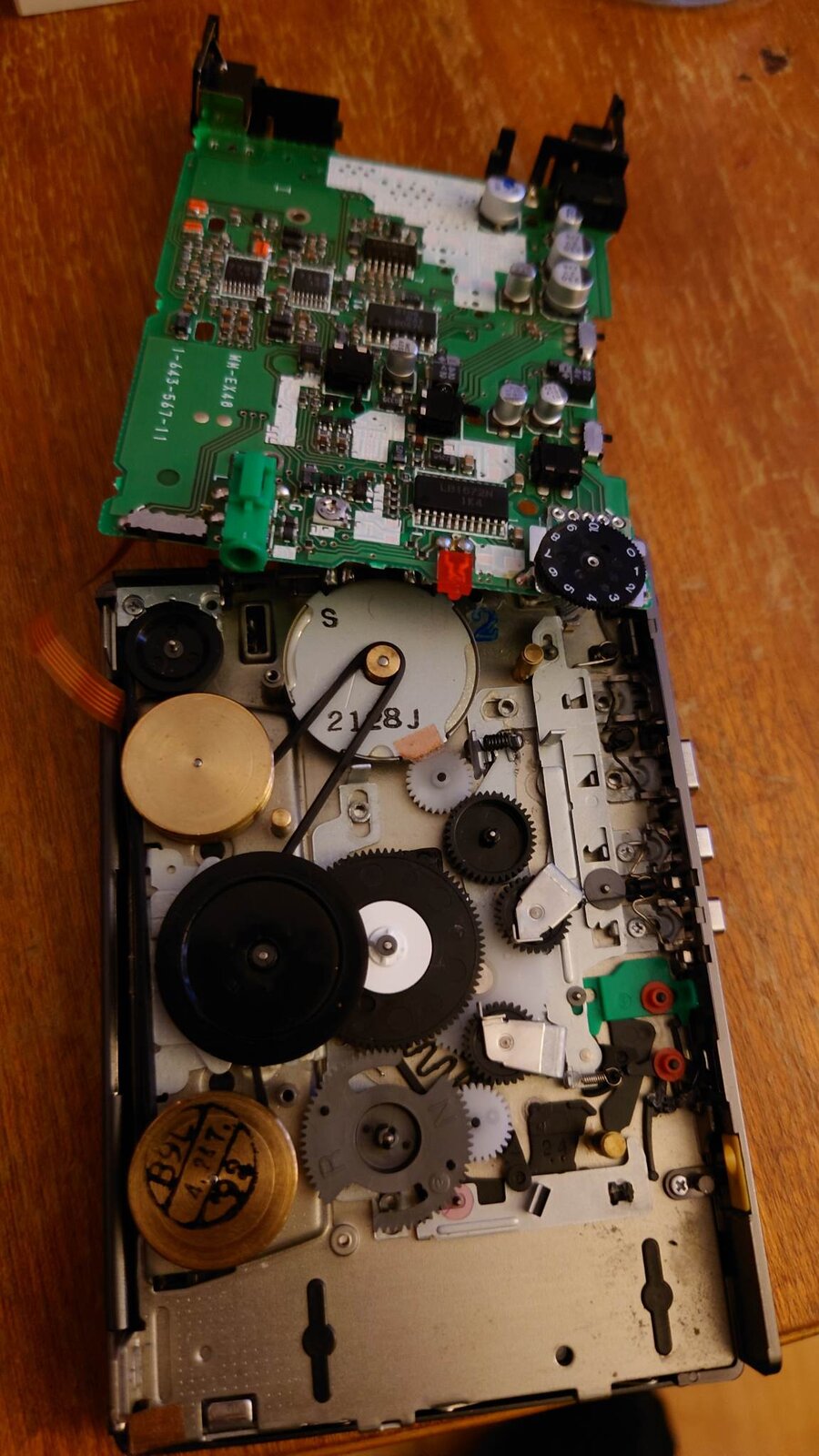

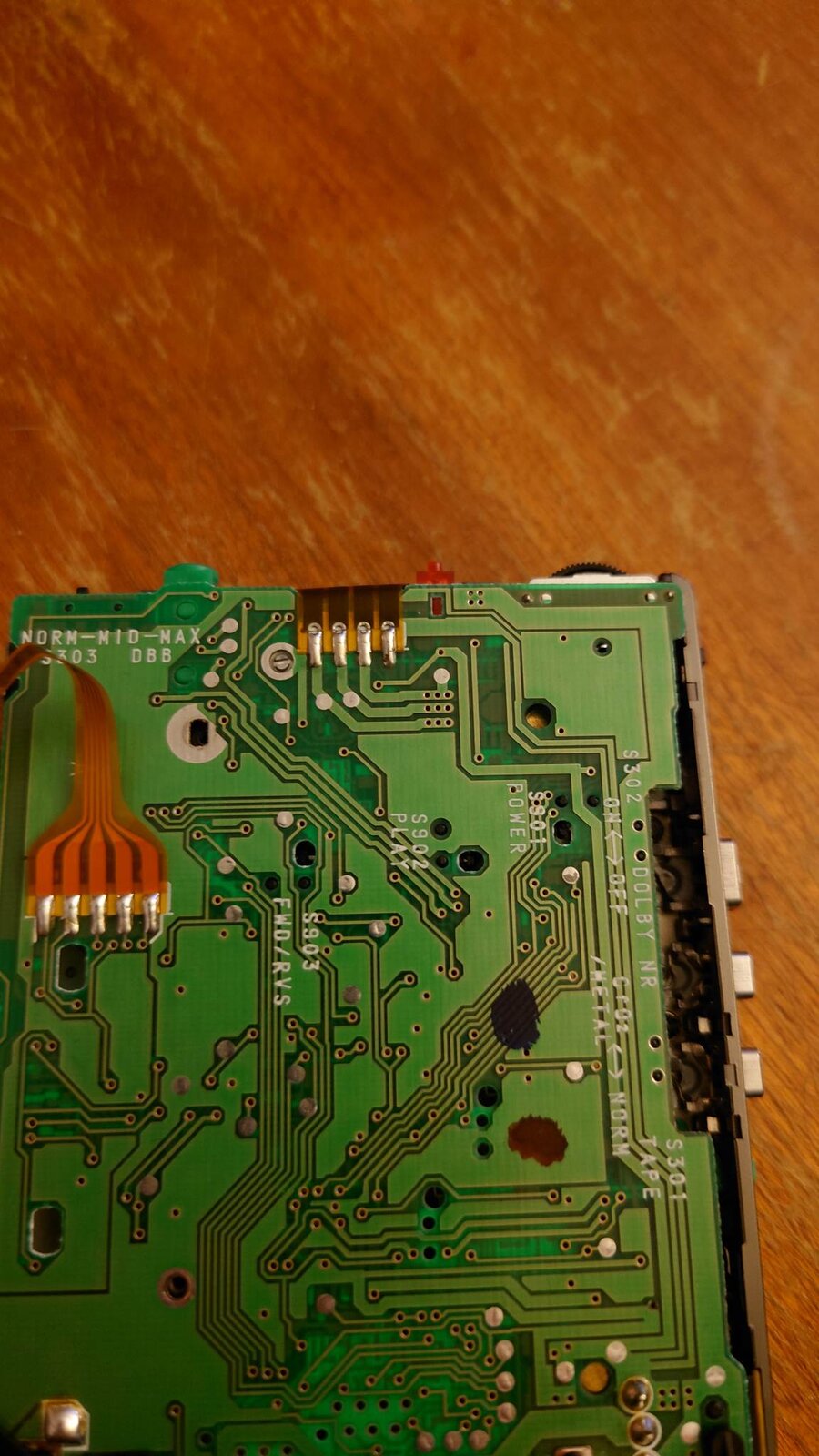

    I found one for really cheap, cosmetically in great shape. The seller said that it won't rewind, probably belt needs to be replaced. Now I opened it up and replaced the belt, but i'm having trouble putting reassembling it. The motor seems to be just loose, and I don't know if there's like a part missing or if I'm just doing it wrong.
    Is the motor supposed be attached to the chassis with something? Or is it just loose and needs to be carefully kept in place? Also I think it looks really good inside, all the gears and such are in great shape? Autopsy pics included.
    included. 336518044_106880485690593_8036506688119929114_n.jpg 336484272_1327524444842078_583929984743150298_n.jpg 336192179_768841964429250_9003919694052523384_n.jpg 336422545_1307376109810265_5135963958161510040_n.jpg 336115748_1789981354732631_8325870483142395703_n.jpg 336518553_557764806179914_5278465776185766805_n.jpg

    Hi, you can find the servicemanual at freeservicemanuals.info
    In it there is an exploded view, so you can see how it is put together.
    To me it looks like the holes in the motor correspond with those in the metal plate?

    Apart from the noise, there are 2 issues that I see:
    2. The belt is way too thick for that walkman. You need a 0.5-0.6mm thickness belt for it. This is the correct one: https://fixyouraudio.com/product/belt-sony-wm-ex48/
    3. The belt is not routed correctly, it needs to go over the black pulley, not under it.
    About the motor, does it do the same noise without a belt in place ? It's not clear to me if the noise is mechanical or one of the 3 phases is missing. It seems more likely to be the latter.
    Would check the wiring to the motor and components around the motor governor IC (the one near the LED), try to put pressure and see if anything changes.
    These motors can sometimes go bad, as the magnet inside may break. As a suggestion to anyone reading this thread, these motors should be disassembled and re-lubricated as they're dry inside.
    Motor is very similar to this one and disassembly process is the same: https://stereo2go.com/forums/threads/how-to-diassemble-and-lubricate-sony-wm-ex-fx-motor.7940/
