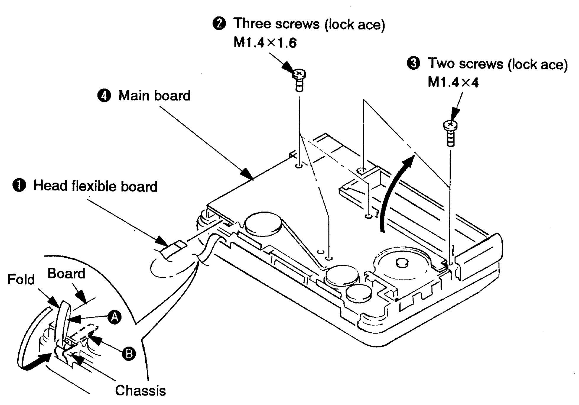

    This is the whole motherboard/cassette assembly, with just the top cover removed. Take a look at point number one. That ribbon connector is what goes to the tape head, and it folds over on the motherboard before curving around back into the connector. This puts stress on the cable where it folds, and also stress on the connector on the board. Check this out to make sure the ribbon cable isn't damaged, has any breaks, or has missing/folded back pins. This connector is really fragile, and I had a cracked connector on an EX that made it to where I had to fold some cellophane tape and jam it in the connector to add thickness to the edge connector so it would insert tightly. You could also try poking and pushing around on this cable with a plastic spudger or pencil eraser while operating to see if it changes anything. Do this all gently. If all of this looks good, and nothing changes, you can move on to the motherboard.

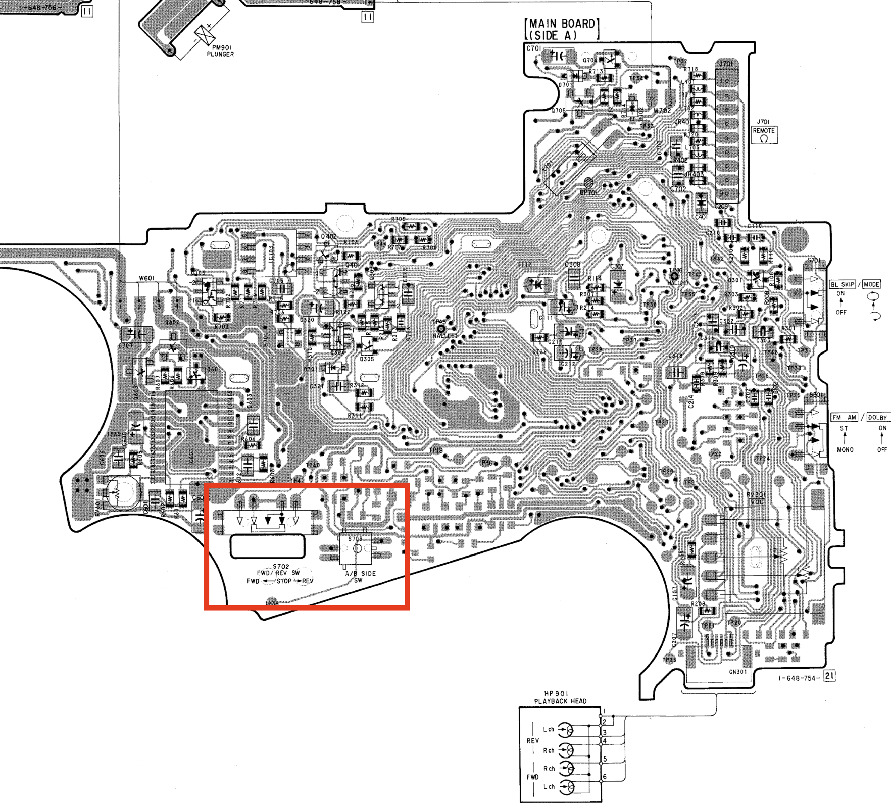

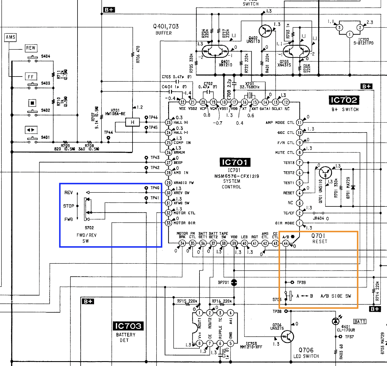

    Let's circle back to that switch really quick. There is another switch you may not be familiar with, called the A/B switch. Let's see the schematic:
    Screenshot 2023-04-09 at 11.23.56 PM.png Screenshot 2023-04-09 at 11.29.24 PM.png
    As you can see, the red square indicates S702, and S703. You can also see the Blue block is where S702 fits into the system control circuit (IC701), and also where S703 connects up (orange block). S702 bridges either pin X. rew, or X. fwd to ground... But A/B switch bridges the A/B pin on IC701 directly to B+. I'm really curious as to what this A/B switch does now, being how it fits into the circuit.

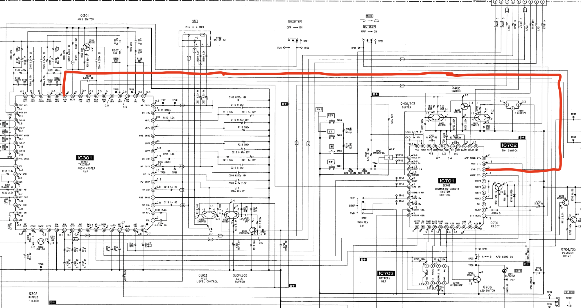

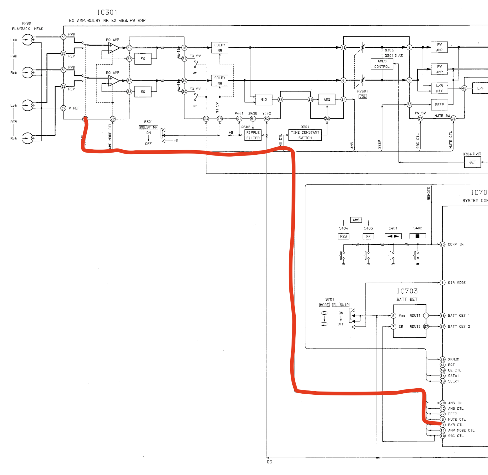

    Pin 9 is the control pin coming out of IC701 that tells IC301 what section of the tape head to use. High logic state for one side of the head, Low logic state for the other. Here's the block diagram:
    Pin 9 of the control IC goes DIRECTLY into PIN 27 of the amp chip IC301. no components in-between. Here's what you need to do. First, check continuity between them. then, Check to see when it's High, 'H', or Low, 'L'. If it is switching from high to low as S702 changes position, the chip is working properly, and IC301 is most likely failed. If it is NOT switching from H to L properly, IC 701 or a supporting component for IC701 has failed.

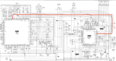

    Here's the complete path for reference:

  9. Silver965
    Silver965 Well-Known Member
    721
    Torino
    excellent explanation @Recaptcha I could not have done better
    But if it is not the switch S703 that causes the logic level to change on pin 9
    of the ic701 control cip ... what makes it change
    there must be a mechanical lever that crushes s703 when it changes reading side ... supplying a positive voltage to pin 44 or vice versa ... there is nothing of ic701 on the network
