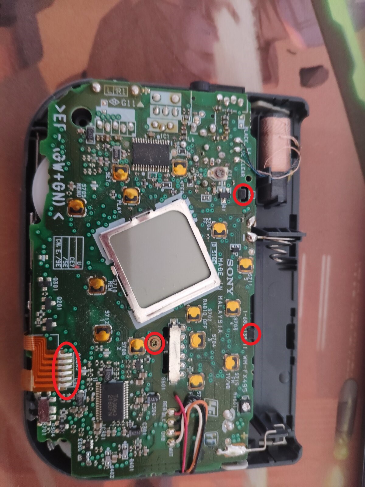

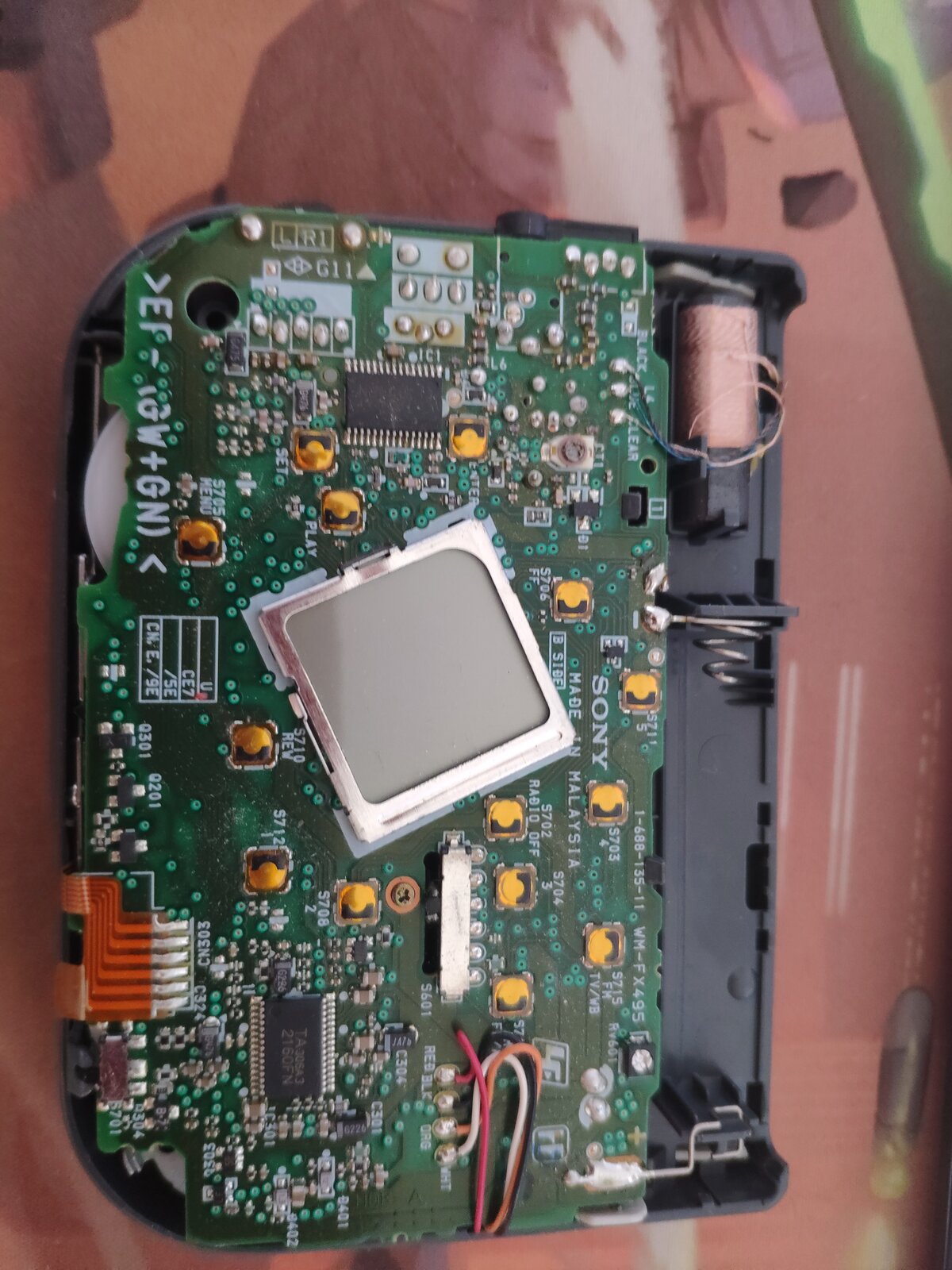

    Hi I opened the front part but this whole mechanism is holded by something I cannot find. Its doesnt have and screws I cannot understand what is holding it. I just want to change the beld. Does anyone know hot to do it.

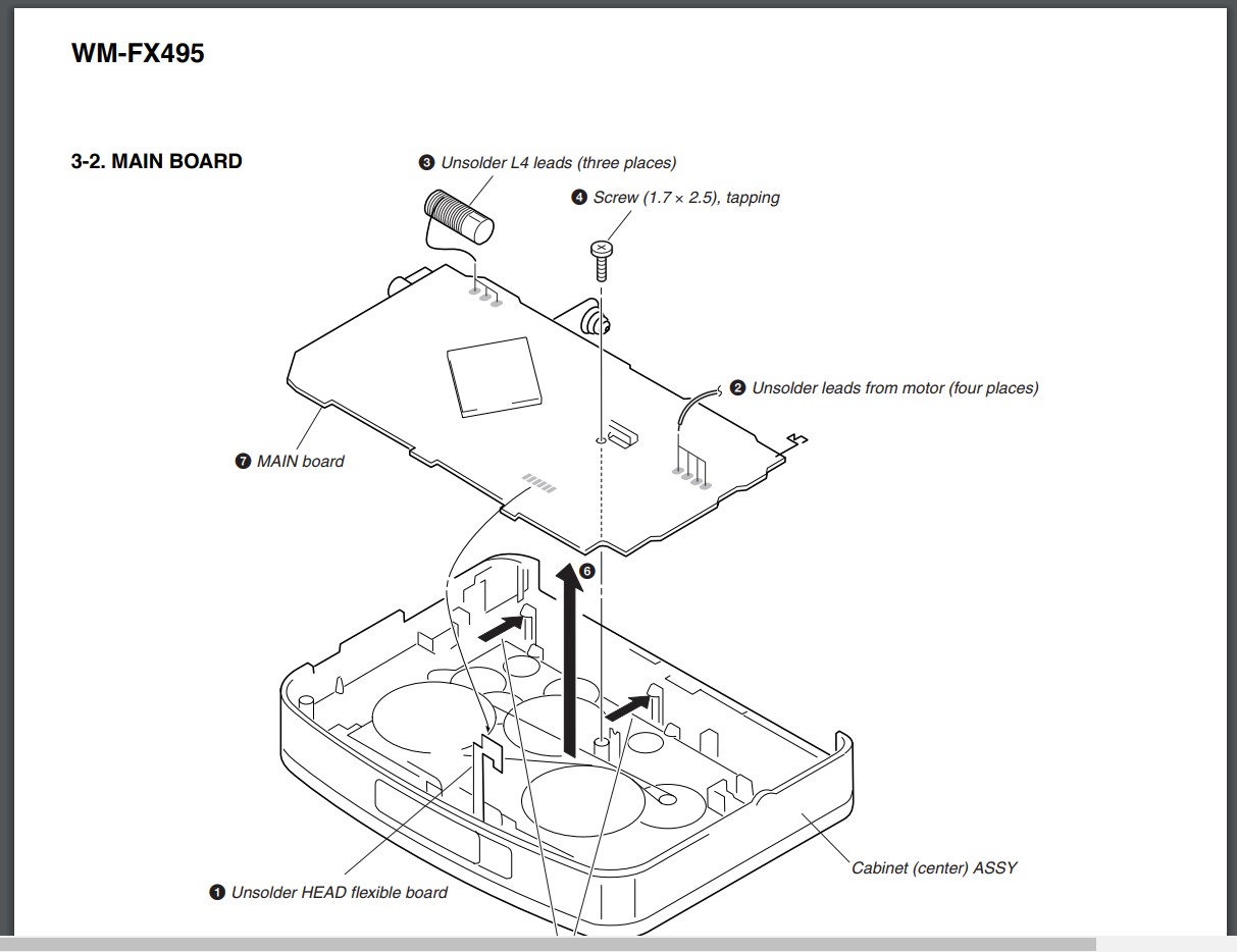

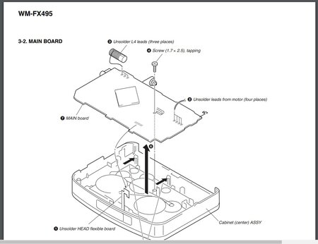

    Taken from the manual

  3. MissionTroll
    MissionTroll Member
    69
    Turkey
    I saw that screw and removed it. But all of the wires are soldered and I have to disolder them for reaching the beld thats kinda annoying.
  4. Silver965
    Silver965 Well-Known Member
    721
    Torino
    you should get up a bit to allow yourself to get to your belt

  5. henrypal
    henrypal Member
    50
    Mar del Plata
    and unsolder L4 leads (three places). (AM antenna)
