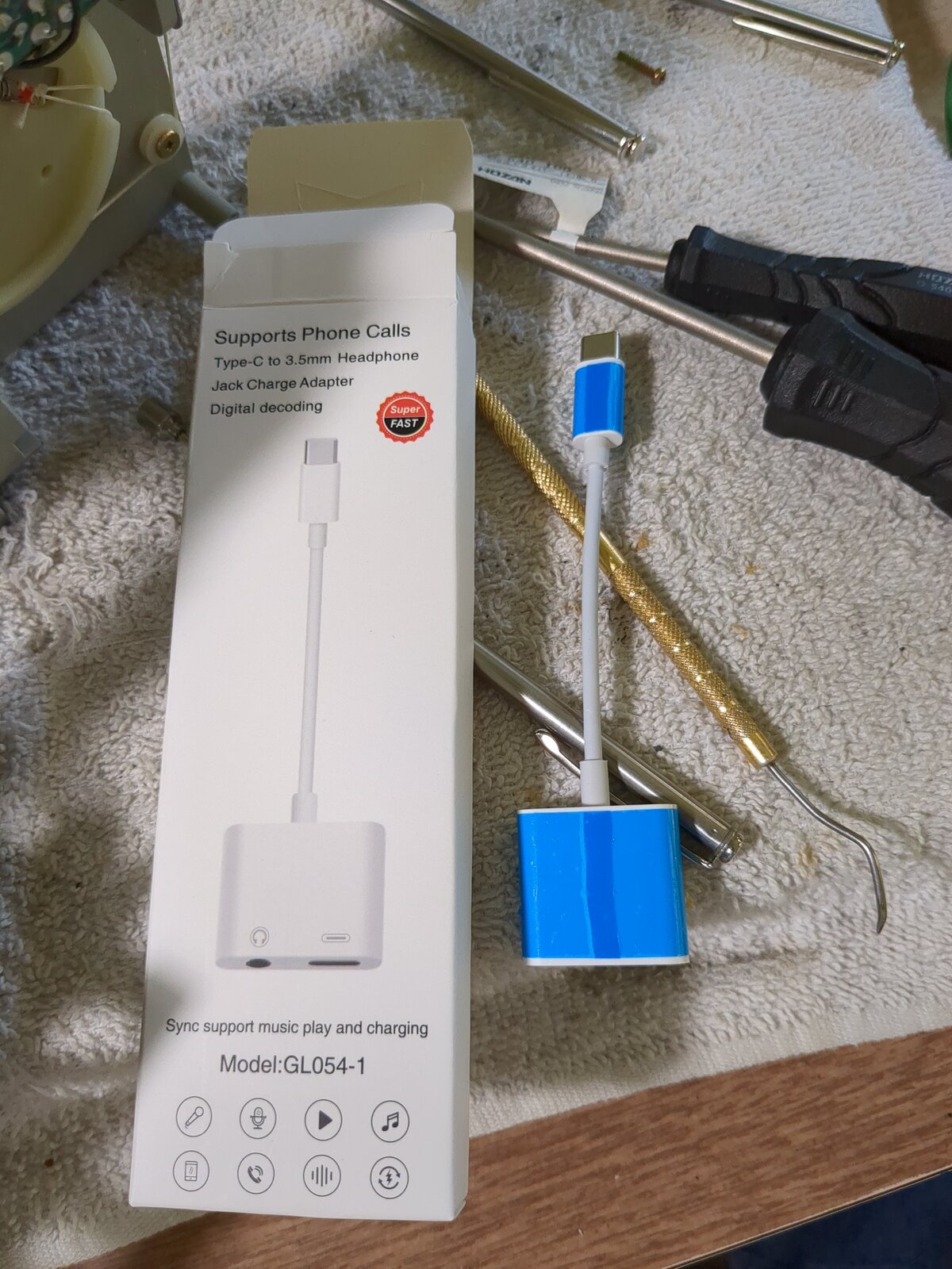

    I have a Google Pixel 6A
    I just got this Saturday
    https://www.ebay.com/itm/145294592702?mkcid=16&mkevt=1&mkrid=711-127632-2357-
    0&ssspo=6frygfzhttc&sssrc=4429486&ssuid=Ssjp7qHRTvG&var=&widget_ver=artemis&media=COPY
    My headphones plug into this and then while the headphones are plugged in you can also plug it into power and recharge your phone if necessary. This is a USBC.

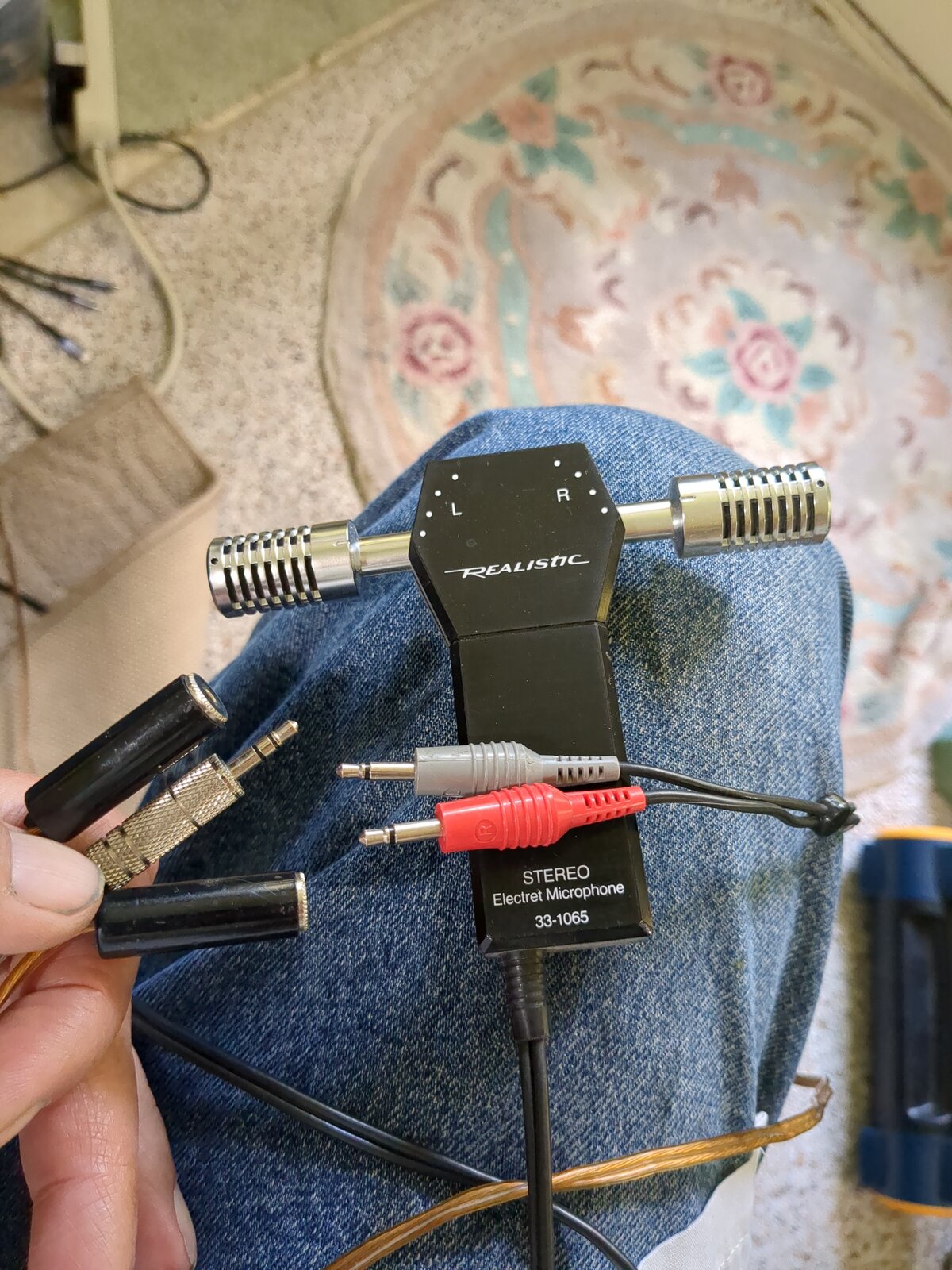

    2. The microphone remote control is 2.5 mm the microphone. Jack is 3.5 mm and is mono when you have left and right. So it's only two pins with one plastic bit in between if you understand that.
    3. One of my microphone choices is this realistic which takes One battery which is electric condenser microphone that you can read, it does not have a 2.5 mm remote control. Jack, it just has the dual mono 3.5 mm jacks. Of course it has a dual head and you may have seen it in some of my old videos.
    To make it work, I have made a custom dual input mono to a stereo. Jack, so I can plug it into a device that only uses one stereo microphone input. Jack or I can plug it into a boombox via the two mono jacks. My choice. Here's a picture to illustrate

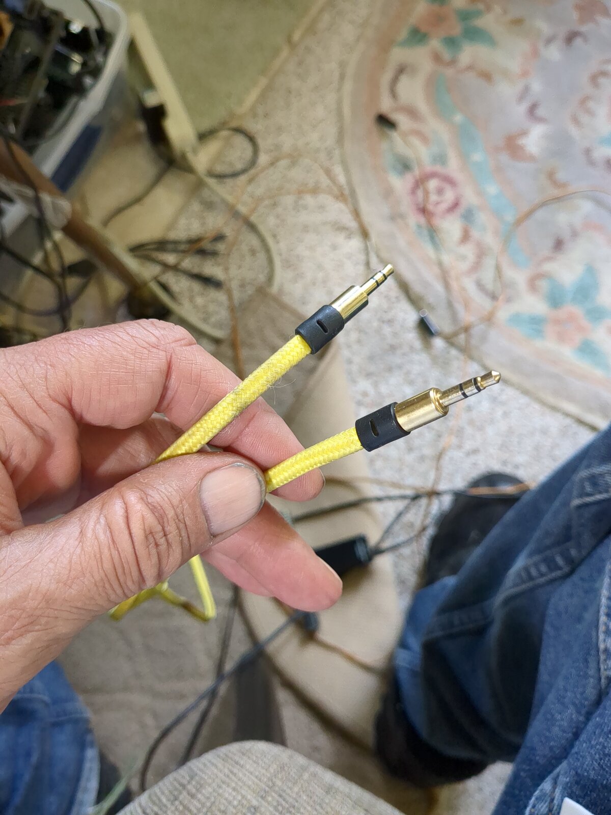

    Lastly, it's nice to have a double-ended 3.5 mm stereo cord here
