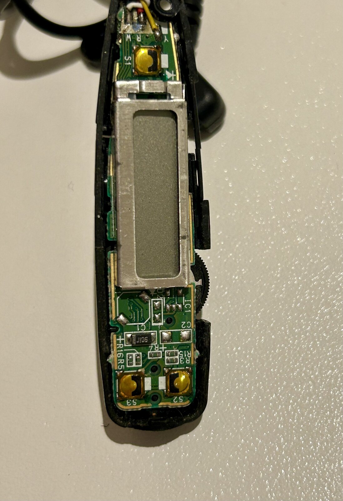

    1,060
    Here is the LCD side of the PCB of the RM-WME23. There are several unpopulated pads: it seems these are for the components required for the backlight, for the L version.

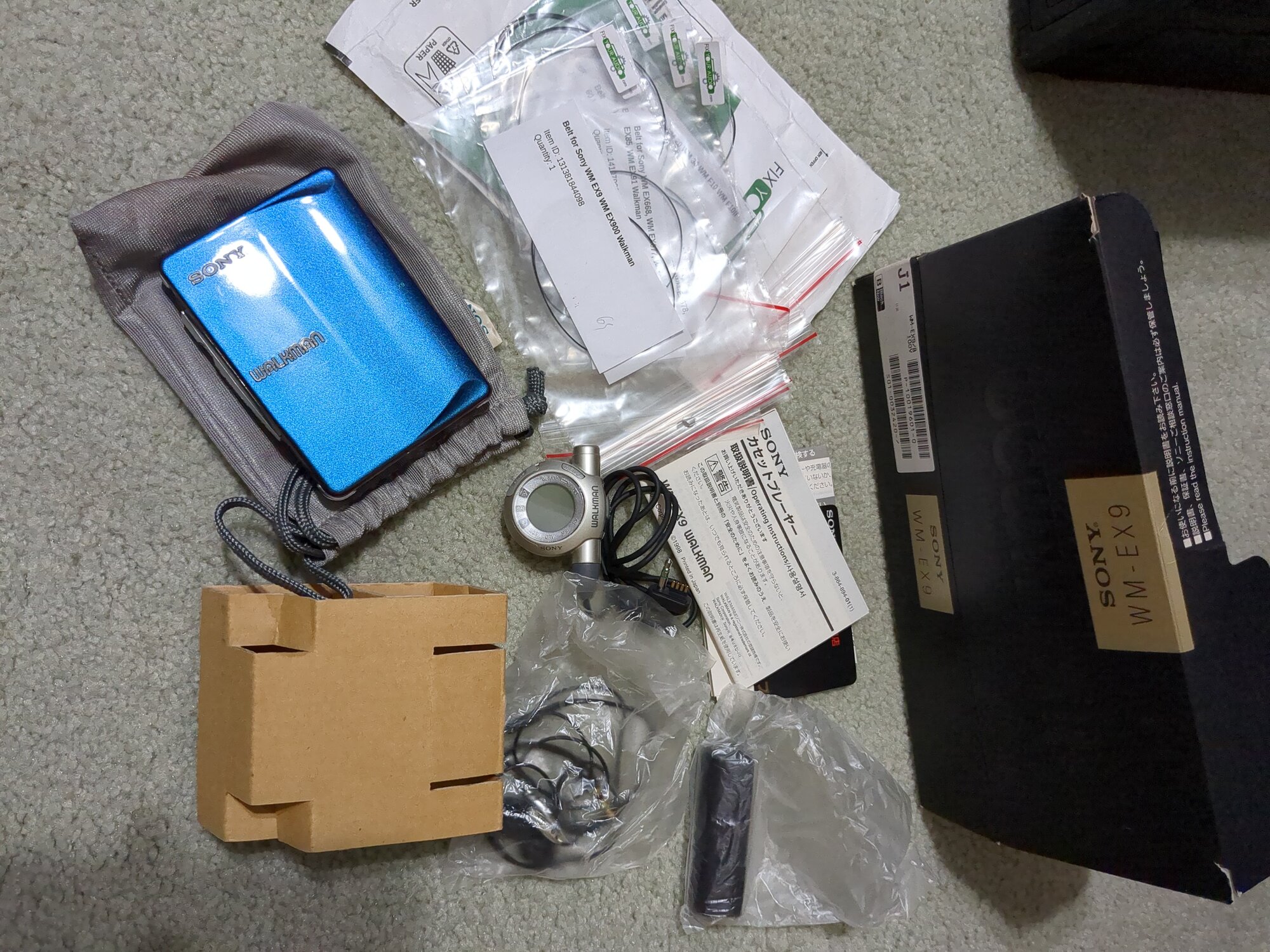

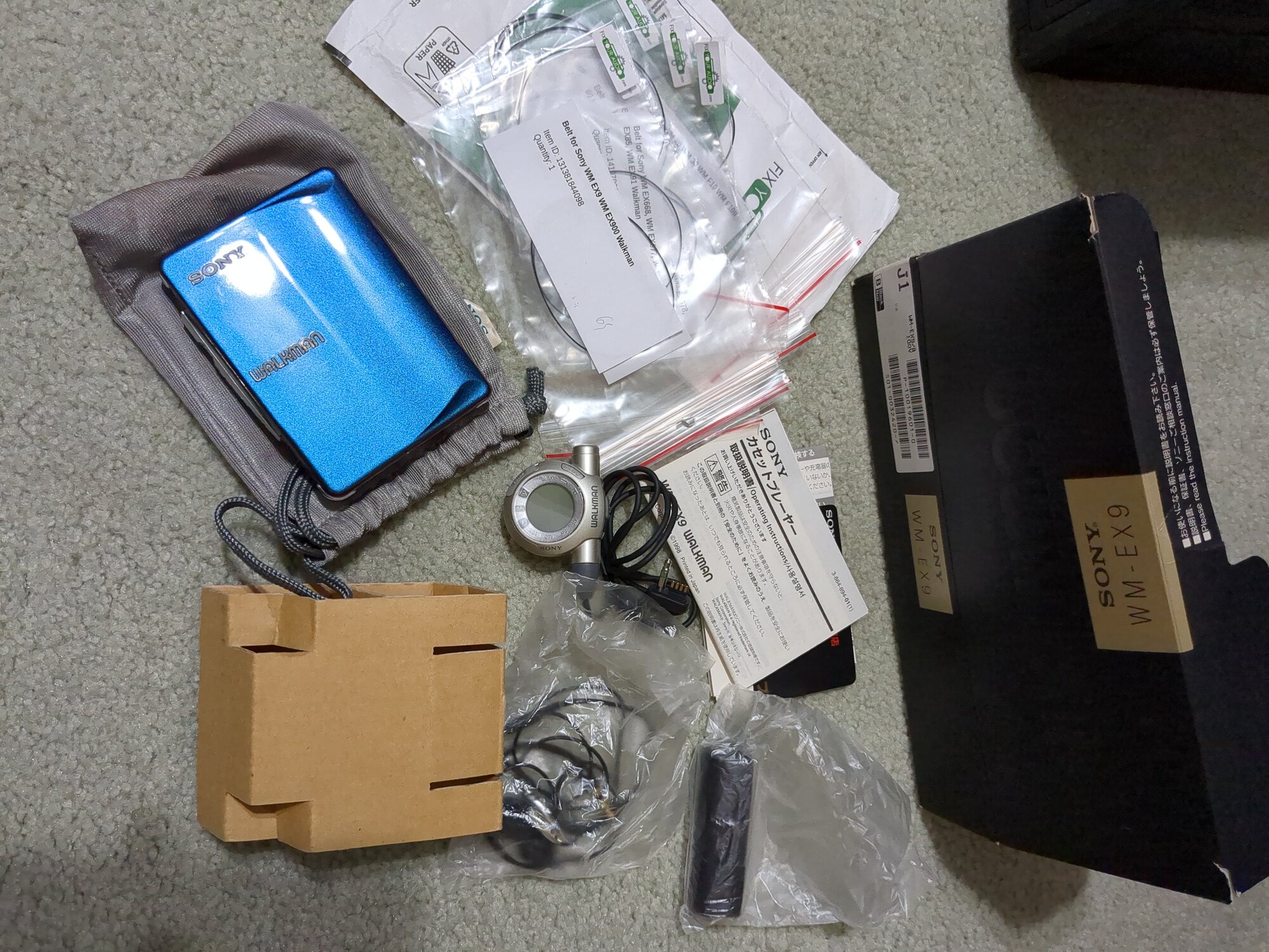

    The remote of the EX9 (RM-WME21L) doesn´t work with the EX900 , and viceversa .
    I know these because have both of them .
    The thing is that the RM-WME21L has the "menu" button/function . while the RM-WME22L (belonging to the EX900) has each button dedicated for any particular function .
    Reducing costs , surely that´s the reason , the 22L might be cheaper than the 21L .
    The EX900 was a less expensive version of the EX9 , by changing the remote and looks of the device (plastic corners vs metal corners ) and not offering the "chamaeleon " color version .

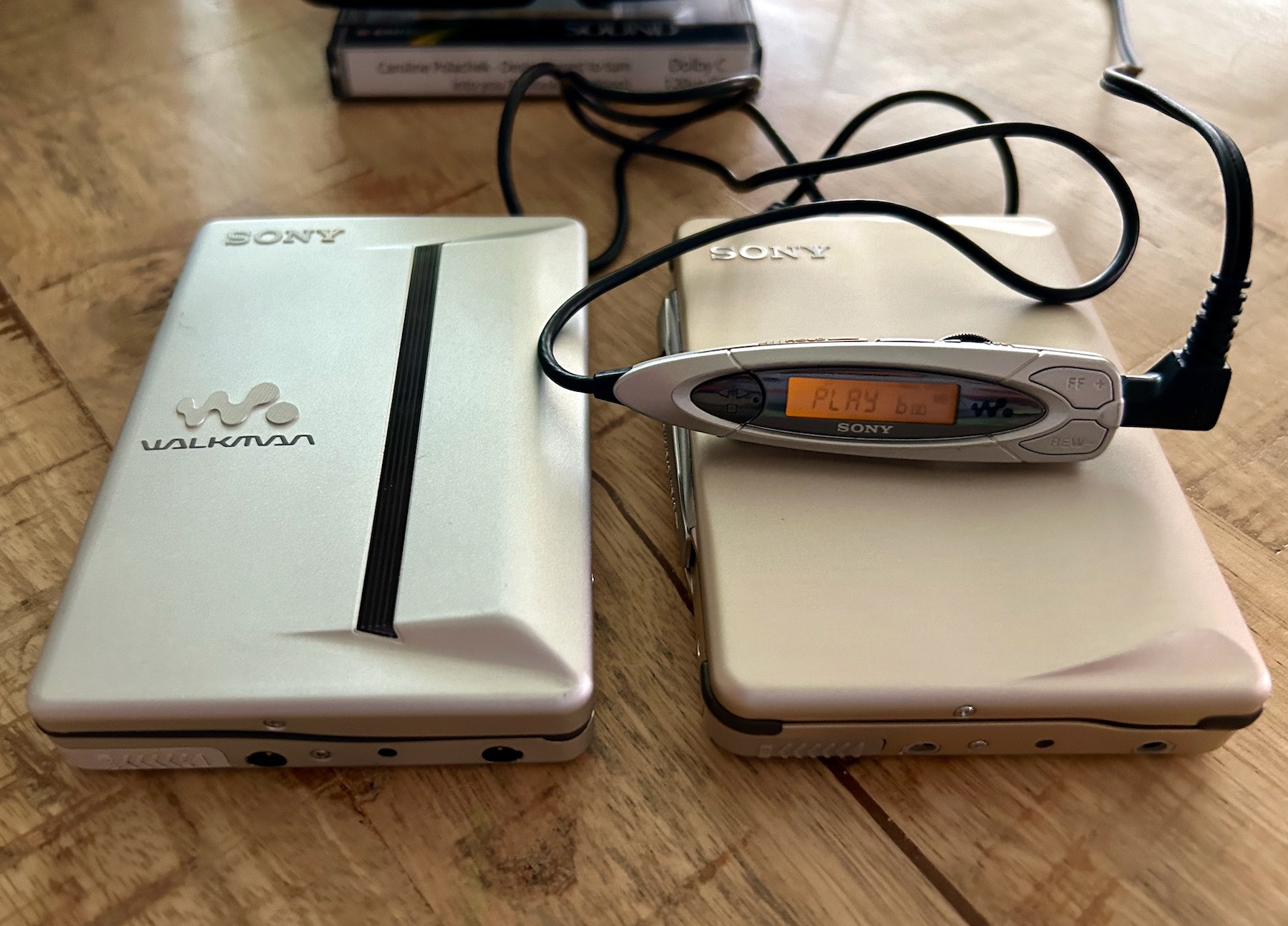

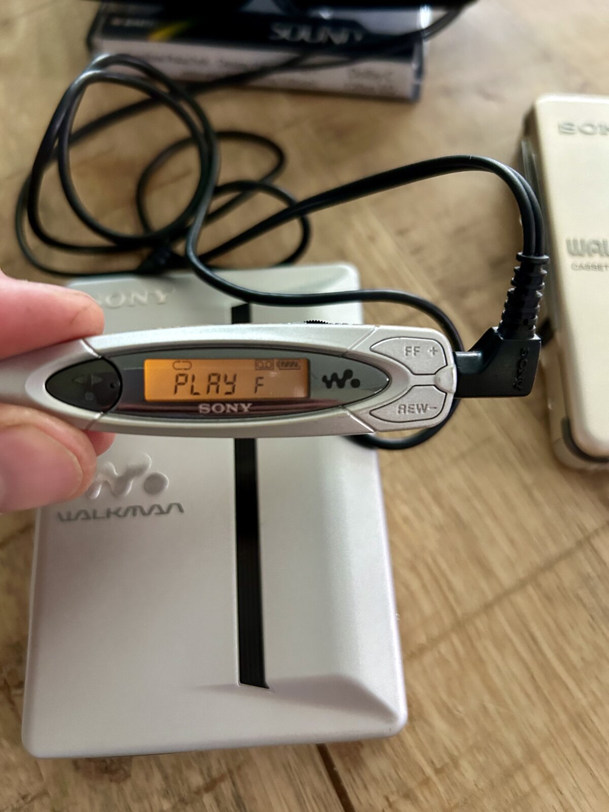

    1,060
    This is the RM-WME23L, originally paired with the EX910, which seems to work as intended with the EX900 too.
    The difference is what is on the display: with EX900 it indicates playback side, with EX910 playback direction.
    Both devices keep info on the remote even when nothing is playing, showing playback mode, direction/side, and cassette inserted icon.

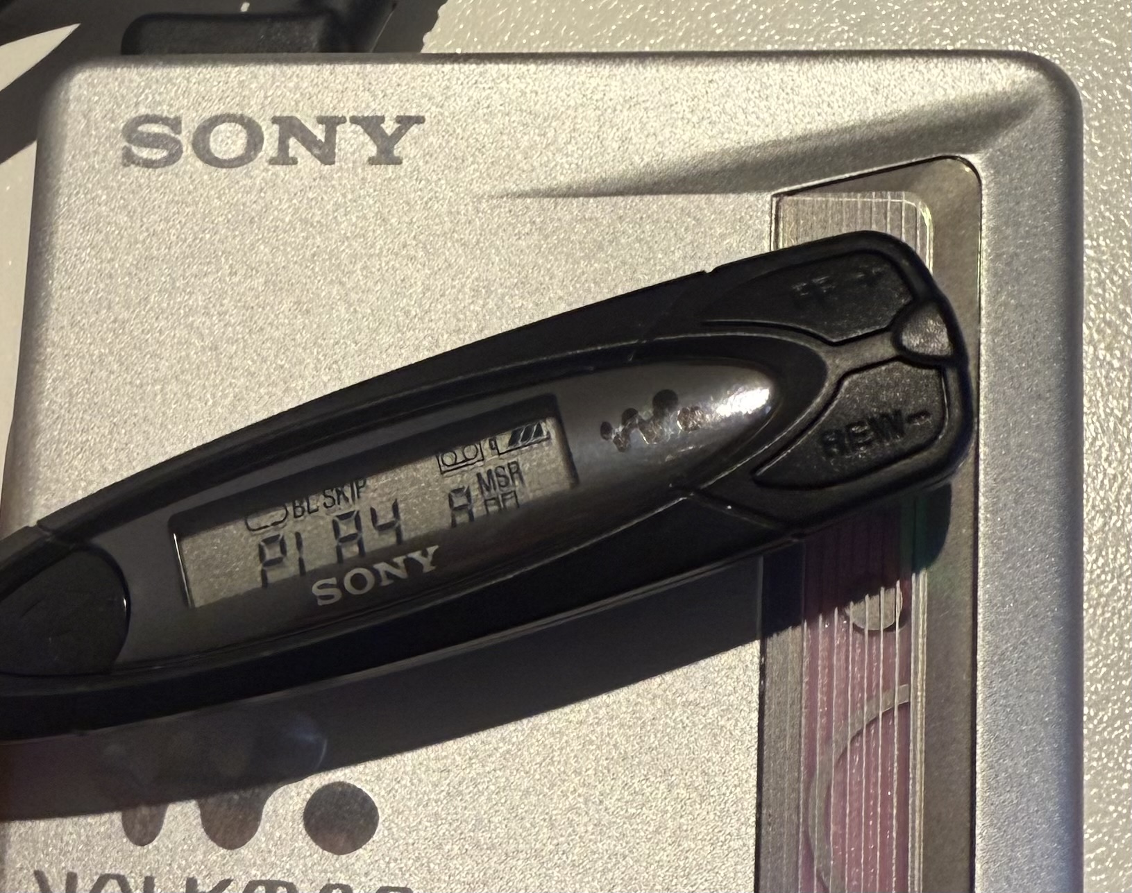

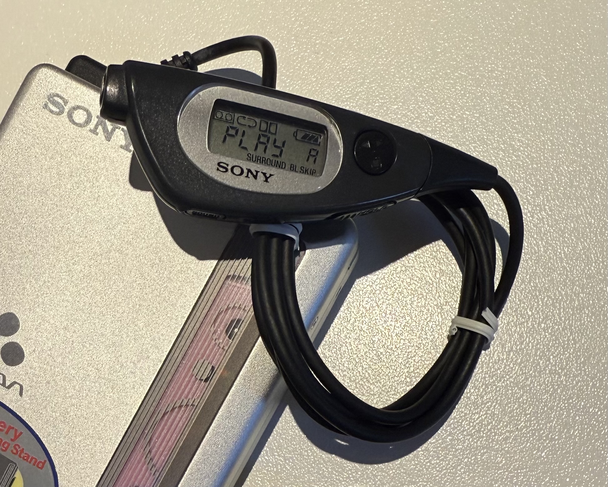

    The RM-WME22 works with the EX2000. It even displays SURROUND instead of MSR that some other remotes show
    RM-WME22 on the WM-EX2000
    RM-WME22 on WM-EX2000
