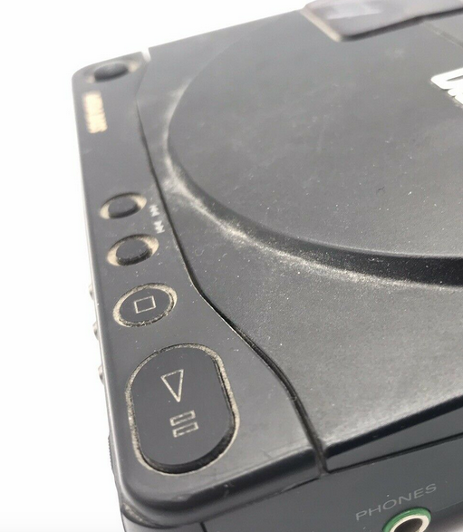

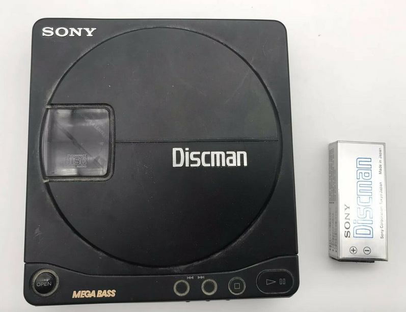

    With this whole shut in thing we have here in the US, I've had nothing but time. So, I decided to buy a used Discman a couple of weeks ago. Here it is:
    It's a D-9 (D-90 for Europe). Dirty. Non-working. Total train wreck. Seller knew it didn't work. Sold as is for about $30. I think for a semi-solid body Discman that's not a bad price (working or non-working).
    Now, I have a good deal of experience repairing CD players and I have done a good many of them. So I did feel I could repair this one, and bring it back to life.

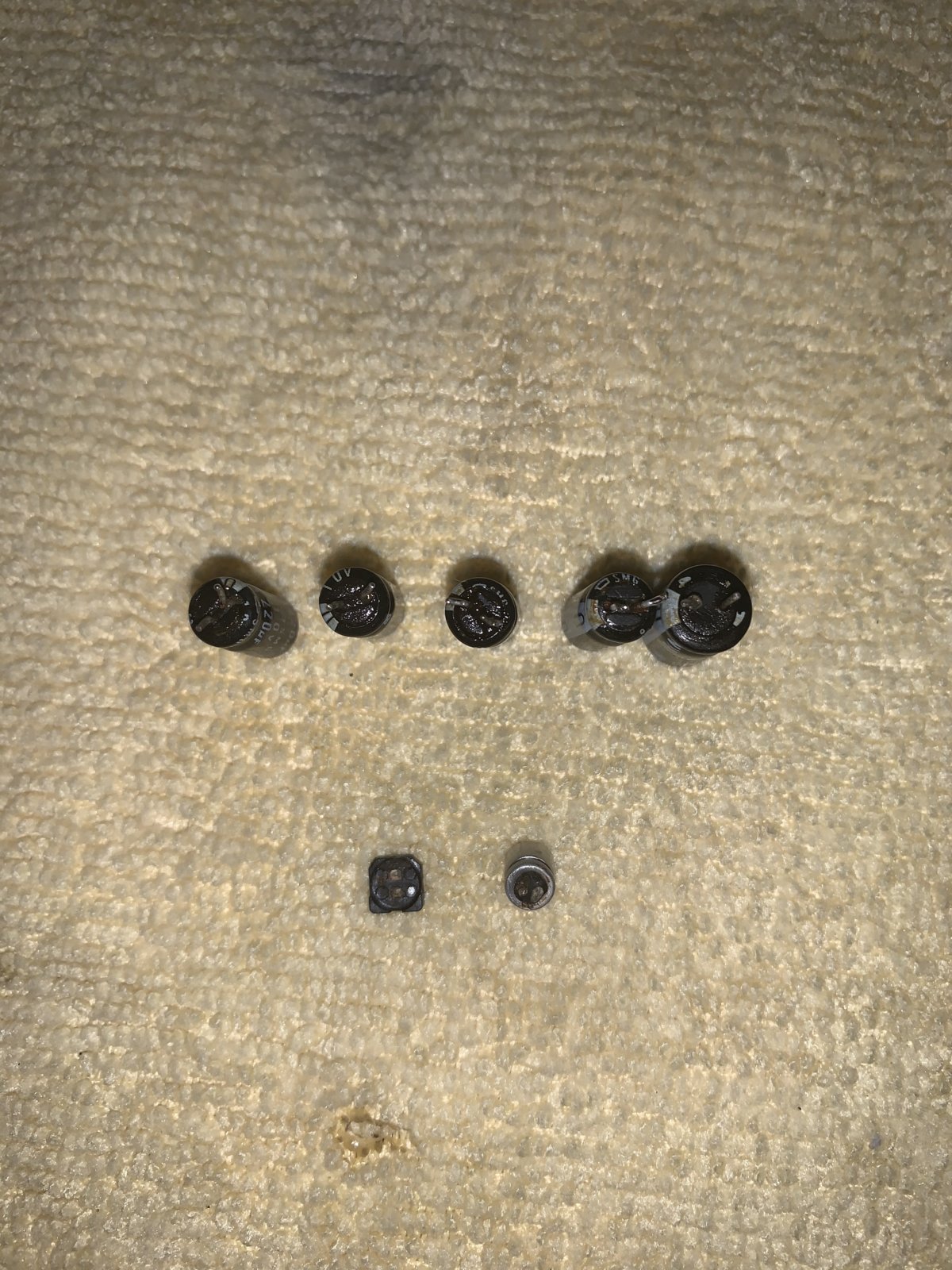

    So, It arrived, I took it to my lab, and gave it a test. It had a stuck laser transport, countless bad capacitors, and a major dirt issue. It really did need a lot of work!

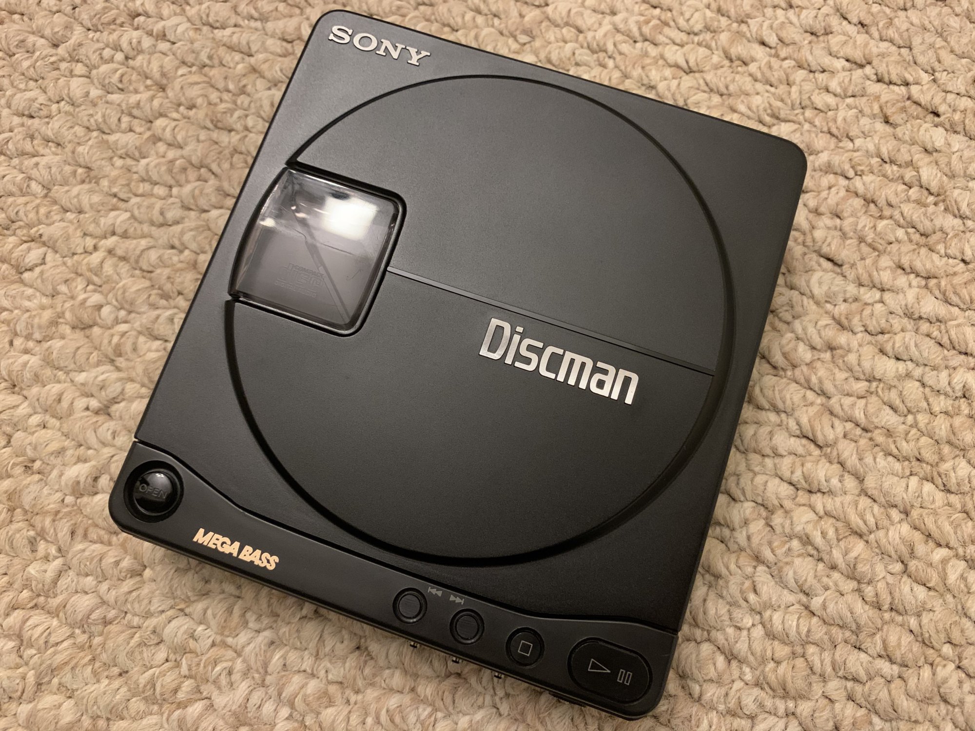

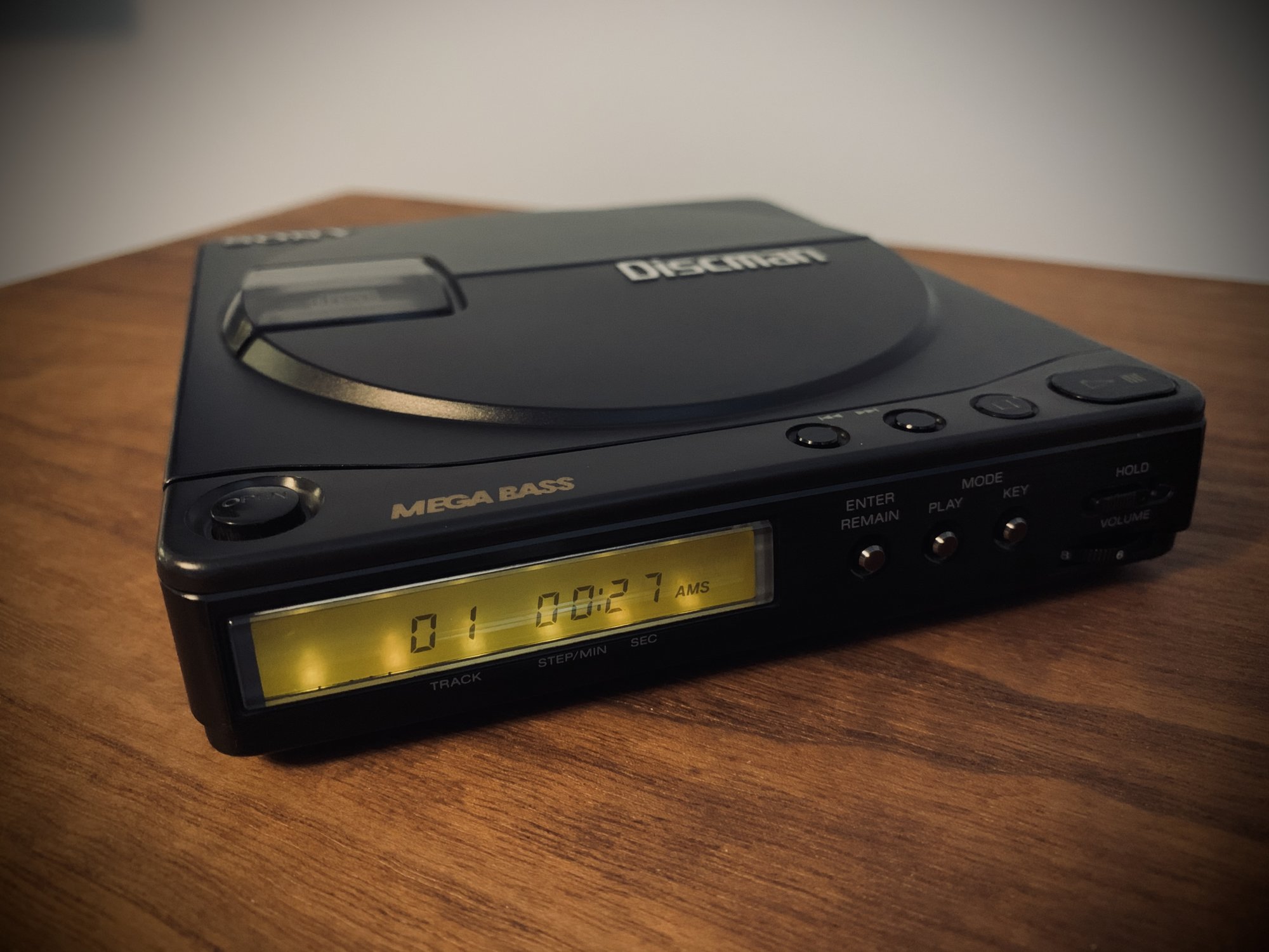

    So, after many hours of work, soldering, cleaning, greasing the gears, and replacing capacitors, I got this unit back up and running properly. It plays like new now.
    Some nice photos:
    I know the D-90 isn't exactly the most desirable model available, but this one hasn't a major ding or scratch on it, and it really has been overhauled!

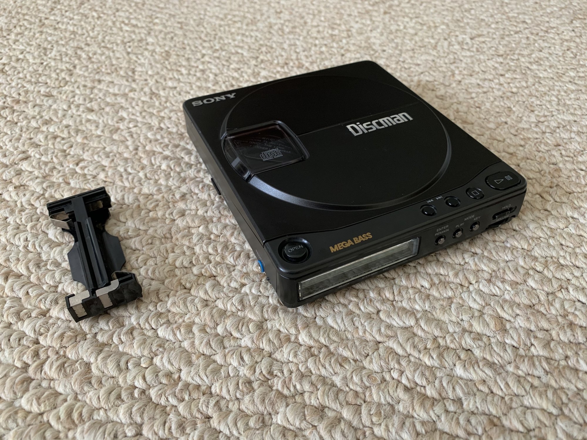

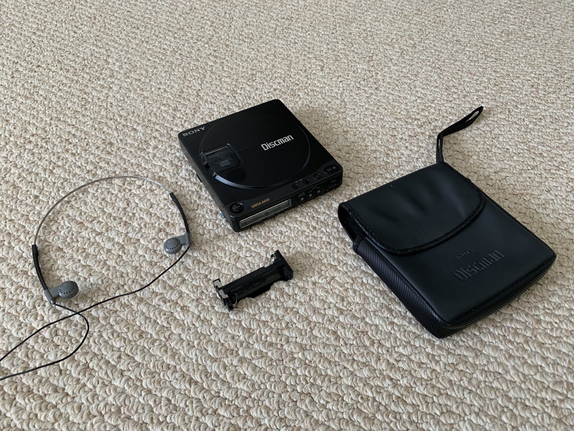

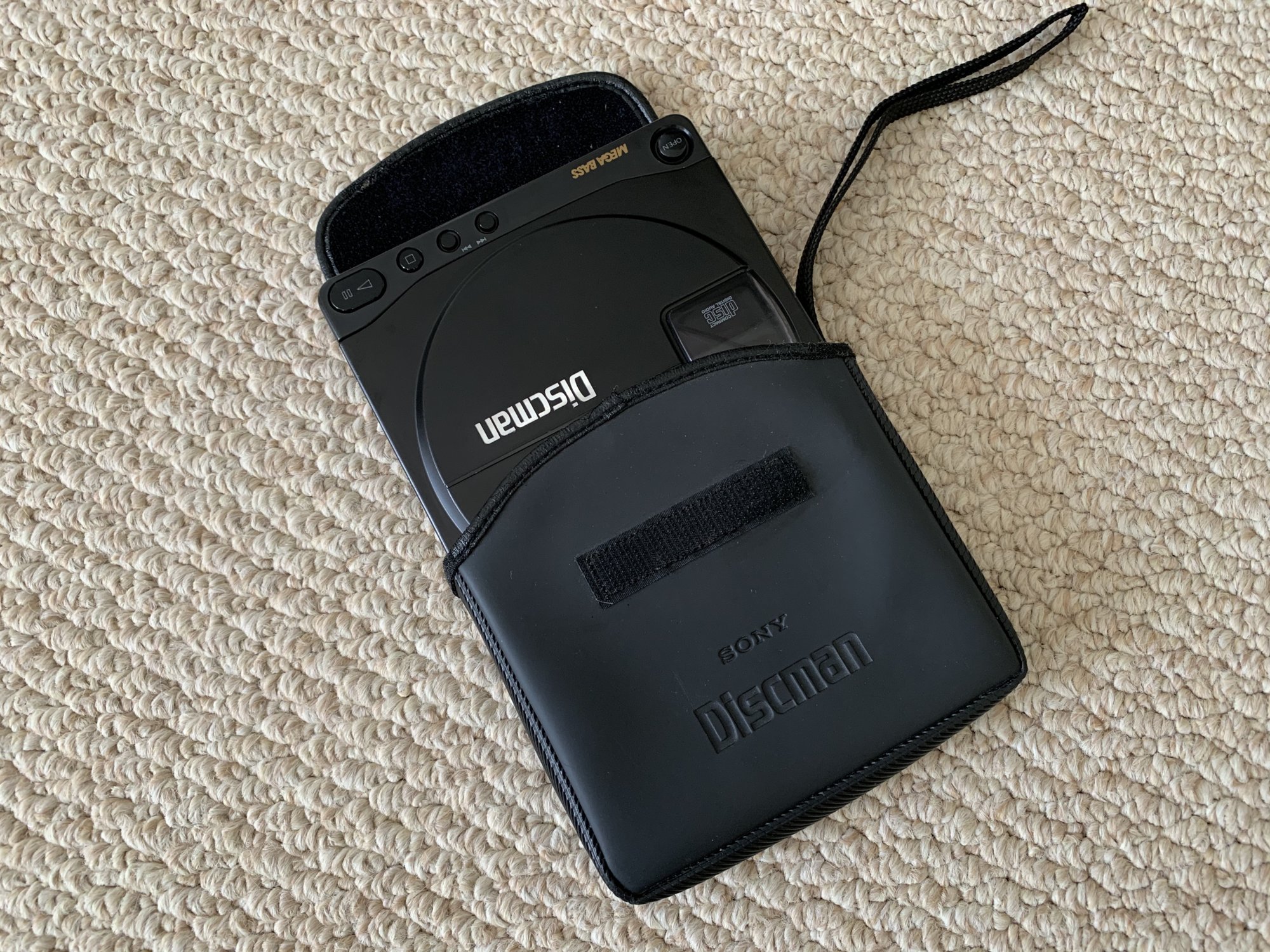

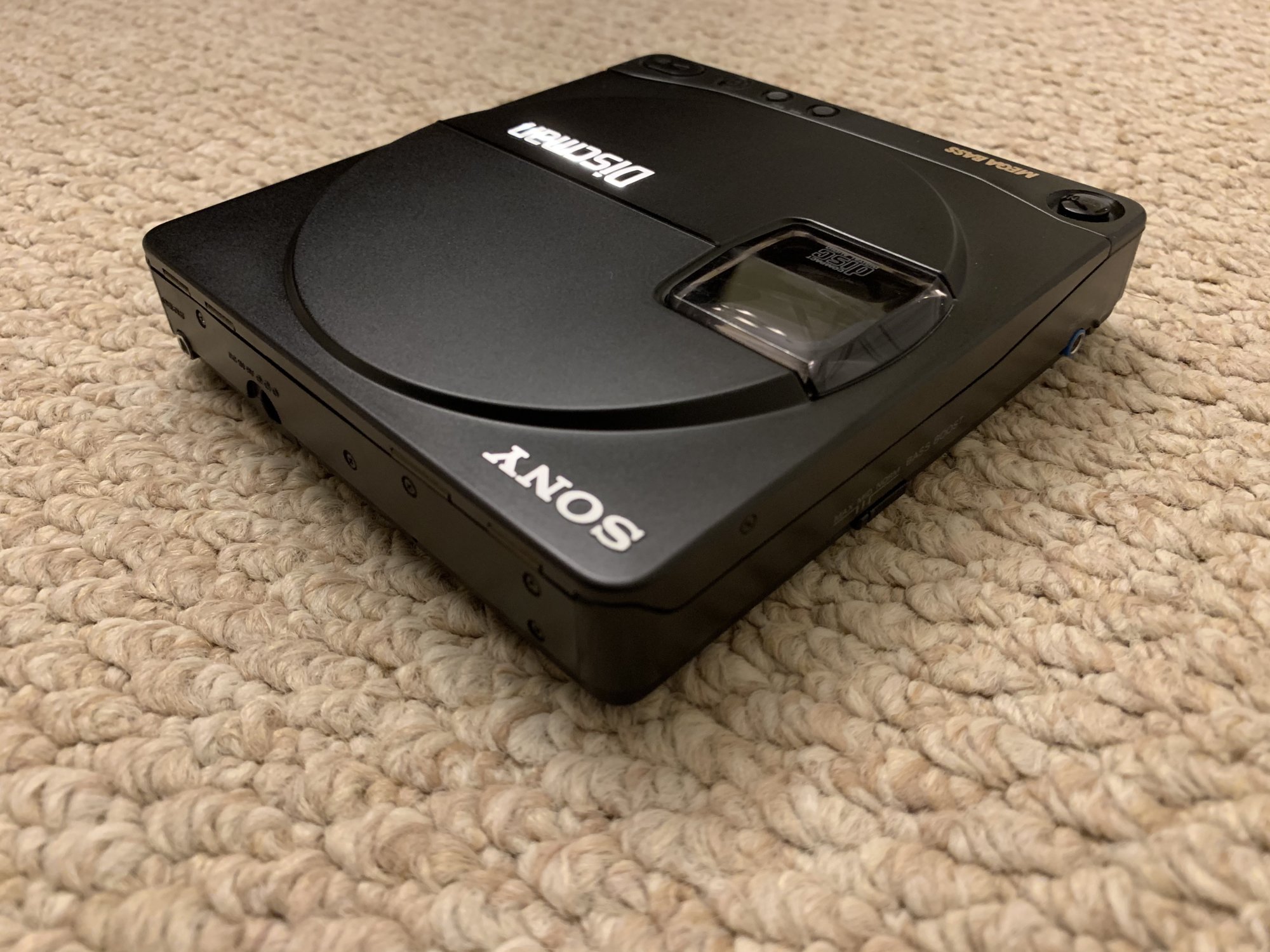

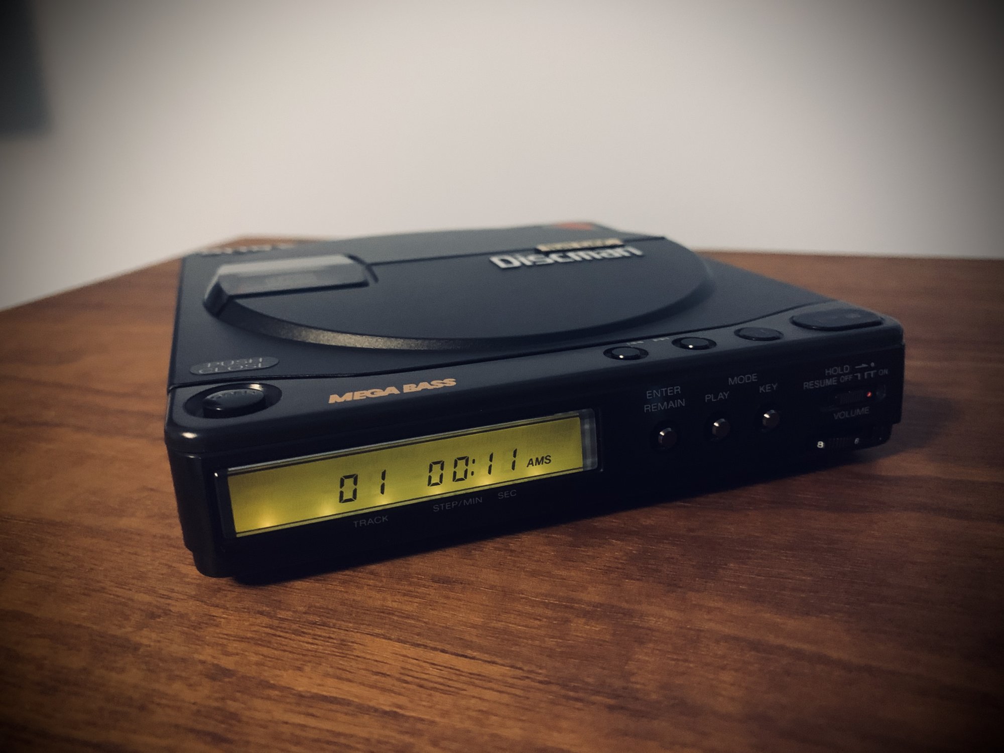

    Ok, I have done another D-9. This one was especially fun since it came with the original accessories. These things are really a blast to repair!
    Same problems as the first, the laser was stuck, the SMD capacitors had leaked, and the unit was dirty.
    I just love how great these things are. They feel so heavy and solid built.

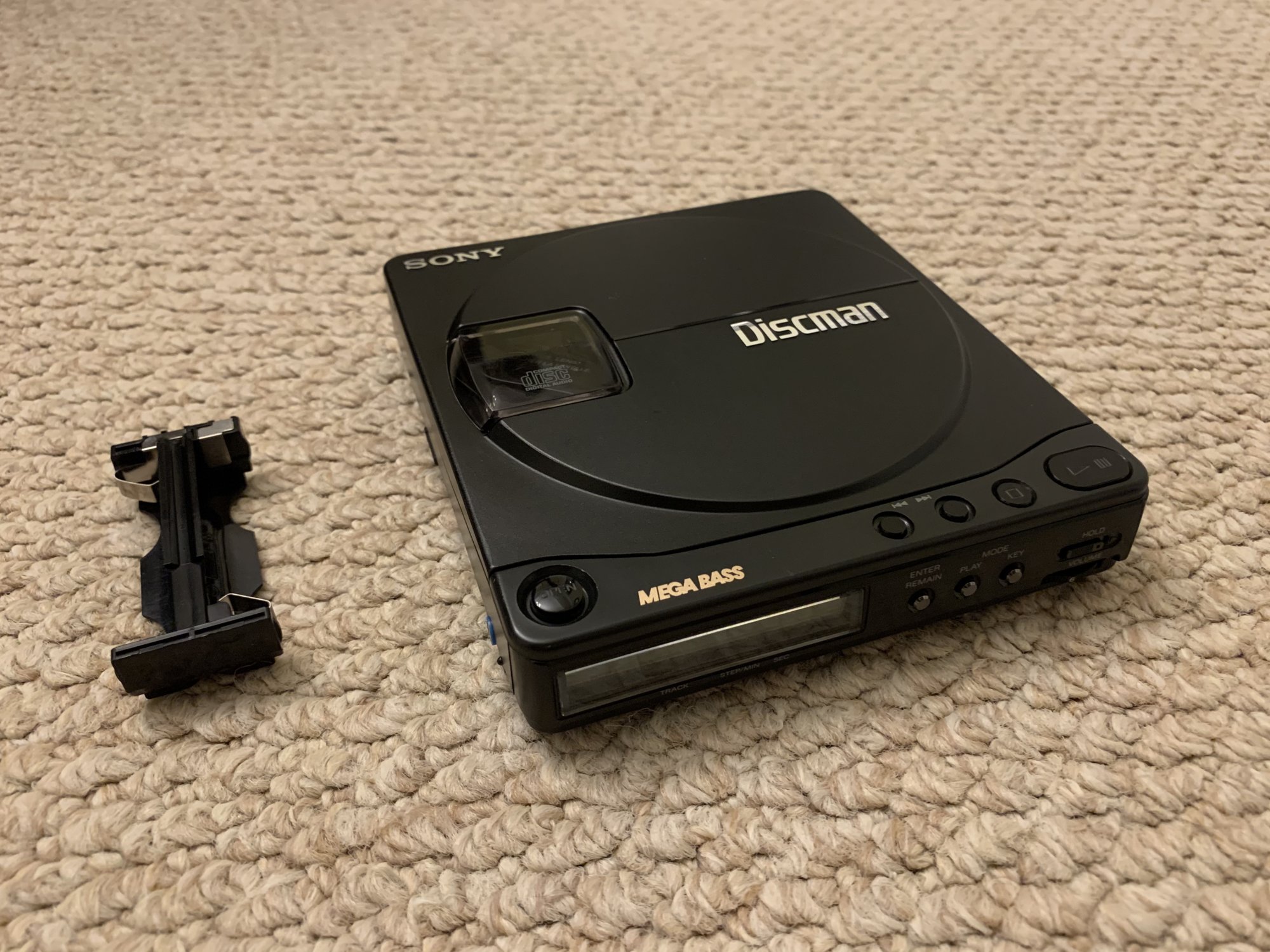

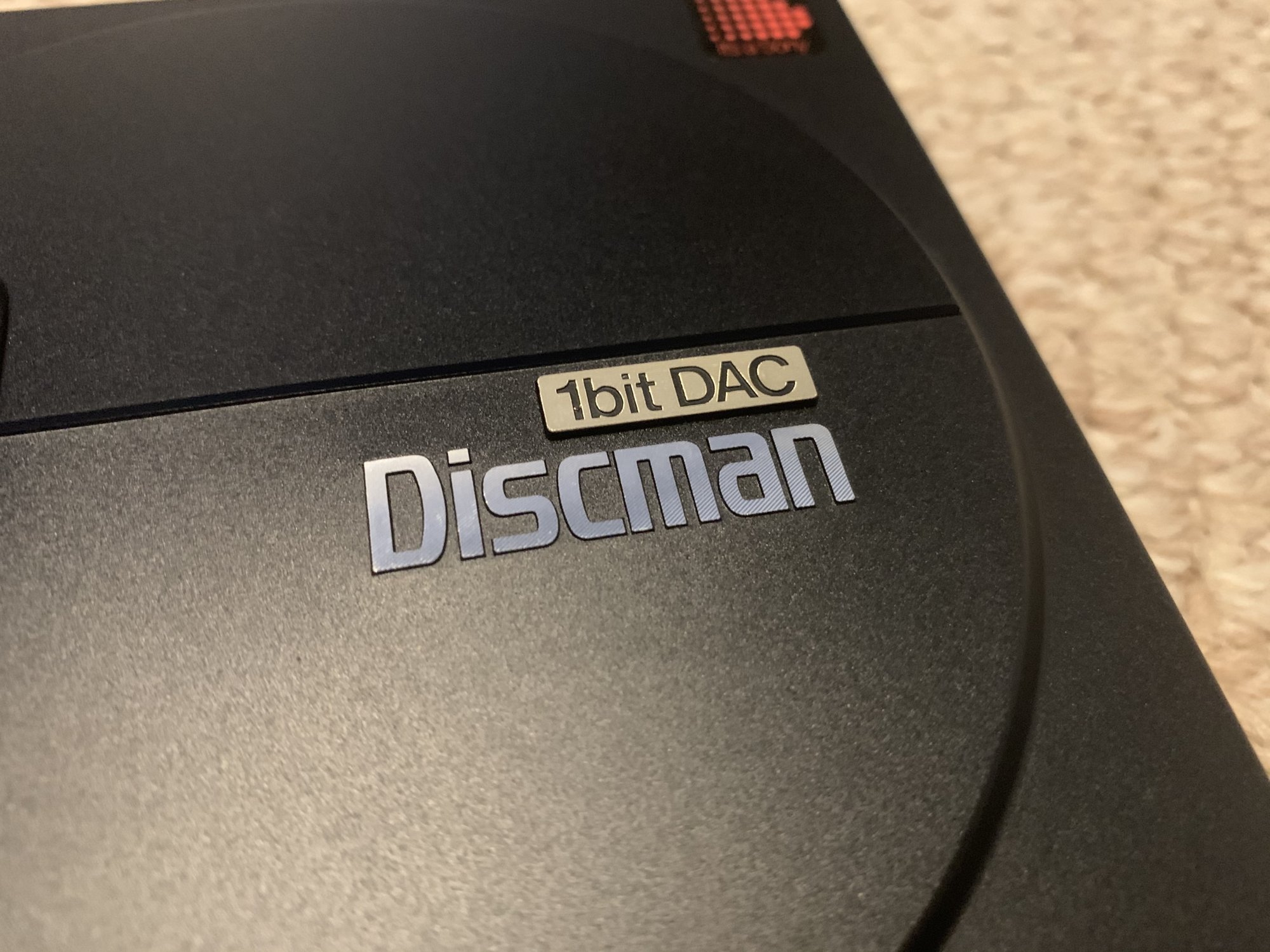

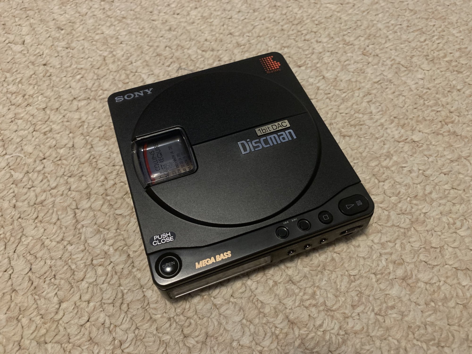

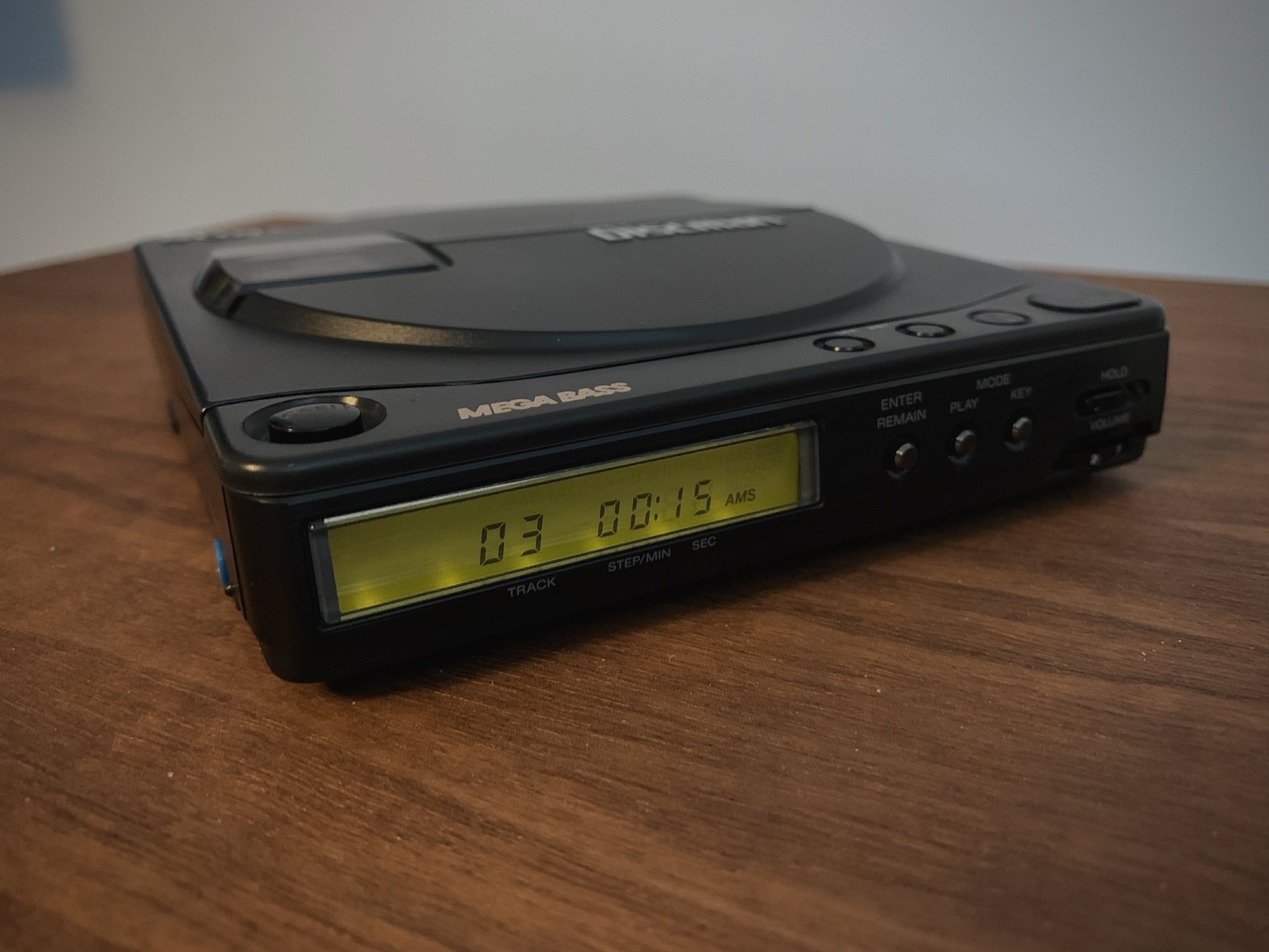

    Ok, I got the D-99 done. There were so many bad capacitors in this unit!
    Anyways, after a TON of work, Here is the finished product:
    It sounds about the same as a D-9, but a little bit louder to me.
    Got a D-9 in the shop now, it's being a bit difficult, but it will come around soon!

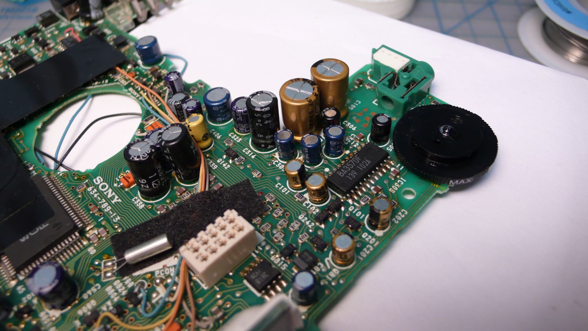

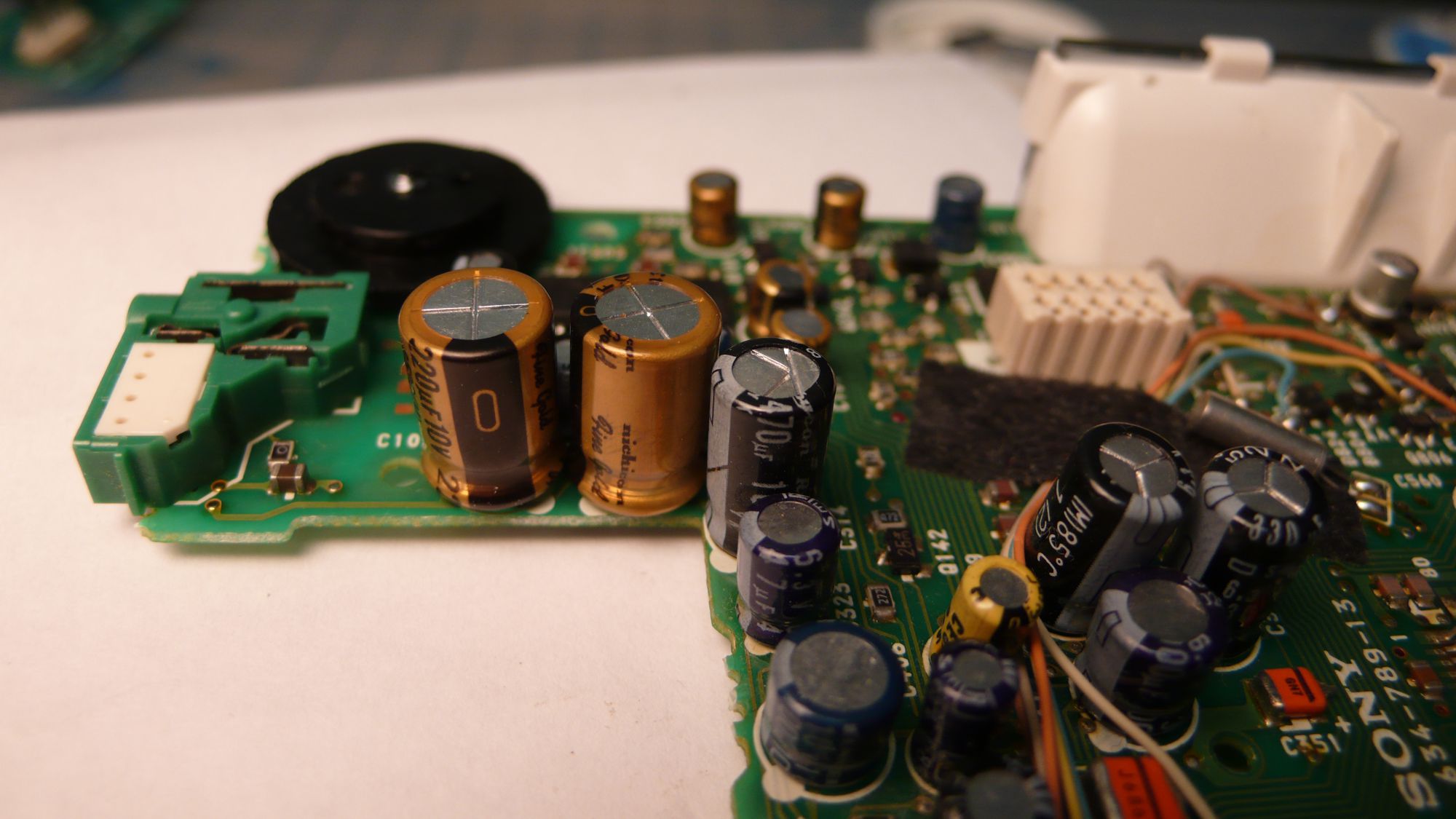

    D-99 has somewhat friendlier layout than D-90. In my second D-99 I managed to put Nichicon FineGold ("Muse" series) h/p coupling caps:
    Overall I did not like how it sounds so stopped reviving these...

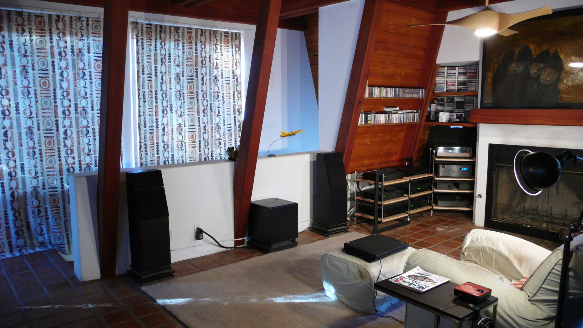

    Extremely interesting, have you ever worked with Sony PlayStations? The early models got into "Stereophile's Recommended Components" list, next to some pretty respectable players! And early PS3 can be hacked to rip SACD layer onto hard drive as dsd, how cool is that?!!!
    two rows above Naim amps was my SACD collection, I would have paid a lot to be able to rip them:
    there was always an option to send SACDs to be ripped for you, but the idea of mailing my Esoteric SACDs (at $100+ a pop) was not very appealing to me
